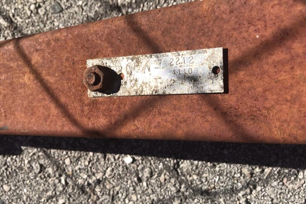

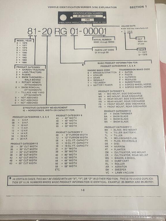

Lane Ranger 12,030 #12 Posted January 10, 2023 (edited) This Wheel Horse Metal Tag I. D. Topic comes up every once in a while. Here is a copy of the Eherl Horse metal tag reference sheet. It is a good idea to make a copy of this and place in one of your files, three ring binders or manuals for your use. An interesting fact I stumbled on is the metal tags were made by ANCO which is placed on many of the early metal tags. ANCO was the Anderson Wiper Blade Company in Gary, Indiana. The company produced many wiper blades and their yellow ANCO metal displays were at gas stations all across the country in 1950, 60 snd 70s. Dump Cart and Mid grader blade tags pictured. Edited January 10, 2023 by Lane Ranger Added photos 3 Share this post Link to post Share on other sites

WHX?? 57,384 #14 Posted January 11, 2023 Is that document in the files Lane? Share this post Link to post Share on other sites
