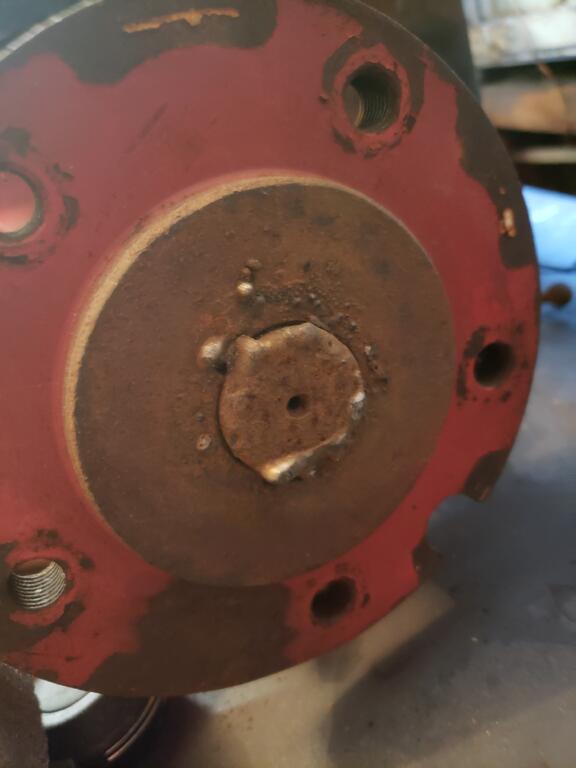

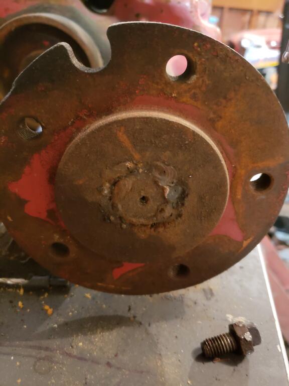

71_Bronco 1,072 #7 Posted May 11, 2020 Heres a pic of the ends where the welds are. One side seems to be goobered just on the outside, but the other seems like it got a decent penetration. 3 Share this post Link to post Share on other sites
Ed Kennell 41,880 #8 Posted May 11, 2020 I would take John's advice and grind both down to clean metal. Then you can se where the two are actually attached. It looks like the first one is only attached at 1-3 o-clock. The second one only at 11. Share this post Link to post Share on other sites
bc.gold 3,406 #9 Posted May 11, 2020 9 minutes ago, 71_Bronco said: Heres a pic of the ends where the welds are. One side seems to be goobered just on the outside, but the other seems like it got a decent penetration. if you can remove the heavily welded axle a machinist could remove the weld, on the gobbed axle fortunately cast iron does not take well to the type of welding rod used/ Is there enough room behind the hub to push it further onto the axle, those gobs will break free then you can clean up the axle to fully remove the hub. 3 Share this post Link to post Share on other sites

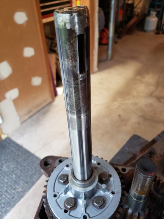

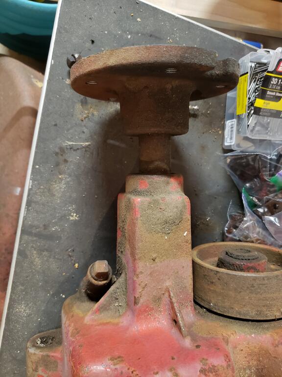

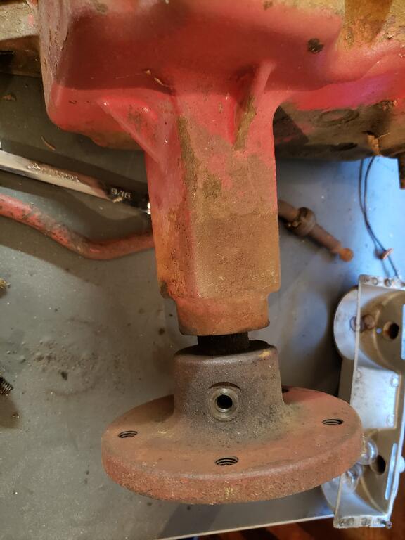

71_Bronco 1,072 #12 Posted May 23, 2020 Heres a pic of the axle shaft after the hub was removed. As I said, key slot looks perfect. The other 2 pics are of the hubs before I started, showing how one is further from the transmission casing. This is what makes me believe 2 longer shafts were used instead of one short and one long. Share this post Link to post Share on other sites

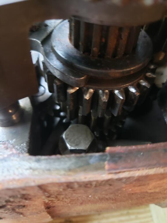

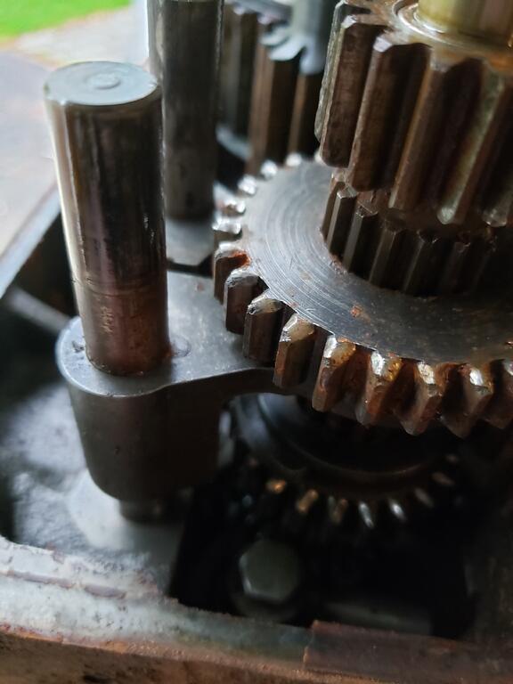

953 nut 59,872 #13 Posted May 23, 2020 The gears didn't leave the factory looking like that, but they have plenty of life left in them (about average after 50 years). Well worth taking apart to inspect bearings and replace all the seals. Share this post Link to post Share on other sites
bc.gold 3,406 #14 Posted May 24, 2020 (edited) 6 hours ago, 953 nut said: The gears didn't leave the factory looking like that, but they have plenty of life left in them (about average after 50 years). Well worth taking apart to inspect bearings and replace all the seals. I would clean the burrs off the factory bevelled edges so the gear engages effortlessly. Edited May 24, 2020 by bcgold 1 Share this post Link to post Share on other sites

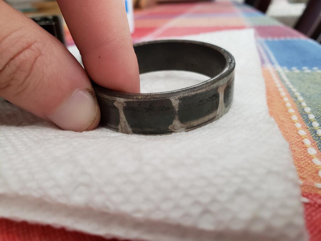

71_Bronco 1,072 #15 Posted May 24, 2020 The case inside was dry, and I will definitely be doing some cleaning / inspection. Some of the gears have some rust-colored discoloration on them. I'll be doing a better inspection of all parts once I get more time to do a full tear-down. I'm definitely going to be replacing the seals, as they are cheap and easy. The axle bearings seem good, the axles dont have up-and-down play. I may replace them anyways though. For the rest of the internal ball bearings, how do I determine if they are good? Especially the large 1533 bearings. @stevasaurus Share this post Link to post Share on other sites
stevasaurus 23,274 #16 Posted May 24, 2020 Put a little oil in the bearing, use a finger that fits and see how they feel. They may even roll for you a little. Also, place in the correct shaft and see if you have any play. You should have very little to no play. Your 1533 bearings...look for any scratches on the balls. Put in a little oil and turn them by hand. If they look and feel good, then they are good to go. I would open that differential and actually measure those axles...also look at the end plates. The 12" axle and the longer end plate go on the right side of the transmission...input shaft side. Like you said, the shorter axle is 11 1/4". 1 Share this post Link to post Share on other sites

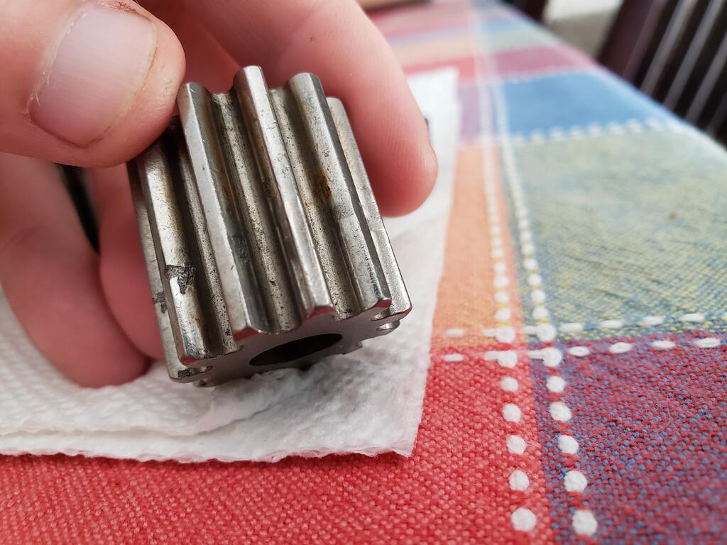

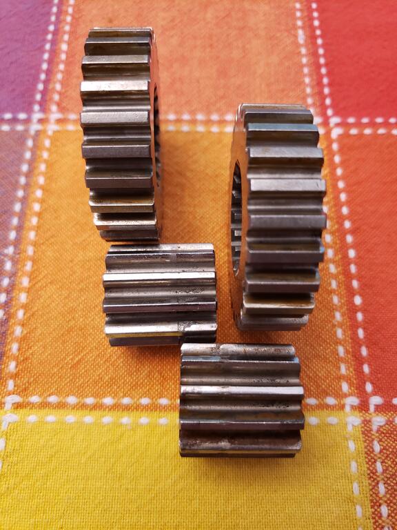

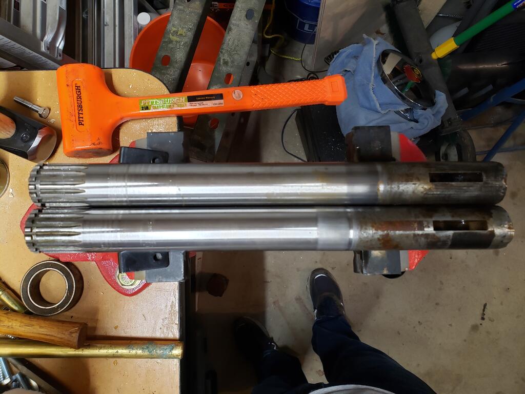

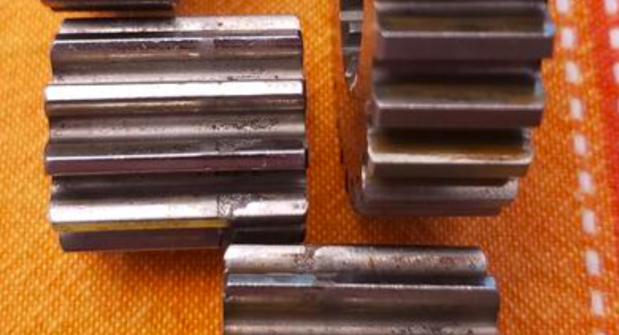

71_Bronco 1,072 #17 Posted May 24, 2020 (edited) Okay, got the differential apart. Things are really screwy with this transmission. First off, the axles were the same length, as expected. However, they both measured 11-5/8" long, meaning both are the wrong axle. The gears on the axles, retained by the snap ring (part 7197) are in mint shape, no wear. The 10 differential pinion gears are in pretty decent shape. All of them have the same wear (shown in picture below). Not sure if these are usable or if I should buy a new set. All of them have the same wear, but vary from tooth-to-tooth and gear-to-gear. The picture shows about the worst wear. The aluminum end caps are perfect, the 2 steel bodies are perfect (that hold the pinion gears) and the differential outer ring gear is perfect too. The pinion cylinder spring (part number 7235) has some wear (pictured), not sure if this is usable or if I should order one from WHP&M. Edited May 24, 2020 by 71_Bronco 1 Share this post Link to post Share on other sites
bc.gold 3,406 #18 Posted May 25, 2020 (edited) 8 hours ago, 71_Bronco said: The picture shows about the worst wear. Not able to see the number of teeth, looks like 12, if this gear was mated to a even numbered tooth count then the worn spot would fall into the same positions. For example a bad tooth on your 12 mated to a 36 tooth gear would strike home three times per revolution, if either gear had an odd number of teeth the damaged tooth would move to an advanced or trailing position. Had both gears an even amount of teeth their mating position should have been marked so they could have been installed as removed into the same wear pattern. Edited May 25, 2020 by bcgold Share this post Link to post Share on other sites
71_Bronco 1,072 #19 Posted May 25, 2020 10 hours ago, bcgold said: Not able to see the number of teeth, looks like 12, if this gear was mated to a even numbered tooth count then the worn spot would fall into the same positions. For example a bad tooth on your 12 mated to a 36 tooth gear would strike home three times per revolution, if either gear had an odd number of teeth the damaged tooth would move to an advanced or trailing position. Had both gears an even amount of teeth their mating position should have been marked so they could have been installed as removed into the same wear pattern. Pinion gears are 11 teeth each, and the mating gears are 25 teeth I think. All 10 pinion gears have the same wear spot, on all teeth. Both of the other gears that mount on the axles have no wear. I think the wear is from the pinion gears turning on themselves as they only mesh with eachother with a little bit of contact area. Share this post Link to post Share on other sites
bc.gold 3,406 #20 Posted May 25, 2020 (edited) Same number of tooth damage indicates contact damage caused by one of two things, someone did a bit of welding repair elsewhere on the tractor ( Electrical Corrosion ) or the damage was caused by a very long lay up and what were seeing is electrolysis corrosion. Here;s a page by NSK explanation with images of types of bearing failures. Edited May 25, 2020 by bcgold 1 Share this post Link to post Share on other sites
pfrederi 18,643 #21 Posted May 25, 2020 I believe the 11-5/8" axles are from newer 8 speeds. Share this post Link to post Share on other sites
71_Bronco 1,072 #22 Posted May 25, 2020 34 minutes ago, bcgold said: Same number of tooth damage indicates contact damage caused by one of two things, someone did a bit of welding repair elsewhere on the tractor ( Electrical Corrosion ) or the damage was caused by a very long lay up and what were seeing is electrolysis corrosion. Here;s a page by NSK explanation with images of types of bearing failures. Based on that link, it looks most like the flaking, which is generally caused by excessive load. Attached is a picture of how the gears sit in the differential and how the mesh, vs the wear patterns. I'm wondering if I can flip the pinion gears around and re-install. This is just a guess though, as I didn't make note of how they were positioned in the differential when I took it apart. Share this post Link to post Share on other sites
pfrederi 18,643 #23 Posted May 25, 2020 The bigger gears from the axle are the correct ones for a Limited slip differential. The have a different tooth shape and pattern than the gears from normal differential. I would attribute the damage to corrosion or foreign object not mismatch Share this post Link to post Share on other sites
bc.gold 3,406 #24 Posted May 25, 2020 (edited) I think were seeing electrolysis corrosion the damage most occurred near the ends of the teeth, as the transmission lubricant aged and contaminated with moisture it became acidic. i would suggest replacing those gears and all the bearings also add a sacrificial anode to take care of errant currents. For transmission lube every year or so do a frying pan sizzle test, a drop of oil into a hot pan will sizzle if any moisture is present, replace the lubricant. If the shift boot is bad replace it as well. Edited May 25, 2020 by bcgold Share this post Link to post Share on other sites
stevasaurus 23,274 #25 Posted May 25, 2020 The 11 5/8" axles are part number 102764 and can be found in the #5091 8 speed transmission...+ some others. The 12' axle is part #7202 and the 11 1/4" is #7203 for the #5060 transmission. You can mix and match those pistons anyway you want...the are the same on both ends. I didn't see anything I would not re-use. I suggest the PO welded the short axles to the hubs just because they were short. I would bet Lincoln at A-Z would have used axles. The aluminum end plates does make this transmission a #5060. Share this post Link to post Share on other sites
