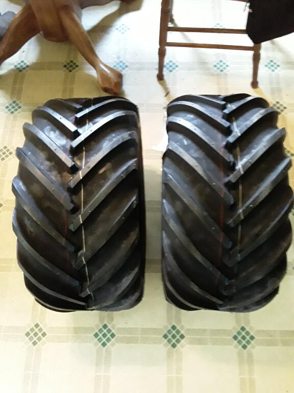

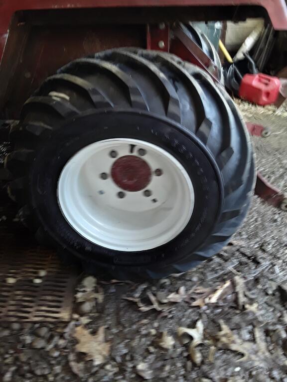

Stike 204 #1 Posted May 10, 2020 Broke down and got some new deestone D405 26x12-12 tires for my D160 and for the price I really like them, though they do seem to run a little bit smaller but just barely. Going through the woods in my back yard is about 14 acres of muddy rutted trails and the D goes through like it's on tracks now 100% better than the old turfs. 5 3 2 Share this post Link to post Share on other sites

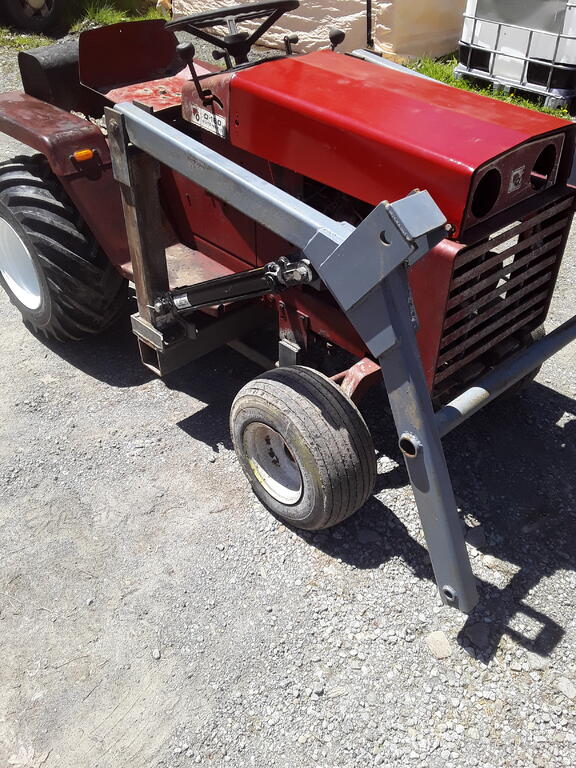

Stike 204 #5 Posted May 13, 2020 Thank for the replies, It has the kohler 16hp single k341s, my dedicated snow plow tractor is a c175 with turfs and chains and it works great. One day I will have a brinley plow but for now I'm working on a loader as time and funds allow. Share this post Link to post Share on other sites

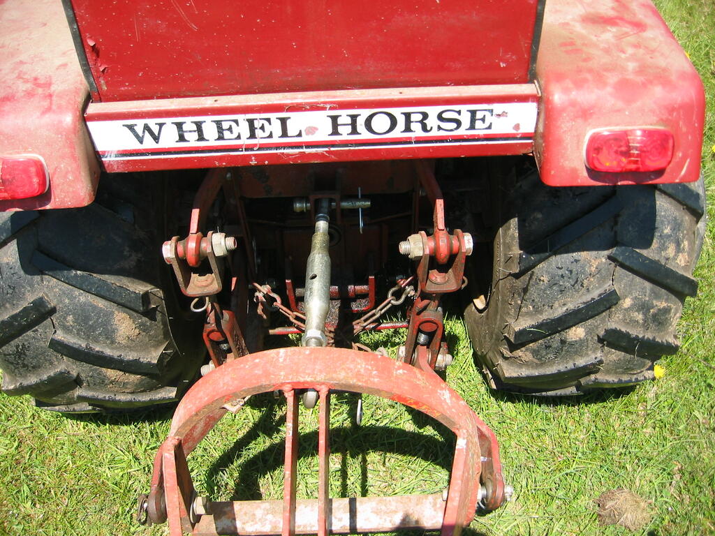

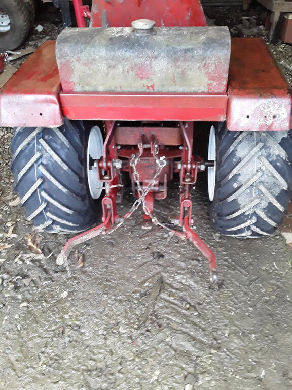

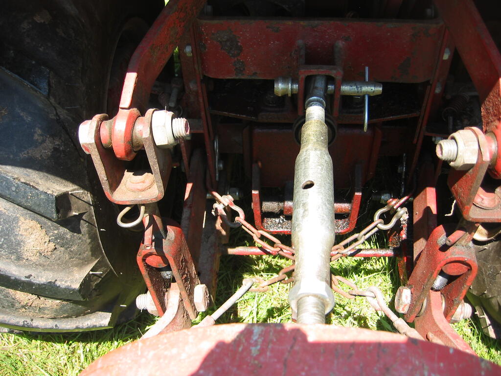

pfrederi 20,870 #6 Posted May 13, 2020 Nice Ags have them on my D200 work really well (going forward ) FYI You should change the mounting of the chains on the three point. The mount to the front of the draft arms. not the top link bracket. Share this post Link to post Share on other sites
Stike 204 #7 Posted May 13, 2020 @pfrederi thanks, I haven't messed with the 3 point much as I need new hydraulic lines and this came from po this way, the new lines are on the way from wheel horse parts and more and should be here Saturday. I'm looking forward to using it, I built a 3 point for my C195 a few years ago and love it, now having an original wheel horse 3 point I see what I did wrong with mine, made the draft arms 2 inches too long but still works good. Share this post Link to post Share on other sites
