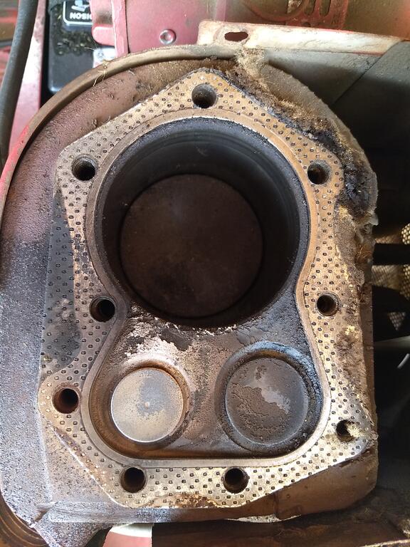

sdhdcouple 133 #14 Posted May 10, 2020 (edited) Guessing it's the connecting rod it will not let me load video but head is off, turns over and valves open and close but piston stays still. Was able to move the piston down with a one finger push. Didn't seam stuck at all. I felt the cylinder walls, no scratches that i can see or feel. will try to upload the video Edited May 10, 2020 by sdhdcouple 1 1 Share this post Link to post Share on other sites

richmondred01 2,393 #17 Posted May 10, 2020 Far from dead. bore, grind the crank, grind valve seats, new guides, piston, rod, rings, bearings and seals. good to go another 50 years with proper maintenance. I done hundreds of these engines that certainly looked worse. just check the cylinder apron to make sure when the rod broke loose it didn’t crack it. 5 Share this post Link to post Share on other sites
Sam Pasch 450 #18 Posted May 10, 2020 (edited) I think its safe to say that it is broken. I think a new rod should fix it though. Edited May 10, 2020 by Sam Pasch 3 Share this post Link to post Share on other sites
Pullstart 71,521 #19 Posted May 10, 2020 Just listen to the guidance of machining the crank at the very least! It is very important that it is perfectly round before reassembly... ask me how I know! 1 Share this post Link to post Share on other sites
richmondred01 2,393 #20 Posted May 10, 2020 Indeed, a set of rings or a new rod will fix nothing. The engine must be in spec or machined or the same issue will arise within a few hours of use. 1 Share this post Link to post Share on other sites

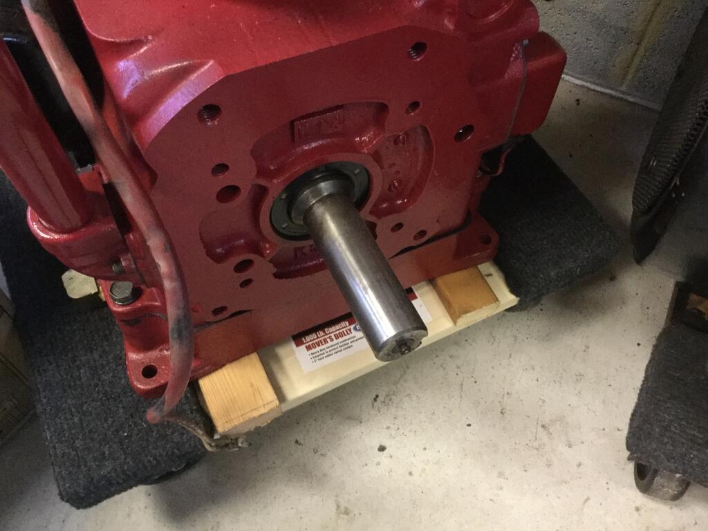

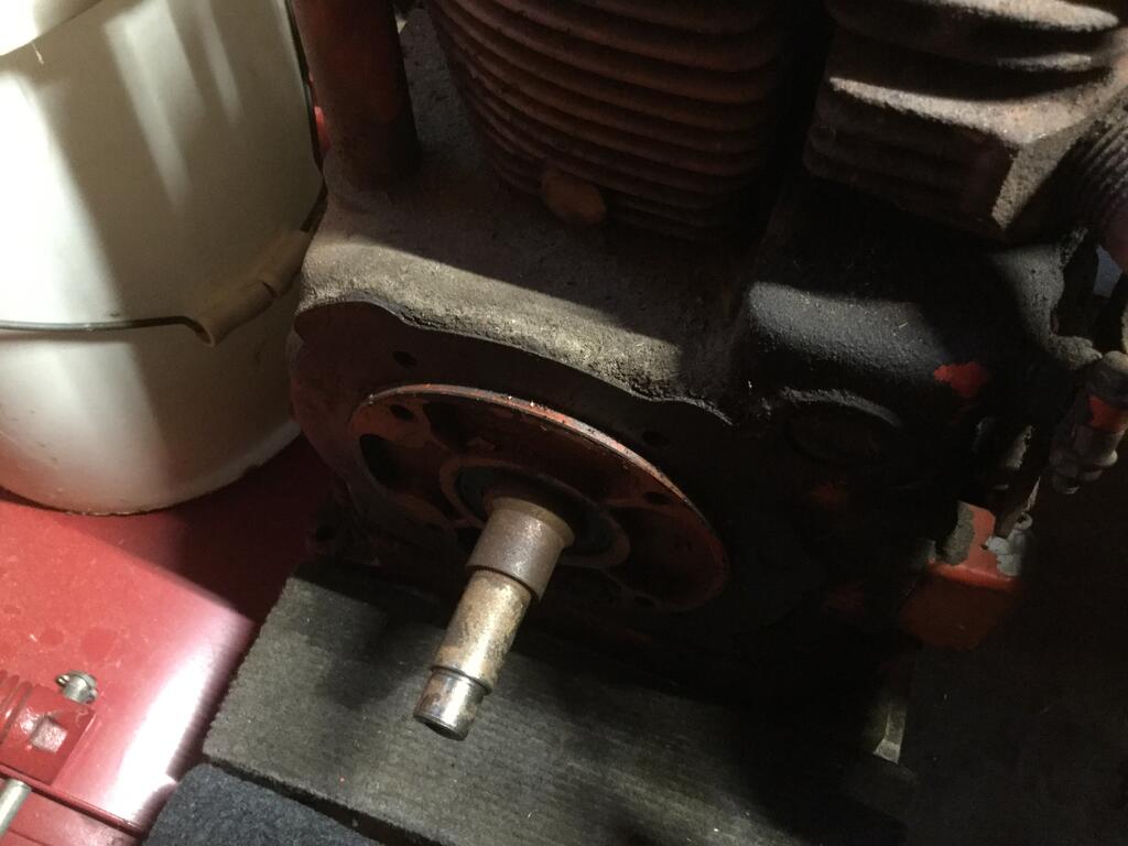

sdhdcouple 133 #21 Posted May 10, 2020 well i got lucky, farmer buddy seen me out door working on the tractor stopped by to BS. He knew someone who collected old Gravely tractor, called him and he had a k301 block that had been rebuilt and with a turned crank, matching rod, new bearings but he had no piston. or the rest the motor parts. So he sold it to me cheap, i think. i will get some pictures 2 Share this post Link to post Share on other sites
richmondred01 2,393 #22 Posted May 10, 2020 (edited) Gravely has a different PTO bolt pattern and the crankshafts aren’t 1 and 1/8. Gravely utilized and embossed lip machined into the pto side of the block. 1st photo gravely 2nd wheel horse Edited May 10, 2020 by richmondred01 1 Share this post Link to post Share on other sites
Pullstart 71,521 #23 Posted May 11, 2020 You should be able to get a sleeve and cut it to length to take up the difference on your crank! 2 Share this post Link to post Share on other sites
richmondred01 2,393 #24 Posted May 11, 2020 5 minutes ago, pullstart said: You should be able to get a sleeve and cut it to length to take up the difference on your crank! Thats true you can go that way and fabricate half moon shims for the lip issue and reposition the holes on the pto bracket. Share this post Link to post Share on other sites
