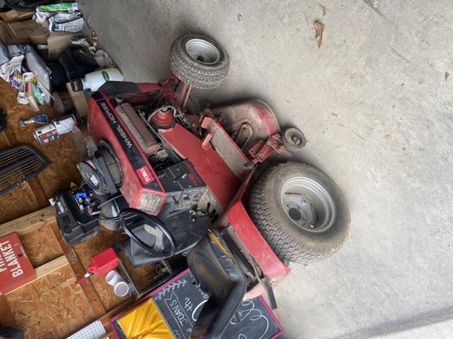

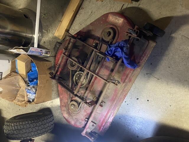

TSingleton 1 #1 Posted May 7, 2020 Need help identifying a model number for my deck on my 1994 416-8. Model 73420. Deck roughly measures 36-37” outside to outside. According to the attachment chart the model number should be a 78305. But on parts tree it shows that model number for a 300 series. I’ll hopefully post pictures. I’m Going to need all 3 belts. Drive and both deck belts. Then spindle bearings, blades, and deck wheels. Any part numbers would help. Was 36” a common deck for a 416-8? Seems little. Thanks in advance! Share this post Link to post Share on other sites

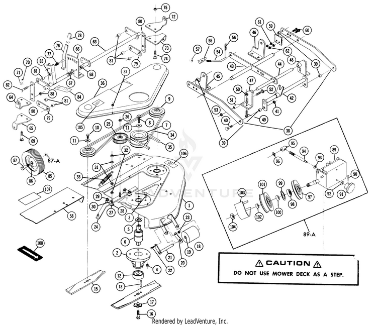

daveoman1966 3,884 #2 Posted May 7, 2020 (edited) The deck you show is a much older model using the "Double-D" spindle / pulley / blade configuration. A similar model is 5-0602 from 1975 and here is a schematic of that model . The spindles(2) are cast iron and the spindle bearings (6) are one-piecd design that are pressed into the spindle. Bearings (6) are # 103119 (need 3 of them) and you'll need a press to install them. Fo to this website and enter 5-0602 as the model number, then follow the schematis to show belt #s and other stuff.. NOTE... the bearing #103119 is on Ebay in sets of 3...usually $70 bux or so...maybe less. . https://www.psep1.biz/arinet.asp?aribrand=TO#/Toro_Consumer/5-0622%2c_36"_Rear_Discharge_Mower%2c_1975/Parts_List_For_Rotary_Mower/cf4e6712-0550-4bfc-ba6b-2a880cf09c9a/5589b906-c02f-43b4-ac7b-14b911c51387 Edited May 7, 2020 by daveoman1966 2 Share this post Link to post Share on other sites
TSingleton 1 #3 Posted May 7, 2020 @daveoman1966 thank you for the reply. I was worried the deck did not fit the same era of the tractor. My grandfather bought the mower new and has now passed on so I don’t know the whole story of when the deck got swapped out. Only has 550hrs on it. I might look around on here for a 42” Rd since this one is already needing some attention. Share this post Link to post Share on other sites
tom2p 2,396 #4 Posted May 7, 2020 (edited) yes - 36" deck is small for a 416 36" deck is small for 300 series - especially 312 and up and more so for a 400 - 500 series there are some that use 37" decks (with grass catcher or whatever) on their 300-400 series tractors - this deck might require the smaller 6" front wheels how much grass do you cut ? If not a small yard I would not put a lot of money into a small deck and instead would direct the money toward a larger deck a good Wheel Horse deck can cost a lot you can spend less for a deck - but realize the cost of the parts can add significantly ... Wheel Horse parts were engineered to last and therefore are not cheap Edited May 7, 2020 by tom2p 1 Share this post Link to post Share on other sites
