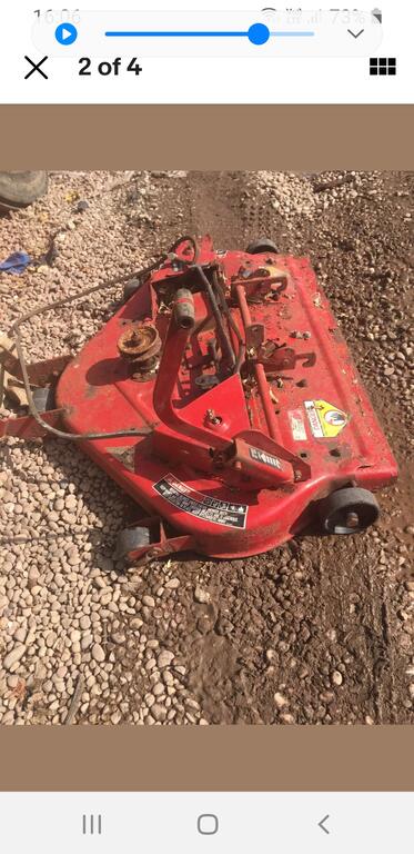

Mickwhitt 5,259 #1 Posted May 5, 2020 Hi all, My C125 came without a cutting deck, but I'd like to fit one some day. This one is on ebay. Will it be suitable, even to modify to a front mount? Share this post Link to post Share on other sites
stevasaurus 23,857 #2 Posted May 5, 2020 I might be mistaken, but that looks like it mounts on a GT with vertical shaft. If so, I don't know how many modifications are needed. Share this post Link to post Share on other sites

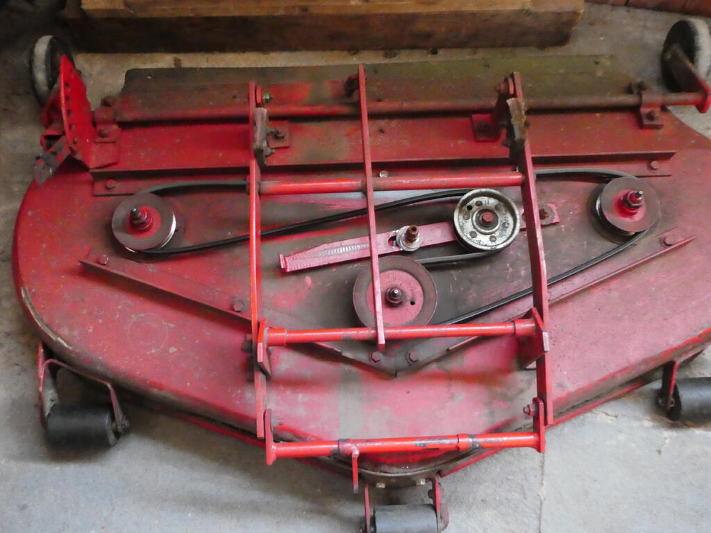

Stormin 9,988 #3 Posted May 5, 2020 (edited) This is what you need, Mick. This is a 42" rear discharge. A 32" is the same as are side discharge decks. you'll need front and centre tach-o-matics and a mule drive. BTW This deck hasn't got the cutter belt tension spring on. Edited May 5, 2020 by Stormin Share this post Link to post Share on other sites
peter lena 10,091 #4 Posted May 5, 2020 hello mick, i agree with stormin , this picture , even though its missing the spindle belt cover , is everything your picture is not. the lift frame on this is what you want to easily hook up on your model. mabey stormin knows where you might pick up such a deck. aside from a refresh , it would easily fit your horse, pete Share this post Link to post Share on other sites
Stormin 9,988 #5 Posted May 5, 2020 36 minutes ago, peter lena said: hello mick, i agree with stormin , this picture , even though its missing the spindle belt cover , is everything your picture is not. the lift frame on this is what you want to easily hook up on your model. mabey stormin knows where you might pick up such a deck. aside from a refresh , it would easily fit your horse, pete The two spindle covers are missing because I had to make a new top for that deck. Hence the angle iron stiffners. If I knew of another deck, I'd be grabbing it myself. I've been trying to find a decent side discharge for some time. The trouble over here, especially in the North, the grass is seldom dry. Some people just neglect to clean the underneath of decks after use and then the decks rot out. I take mine off after every mowing session and give it a good clean down. 1 Share this post Link to post Share on other sites

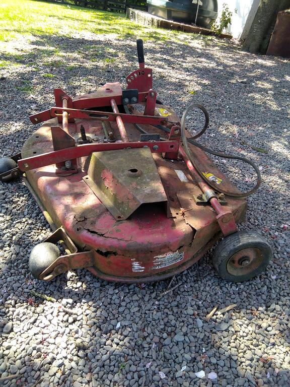

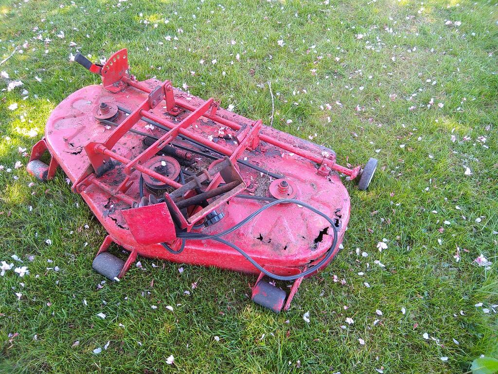

Dan.gerous 2,696 #6 Posted May 5, 2020 (edited) 33 minutes ago, Stormin said: The two spindle covers are missing because I had to make a new top for that deck. Hence the angle iron stiffners. If I knew of another deck, I'd be grabbing it myself. I've been trying to find a decent side discharge for some time. The trouble over here, especially in the North, the grass is seldom dry. Some people just neglect to clean the underneath of decks after use and then the decks rot out. I take mine off after every mowing session and give it a good clean down. I have two rusted out decks with my horses, just to confirm that they all get abused! There is a guy on eBay who rebuilds them and you reuse your fittings where possible. Tempted to get that done to one of them when I have spare cash for such luxuries. Edited May 5, 2020 by Dan.gerous 1 Share this post Link to post Share on other sites

Dan.gerous 2,696 #20 Posted May 6, 2020 3 hours ago, Stormin said: For a start, you need an old one for a template. When I made the replacement top, I cut off the old top which was used for positioning holes. Tools were a jigsaw, arc welder and electric drill. Found an early topic I did. What you did with your deck seems the best option, will check mine and see if the sides are good on one, I know a guy that can weld if it's too much for me. He did all the farm welding anyway. @Mickwhitt you can have whichever one is left over if it's any use to you for parts, I'm always driving up and down the country so could drop it off some day. Share this post Link to post Share on other sites
Mickwhitt 5,259 #21 Posted May 6, 2020 That would be fantastic. I can do any amount of modification or fabrication. Just need a unit to work from. That's why I thought the ebay one might be a start. Mick Share this post Link to post Share on other sites
Lee1977 7,805 #22 Posted May 6, 2020 42 minutes ago, Mickwhitt said: That would be fantastic. I can do any amount of modification or fabrication. Just need a unit to work from. That's why I thought the ebay one might be a start. Mick You need the mounting hardware for a garden tractor. That 36" deck looks the same and Wheel Horse didn't change anything they didn't have to. Quite a few have modified the lawn tractor decks, but they had a similar garden tractor deck with all the parts needed to make it work. Share this post Link to post Share on other sites
Dan.gerous 2,696 #23 Posted May 6, 2020 1 hour ago, Mickwhitt said: That would be fantastic. I can do any amount of modification or fabrication. Just need a unit to work from. That's why I thought the ebay one might be a start. Mick No problem Mick, will arrange it next time I'm heading down your way. Like you say, it gives you something to work with 🙂 2 Share this post Link to post Share on other sites
Dan.gerous 2,696 #24 Posted May 6, 2020 I will probably keep the darker looking one, but they both have all the fittings and I still use the lighter coloured one. I think I also have a spare front pulley that you can have with it. Would mean just fabricating the casing and you would be ready to go. The one for you also needs the pulley guards making up as it didn't come with any. We also got two sheep today so probably won't need the mower anyway 😁 1 Share this post Link to post Share on other sites
Mickwhitt 5,259 #25 Posted May 7, 2020 Loving the sheep! Eco friendly mowing lol. I watched the one on ebay and it ended at £137 Too much to take a punt on. Mick 1 Share this post Link to post Share on other sites
