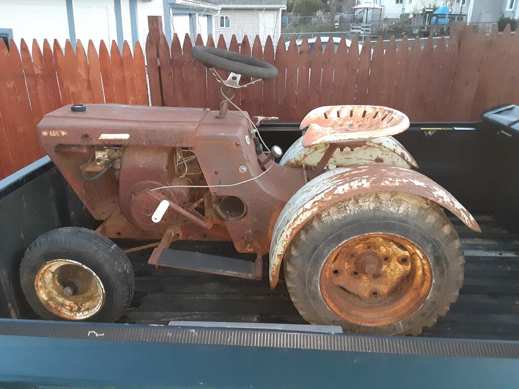

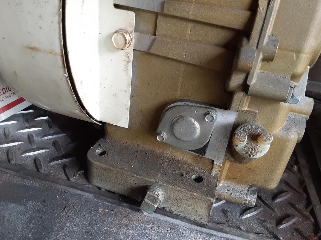

953 nut 68,912 #126 Posted May 18, 2020 9 hours ago, D_Mac said: I was looking at the original engine, it has compression, but it most likely will need a new carb, the gas tank was like swiss cheese I looked online for another and no luck. Then I would need to mount a new one somewhere, maybe new points.. ect. It does have electric start but I dont even know if it works. Has these glass fuses mounted on the engine, I never seen anything like that before. That is a Lauson Engine like the ones used on the Suburban 550 and 551 models. The two upright thingies below the fuse are diodes that take the AC generated by the engine alternator and converts (rectifies) it to DC to charge the battery. If you don't decide to use that engine I'm sure someone on here would love to have it. 1 1 Share this post Link to post Share on other sites

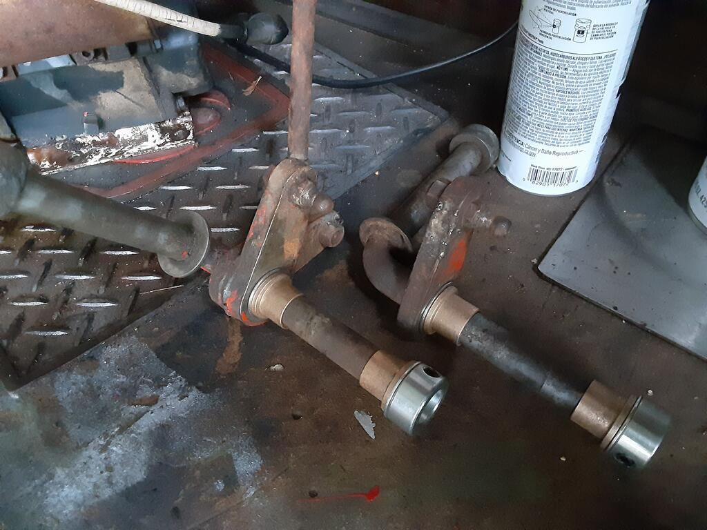

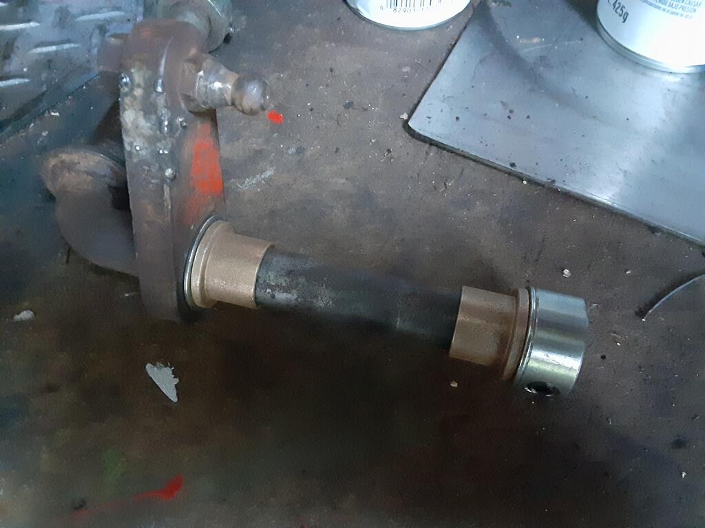

D_Mac 9,339 #131 Posted May 18, 2020 Well I went back to my trustee hardware store again and asked about the bushing and guess what ..... BINGO. Must be the other kid didnt know what a bushing was. I am still working on the tie rod. Cant get the ends off. Is one right hand thread and the other end left ? Im happy i got the bushings, washers, and the shaft collars. Looking at the 8hp Briggs. Next to the oil cap, is that where you would put the opening for the Pulse fuel pump? My garage I cant walk around to even do anything untill it stops raining. Paint on parts drying all over. The chain should come tomorrow. Put that on then I can get some body parts on. 5 Share this post Link to post Share on other sites

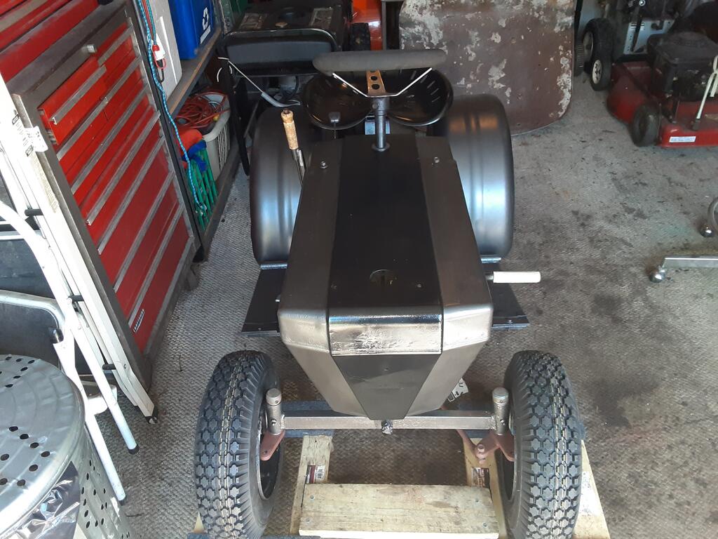

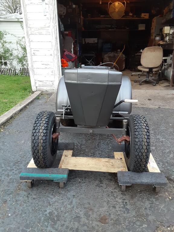

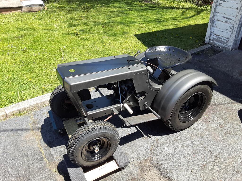

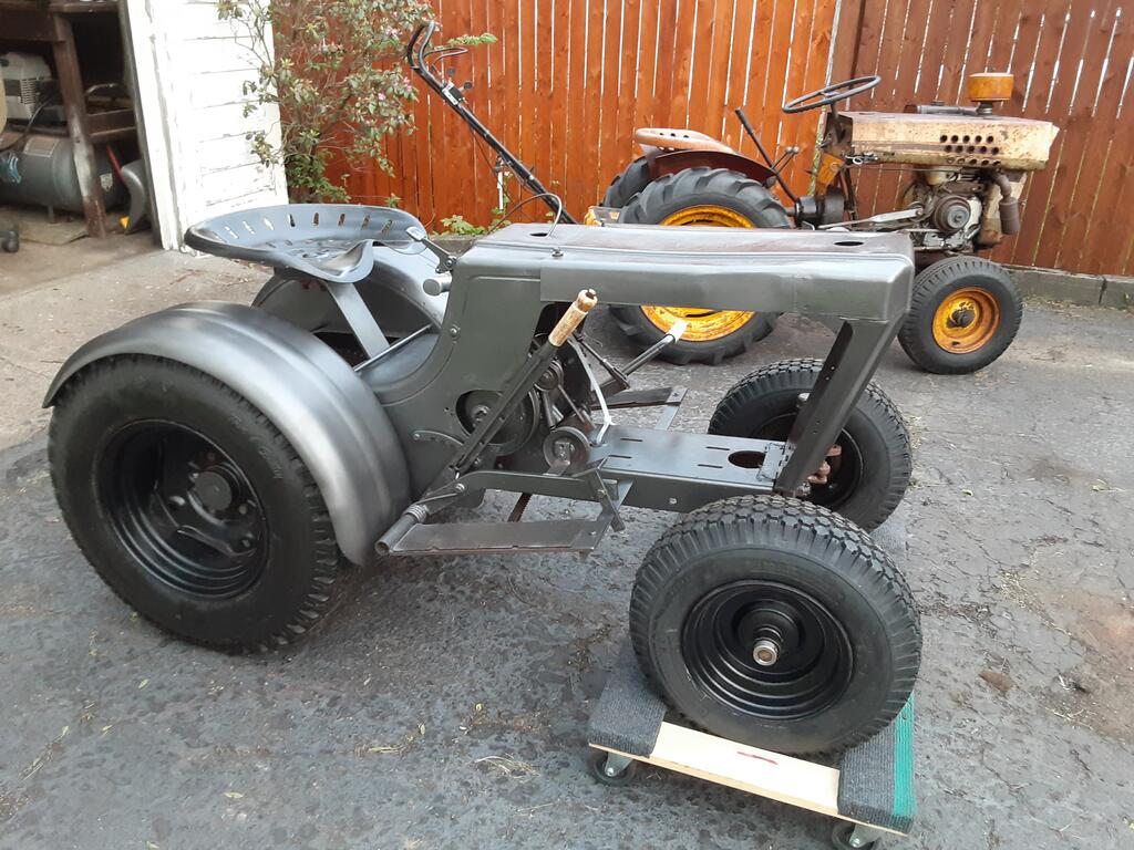

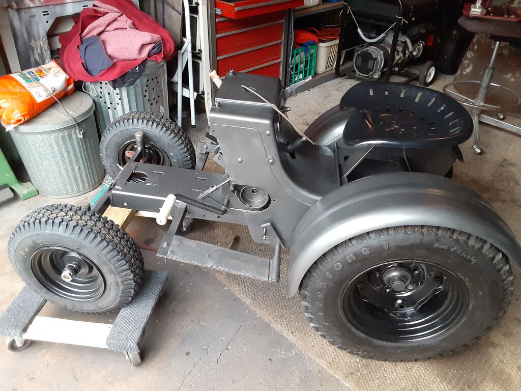

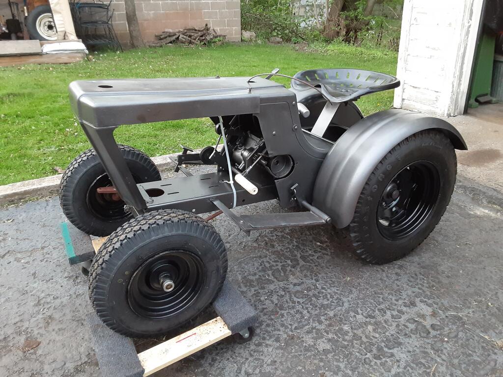

D_Mac 9,339 #132 Posted May 20, 2020 (edited) All day working on the Lambert. Try to order a tie rod from @76c12091520h I havent received a reply yet. Got it pretty much back together except for the steering wheel, rack and pinion, tie rod, and yes the engine. I ran out of gas. I will see if the Briggs will fit in there tomorrow. If it does I will begin working on it. I need to find a tie rod as I discovered a crack in it when I removed the ends today. Put the rest of the front end together... bushings fit like a glove. The chain came in the mail so I installed them both.Then I began putting it together. Wish I had some help, the paint got all scratched up but I will touch it up when done. Seems this thread has lost interest but I will keep posting, maybe your just looking at the pics. Edited May 20, 2020 by D_Mac 2 5 1 Share this post Link to post Share on other sites
76c12091520h 4,282 #133 Posted May 20, 2020 Sending pm now 1 Share this post Link to post Share on other sites
SylvanLakeWH 32,328 #134 Posted May 20, 2020 Looks beautiful! Nice work! 1 Share this post Link to post Share on other sites

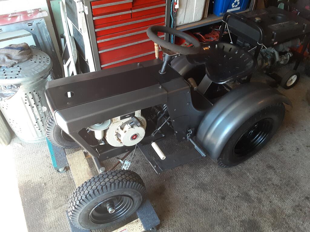

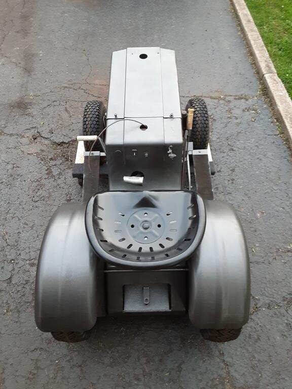

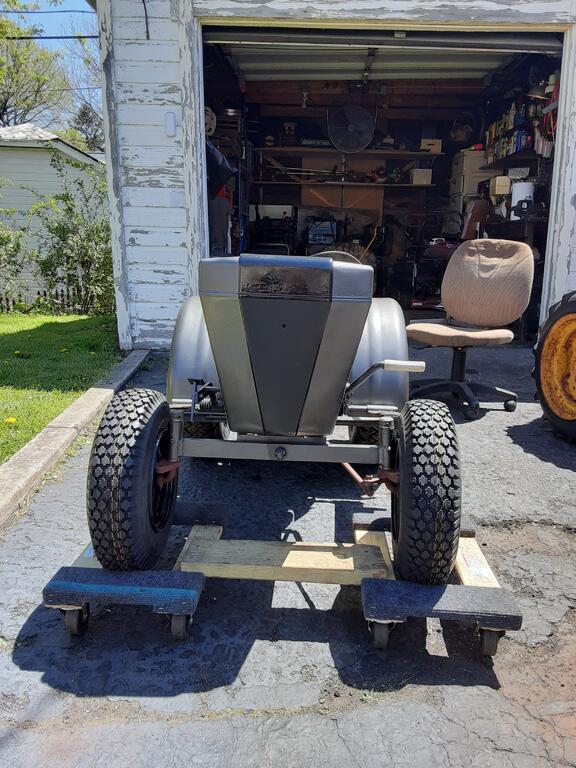

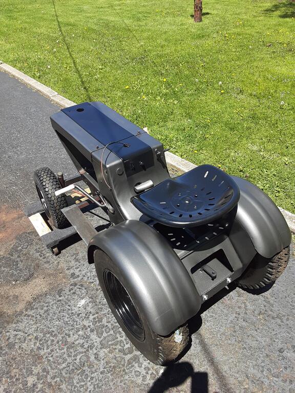

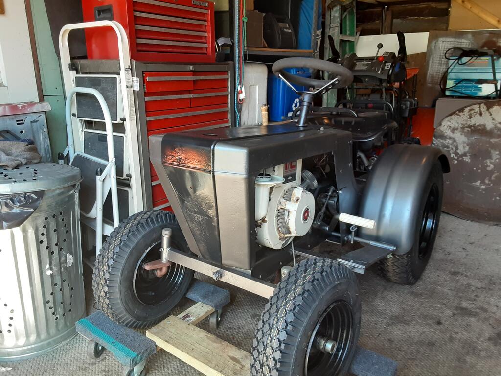

D_Mac 9,339 #139 Posted May 20, 2020 I ordered the tie rod from @76c12091520h He is going to make it and send it off for me. Today I finished up the paint work. Amazing how much effort is involved in painting it and how little effort it takes to scratch it. I dont have it in me to lay on any more coats. It will have to do. At this point I am stuck. Going to need some welding done. I am also going to need to drill out some mounting holes for the engine. It is just barely going to fit under the hood. I am going to try to get my cousins help on those things but will have to wait untill I get the tie rod. To hard to get it up and down ramps the way it is now. Most likely I am not going to install the mower deck as I cant free up the deck height locking button. Like the engine I will keep all the original stuff together. While the new engine was on the floor I sprayed a little starting fluid in the carb and one pull it fired up after sitting for 17 yrs The air cleaner and exhaust are super tight under the hood. May need to be modified. Gas tank will have to be mounted on side of hood. Not comfortable in drilling a hole in the engine. Anyways here it is mocked up. I dont plan on painting the engine. I plan on adding white or red pinstripe when its all together. 4 3 Share this post Link to post Share on other sites
WHNJ701 4,173 #140 Posted May 20, 2020 make up 4 spacers and use longer bolts if you have to raise the hood a little bit for clearance. 3 Share this post Link to post Share on other sites
oliver2-44 11,718 #141 Posted May 21, 2020 Looks great, keep up the good work. Share this post Link to post Share on other sites

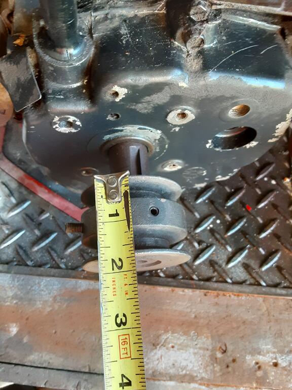

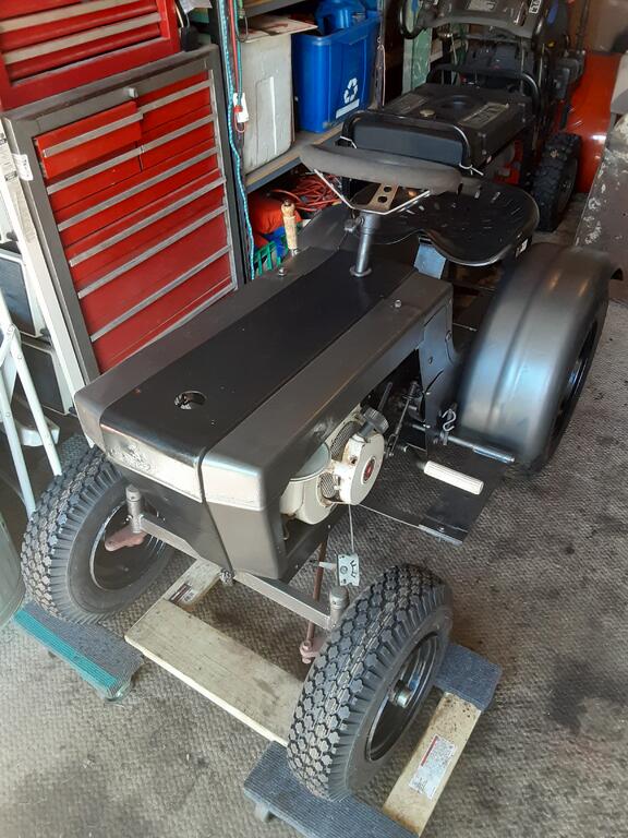

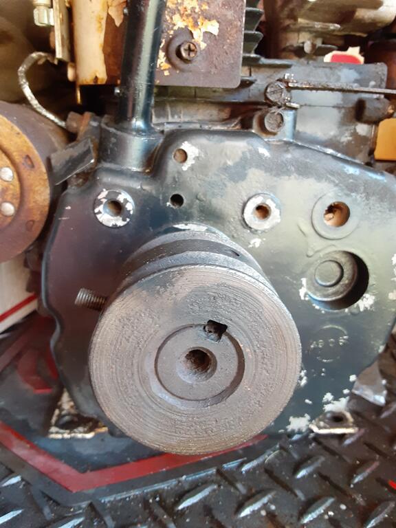

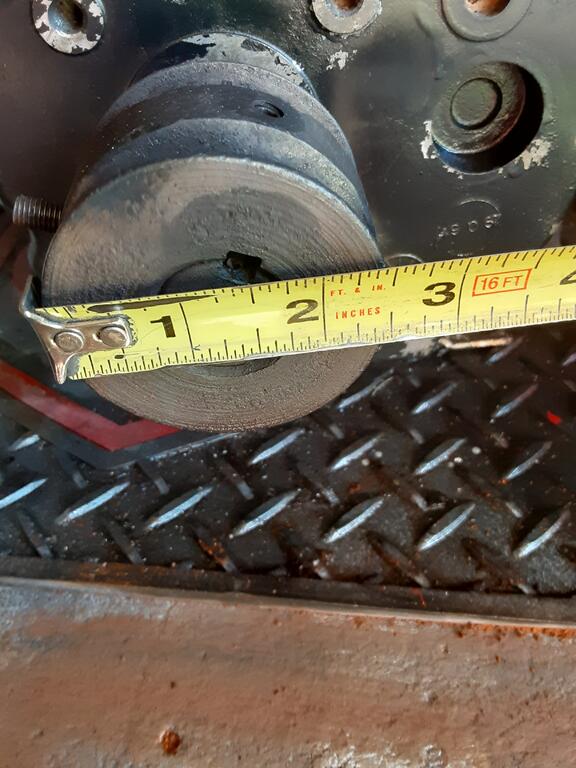

D_Mac 9,339 #144 Posted May 21, 2020 Well this is getting frustrating. I forgot to drain the ATF/Acetone out of the tranny and put the gasket on the case before I reassembled it all..... ugh..... Now I have been rolling around trying to figure out how the rack and pinion assembly goes back on. There seems to be a brace that went between the frame rails the holds the gear in place. It fell off when I took it apart but is it supposed to be welded in place? Is it suppose to be on an angle or straight across? I have to get this done before I can begin on trying to figure out the engine placement. I also cant get one of the set screws out off the old engine to pull the pulley off. I got one out but the second one isnt budging. I heated that thing with a little bernzamatic I been soaking it everyday it isnt coming out. Makes me think if I could even get the pulley off if it even does come loose. I really need help. I have never done anything like this before. Share this post Link to post Share on other sites
WHNJ701 4,173 #145 Posted May 21, 2020 Post a pic of the engine pulley Share this post Link to post Share on other sites
D_Mac 9,339 #146 Posted May 22, 2020 Gonna heat it up again tomorrow. I dont want to drill it because I cant retap it if i do. Share this post Link to post Share on other sites
WHNJ701 4,173 #147 Posted May 22, 2020 if your not running the mower, just buy a single groove pulley off ebay or something Share this post Link to post Share on other sites

squonk 48,010 #150 Posted May 23, 2020 Why do you need to get that pulley off? If you had a puller like this you could still get that pulley off even with the set screw still in it. I've done it many times on blower housings. Large plate goes behind the pulley and a nice even pull. If you decide you absolutely need to get that pulley off bring it to me Share this post Link to post Share on other sites
