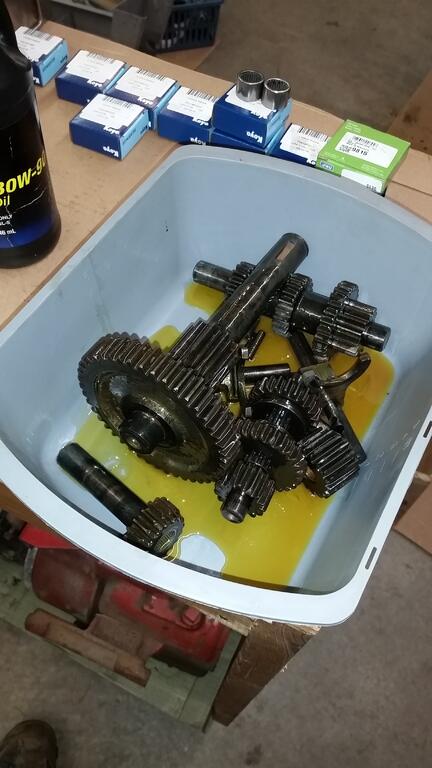

oliver2-44 11,718 #53 Posted May 8, 2020 I have a T92 that I need to put bearings in and the Powerking guys tell me there as easy or easier than Wheelhorse trannys to work on. Your tranny looks very salvageable. Compared to some WH rusty one I’ve been into 1 Share this post Link to post Share on other sites
D_Mac 9,339 #54 Posted May 8, 2020 2 minutes ago, oliver2-44 said: I have a T92 that I need to put bearings in and the Powerking guys tell me there as easy or easier than Wheelhorse trannys to work on. Your tranny looks very salvageable. Compared to some WH rusty one I’ve been into The last photos of the inside of the tranny show the good side. If i were to spin it the other side where it was exposed is way worse. Some teeth are chipped, pitted badly and thats just the top shaft and gears. I cant tell the condition of the bottom one as I cant see it. None of the gears are sliding. I believe I am in over my head. Share this post Link to post Share on other sites

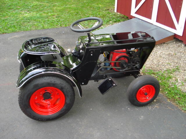

WHX?? 57,955 #58 Posted May 10, 2020 (edited) On 5/8/2020 at 2:26 PM, D_Mac said: believe I am in over my head. Bad news Mac we ain't gonna let you give up.. Worse come to worse we is gonna have you send that tranny to one of us.! I been thru alot worst and I know @Achto has been thru alot worse than me! Believe it or not this tranny is now in a working tractor... Edited May 10, 2020 by WHX24 1 3 1 Share this post Link to post Share on other sites
D_Mac 9,339 #59 Posted May 10, 2020 @WHX24 That is a very generous offer and very impressive how clean you got those gears. Mine might be a little worse off though. Some of the gears that I can see on mine have some chipped teeth. Not bad but few corners are chipped. There is a whole other shaft and set of gears I cant even see yet. Brings me to more questions... is the whole gear shot just cause a few chipped teeth? I say this for several reasons. One is the lack of money I can put into this project. Because of my cancer I havent worked in over a year no unemployment, no disability. I expected to spend some money on it but there has to be a limit.There are many other things its going to need. I believe I have a good engine ( Briggs 8hp ) and 2 rear tires for it. I need to find a front tie rod, bushings for front spindles, front tires, belts and chains. The tranny is the main issue. If I cant get it sorted there is no need to proceed any further. I might be stuck < just like the tranny> because after this soak I am not even sure how to get it apart to even try to figure out what it needs and then try to source the parts. I was hoping I could just free it up and use it as is. I realize that isnt in the cards now. That dosnt mean I am ready to quit, Im a fighter not a quitter. With help Im fighting through pancreatic and tonsil cancer. I might need some help on this but not ready to give up , may have to go on the back burner for awhile though. I appreciate the help and inspiration to press on with it. Share this post Link to post Share on other sites
WHX?? 57,955 #60 Posted May 10, 2020 I wouldn't worry too much about chipped teeth on the gears. This girl is most likely just going to be used for leisurely seat time up and down the driveway. Share this post Link to post Share on other sites
D_Mac 9,339 #61 Posted May 10, 2020 That about sums it up. I wasnt sure about the gears. In your photo I see some parts in boxes. Where did you get them? I see some parts for a T-92 on EBay... little pricey. Share this post Link to post Share on other sites

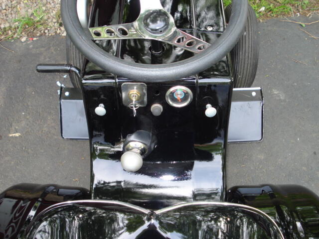

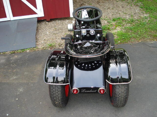

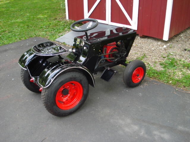

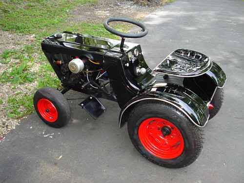

D_Mac 9,339 #62 Posted May 10, 2020 (edited) Well just came back in from messing with this thing again. I drained the vinegar out. I didnt see much difference. I grabbed a hold of the big pully on the right hand side and tried rocking it back and forth. Well it busted loose. I am able to spin both of the " shafts ". Calling them shafts because I dont know the actual name for them. The gears and shafts all spin but I still cant get the gears to move up and down on the shafts. I tried giving them a gentle tap but so far they are not budging. I did find photos of one that I think looks very cool. I like how they closed off the rear of it and added the rear lights. Edited May 10, 2020 by D_Mac 3 1 Share this post Link to post Share on other sites

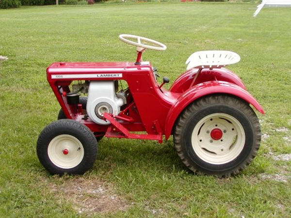

D_Mac 9,339 #65 Posted May 11, 2020 Went and checked on it this morning and tried shifting it....... no luck. Gave the shafts a quarter turn. I will continue this for a couple days. If they dont free up I will get serious. Maybe if I try heating them with a torch and tapping a little harder. I hate waiting but its freezing outside. I just sit now and fantasize about what colors I would paint it if I can get it functioning. I like the black one but I know how we all love Red. 3 Share this post Link to post Share on other sites
