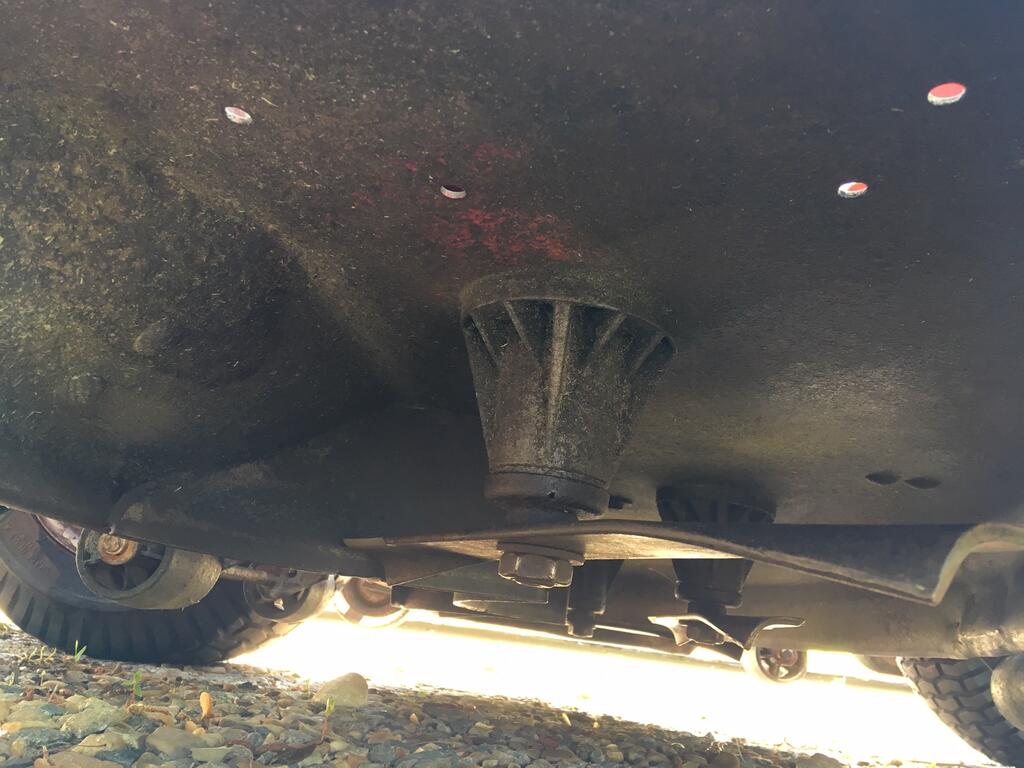

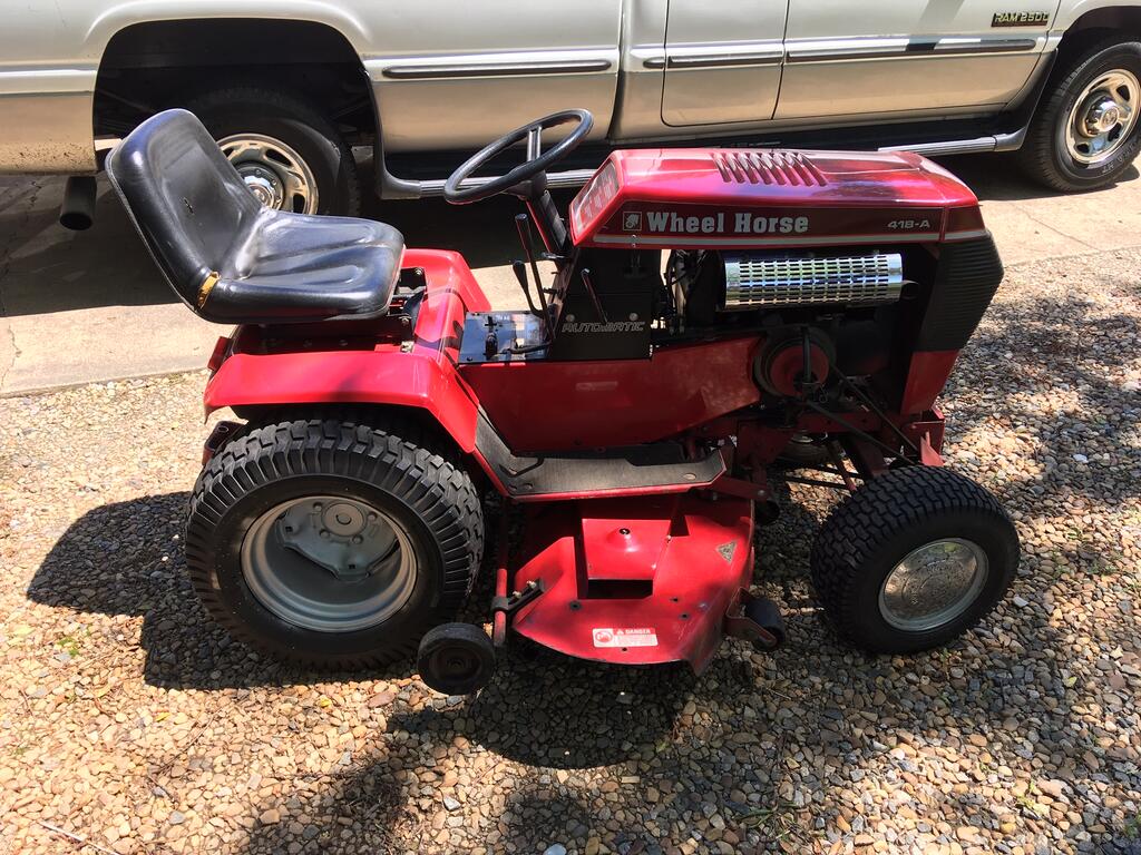

Tgalo 128 #1 Posted May 2, 2020 Pick up a 418 with a 42" snow blower last weekend. Farley low hours and very well kept. The guy said he didn't like the way it mowed, well I found out why when I looked under the deck... See pic 4 5 2 1 Share this post Link to post Share on other sites
lynnmor 8,835 #2 Posted May 2, 2020 (edited) I bought a low hour machine from a guy that didn't like the way it cut as well. After I mounted the deck correctly, leveled it, set the transport height and put the belt in the right groove, it mowed just fine. That's the way to buy them, many owners don't know how to treat horses. Edited May 2, 2020 by lynnmor 2 3 Share this post Link to post Share on other sites
c-series don 11,954 #3 Posted May 2, 2020 That’s a nice 418 ! I bought my commando 8 from a guy that said he didn’t like the way it cut. I got it home jacked it up and quickly realized that the blades were on backwards. It has two counter rotating blades so I switched them and it cut beautifully ! 2 1 Share this post Link to post Share on other sites
peter lena 9,896 #4 Posted May 2, 2020 bought a like new 42 " rd deck a few years ago , owner said , it was a poor cutter , he had the wrong pto drive belt on it , cuts like a champ , pete 2 Share this post Link to post Share on other sites
Sam Pasch 450 #5 Posted May 2, 2020 1 hour ago, Tgalo said: Pick up a 418 with a 42" snow blower last weekend. Farley low hours and very well kept. The guy said he didn't like the way it mowed, well I found out why when I looked under the deck... See pic Hmmm. The blades definitely aren't on upside down. Wonder why it didn't work.😂 Share this post Link to post Share on other sites
Irv 115 #6 Posted May 2, 2020 Blades upside down! I bought a 518 like that a few years back. 1 Share this post Link to post Share on other sites
