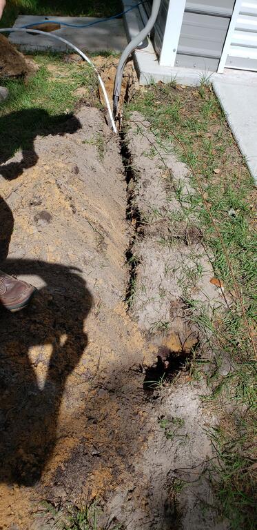

Zeek 2,299 #2 Posted May 2, 2020 (edited) I just ran 100' of half-inch PEX from my house to my garage. I live in FL. It's direct buried about 18". Works great and is very easy to work with. I threw it in when I had the ditch open for the electric. I did not use 3/4" because I only have one faucet draw at a time - pressure/flow same as rest of house. 3/4" is only needed for multiple draws from same feeder (shower/dishwasher running at same time from same feeder line). I got the best price here on eBay. I paid $26.67 last fall. This seller is out of stock and the price has increased, but you can get it elsewhere cheap. Once you have the fittings, cutter and crimper (you can get a kit) you are good to go. I used this crimper and this cutter. Edited May 2, 2020 by Zeek 1 1 Share this post Link to post Share on other sites
