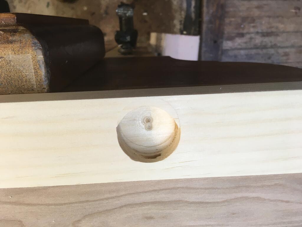

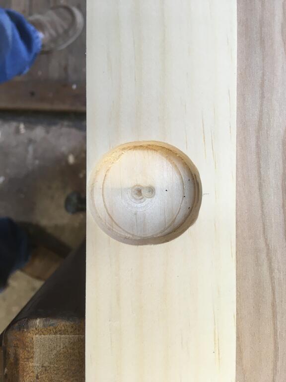

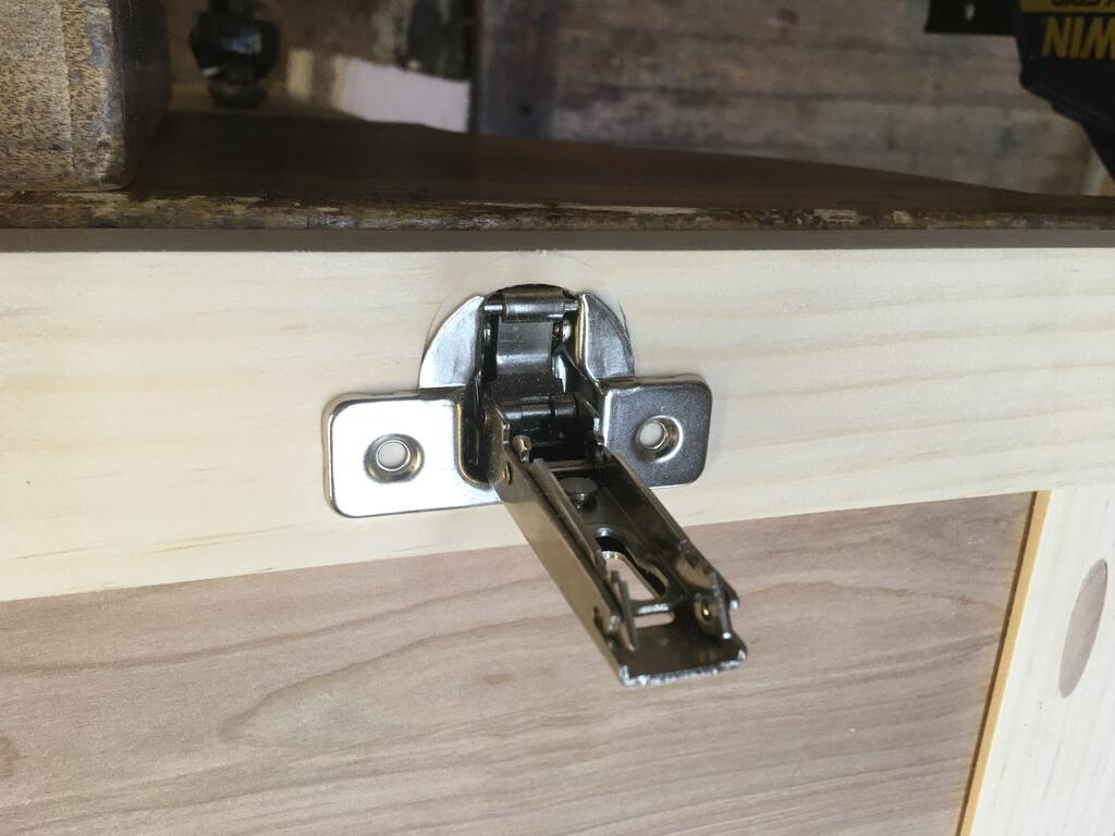

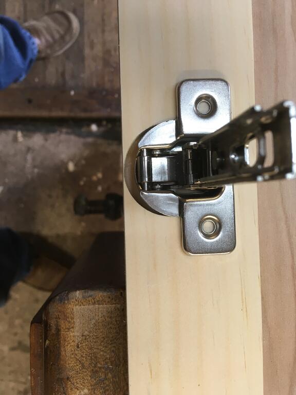

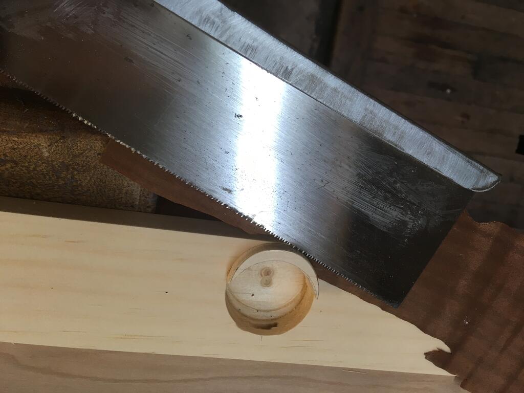

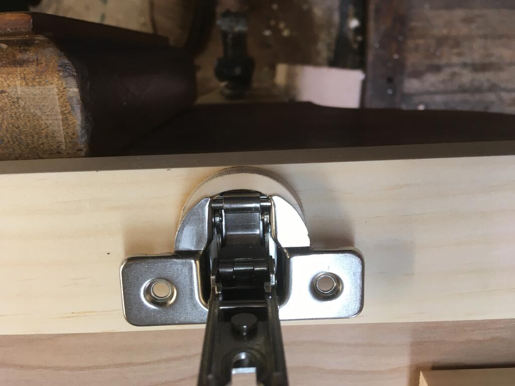

formariz 12,359 #1 Posted May 1, 2020 Someone made the comment to me once that it was amazing I never made mistakes in my work. That of course could not be any further from the truth, hence my answer that in reality I make so many that I became really good at not only finding them quickly but also quite adept at fixing them. As a example here is the latest one which is unfortunately a common occurrence when working alone and trying to balance an seven foot long door on drill press. Door just was not against fence and hinge hole was 3/16” off just about coming out back 1 8 Share this post Link to post Share on other sites

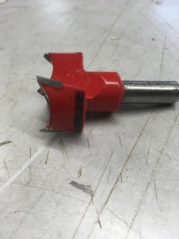

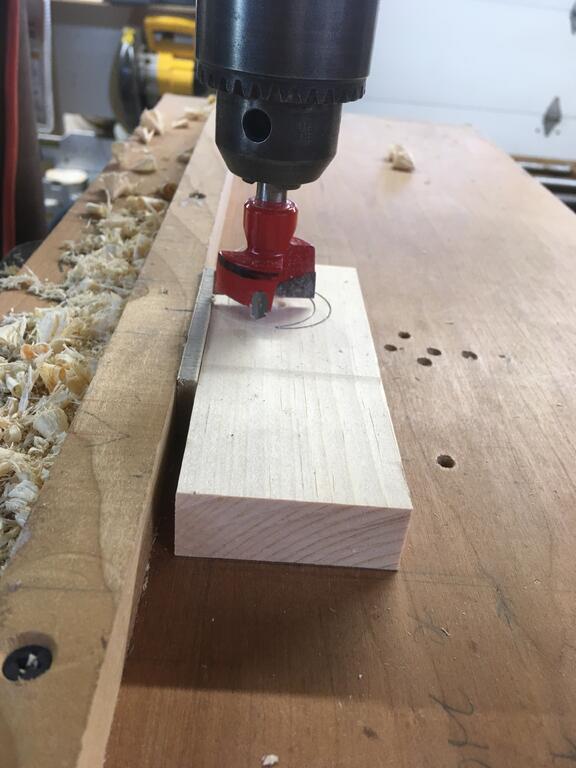

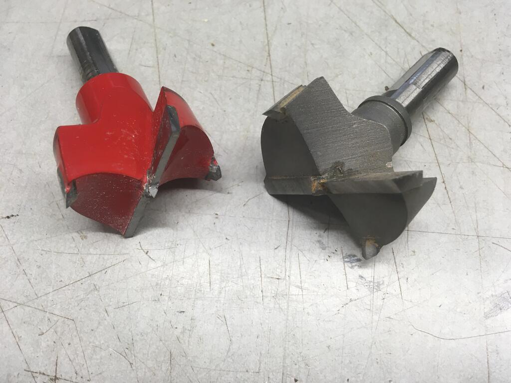

wh500special 2,396 #13 Posted May 2, 2020 That’s a great fix. I’ll have to remember that one for the next time I drop a hole in the wrong spot. I’ve noticed that hobbyist woodworkers - myself included - tend to go out of our way to point out our mistakes to others. Most of the time, they would have never noticed them. Hopefully you professionals are better at keeping secrets! Is that forstner a router bit you have chucked in the DP? I’ve not tried that. Steve 1 Share this post Link to post Share on other sites
formariz 12,359 #14 Posted May 2, 2020 (edited) 19 hours ago, pullstart said: I make it a habit to point out my mistakes to my girls. It shows them that it’s ok to get on with it, take care of the problem and move on with the day. It’s ok to try and fail, it’s not ok to never try in the first place for the fear of failure. Great attitude. Specially when dealing with children. I see so many children discouraged from being unsuccessful at something and even worse not trying again because a mistake was made fun of, or they were ridiculed by a parent or adult. We should always tell them that the mistakes are just another step in the learning process. It will build their self confidence and self esteem for the rest of their lives. I can honestly say that I have learned a lot from my mistakes, and I actually always look forwards to the challenge of fixing them when they happen. 13 hours ago, Mickwhitt said: I seldom work from a set plan or scheme of work. I prefer to do a bit of thinking, a little sketch and a lot of figuring as I go. Good point. I do pretty much the same. Although it starts with detailed drawings through out the process I am always improving it and using different ways of achieving the end result. 4 hours ago, wh500special said: Is that forstner a router bit you have chucked in the DP? I’ve not tried that. Its not a router bit. It is a dedicated bit made for production work in drilling hinge cups on the 32mm system. They are carbide tipped. Most times they are used on man made materials such as particle board or MDF. A regular bit like a Forstner would get dull really quick from that. That particular one has probably drilled a few thousand holes and still cuts quick and cleanly. They are also great at chip ejection. They are a real pleasure to use but not cheap running about $30.00 each depending on size and brand. Edited May 2, 2020 by formariz 1 Share this post Link to post Share on other sites

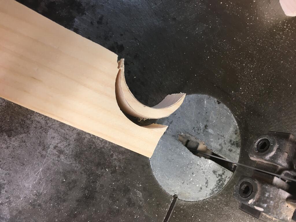

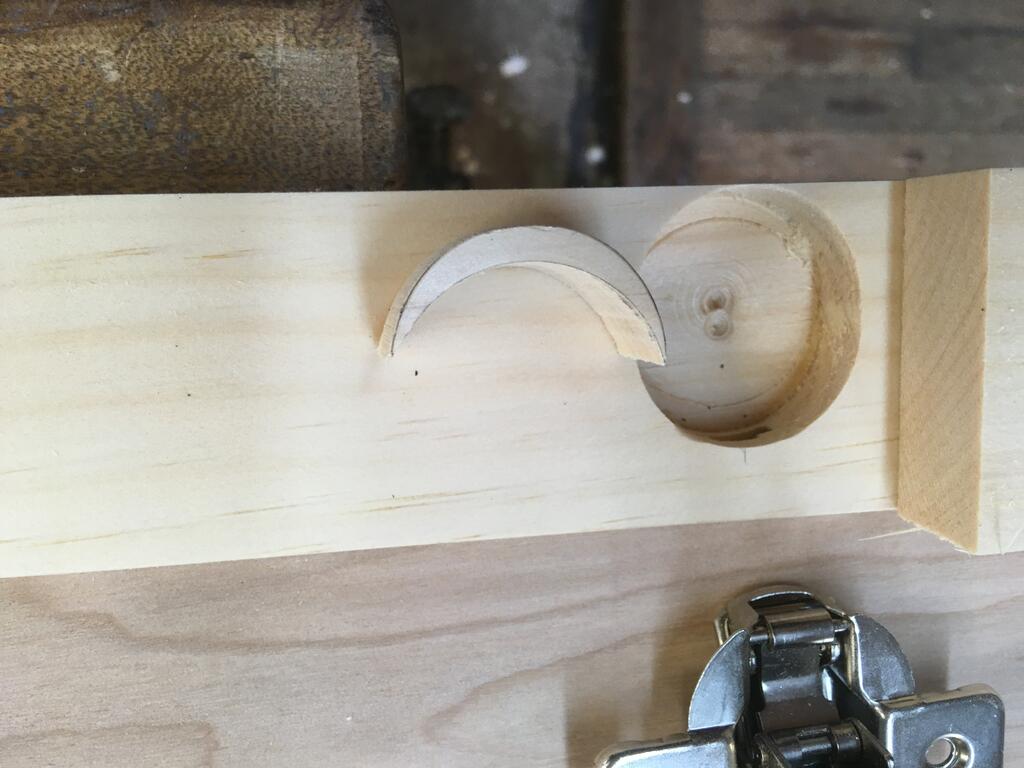

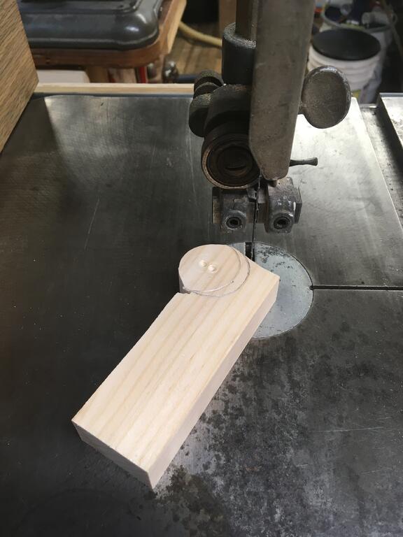

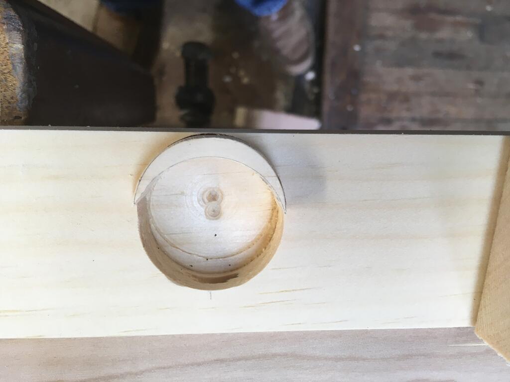

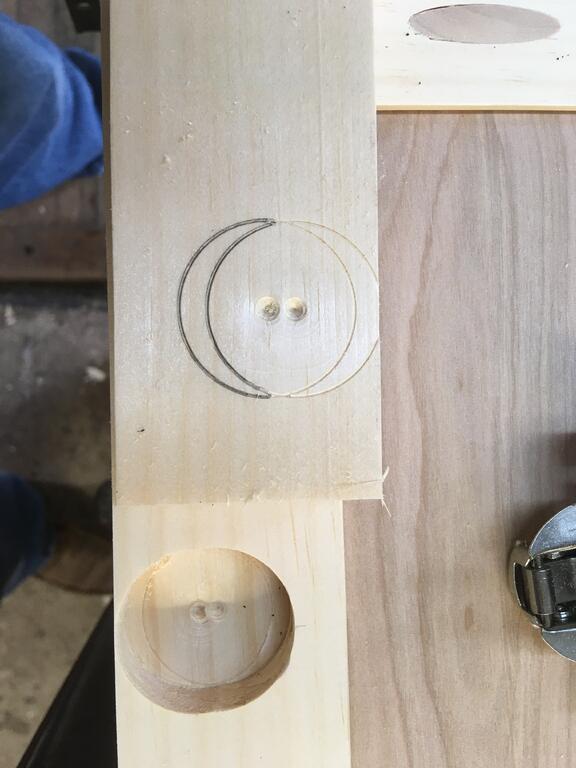

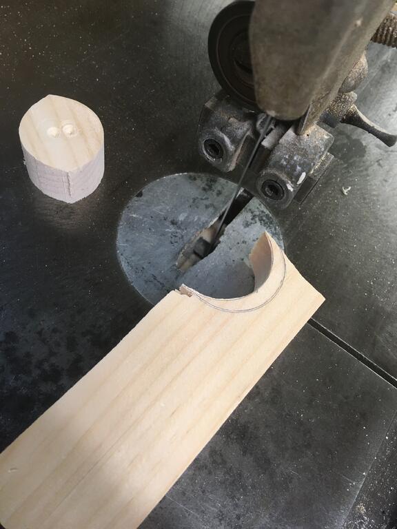

Mickwhitt 5,259 #15 Posted May 2, 2020 I have made a few doors with that kind of hinge and the bit you described is indispensable. Depth stop and a way of setting it to the right dimension from the door edge and you're away. Unless it's a 7 foot long door lol. I wondered how you cut the crescent shaped filling piece. Mick Share this post Link to post Share on other sites
wh500special 2,396 #16 Posted May 2, 2020 Interesting. I just hadn’t seen that variety of bit for drilling before. I’ve seen some router bits for shelf pin and hinge holes and just assumed that’s what you had. I like it. $30 apiece is nothin’ if you can get that many holes from them. I like the 32mm system. And there are a lot of premade jigs for that layout, some of them quite intricate and slick. Pretty handy. I’ve done a few projects using metric measurements and found it simpler to use when dividing things up like spacing between shelves for instance. It’s a shame we’ve not gone further with metric tools here. steve 2 Share this post Link to post Share on other sites
formariz 12,359 #17 Posted May 3, 2020 (edited) 21 hours ago, Mickwhitt said: I have made a few doors with that kind of hinge and the bit you described is indispensable. Depth stop and a way of setting it to the right dimension from the door edge and you're away. Unless it's a 7 foot long door lol. I wondered how you cut the crescent shaped filling piece. Mick I don’t bother with the depth stop. The black mark on it is where to stop. Cut it on the bandsaw and just cleaned it up with a little sanding Edited May 3, 2020 by formariz Share this post Link to post Share on other sites
