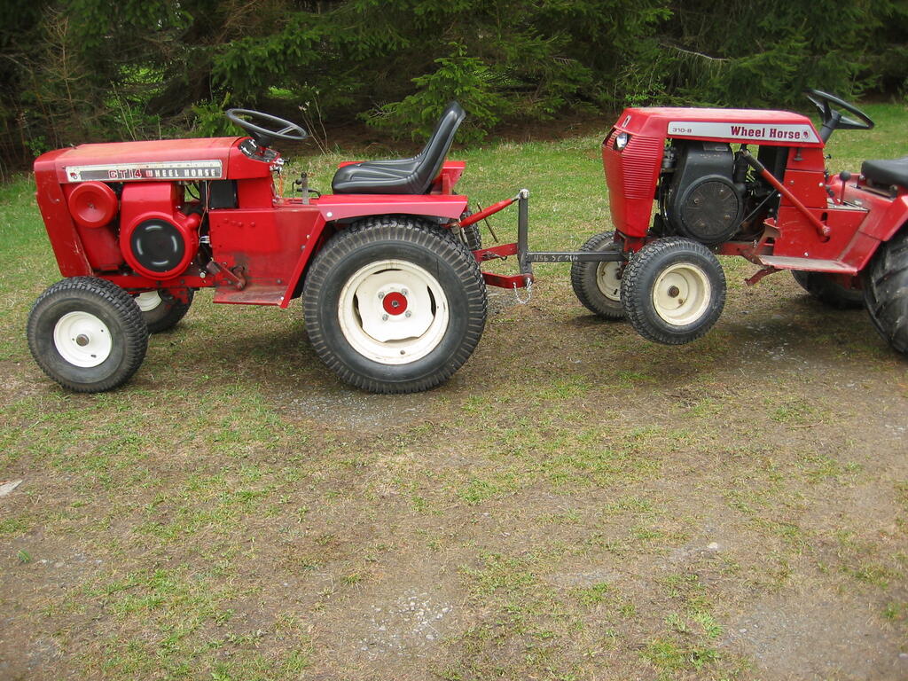

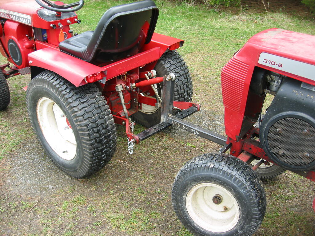

pfrederi 20,870 #1 Posted May 1, 2020 Finally got a chance to out shop the GT-14. Overhauled motor, refreshed hydro, Changed ignition systems and added 3 point. Played around with some scrap metal this afternoon came up with a WH recovery vehicle. This setup only works if the sick tractor has a front tachmatic. Have to figure out another set up for older horses. Have to add stabilizer chains and maybe a RAWL (be cool like Jamie Davis Heavy Rescue) 6 5 1 Share this post Link to post Share on other sites
c-series don 12,130 #3 Posted May 1, 2020 You’re going to need an orange vest and a lot of strobe lights! Share this post Link to post Share on other sites
cafoose 3,774 #4 Posted May 3, 2020 On 5/1/2020 at 4:14 PM, pfrederi said: Finally got a chance to out shop the GT-14. Overhauled motor, refreshed hydro, Changed ignition systems and added 3 point. Played around with some scrap metal this afternoon came up with a WH recovery vehicle. This setup only works if the sick tractor has a front tachmatic. Have to figure out another set up for older horses. Have to add stabilizer chains and maybe a RAWL (be cool like Jamie Davis Heavy Rescue) @pfrederi Is that 3 point custom or an original part? Share this post Link to post Share on other sites

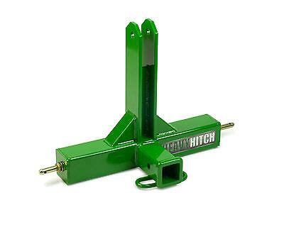

19richie66 17,930 #5 Posted May 3, 2020 (edited) Just an idea.... why not weld a female 2” receiver where your bar goes into the uprights and then you could swap out bars for attachamatics and one for older tractors. Want to move a trailer? Simply insert receiver with 2” ball. It would make one setup so more adaptable and useful. But I like the idea!! Edited May 3, 2020 by 19richie66 1 Share this post Link to post Share on other sites
pfrederi 20,870 #6 Posted May 3, 2020 2 hours ago, cafoose said: @pfrederi Is that 3 point custom or an original part? Original part Share this post Link to post Share on other sites
cafoose 3,774 #7 Posted May 3, 2020 2 minutes ago, pfrederi said: Original part Just wondering because I'd like to put one on my GT-14 but they're hard to find and expensive. Wondering if I could fabricate or adapt something? Share this post Link to post Share on other sites

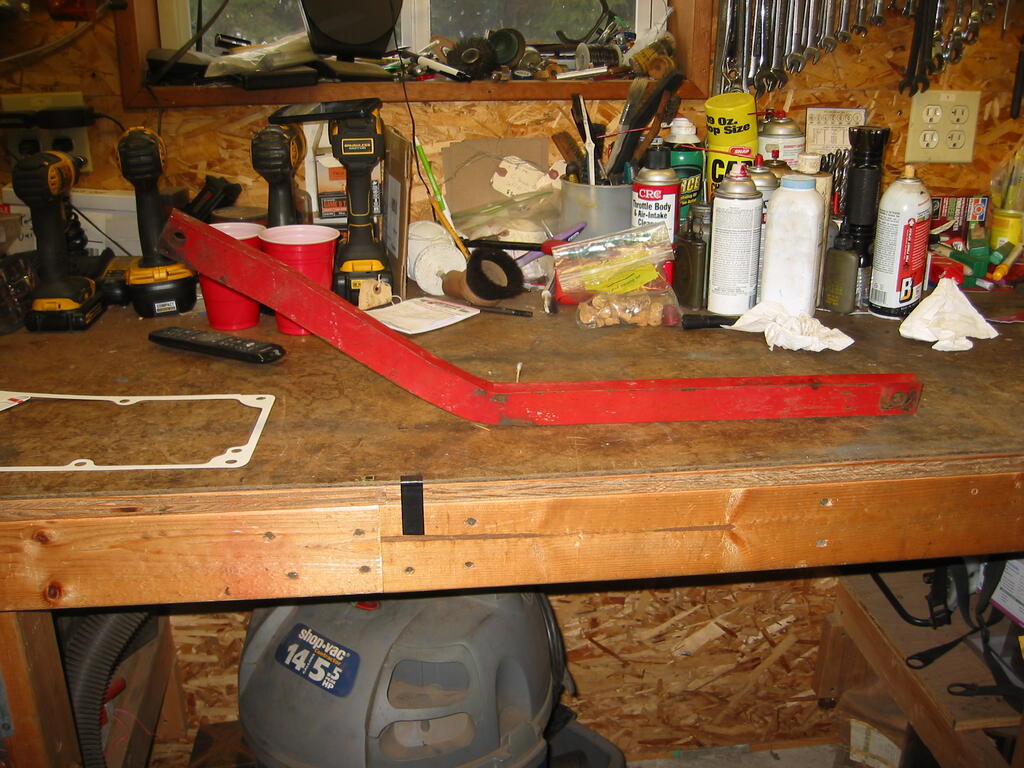

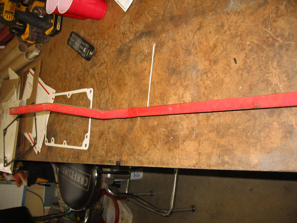

pfrederi 20,870 #8 Posted May 3, 2020 The rear parts are similar to a D series 3pt. The problem is the link that goes to the hydro cylinder. almost 3 ft long 3/4 x 1-1/4 steel with odd bends.... 1 Share this post Link to post Share on other sites
cafoose 3,774 #9 Posted May 3, 2020 So all the parts are the same as a D series except for the link to the hydro cylinder. So if I got a D series setup and a GT -14 link to the hydro cylinder then it would work? Share this post Link to post Share on other sites
pfrederi 20,870 #10 Posted May 3, 2020 (edited) Similar not exactly same I really haven't done a detailed check draft arms look the same some of the mounts are different...You would have to compare parts numbers... Edited May 3, 2020 by pfrederi 1 Share this post Link to post Share on other sites
19richie66 17,930 #11 Posted May 3, 2020 Lower arms and the cylinder are the same. Everything else is different 1 1 Share this post Link to post Share on other sites
