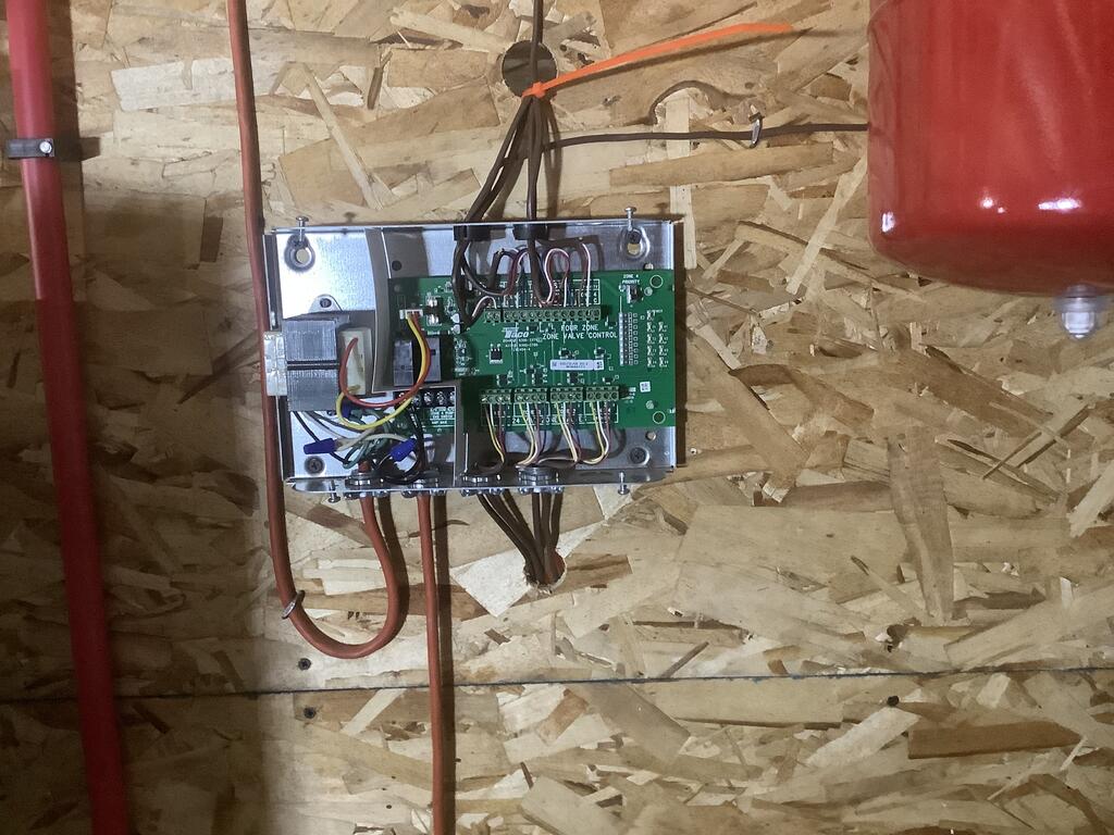

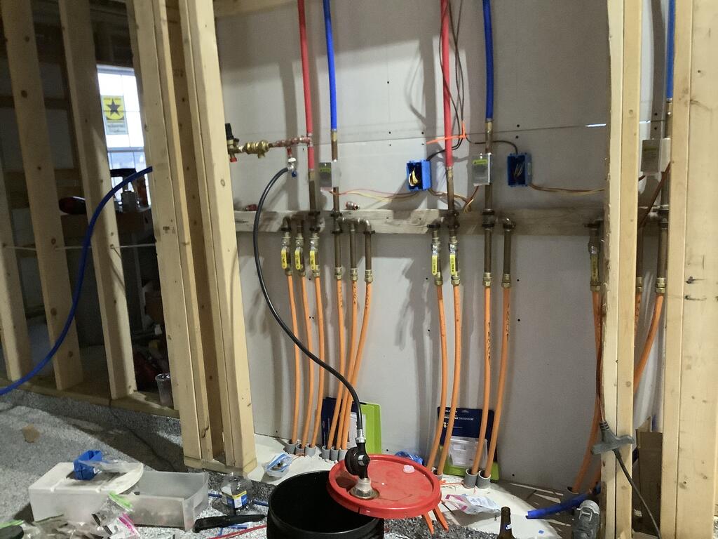

Pullstart 71,075 #1105 Posted December 13, 2020 Helped finish the install on the boiler / radiant heating system for my FIL today. The drill pump I use for filling tires did a marvelous job at filling the system with glycol! 2 Share this post Link to post Share on other sites

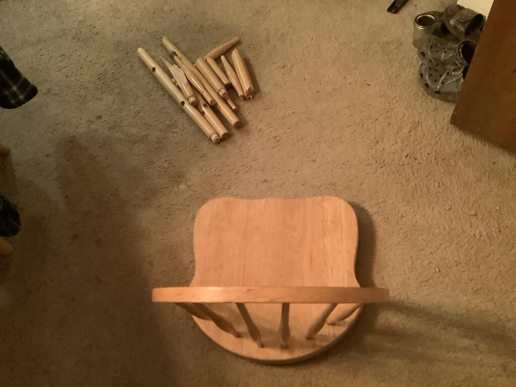

Pullstart 71,075 #1108 Posted December 14, 2020 Fixed that broken chair tonight... 1 2 Share this post Link to post Share on other sites

WHX?? 57,749 #1113 Posted December 14, 2020 14 hours ago, pullstart said: Helped finish the install on the boiler / radiant heating system for my FIL today. The drill pump I use for filling tires did a marvelous job at filling the system with glycol! Looks good Kev. I use a transfer pump but a drill pump gets better pressure. The back flow preventer is supposed to be ahead of the fill valve. Also never install valves upside down. Supposed to be no more than 45 deg from vertical. They can accumulate crap in the system then not seat causing annoying drips. Be carful of romex connectors on low voltage wiring & don't over tighten. That insulation on the wires is pretty thin. Share this post Link to post Share on other sites
Pullstart 71,075 #1114 Posted December 14, 2020 1 minute ago, WHX24 said: Looks good Kev. I use a transfer pump but a drill pump gets better pressure. The back flow preventer is supposed to be ahead of the fill valve. Also never install valves upside down. Supposed to be no more than 45 deg from vertical. They can accumulate crap in the system then not seat causing annoying drips. Be carful of romex connectors on low voltage wiring & don't over tighten. That insulation on the wires is pretty thin. Any examples of the backflow preventer and fill valve handy Uncle Jim? We used the box they came in as a build example. Luckily we haven’t gotten it completely filled so we can still modify what is needed. Share this post Link to post Share on other sites

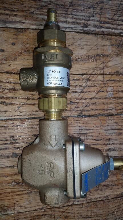

WHX?? 57,749 #1115 Posted December 14, 2020 These are just the ones I use and come preassembled. Most systems I am going to put glycol in I don't even use them. I have a temporary fill setup up made for initial filling/purging and fill thru the valve you have your pump connected to using washing machine hoses. Once it's in operation and I'm happy with the final pressures after a couple weeks of operation it comes off and adding glycol or pressure adjustments are made using the drill pump. The thing with those valves is they are only used once and then corrode up and are useless down the road. The idea behind the backflow in front of the pressure reducing valve is the PR valve might not have enough pressure to overcome a stuck backflow valve. When you don't even use one there is zero chance of anti freeze backing up into potable water. There should always be a shutoff on BOTH sides of the combination valve in case it needs replacing. 1 Share this post Link to post Share on other sites

Lee1977 7,750 #1117 Posted December 14, 2020 14 hours ago, pullstart said: Fixed that broken chair tonight... Unless you turned a lot of new parts. I think fire wood would have been a better option. 2 Share this post Link to post Share on other sites
Pullstart 71,075 #1118 Posted December 14, 2020 4 hours ago, Lee1977 said: Unless you turned a lot of new parts. I think fire wood would have been a better option. ‘Tis fire wood indeed! Actually I just tossed it in the boiler! 1 Share this post Link to post Share on other sites

Pullstart 71,075 #1120 Posted December 15, 2020 It actually went like this... it was missing a spindle or three, has been pretty iffy for a couple years. A bigger person comes over, we have to avoid letting them sit, etc. finally Mrs. P asked me to do something about it, so I picked it up and smashed it to pieces WWF style. ThereIFixedIt! 1 5 Share this post Link to post Share on other sites
