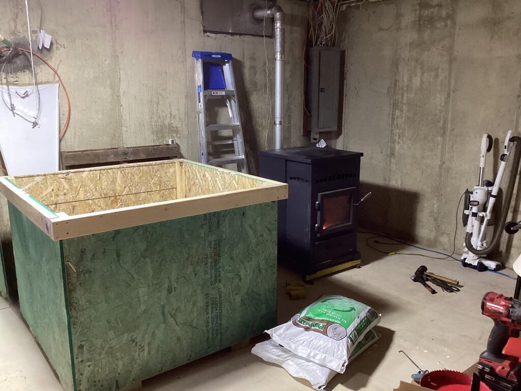

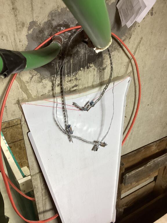

Pullstart 71,175 #5102 Posted December 13, 2022 Got my bin finished up, now need to build the chute! As for the white triangular item on the wall, it’s a makeshift “drain” that was installed before we moved in. Must be at one point, there was enough water outside to seep in through the wood boiler lines. The Farm Truck made a trip to town this morning, I’ve got a ton of pellets on a pallet, waiting to get dumped into the bin. The 2x4’s on top serve a structural purpose, plus it will prevent the abrasion on hands, arms or chests while digging for pellets with the bucket. Maybe if I am feeling super ambitious one day, I’ll build an auger system to load the pellet hopper for me. I have one for the wood boiler to load corn or wood pellets into it from a gravity wagon. I could utilize parts, or use it as a template to build my own. I also thought about elevating this bin and running a gate valve of sorts to gravity feed it into the hopper. I thought there are all kinds of ways for that to go wrong, collapse, overfill, etc. 2 2 Share this post Link to post Share on other sites
ebinmaine 80,496 #5103 Posted December 13, 2022 24 minutes ago, Pullstart said: I also thought about elevating this bin and running a gate valve of sorts to gravity feed it into the hopper I like that idea 1 Share this post Link to post Share on other sites

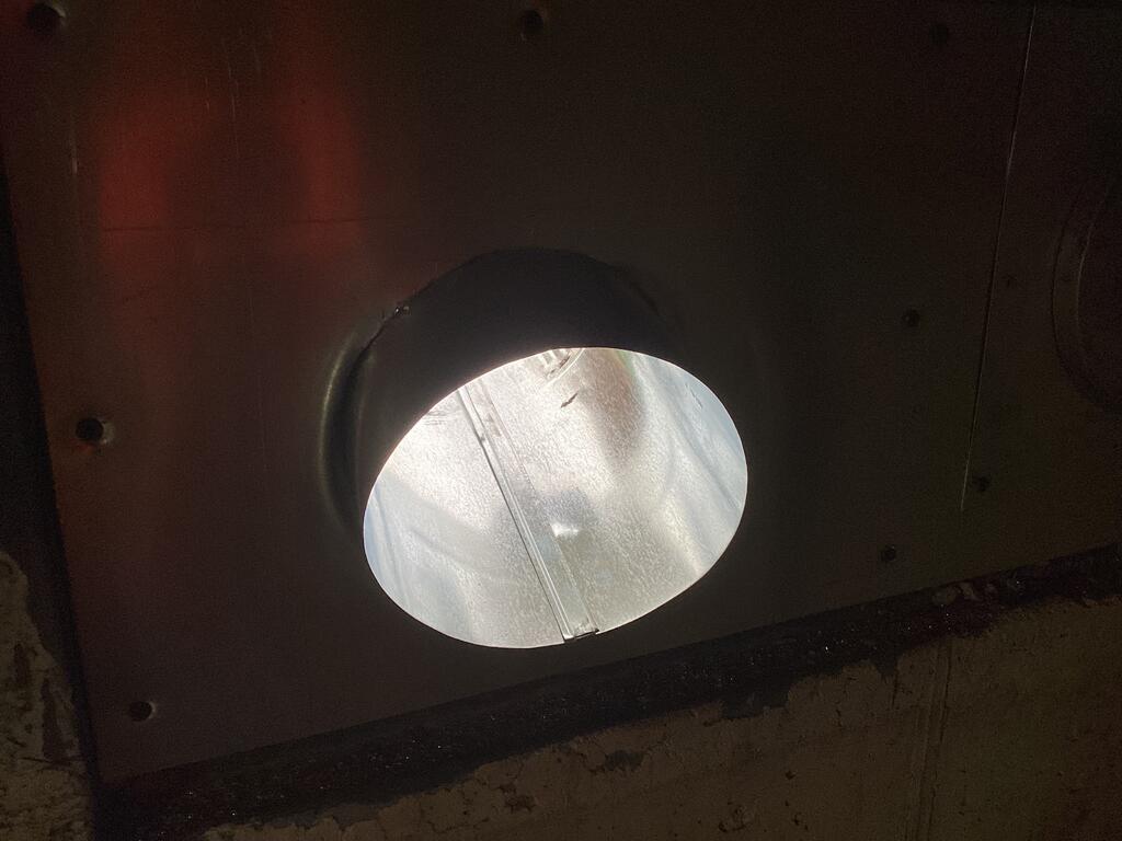

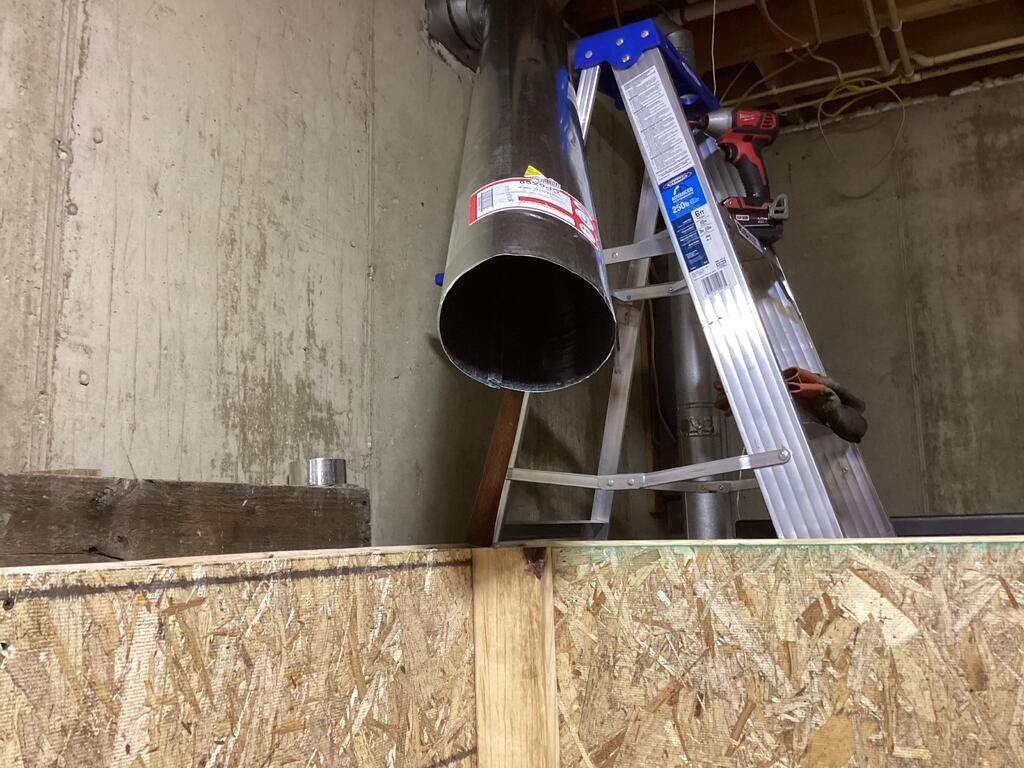

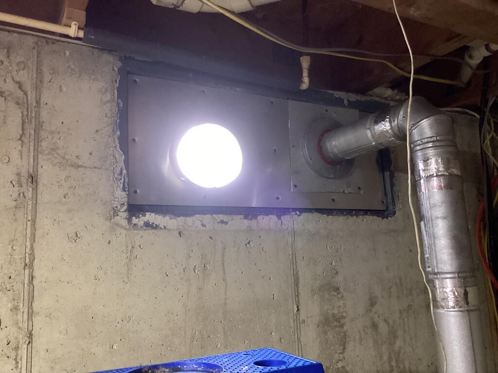

Pullstart 71,175 #5104 Posted December 13, 2022 Got the first part of my chute installed. 4 Share this post Link to post Share on other sites
Handy Don 17,412 #5105 Posted December 13, 2022 32 minutes ago, Pullstart said: Got my bin finished up, now need to build the chute! Maybe if I am feeling super ambitious one day, I’ll build an auger system to load the pellet hopper for me. I have one for the wood boiler to load corn or wood pellets into it from a gravity wagon. I could utilize parts, or use it as a template to build my own. I also thought about elevating this bin and running a gate valve of sorts to gravity feed it into the hopper. I thought there are all kinds of ways for that to go wrong, collapse, overfill, etc. Brings back childhood memories of our anthracite-heated home in NE Pennsylvania. Coal truck dump body could be lifted vertically about 10 feet before tipping to dump down a long chute. Coal ran into a bin in the basement next to the furnace and an auger tube fed the burner. My job was to shovel out and remove the ashes in ½ bushel tubs without making a mess in the kitchen on the way out. 3 Share this post Link to post Share on other sites

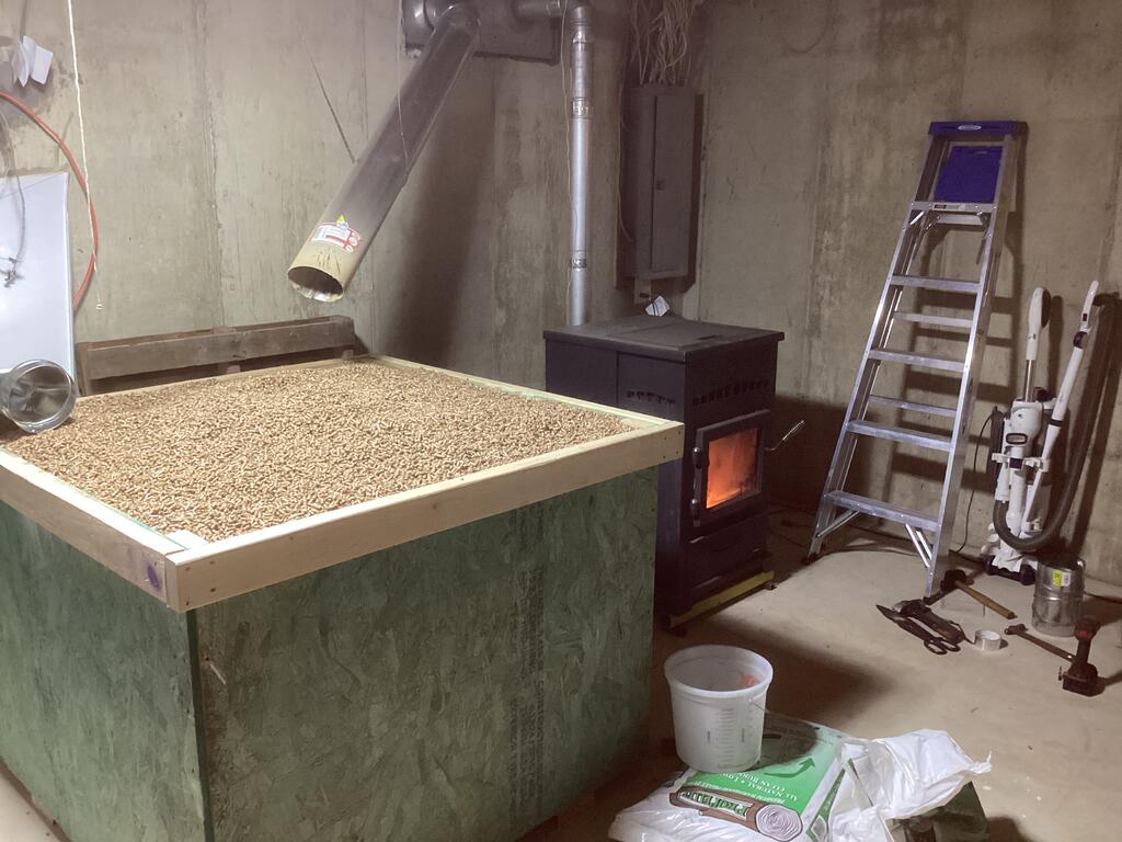

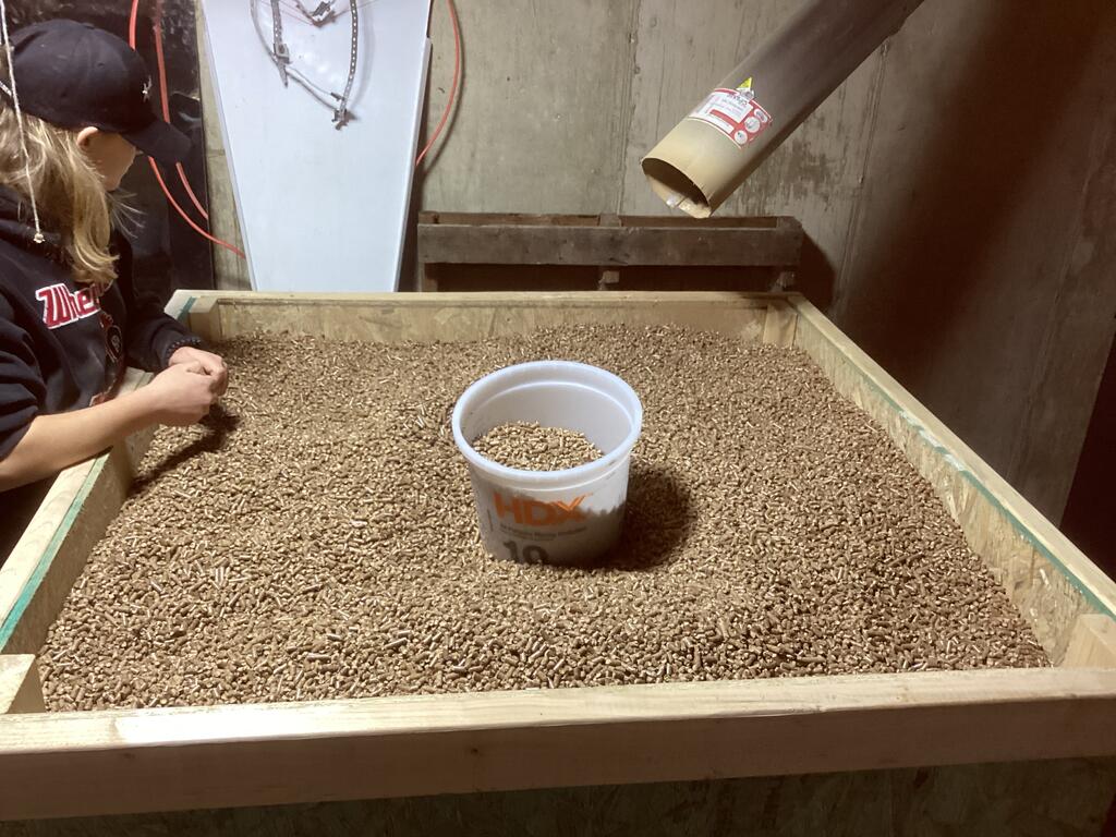

Pullstart 71,175 #5107 Posted December 13, 2022 That aughtta throw a pellet or 758,613! 5 1 Share this post Link to post Share on other sites
Handy Don 17,412 #5108 Posted December 13, 2022 37 minutes ago, Pullstart said: That aughtta throw a pellet or 758,613! You'll add a support for the end of the tube to keep it stable, right? Don't want any of those hundreds of thousands of pellets missing the bin! 2 Share this post Link to post Share on other sites
Pullstart 71,175 #5109 Posted December 13, 2022 26 minutes ago, Handy Don said: You'll add a support for the end of the tube to keep it stable, right? Don't want any of those hundreds of thousands of pellets missing the bin! There is some 3/4” galvanized strapping holding it up Haven’t missed the hole yet! 2 Share this post Link to post Share on other sites

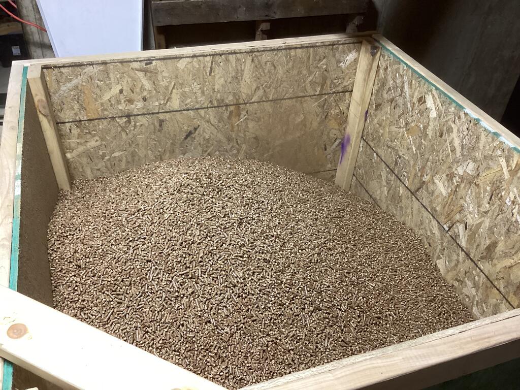

Pullstart 71,175 #5112 Posted December 13, 2022 6 bags left outside! 4 Share this post Link to post Share on other sites

SylvanLakeWH 32,373 #5114 Posted December 13, 2022 (edited) @Pullstart Curious... any dust? Edited December 13, 2022 by SylvanLakeWH 1 Share this post Link to post Share on other sites
Pullstart 71,175 #5115 Posted December 13, 2022 25 minutes ago, Ed Kennell said: Do you have a bulk delivery service in your area? I’ve never seen or heard of one! 1 Share this post Link to post Share on other sites
Pullstart 71,175 #5116 Posted December 13, 2022 8 minutes ago, SylvanLakeWH said: @Pullstart Curious... any dust? not terrible. A little on the tube. 1 1 Share this post Link to post Share on other sites
Pullstart 71,175 #5117 Posted December 13, 2022 @SylvanLakeWH here is a “full shot”. It shows the dust accumulated on the tube, but not terrible otherwise. 1 1 Share this post Link to post Share on other sites

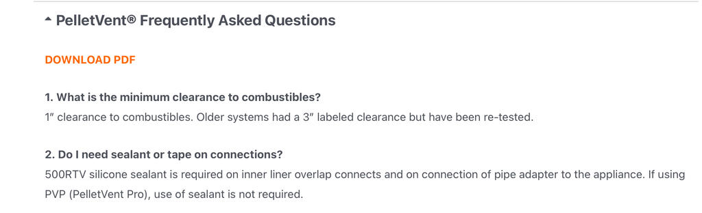

Horse Newbie 7,405 #5118 Posted December 13, 2022 3 hours ago, Pullstart said: Got the first part of my chute installed. No real need for that shiny tape on those flue pipe joints … actually may not meet code, unless you all can get by with it up thar. Especially the double wall pipe… probably the single wall pipe too. Share this post Link to post Share on other sites
Horse Newbie 7,405 #5119 Posted December 13, 2022 1 hour ago, Pullstart said: 6 bags left outside! Is she counting the pellets ? 5 Share this post Link to post Share on other sites

Pullstart 71,175 #5121 Posted December 13, 2022 3 minutes ago, Horse Newbie said: Is she counting the pellets ? She knocked down a couple mountains looking to spill over, and was snapping them like twigs! I had a thought. We have two cats. That’s a real big litter box 2 Share this post Link to post Share on other sites
Horse Newbie 7,405 #5122 Posted December 13, 2022 Just now, Pullstart said: She knocked down a couple mountains looking to spill over, and was snapping them like twigs! I had a thought. We have two cats. That’s a real big litter box Time to build a lid… 1 1 Share this post Link to post Share on other sites
Pullstart 71,175 #5123 Posted December 13, 2022 15 minutes ago, Horse Newbie said: No real need for that shiny tape on those flue pipe joints … actually may not meet code, unless you all can get by with it up thar. Especially the double wall pipe… probably the single wall pipe too. I see some forums say that metal tape has been used to seal nuisance leaks… but they do recommend 500 degree RTV 1 Share this post Link to post Share on other sites
