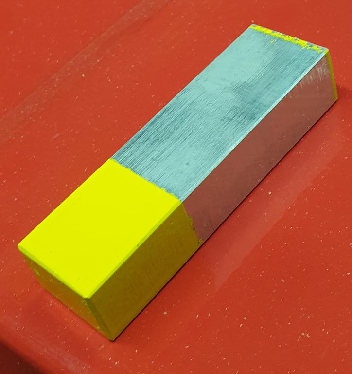

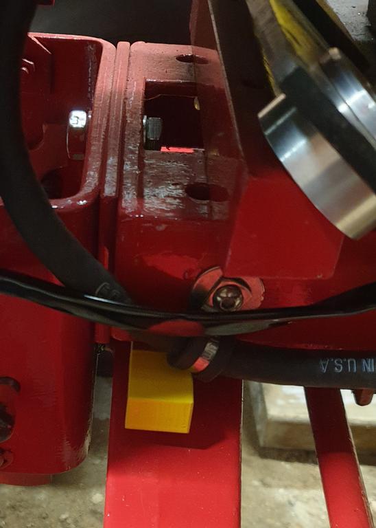

Mickwhitt 5,259 #1 Posted April 27, 2020 Hi all, Just thought I would ask members to share those neat tools and gadgets they have made to work on their tractors. I was jacking up my WH with a scissor style motorcycle lift under the rear axle. When I got both wheels off the ground I found the machine was able to rock from side to side a lot due to the front axle pivot, almost falling off the jack. So I made a pair of aluminium blocks with a magnet let into the back so they slip into the front axle gap to stop any rocking and jerp things safe when the rear end is jacked up. 4 1 Share this post Link to post Share on other sites
formariz 12,379 #2 Posted April 27, 2020 Great idea. Had same issue with same type of jack. Used a piece of wood cut to fit but always have to look for it. Share this post Link to post Share on other sites
Mickwhitt 5,259 #3 Posted April 27, 2020 These little blocks stick to the jack so hopefully I wont lose them. Bright yellow so I don't forget to remove them. 1 Share this post Link to post Share on other sites
