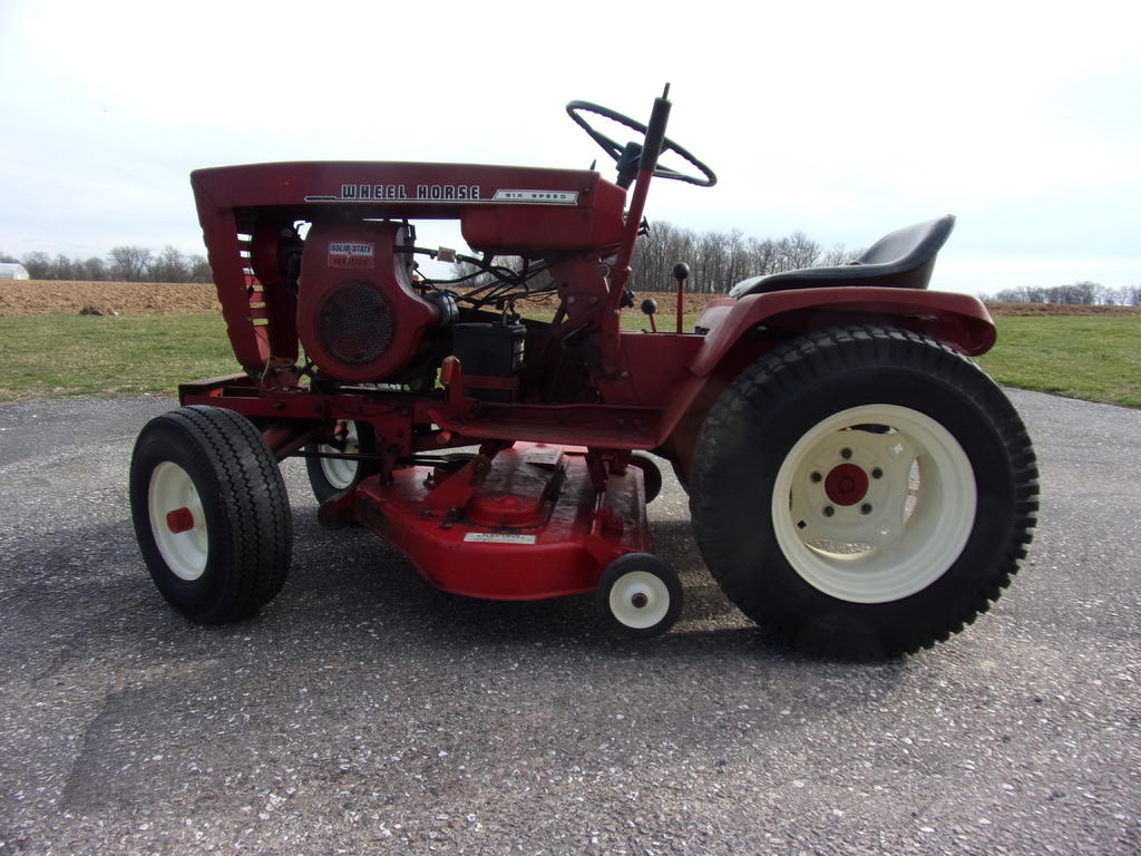

Stepney 2,356 #1 Posted April 27, 2020 A long search finally comes to a close. I'm always asked why I've had 4 Chargers, 2 Electros, and a number of other older and newer hydro models.. most with hydro lift too. But never a gear drive? Well. Simple. After all the years, I've simply never come across a reasonably priced, and local, early 8 speed.. Until now. Showed up on CL about half an hour away, I wrote on the first hour of being posted. Had been in this man's ownership for about 25 years, never ran even then. Got it home, removed the 1979 dated Sears battery. Added a battery and it cranks and fires on the key. Oh.. and the HH100 SSI ignition works perfectly. In fact it'd be running right now if I could get the intake valve unsticked. It fires right off but dies just as quick. Even the carb was pretty clean. Doesn't leak. Original seat really seems nice. Very soft, just filthy. The rear wheels were reversed for some reason. Have to switch them around. With any luck she'll be running by morning. 6 8 Share this post Link to post Share on other sites

Pollack Pete 2,273 #8 Posted April 27, 2020 Nice little Raider 10.I've got one floating around here some where that's on my work on it someday list. Previous owner must have been looking for the " funny car " look when he reversed the rear wheels.Have fun with your new toy. 1 Share this post Link to post Share on other sites
Stepney 2,356 #9 Posted April 27, 2020 Welp, gentlemen. She didn't last long.. Got the valve good and free. Hit the starter and first try she lit right off and was purring .... Then it went CRACK and coasted to a stop. At first I thought rod, but when cranking it would spit fire and gas vapor from the carb.. so the rod was still in there. Pulled the plug and turned it over, no movement from the valves. Sounds like the cam gear rounded off for whatever reason.. Had a nice running HH100 I sold just a few months back. Wish I hadn't now. Ah well, there's a good Kohler on the parts line for a donor engine. I've already pulled the Teccy off. Would not be against fixing it but I have a fleet of Kohler stuff so it'd just make it that much easier to keep running. I'll probably throw the 'important' parts up on the classifieds if anyone needs a good Teccy SSI or other parts. She looks pretty sad in the back of the garage. 3 Share this post Link to post Share on other sites

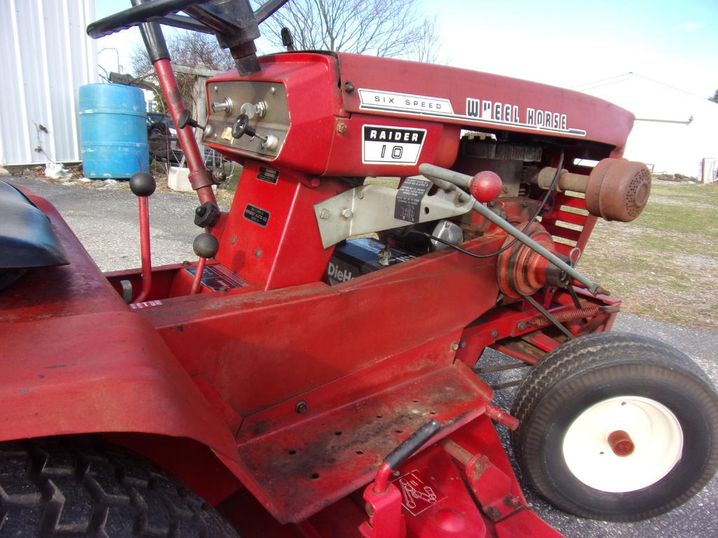

Stepney 2,356 #11 Posted April 28, 2020 Well, one way or another, she's alive! Had this old blue Kohler K301t industrial engine in the shed. I was there when it was removed from a pallet as a new engine, it was stuck on a 1967 Bolens and after about an hour the clutch failed. Kid left it to rot for a few years till I bought the whole rig for the motor. Fit right onto the Raider, added a pulley and away we go. No starter or charging system. Think I may wind up adding a bracket and pulley for a starter generator. But for now it's running on the mag and seems to run great. 2 2 Share this post Link to post Share on other sites

Stepney 2,356 #19 Posted May 2, 2020 Did her first bit of actual work in a few decades today. Still soaking the shroud trying to get the horrible mouse stench out of it. Can't run it too long.. but at a nice sloe lope it had an easy job of dragging 325lbs of dead weight around like nothing was there. 2 4 Share this post Link to post Share on other sites
