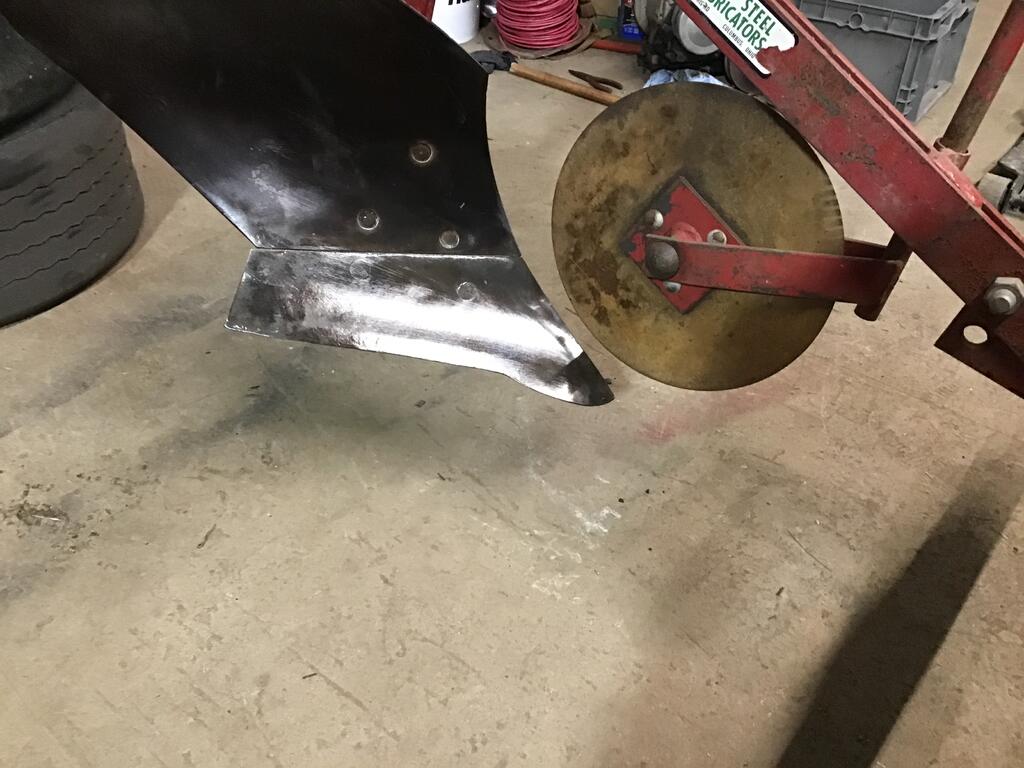

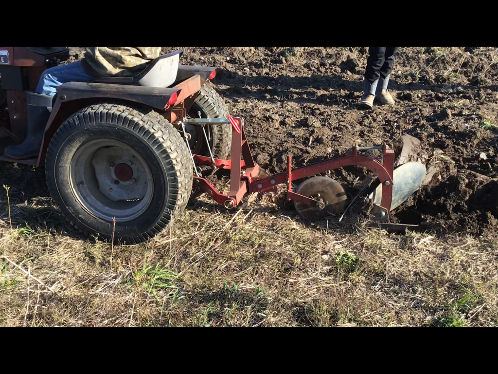

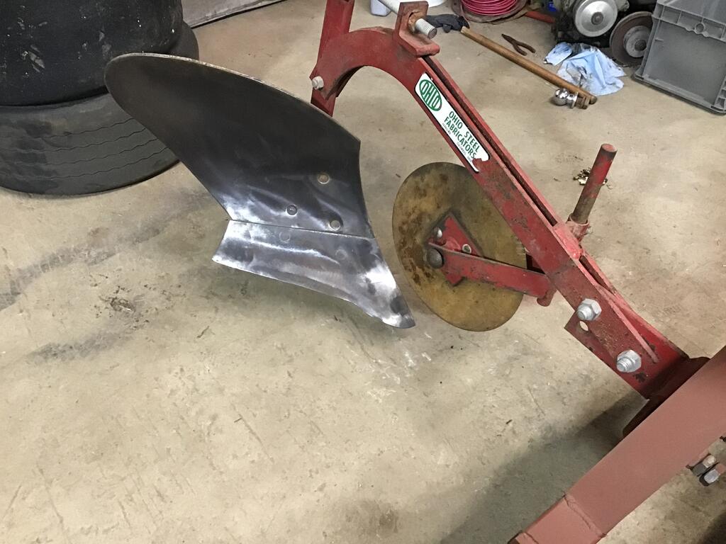

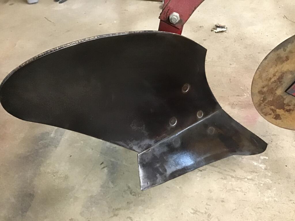

Pullstart 71,564 #77 Posted May 11, 2020 Threw a little shine on the moldboard before the tractor leaves the shop. I’ll toss some grease on too, as recommended by real plow dogs! 3 Share this post Link to post Share on other sites
Pullstart 71,564 #78 Posted May 11, 2020 The grease really makes that bare old steel POP! 1 1 Share this post Link to post Share on other sites

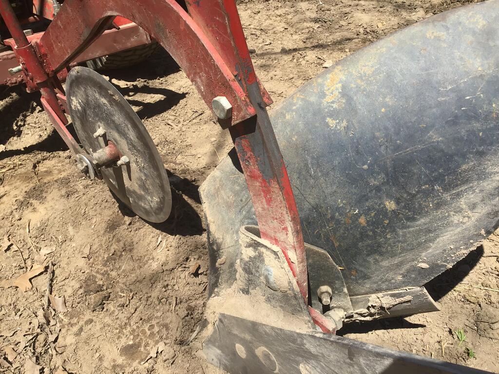

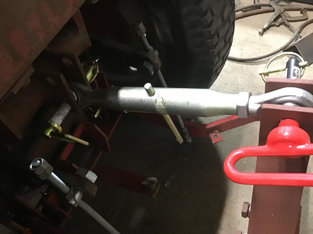

Pullstart 71,564 #79 Posted May 11, 2020 On 5/9/2020 at 7:45 PM, 953 nut said: https://www.tractorsupply.com/tsc/product/countyline-adjustable-top-link-cat-0-short?cm_vc=-10005 one last, one final, I think this really is it thing... I cut about 1” off the top link, maybe 1-1/2”. the point of the plow is about 6-1/2” off the ground now! 3 1 Share this post Link to post Share on other sites
PeacemakerJack 11,096 #80 Posted May 11, 2020 Time to throw on some chains or AG’s and get that plow in the ground!!! Make sure that you do a “shop adjust” set to the plow up on blocks like you did with Putt-Putt. You add the dynamic here of being able to “level” the vertical portion of the plow beam by lengthening or shortening the lift links—very cool. 1 Share this post Link to post Share on other sites

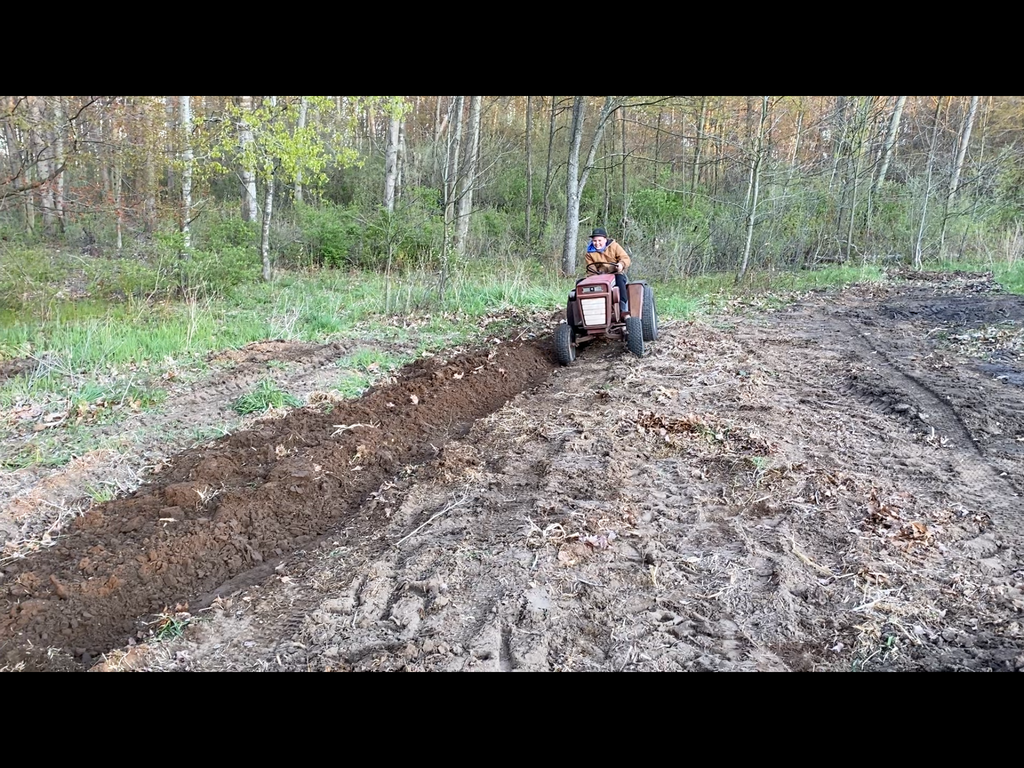

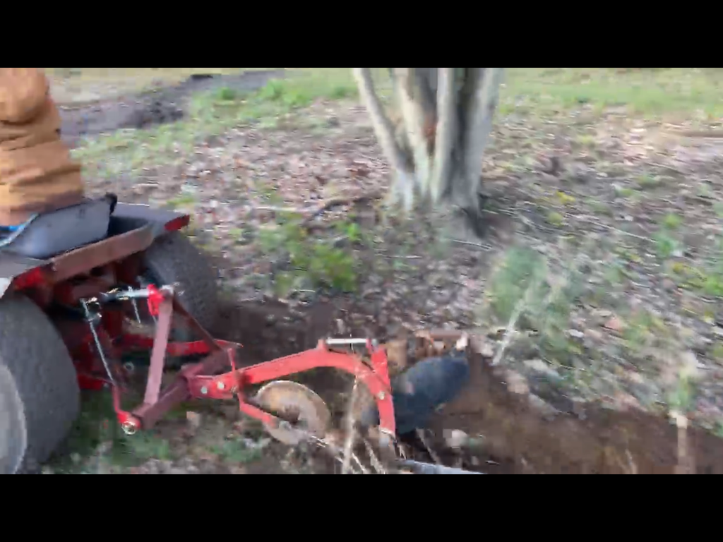

Pullstart 71,564 #83 Posted May 12, 2020 Well, the boys came out and plowed a bit in our garden, then took it home to do their plot! The belt was slipping quite a bit but once they got home, they found that they can push down on the parking brake handle a bit and it is a rocket! Traction is still an issue but their soil is mainly sand and it does ok still with the limited slip. I’m glad they are happy and look forward to seeing it on their older brother’s YouTube channel “Cade’s Cows” in the near future! Thank you again @davidtmercer for hooking me up with this awesome machine! I made them promise that I can be first on the list if they ever sell it 1 1 4 Share this post Link to post Share on other sites
Pullstart 71,564 #84 Posted May 12, 2020 I’ve been taking video segments and working on putting them together. Some day, I’ll attempt to add different sound bites, etc. Share this post Link to post Share on other sites

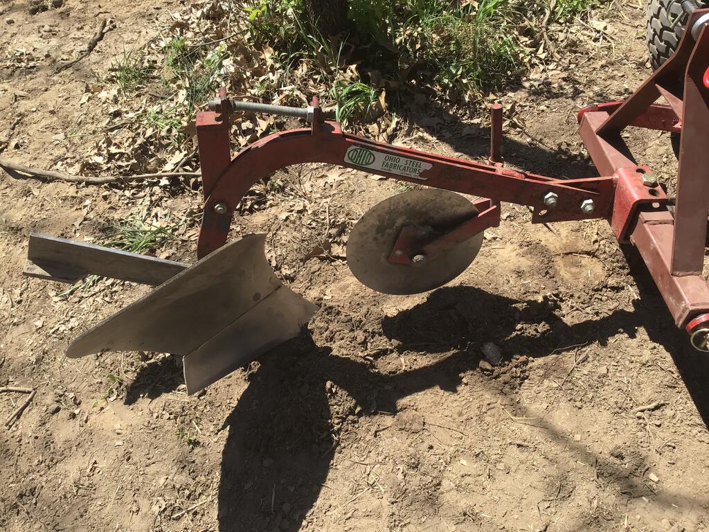

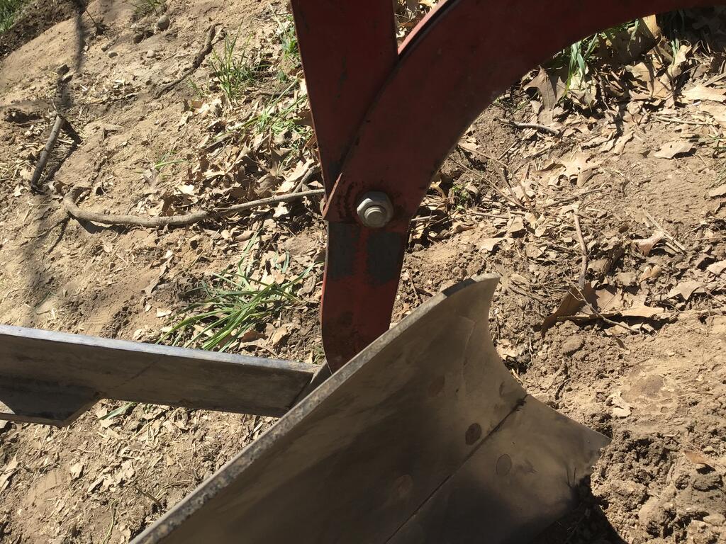

Pullstart 71,564 #89 Posted May 18, 2020 So the boys took delivery last week and have been having a blast! They coated it with WD40, changed the oil, cleaned the fuel tank and are probably due for another oil change! Unfortunately, they were plowing a bit faster than they should to keep momentum and caught a big root, bending part of the plow. Ohio Steel quit making these 20 years ago according to the nice lady I spoke with in their customer service, so parts are NLA. We might see about making it, but it’s 2”x1/2” solid bar and needs a lateral bend. 2 Share this post Link to post Share on other sites

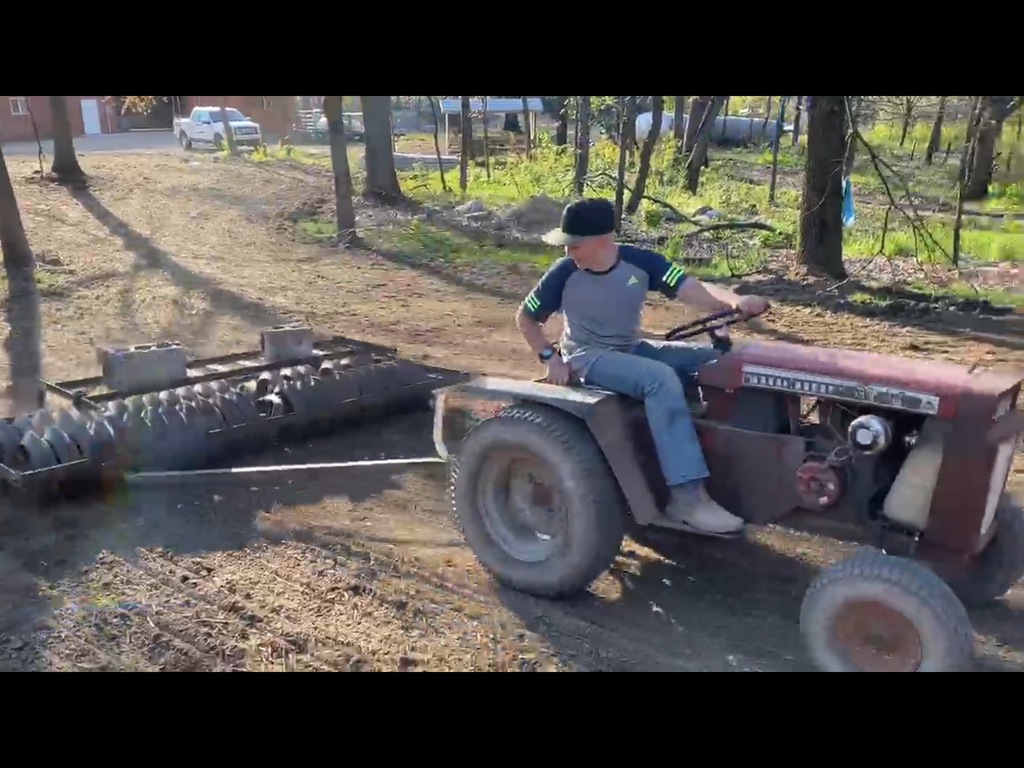

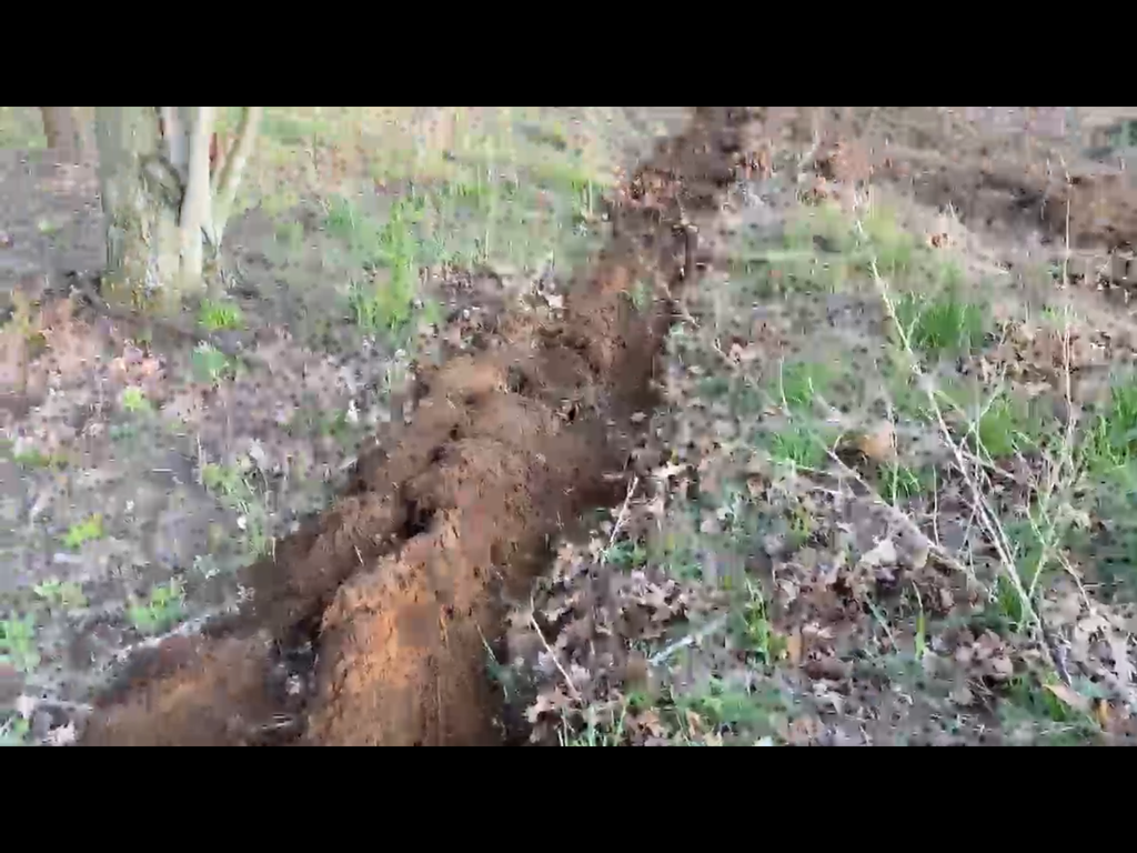

Pullstart 71,564 #90 Posted May 18, 2020 Here are a few pictures of them working around the farm! 1 2 Share this post Link to post Share on other sites
Tractorhead 9,218 #91 Posted May 18, 2020 Maybe a hot bending and weld a stiffner onto the Backside to reinforce an fix it. But it seems the Boy‘s keep it species-appropriate attitude. 👍 1 Share this post Link to post Share on other sites
Pullstart 71,564 #92 Posted May 18, 2020 1 hour ago, Tractorhead said: Maybe a hot bending and weld a stiffner onto the Backside to reinforce an fix it. But it seems the Boy‘s keep it species-appropriate attitude. 👍 I was thinking that too, but I’m afraid my torch may not get hot enough.. Share this post Link to post Share on other sites
Tractorhead 9,218 #93 Posted May 18, 2020 You don‘t have autogenous Welder? That should be fine for that purpose. normal Torch may be too Weak, but it‘s worth a Try. Share this post Link to post Share on other sites

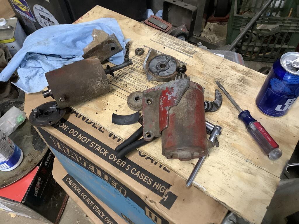

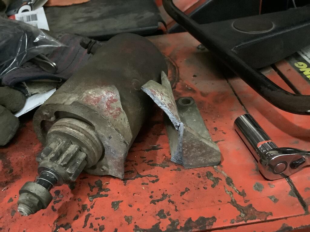

Pullstart 71,564 #95 Posted December 14, 2020 The GT-14 is back here for a bit. The starter seems to have cracked a little. 2 Share this post Link to post Share on other sites
ebinmaine 81,283 #96 Posted December 14, 2020 10 minutes ago, pullstart said: The starter seems to have cracked a little J. B. Weld. 1 Share this post Link to post Share on other sites
Pullstart 71,564 #97 Posted December 14, 2020 5 minutes ago, ebinmaine said: J. B. Weld. I thought about PullStart Weld... but figured I’d yank one off a running parts rig. Share this post Link to post Share on other sites
ebinmaine 81,283 #98 Posted December 14, 2020 8 minutes ago, pullstart said: I thought about PullStart Weld... but figured I’d yank one off a running parts rig. Yeah take the easy way out.... Share this post Link to post Share on other sites
Pullstart 71,564 #99 Posted December 14, 2020 31 minutes ago, ebinmaine said: Yeah take the easy way out.... At least I popped it apart and cleaned up the innards and used the best of all the parts... 2 Share this post Link to post Share on other sites
Pullstart 71,564 #100 Posted December 14, 2020 It’s alive and well! Now to get their “new” snowmobile running in time for Christmas! Share this post Link to post Share on other sites
