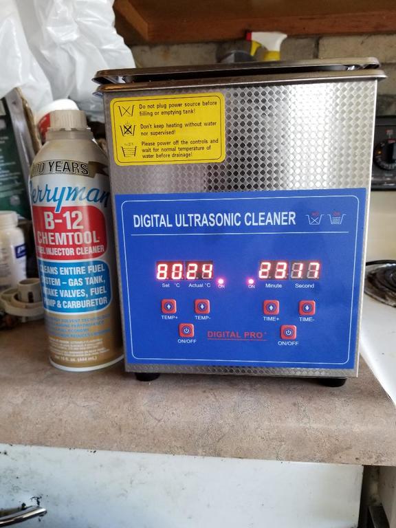

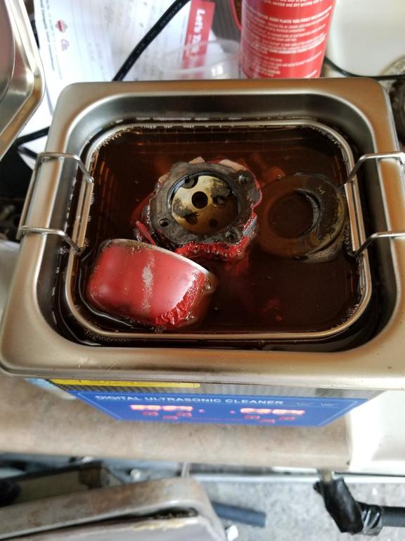

cafoose 3,685 #1 Posted April 21, 2020 I got my order from McMaster/Carr today. Wow that was fast I'm cooking the carburetor now in my ultrasonic cleaner I got from 3 1 Share this post Link to post Share on other sites
ebinmaine 78,272 #2 Posted April 21, 2020 Nothing like a nice fresh cooked carburetor 1 1 Share this post Link to post Share on other sites
squonk 46,099 #3 Posted April 21, 2020 McMaster is quick. I have a HF ultrasonic cleaner. I think I remember the manual saying not to put stuff like carburetor cleaner in it. I could be wrong but something sticks in my head about it. Share this post Link to post Share on other sites
cafoose 3,685 #4 Posted April 21, 2020 3 minutes ago, squonk said: McMaster is quick. I have a HF ultrasonic cleaner. I think I remember the manual saying not to put stuff like carburetor cleaner in it. I could be wrong but something sticks in my head about it. mine is all stainless steel so it should be fine Share this post Link to post Share on other sites
squonk 46,099 #5 Posted April 21, 2020 Mine is stainless too. I'll have to dig the book out. Share this post Link to post Share on other sites

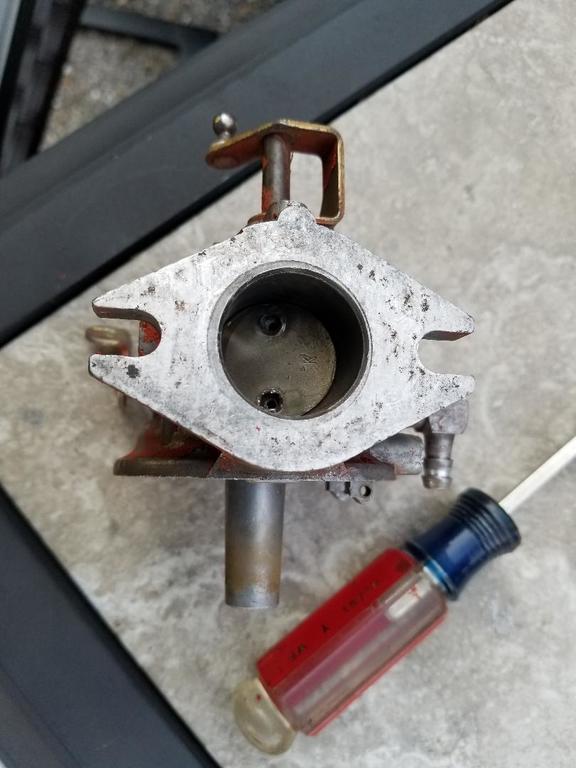

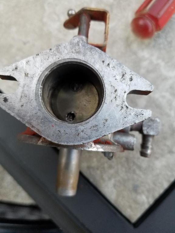

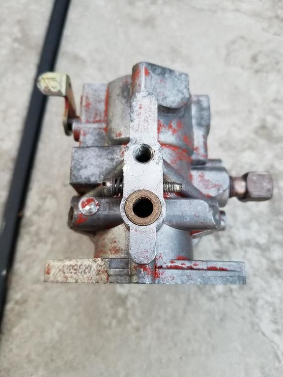

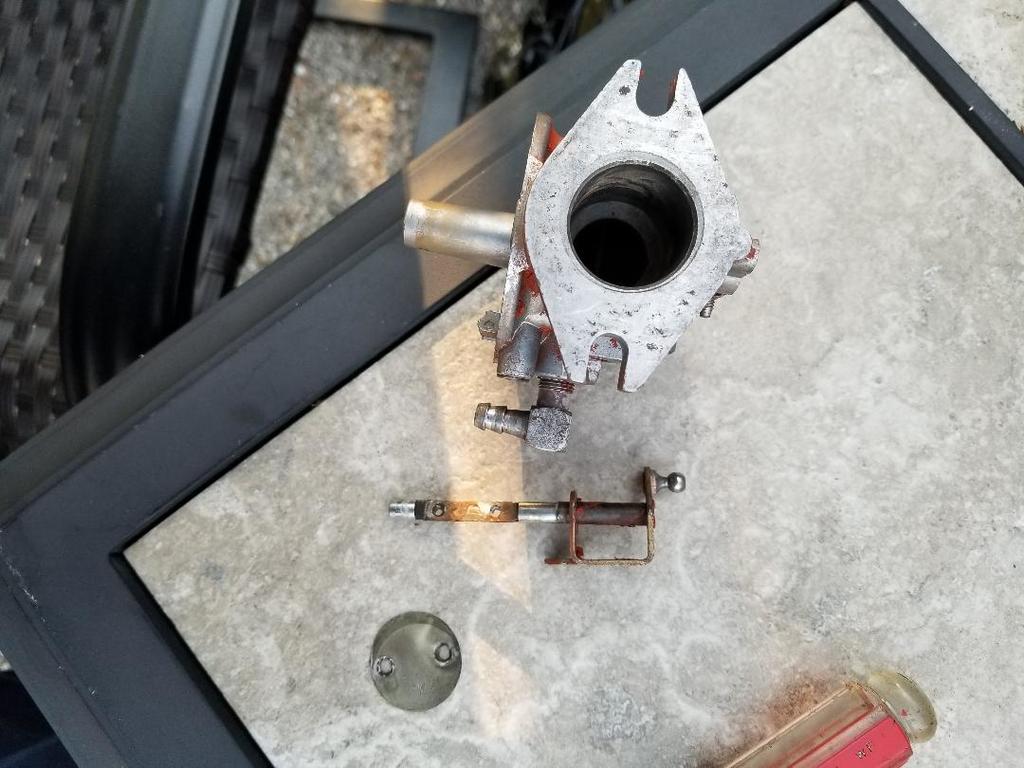

cafoose 3,685 #6 Posted April 21, 2020 Success Throttle plate removed! Now I need to find a bowl gasket 1 Share this post Link to post Share on other sites

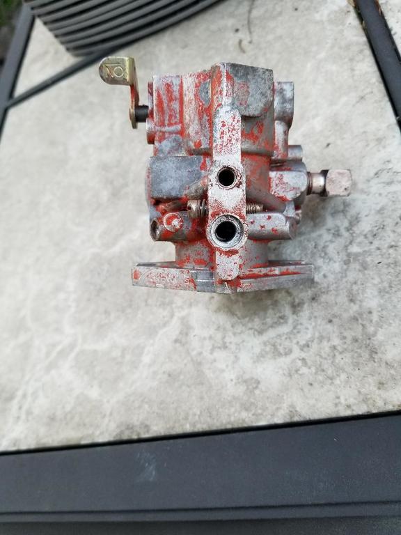

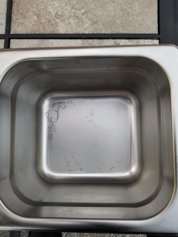

cafoose 3,685 #7 Posted April 23, 2020 On 4/21/2020 at 4:30 PM, squonk said: I have a HF ultrasonic cleaner. I think I remember the manual saying not to put stuff like carburetor cleaner in it. I could be wrong but something sticks in my head about it. @squonk this is after I cleaned it out. A little stained but still works fine Share this post Link to post Share on other sites

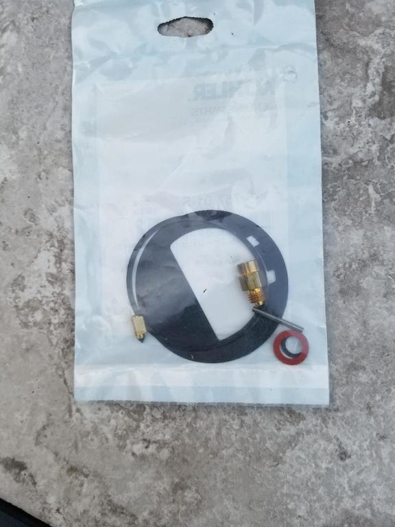

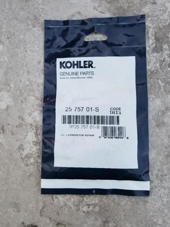

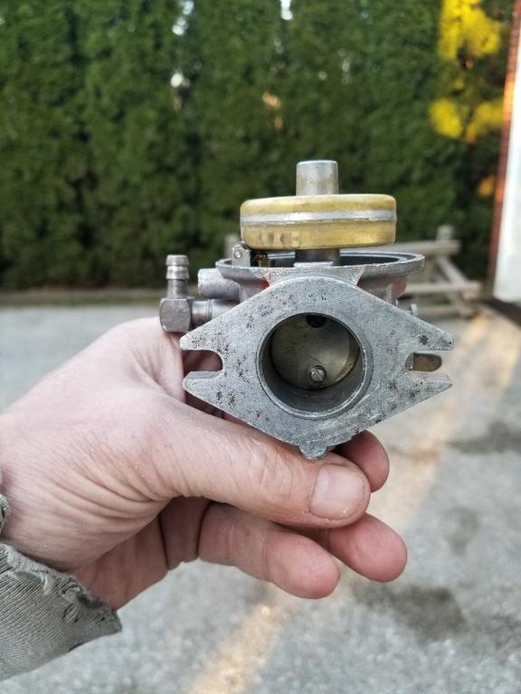

cafoose 3,685 #8 Posted April 23, 2020 Got the bushings in and the carb together I found a genuine Kohler kit for $18.23 in stock at an old local dealer in Jacobus about 10 miles away who still has a lot of Wheel Horse parts : https://innerstsalesandservice.business.site/?utm_source=gmb&utm_medium=referral The carb came off a "C" series and the choke configuration is wrong I'm putting it on a GT-14 that has the cable going across the top and the "C" series I believe goes under the engine shroud and up to the carb. I may need a longer choke cable Share this post Link to post Share on other sites
ZXT 2,401 #9 Posted April 23, 2020 On 4/21/2020 at 3:36 PM, squonk said: Mine is stainless too. I'll have to dig the book out. One big thing on the HF cleaners is that the stainless bowl doesn't have any sort of a seal where it meets the plastic case. I know that if you turn it over to dump the liquid out, it will get some of the liquid inside of the cleaner itself which can short it out, and would be especially bad with something flammable like carb cleaner. Share this post Link to post Share on other sites
