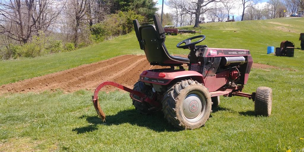

WVHillbilly520H 10,378 #37 Posted April 21, 2020 (edited) I'm gonna throw out a different brand here OTR (OE supplier for Kubota) so... The rears are OTR Lawn Trac R1 (AG) 23x10.50-12 or if you want to stay with turf OTR Grassmaster same size for the rear 16x7.50-8 front I also have my snow chucker set with the R1s on the front. I run the rear tires fluid filled plus iron weights for improved stability and traction and I don't tear my grass up only when spinning out with OLD age hardened turf tires that would bite. Also the Kenda turfs were OE on the xi series so decent tire as well I wouldn't put anything heavier than a 4 ply back on as the 6 ply do not "flex" and therefore reduce traction IMHO. Edited April 21, 2020 by WVHillbilly520H 1 Share this post Link to post Share on other sites

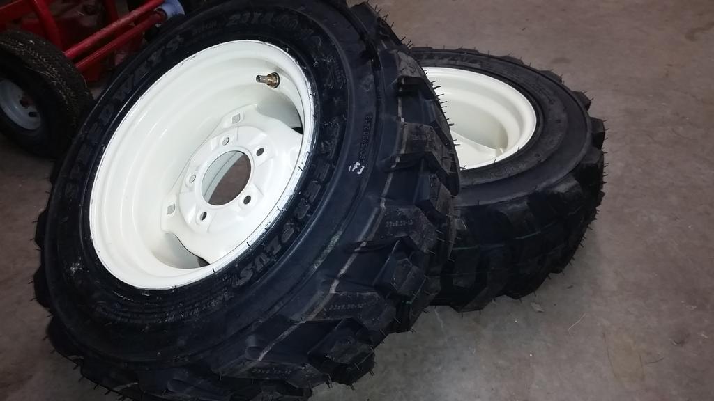

chalupaalien 0 #44 Posted April 21, 2020 21 hours ago, Sparky said: I always recommend these...Carlisle All Trails...best of both worlds . What size are those? Did you get wider rims as well? Considering these for my 314-8 but still want to be able to fit chains and think the 10.5 may be too wide for me. Share this post Link to post Share on other sites
ebinmaine 79,710 #45 Posted April 21, 2020 3 minutes ago, chalupaalien said: What size are those? Did you get wider rims as well? Considering these for my 314-8 but still want to be able to fit chains and think the 10.5 may be too wide for me. @Sparky will be along to tell you what he did to his particular tractor. I did put 10.5 wide tires on my 74 c-160. Cinnamon horse. I put aluminum wheel spacers inside to space the rims out so the chains would clear the brakes. Share this post Link to post Share on other sites
Sparky-(Admin) 25,940 #46 Posted April 21, 2020 23 minutes ago, chalupaalien said: What size are those? Did you get wider rims as well? Considering these for my 314-8 but still want to be able to fit chains and think the 10.5 may be too wide for me. Those tires at 23-10.5-12’s. I bought a pair of the 8.5” wide rims like come on the 520’s and the GT-1800’s. I keep the air pressure lowish and have 25# inner weights and 50# outer weights so I can skip tires chains. Very happy with these tires! Share this post Link to post Share on other sites
