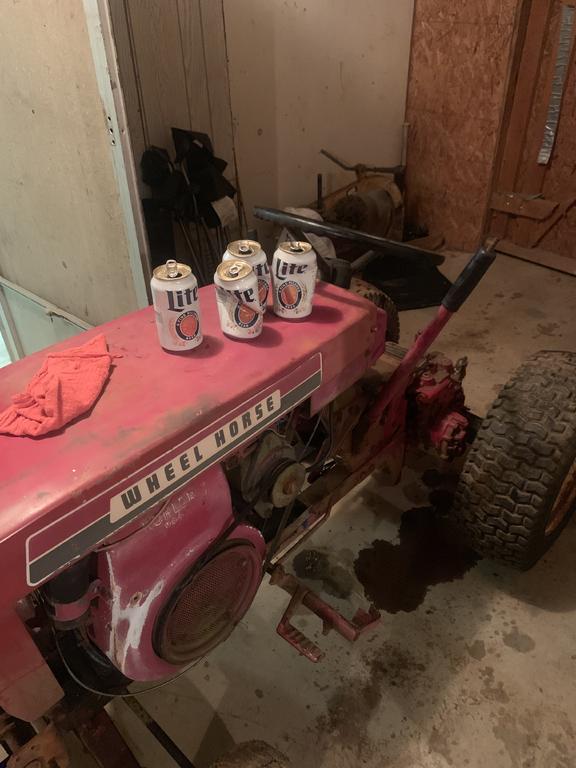

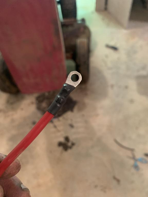

Greentored 3,221 #29 Posted April 24, 2020 (edited) Makeshift exhaust done, fluid change done, got the lift working and deck off, and wired up for push button. Immediately put the old horse out to pasture and she didn’t miss a beat til the clamp on my homemade lift cable slipped. 3 months ago: “seriously, a horse for every implement?” Today: “main horse, trail horse, now dedicated disc horse 👍 first experience with a big Kohler and I see the attraction- whatta thumpin torque monster! @ebinmaine wire ends look good to ya? Haha Edited April 24, 2020 by Greentored 1 4 Share this post Link to post Share on other sites
ebinmaine 81,150 #30 Posted April 25, 2020 Coodna' dunnit bettah mahself You just keep getting implements..... And horseys.... So that Kohler eh?.... Share this post Link to post Share on other sites

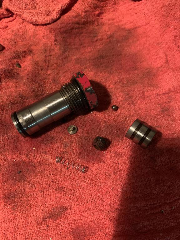

Greentored 3,221 #35 Posted April 25, 2020 Ok fellas, here we go- hydro issues. Before I post up in the trans forum, what model would be in this? All I know is it’s a Sundstrand and all basics are up to snuff. Maybe with a model number I can do some digging. Ol girl won’t climb over a cat turd in reverse, forward is better but won’t turn the tires over. Share this post Link to post Share on other sites

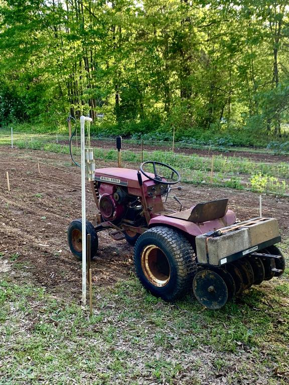

Greentored 3,221 #36 Posted April 27, 2020 (edited) Weekend update: four beverages and a bic pen spring later, overhauled the acceleration valves and pulled a disc through the garden, she will back up a hill and drive over the garage step like a champ! Check balls were stuck and a small spring missing from one of the valves- the one under the little Allen cap in the big 1 3/16 nut. Bic pen spring was all I had and was apparently a close enough match. She even got treated to a bath along with her big brother! Edited April 27, 2020 by Greentored 2 Share this post Link to post Share on other sites
ebinmaine 81,150 #37 Posted April 27, 2020 I can't download videos onto my phone so I can't watch that but I'm glad to see you got it up and running. Way to go using the pen spring. Share this post Link to post Share on other sites
