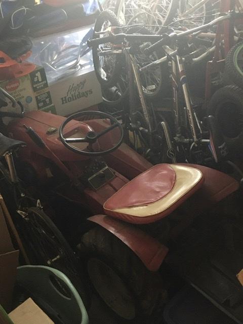

Greentored 3,221 #1 Posted April 20, 2020 If the Raider 12, (tractor #3) I snagged yesterday and posted wasnt confirmation of the addiction, today is. Buddy had this listed 2 miles away and dropped it off. Being kinda new to Horses, wasnt sure what it was but it had a Kohler, foot rests, and a hydro? Research showed most likely a 875, maybe a 1075. Nope. 1277. Never heard of them, but digging online sounds like a picked a winner? One year only? If thats the case, so much for a quick flip. This baby will live the rest of her days in my hands I am 100%, completely, full blown addict at this point and its all you's fault! 2 10 6 1 Share this post Link to post Share on other sites

Achto 32,633 #9 Posted April 21, 2020 (edited) 4 hours ago, Greentored said: 1277. Never heard of them, but digging online sounds like a picked a winner? One year only? From 1960 - 1967 the last number in the model number represents the year that the tractor was built. 1277 - 12 = 12 horse power, 7 = Hydrostatic transmission, 7 = 1967 1257 - 12 = 12 horse power, 5 = Standard transmission, electric start, 7 = 1967 502 - 5 = 5hp, 0 = standard trans, pull start, 2 = 1962 The "0" in the middle of the model number can have some exceptions. A 701 & 702 did come with electric start. There are also some one off middle numbers like the 1045 which is basically a 1055 with clam shell rear fenders in stead of seat pan / rear fender. The 633 was basically a 603 with a Kohler engine instead of a Tecumseh. Edited April 21, 2020 by Achto 1 1 2 Share this post Link to post Share on other sites

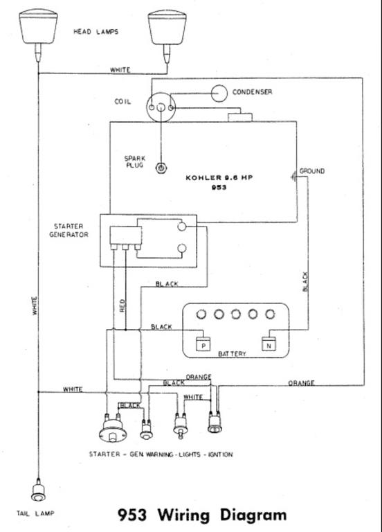

ebinmaine 80,638 #19 Posted April 24, 2020 27 minutes ago, Greentored said: Wiring-wise, it has the standard starter/gen setup and a heavy, double eyelet cable attached to generator A which I need to touch to 12V to whirl it over, as well as a small, standard wire and end coming from the ignition switch start terminal, and no starter push button. This indicates to me that this would be a 'solenoid' model and it is just missing, am I correct? Which wire actually provides the 'charge' for the battery No solenoid 'Red. The S/G will START if current is fed, and CHARGE if spun by engine. Neat system. Check the electric section for the correct schematic. Kohler engines of that era normally want HD30 detergent oil. Transmission..... Could be ATF OR oil. I've said a few times. One tractor per implement is a minimum. Yes they're easy to swap. DON'T tell anyone. Share this post Link to post Share on other sites
Greentored 3,221 #20 Posted April 24, 2020 (edited) 20 minutes ago, ebinmaine said: No solenoid 'Red. The S/G will START if current is fed, and CHARGE if spun by engine. Neat system. Check the electric section for the correct schematic. @ebinmaine thanks buddy! Found a few schematics, and it appears someone in the past had replaced the ignition switch with a blade (light duty?) style and most likely wired in a solenoid. Think ill replace the switch with a heavy duty one and be good to go? Not sure how much amperage goes through that "start" terminal to the gen armature, but it makes a pretty good spark when touching the 12V+ to roll it over and start. Edited April 24, 2020 by Greentored Share this post Link to post Share on other sites
ebinmaine 80,638 #21 Posted April 24, 2020 1 minute ago, Greentored said: @ebinmaine thanks buddy! Found a few schematics, and it appears someone in the past had replaced the ignition switch with a blade (light duty?) style and most likely wired in a solenoid. Think ill replace the switch with a heavy duty one and be good to go? Not sure how much amperage goes through that "start" terminal to the gen armature, but it makes a pretty good spark when touching the 12V+ to roll it over and start. Oh WOW.... GET THAT OUT OF THERE! Amazing what people think.... Or don't. Sometimes. The switch you have is only rated for a few amps. What you want to do is get a 70 amp rated switch from a known good quality company. Battery cables would have been 8 gauge originally and that's okay if they are very new with no corrosion. You really should replace them with 6-gauge if you can. I can get you some more numbers and information later on today if somebody else hasn't done it by then. I did a complete wiring harness rebuild on a 1267. 1 Share this post Link to post Share on other sites
Pullstart 71,212 #22 Posted April 24, 2020 For the wiring, in place of a solenoid if you choose to add one, you could go for the 953 S/G wiring with a heavy push button switch. Simple on/off key to feed ignition coil power and a heavy button to provide the start juice. 1 Share this post Link to post Share on other sites
Greentored 3,221 #23 Posted April 24, 2020 (edited) @ebinmaine whatcha think of Pullstart's diagram above? I can have a 60 amp push button here in 15 minutes. Think 60 would cut it? Edited April 24, 2020 by Greentored Share this post Link to post Share on other sites
ebinmaine 80,638 #24 Posted April 24, 2020 2 minutes ago, Greentored said: @ebinmaine whatcha think of Peacemaker's diagram above? I can have a 60 amp push button here in 15 minutes. Think 60 would cut it? I think the best answer for you is... Probably. IIFF the wiring and connections and grounds are all in good condition I would probably use that. Share this post Link to post Share on other sites
Greentored 3,221 #25 Posted April 24, 2020 Thanks buddy! Kinda like the push button idea even if its not factory correct. Man, considering some of the stuff Ive had to wire and repair on these old musclecars, the Horse will be a breeze. Solder and heat shrink are in my vocabulary. Scotch locks and butt connectors are not 1 Share this post Link to post Share on other sites
