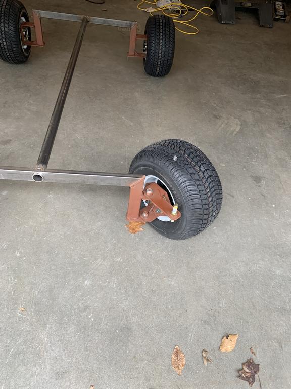

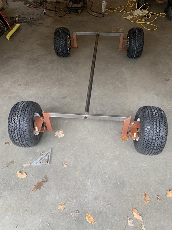

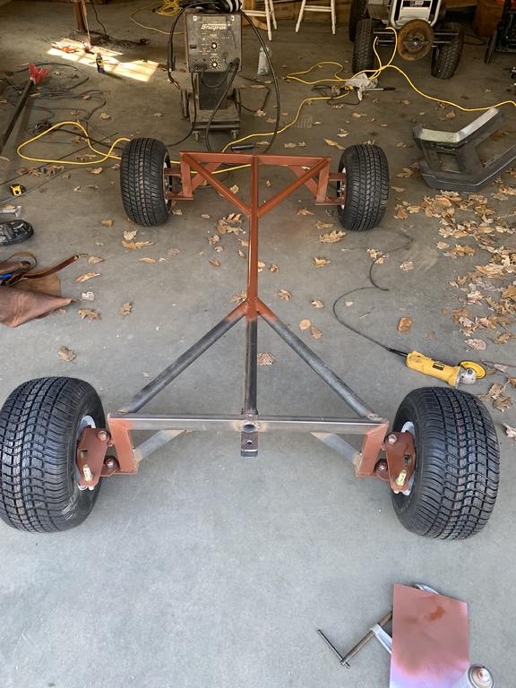

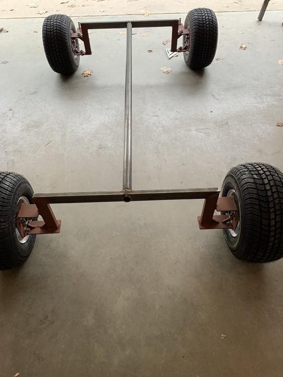

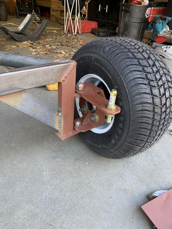

I decided I wanted a small wagon to pull behind my horse. Started out with hubs and spindles from a snowmobile trailer. I should have taken pictures of earlier steps, but I’m more than happy to supply measurements and close up pictures if anyone wants them. More pictures to come..

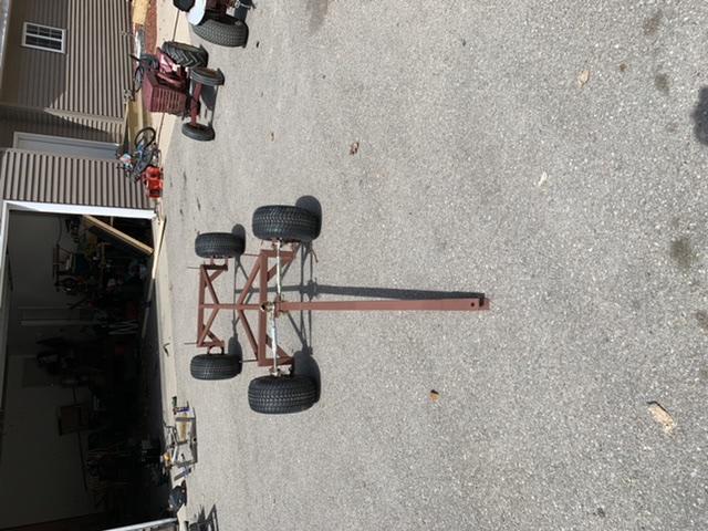

What are the rough measurements?
Ed Kennell
Nice work.    Don't forget a vertical joint when you build the tongue.   Someone on here just built a wagon and forgot this important step.

@Ed Kennell can you post a pic of what you are referring to? I think I understand but want to verify for my own use on my trailers... Thanks.
Ed Kennell
The tongue should have a joint that allows the tongue to move vertically like any Radio  Flyer toy wagon.
Allows hitching to any height drawbar,  operation over rough terrain, and can be lifted back over vertical for storage.See the source image
The spring is not necessary on a light tongue and it would be in the way to store the tongue back over the wagon.

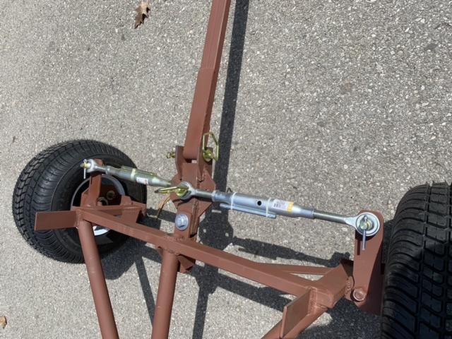

Some update pictures after a few hours out with the kids.

Rough measurements are 5’ wide 8’ long with the deck sitting about 18” off the ground.

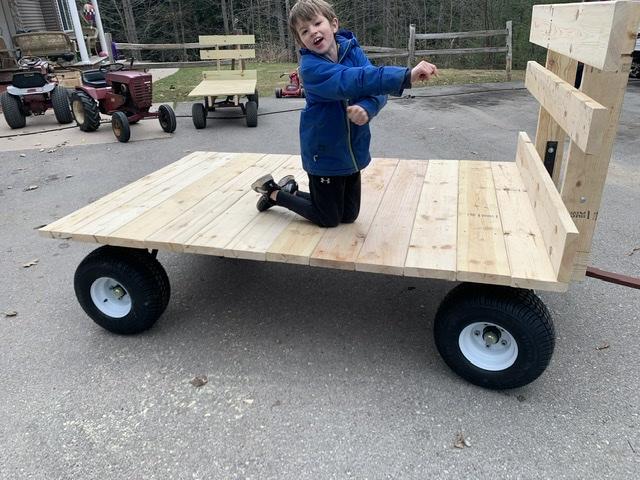

Pat mcgrew

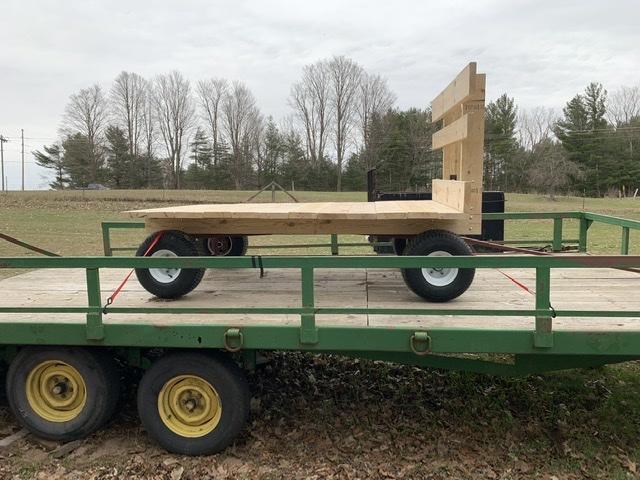

Finished project.
  • Excellent 5
EXCELLENT
