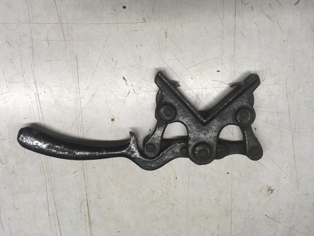

formariz 12,381 #1 Posted April 18, 2020 It’s raining and I can’t be going around checking birdhouses so I got to stay busy. Share this post Link to post Share on other sites
stevasaurus 23,788 #2 Posted April 18, 2020 I think that would have been used to straighten or plumb a fence post and hold it while back filling. 1 2 Share this post Link to post Share on other sites
johnnymag3 2,647 #3 Posted April 18, 2020 looks to me like it would be used to clamp or hold something. Fence post does not come to mind, but Ive been wrong before....Cool looking tool 1 Share this post Link to post Share on other sites
CCW 1,516 #4 Posted April 18, 2020 It appears that the handle articulates which will cause the jaws to close thru the openings of the 90 corner. Perhaps a clamp for some form of framing. 2 Share this post Link to post Share on other sites
Ed Kennell 46,824 #5 Posted April 18, 2020 It certainly could grasp and twist a round or square piece of wood. The key may be in the hook on the handle. Any dimensions Cas? Share this post Link to post Share on other sites
formariz 12,381 #6 Posted April 18, 2020 Getting very warm but need specifics. Tool is 2x2 at the angled part and handle is about 4”. It’s extremely rare. The only ones I ever come across I own. Never seen them anywhere else not even photos of one. There aren’t any marks on them. Perhaps the only tool I own that I don’t know who made it. There are modern versions although looking quite different and totally ineffective compared to these. 1 Share this post Link to post Share on other sites

SPINJIM 1,997 #8 Posted April 18, 2020 Looks like it would clamp onto a piece of angle iron, but for what purpose? Share this post Link to post Share on other sites

Ed Kennell 46,824 #10 Posted April 18, 2020 Wrench for joining wood with these. 1 Share this post Link to post Share on other sites

953 nut 68,241 #13 Posted April 18, 2020 Looks like they would pull miter cut boards tight while banding a crate. 1 Share this post Link to post Share on other sites

8ntruck 9,193 #15 Posted April 19, 2020 My initial thòught was some sort of corner clamp. "Can get by with one, but the proper number is two." "Breathtaking woodwork from the 1800's." This leads me to believe this is a tool that a finish carpenter or cabinet maker would use. 2 Share this post Link to post Share on other sites
Mickwhitt 5,259 #16 Posted April 19, 2020 The unusual shape if the handke has me wondering. Is the rounded notch designed to sit against something? Like a ratchet pawl to hold the tool from rotating with what its clamped to? I also think it might be for gripping round stock not square, vee blocks support round bar not square. I am no wood worker but are they for turning some kind of cylindrical component, like a threaded screw? They would work like a stilson wrench, gripping the part in one direction and releasing in the other. You can tell I'm scratching around in the dark here lol Mick 1 Share this post Link to post Share on other sites

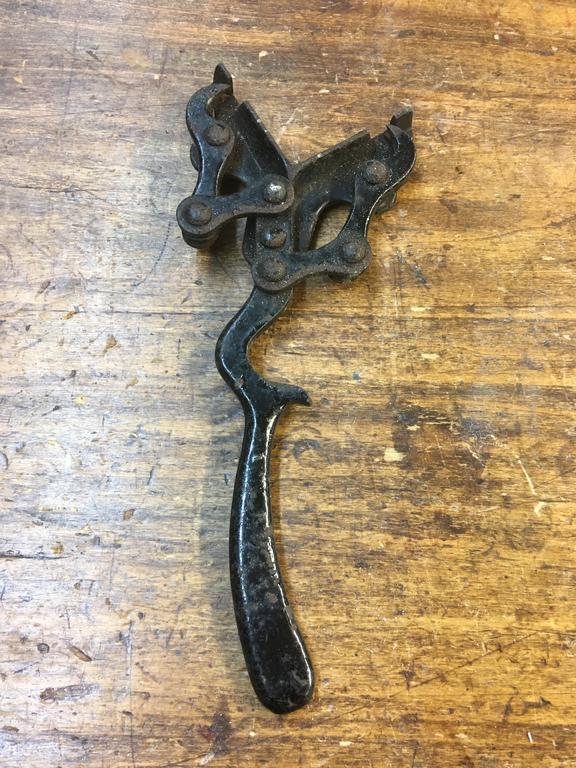

formariz 12,381 #18 Posted April 19, 2020 Another view. Share this post Link to post Share on other sites

Ed Kennell 46,824 #22 Posted April 19, 2020 All I see is a clamp for gluing a corner joint. 1 Share this post Link to post Share on other sites
formariz 12,381 #23 Posted April 19, 2020 1 minute ago, Ed Kennell said: All I see is a clamp for gluing a corner joint. Yes it is. But based on my clues what joint is rather frustrating to keep tight and aligned out on the field ? Not saying that it cannot be used in other instances, it is however king when it comes to that one. 99% of modern types have to be used on a table and cannot really be effective using only one. The 1% that directly mimics this ones function is nothing short of ridiculous. I have used and attempted literally hundreds of methods for that function throughout my life in the search to keep that joint perfect and nothing comes close to this. Not only because how it does that job but also how practical and easy it is to use. No fuss and instant perfection. Perhaps that is why its used was so prominent all over that place. Sometimes we look at "ancient" work and we wonder how were they able to make that so perfect and keep it that way? There is always an answer, just not always that obvious. @Mickwhitt I will be very interested in the actual source you found it on. Based on the information you gave me I still cannot find it mentioned anywhere. Incredible that you found it there. Really obscure item since besides Zev I never found anyone else that knew about it and I have been with quite a few older craftsman all my life. Really curious as to the date of manufacture. They must have also come in different sizes because I remember marks at different distances from the corner depending on how large these pieces were. Share this post Link to post Share on other sites
