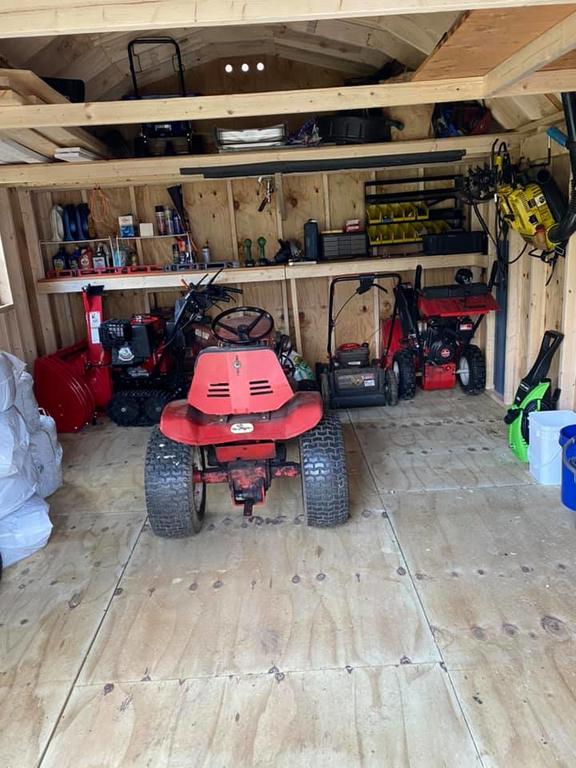

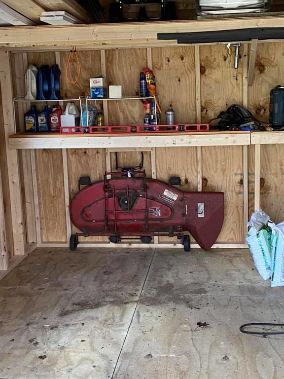

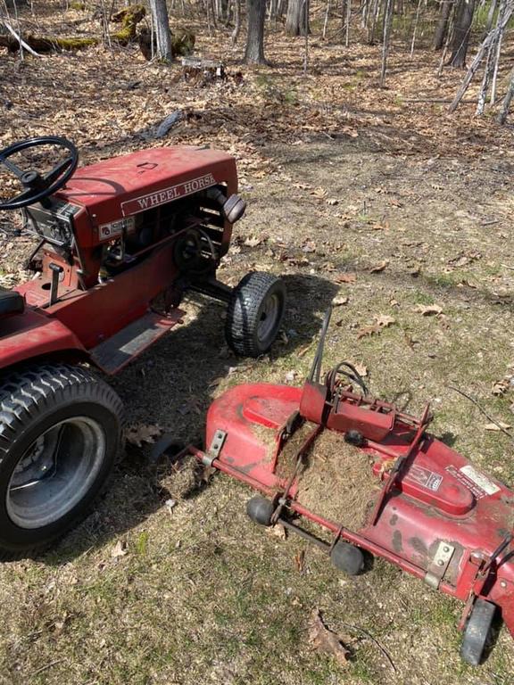

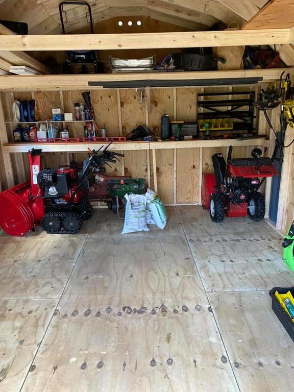

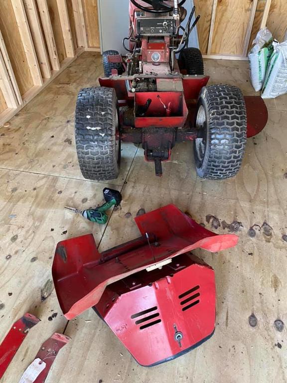

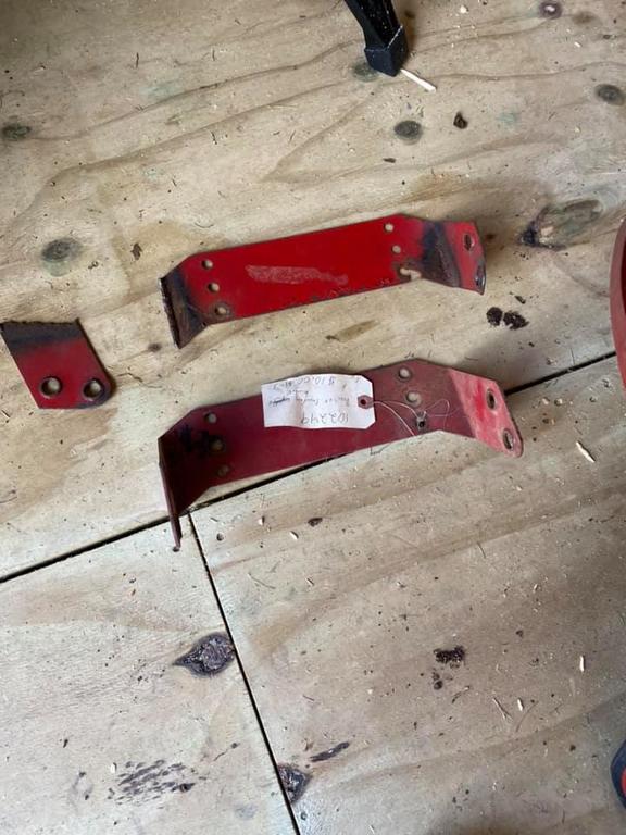

River19 87 #1 Posted April 11, 2020 Well, with the COVID19 quarantine in full force I have been working on building out the interior of my new shed (moved to this house in August and had shed built in September or so). Plenty of organization projects, built the workbench, shelves, a mini loft for fertilizer, built and equipment rack for yard implements etc. And of course this is the home to the 1975 C-160 Auto........the tractor my father bought used in the mid 1980s (I could always pull the actual classified ad from back then as he clipped it and gave it to me in 'his tractor folder'). Today I spent a couple hours working on some Tractor things: Pulled the fender and finally replaced the rear hinge bracket Pulled the mower deck (won't be used on this property most likely) Stowed the deck in its new place at the back of the shed Power washed (gently) the 160 Stowing the deck allowed me to move the Honda blower into the shed (next snow is my fault) Then moved all the kids into the pool to make sure there is plenty of room in the man cave.....and there is..... I am waiting on some oil and new plug etc. I will be doing an oil change, new plug, air filter, rear end oil change..........I'll be picking up a new cart and harrow for some projects here at the house in NH and I'll start the impossible hunt for a mid mounted grader for the 160.......I have a better chance at striking gold. I will be asking stupid, obvious questions and I appreciate the passion you all have for Wheel Horses.....they really are amazing machines. Oh.....and I put gas in it today and low and behold it fired right up..... PS. The K341 is a 12 fin..........not the more desirable 13 lol oh well...... 6 5 1 Share this post Link to post Share on other sites

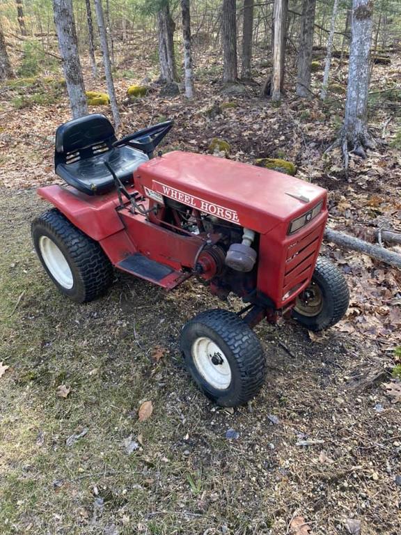

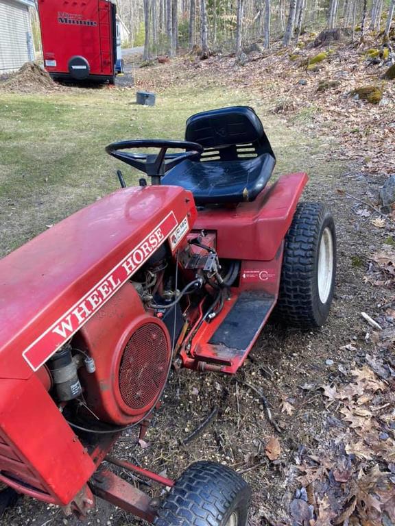

River19 87 #18 Posted May 3, 2020 After running the tractor the past 2-3 weekends for some projects around the yard (quarantined and all) I decided spend an hour or so doing the long needed tune up. Changed the oil, plug, air filter, installed new fuel line and fuel filter and new air filter. Only thing that was slightly wonky was the oil drain "tube" much preferred to unscrew from the 90 degree fitting coming off the base of the engine. Whomever put the "cap" bolt on the drain tube last time snugged that thing up like it was going to leak COVID 19 or something......so I drained it by just taking off the whole damn tube......had a little mess to clean up afterward on the front axle as you would expect. After the "tune up" she fired right up strongly. I noticed over the years it would always stumble when raising up the throttle so going from idle to 3/4 - full throttle...... and yesterday prior to fixing things up I noticed it sounded like it may stall when at idle while I was loading the cart. Seems like both situations improved with the new engine love. Getting there....... I was going to pull the cover for the drive belt to track down the e-brake issue I have but that seemed a little more involved than I wanted. Can someone confirm the bolts that need to be removed for that? Looks like on up front by the PTO and in the rear, but the foot board looks like it may need to be pulled to get the cover off right? Thanks 1 Share this post Link to post Share on other sites
ebinmaine 81,150 #19 Posted May 3, 2020 7 minutes ago, River19 said: foot board looks like it may need to be pulled to get the cover off right To see the whole drive mechanism the side step, belt cover and shifter plate will need to come off. 1 Share this post Link to post Share on other sites
