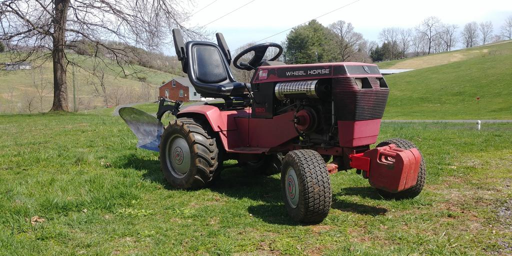

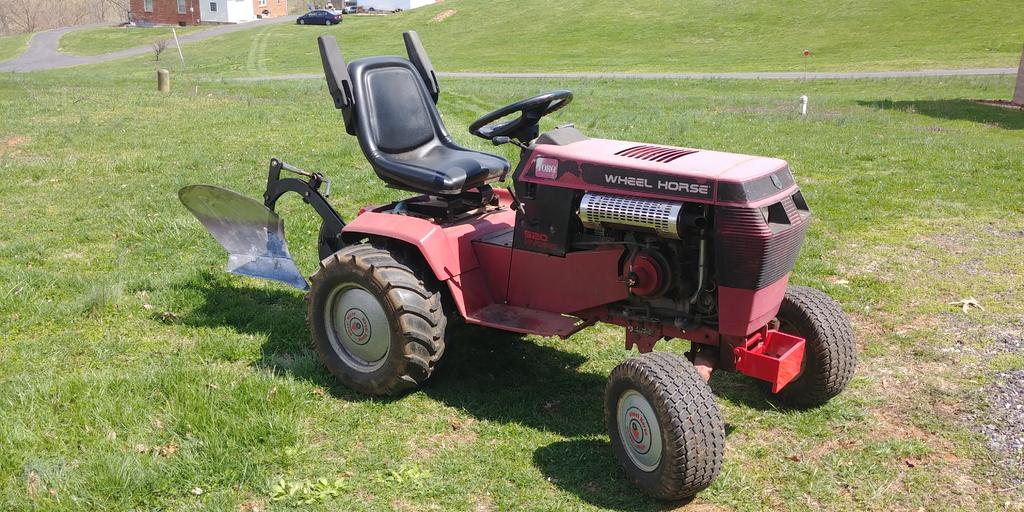

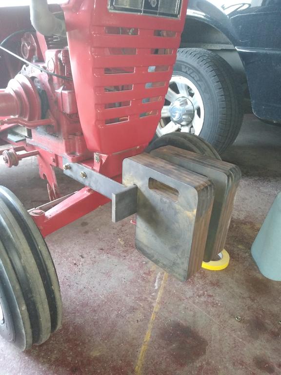

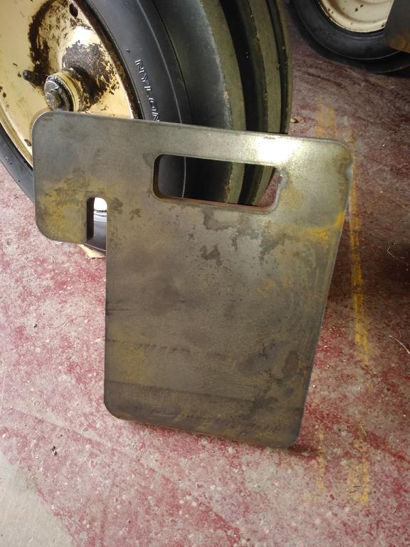

Solze1267 202 #1 Posted April 11, 2020 Well the time has come that I needed some extra weight on the front of my 1267. Had a friend with a CNC plasma table cut out some 10 pound (really 10 1/2 but who's counting)suitcase weights. Built a front hanger/bumper for it and boom 105 adjustable pounds up front. Now to take it back off and prime and paint it 3 11 Share this post Link to post Share on other sites

Tractorhead 9,217 #4 Posted April 11, 2020 Great Solution, make it simple to handle and easy to use. The ability to „hang on what you need“ i see as a big Benefit. With another added mounts in the Mid and on the Rear you can also simply balance to mid or rear, where ever you need the Weight. Well done. 2 Share this post Link to post Share on other sites

Pullstart 71,160 #6 Posted April 13, 2020 (edited) Awesome work! Are those mounting bolts grade 8? I can see anything softer shearing off after time... Edited April 13, 2020 by pullstart Share this post Link to post Share on other sites
Solze1267 202 #7 Posted April 13, 2020 @pullstart they are grade 8 all they way from bolt to nut 👍🏼 1 1 Share this post Link to post Share on other sites
