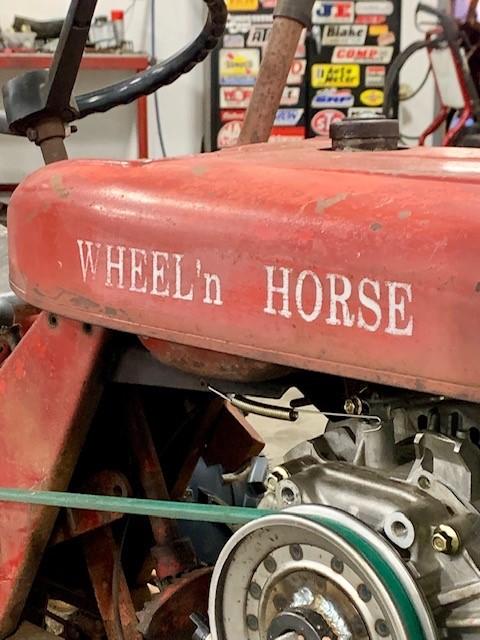

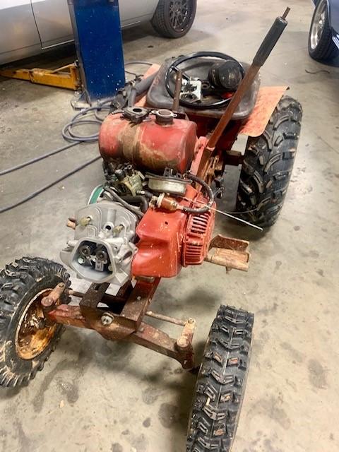

Greentored 3,221 #26 Posted April 17, 2020 Between a couple evenings and this week's 'mental health' afternoon, she got a name change and made it official, her new heavy duty hubs and a set of beefy tires done. Added a second set screw to the hubs, slotted the axles and installed full length keys. First true offroad ride, she did excellent, but changes need to be made. I now understand why a couple of you mentioned "light front end" HA! It is flat out scary going up any decent incline, and im talking 2-3mph, near idle in first gear. The slightest change in throttle or traction and the front end comes up, and doesnt want to come down. Yes I got 'bucked off the horse" once, over backwards, and it hurt, im not 20 anymore. Shes getting loaded front tires and a weighted front bumper and/or wheelie bar immediately. The taller 25x8 rears are actually closer to 3" taller, and top speed is closer to 30mph or more now, rendering 3rd gear useless and even second gear nearly the same in offroad situations. Shes getting a pulley and belt swap with a goal of a more 'rock crawler' first gear and maybe 15mph top speed. The transmission is not disappointed in this decision, although she has been flawless thus far. The funny part is how many folks think this whole thing is nuts, ridiculous, childish, redneckin' at its best, yet it gets more thumbs ups and 'fist pumps' out the window by passersby than any hotrod Ive ever driven, and now a few others are suddenly asking questions about tractors they found on the local marketplace. .....Cant deny the nuts, ridiculous, childish, or especially redneckin at its best, and couldnt care less. Life is to be enjoyed! "Do what makes you happy- they're gonna talk about you anyways" 1 1 2 Share this post Link to post Share on other sites

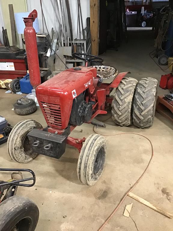

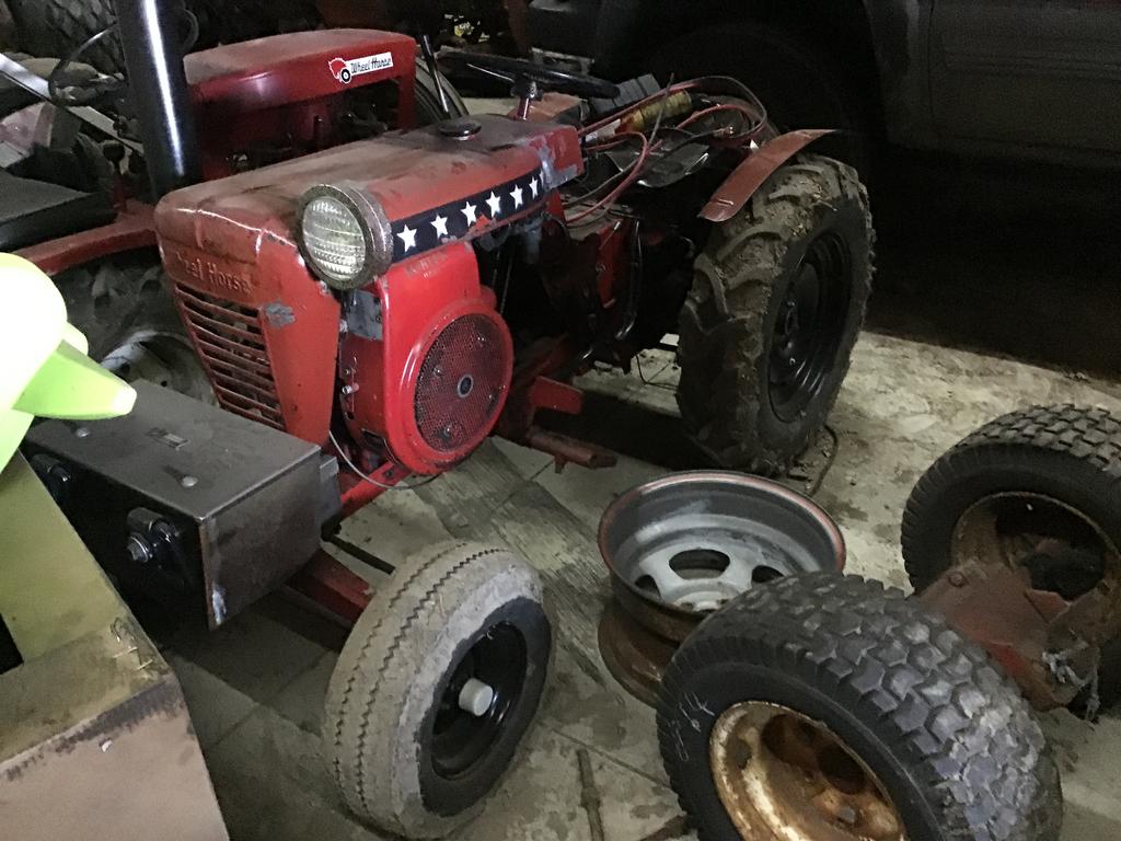

Pullstart 71,482 #27 Posted April 17, 2020 WHEEL’n HORSE looks great! I like the tire combo! The cement filled box hanging off of Putt Putt is easily removable... with some SBC manifold bolts just pinning it in place and the weight of the whole thing wedging it there. Between that and my loaded tires, it hasn’t come off the ground since! Frank’s box holds a battery, starter solenoid and a buncha steel! No loaded tires, but he’s planted firm on the ground. They are both proportionally scaled to each other in height and width. I think for Frank, 1.4 was my multiplier. Why would I remember that? Who knows... 1 Share this post Link to post Share on other sites
Pullstart 71,482 #28 Posted April 17, 2020 Here are some links to show how I “spotted in” the front hanging mount on the frame. Yellow paint marker was my spotting dye. On the ‘62 frame with the flat front, the angle iron was simply cut flat to rest straight across the front. Comparing the ‘62 to ‘64 front end First assembly after paint Shot of the weight off after a couple years’ use 1 Share this post Link to post Share on other sites

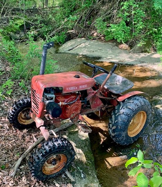

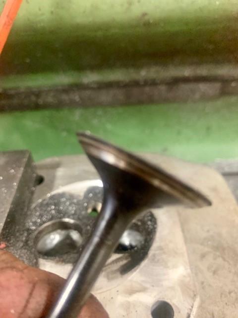

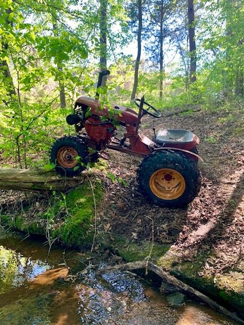

Greentored 3,221 #31 Posted May 1, 2020 Gosh, its hard to figure out a good place to post updates.Think ill just keep this thread going for the ole 654 trail bomber. Shes been getting a back property ride every 2-3 days and doing great! Fabbed a wheelie bar with a solid link to the hitch lever and added a stop to it. Now can keep the bar out of harms way, and drop it in a moments notice when its time to climb a steep hill or questionable terrain. ...then decided, as if it isnt already a handful, lets beef it up some more! Purchased a .010 shim steel head gasket to replace the .040 stock one, did the calculations and milled .050 off the head which takes it from a calculated, CCd 8.4:1 to 11.5:1, and as long as I was there, ported the head and back cut the valves. Did it make the difference I expected? No. Does it have more authority, a much meaner 'bark', and will it lift the front tires on a roll in second gear without any clutch help? Yep. I truly cannot wait til all this corona crap is over so I can attend a meet and put some names to faces. This ole girl will definitely be in attendance! 2 2 1 Share this post Link to post Share on other sites

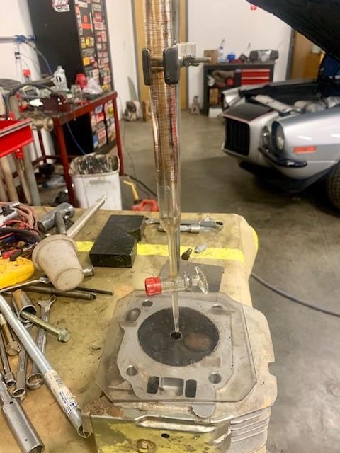

tom2p 2,396 #32 Posted May 1, 2020 (edited) cool ! with that top speed you might be able to drive it to a meet lol first pic above - are you cc'ing the head ? ( heard the term but never saw it performed ) assume higher octane needed ? colder plug ? can you feel the additional compression when you pull start ? Edited May 1, 2020 by tom2p Share this post Link to post Share on other sites
Greentored 3,221 #33 Posted May 1, 2020 7 hours ago, tom2p said: cool ! with that top speed you might be able to drive it to a meet lol first pic above - are you cc'ing the head ? ( heard the term but never saw it performed ) assume higher octane needed ? colder plug ? can you feel the additional compression when you pull start ? Haha, I have driven it home a few times and made a beer run on it Granted, all three places are less than 2 miles, but anything to embarrass the girlfriend when I roll through the neighborhood on it. Yes, CCing the head in first pic. Yes, definitely needs 93 octane now, or at least 89. Same plug, no issues there. Due to the compression release, it still pulls over pretty easy, but can definitely feel it 'snap' over now, and when you kill the engine, it comes to a much more abrupt stop. The difference in throttle response and 'bark' out of the stack is day and night. It definitely does not sound like a generator engine anymore ha. 2 Share this post Link to post Share on other sites
