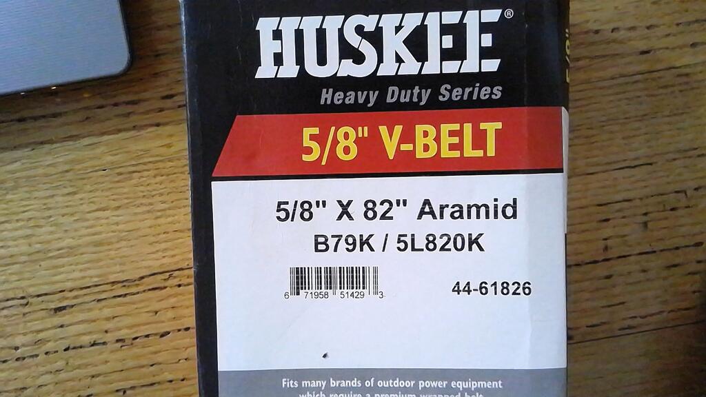

pen414 13 #17 Posted June 26, 2020 (edited) Just wanted to share an update. I ordered a wheel horse branded 7473 belt, but a 7478 belt arrived and looks great, however, this belt is too big. Time to see how an ebay return works. I really wanted to replace it with an "authentic" belt since the original has held up so well, but I gave up and went to Tractor Supply and picked up a 5/8 x 82 belt that works well. Hopefully I'll get decent life out of it. I'll attach a pic of the belt's box in case that helps anyone else. Thanks for all the helped out. Edited June 26, 2020 by pen414 Share this post Link to post Share on other sites
