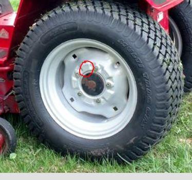

Bill D 3,193 #15 Posted April 9, 2020 Those rear wheels should fit fine, just flip them around. The only difference is the valve stem will be on the outside. I saw a setup like that on my neighbor's John Deere. I put front wheels from a 264 on my GT-1642. They will fit fine, but the hub caps are different. 1 Share this post Link to post Share on other sites
Dan.gerous 2,696 #16 Posted April 9, 2020 5 hours ago, Bill D said: Those rear wheels should fit fine, just flip them around. The only difference is the valve stem will be on the outside. I saw a setup like that on my neighbor's John Deere. I put front wheels from a 264 on my GT-1642. They will fit fine, but the hub caps are different. They are on the way, will get a picture of them on once they arrive. I thought the valve being on the inside was already odd, most vehicles it's on the outside I thought. Any idea what the reason behind an inside valve is? Share this post Link to post Share on other sites
Pullstart 71,520 #17 Posted April 9, 2020 5 hours ago, Dan.gerous said: They are on the way, will get a picture of them on once they arrive. I thought the valve being on the inside was already odd, most vehicles it's on the outside I thought. Any idea what the reason behind an inside valve is? Protection from the elements for nature is my guess plus, WH engineers wanted us to learn to stand on our heads to operate an air chuck! 1 Share this post Link to post Share on other sites
RandyLittrell 3,946 #18 Posted April 10, 2020 Those flat spots are there so they can be used either way. I have used many wheels both ways. Randy 1 Share this post Link to post Share on other sites
WHX?? 58,347 #19 Posted April 10, 2020 On 4/9/2020 at 3:37 AM, Dan.gerous said: reason behind an inside valve is? I always guessed so wheel weights could be added. 1 Share this post Link to post Share on other sites
Dan.gerous 2,696 #20 Posted April 11, 2020 12 hours ago, WHX24 said: I always guessed so wheel weights could be added. That makes a lot of sense. Share this post Link to post Share on other sites
Dan.gerous 2,696 #21 Posted April 15, 2020 My wheels have arrived 🙂 No time to check the rears for fit yet but will let you know when I get around to it. Most importantly is I now have a front wheel that isn't flogged out. Share this post Link to post Share on other sites
Dan.gerous 2,696 #22 Posted April 23, 2020 I can confirm that the 246 h wheels fit the C125 no problem at all That's awesome as now I can have a set filled with water for the tiller tractor. Share this post Link to post Share on other sites
