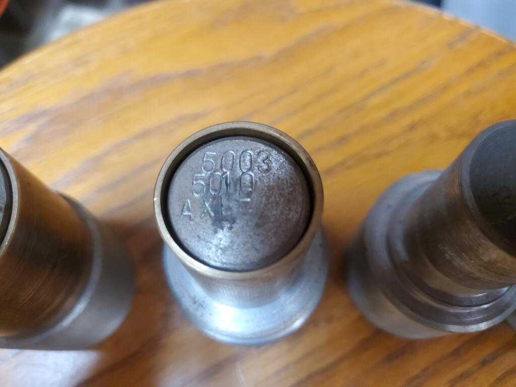

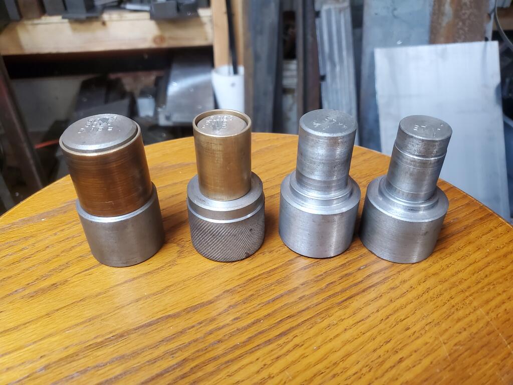

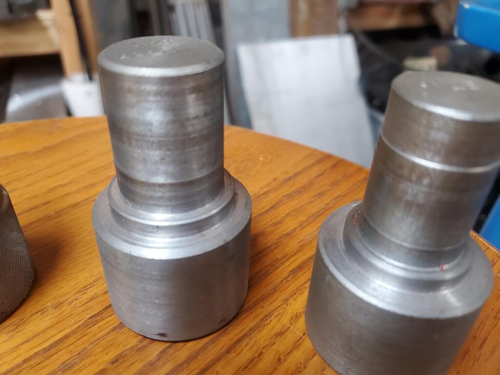

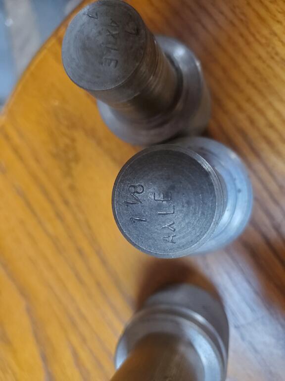

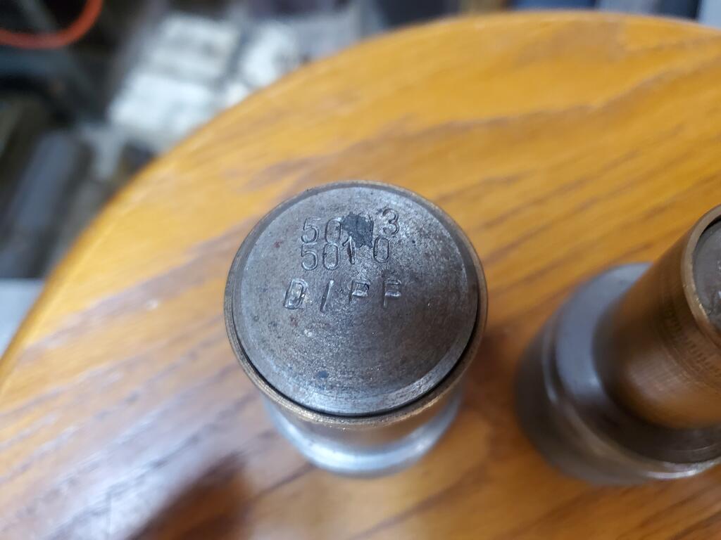

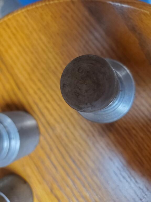

Shynon 7,567 #29 Posted June 17, 2020 Made these bushing drivers for the 5003/5010 transmission to press in the differential bushing and axle bushings. Also made for 1" and 1 1/8" axle bearing and seal drivers, puts the bearing to correct depth with the step. Then installs the seal little recessed from the axle casr. 8 7 Share this post Link to post Share on other sites

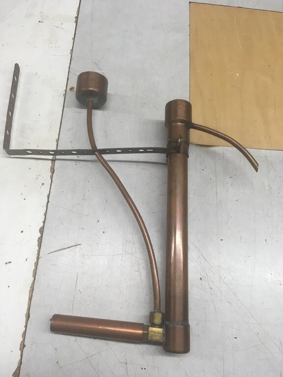

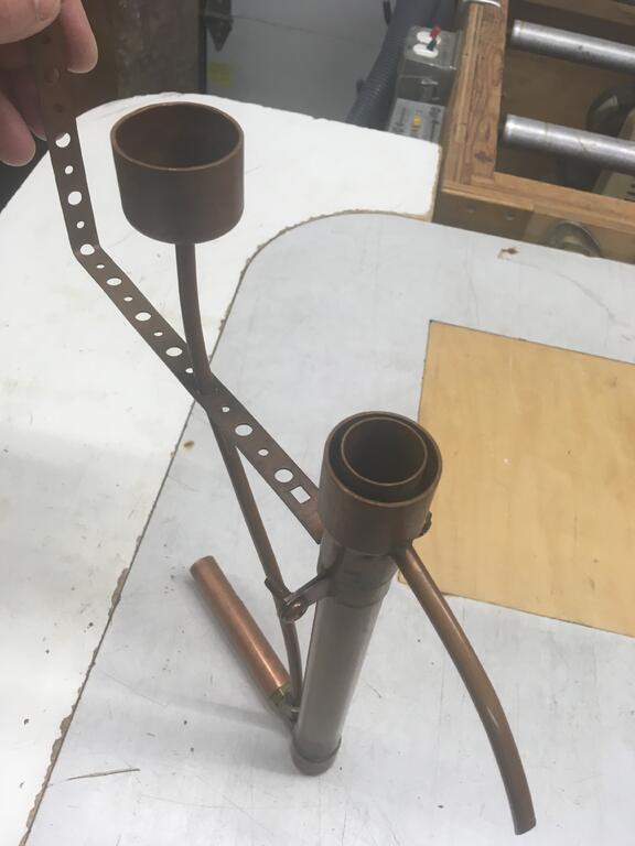

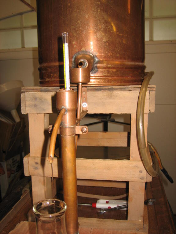

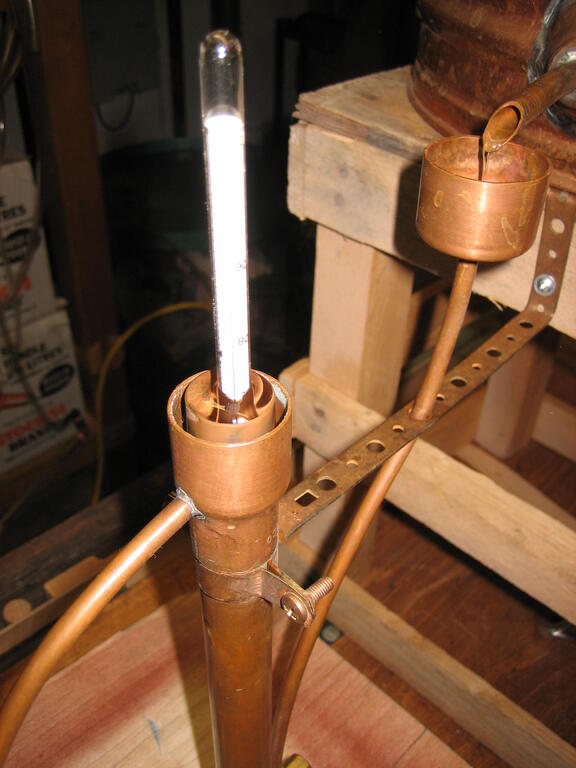

formariz 12,359 #34 Posted June 18, 2020 It’s not always about wood here. Here is another tool I made for my other activity. Share this post Link to post Share on other sites
prondzy 3,889 #35 Posted June 19, 2020 19 hours ago, formariz said: It’s not always about wood here. Here is another tool I made for my other activity. care to elaborate? Share this post Link to post Share on other sites
formariz 12,359 #36 Posted June 20, 2020 On 6/19/2020 at 6:40 AM, prondzy said: care to elaborate? Its a "parrot" . Used while distilling for constant monitoring of alcohol proof. 2 2 5 Share this post Link to post Share on other sites

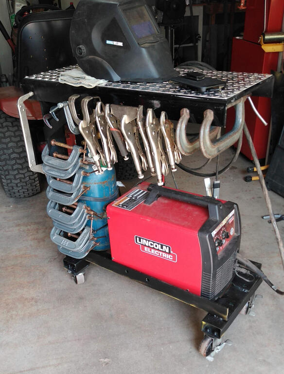

edgro 680 #37 Posted June 21, 2020 homemade welding cart / clamp & vicegrip holder 9 Share this post Link to post Share on other sites

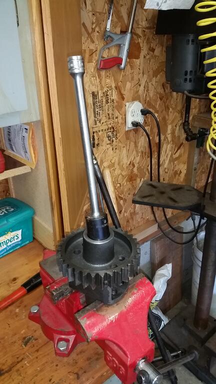

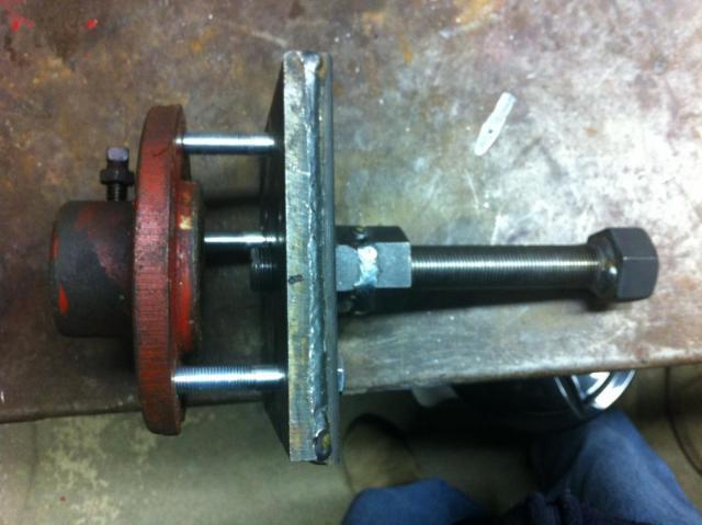

squonk 46,394 #40 Posted September 27, 2020 My hub puller 1 1 Share this post Link to post Share on other sites

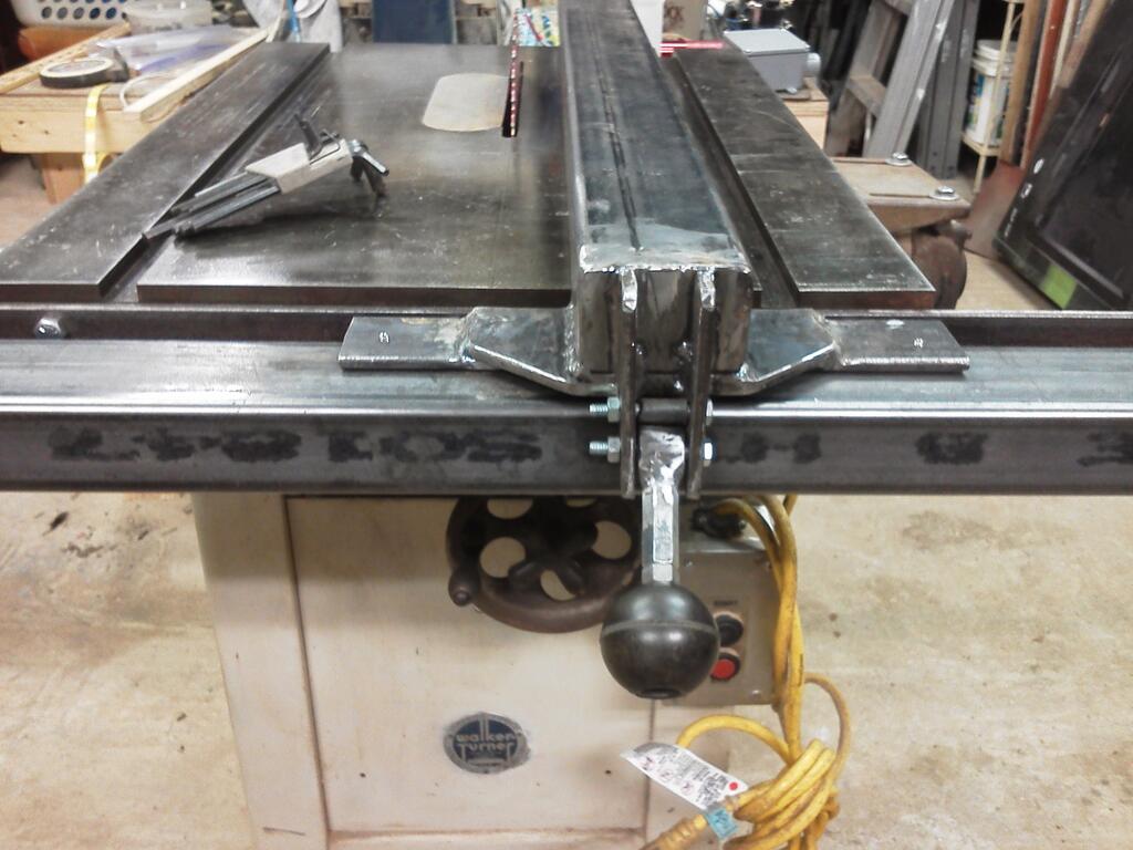

JPWH 6,544 #41 Posted September 27, 2020 Table saw fence. For my Walker Turner table saw. 1 4 1 Share this post Link to post Share on other sites

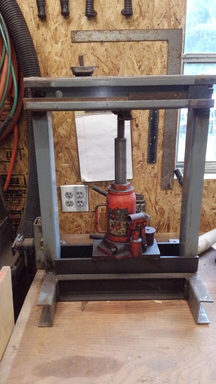

JPWH 6,544 #42 Posted September 27, 2020 Small hydraulic press. The bracket on the left side is for holding a Kohler engine block. I just clamp it down when I need it. 5 Share this post Link to post Share on other sites

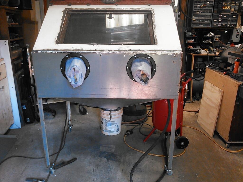

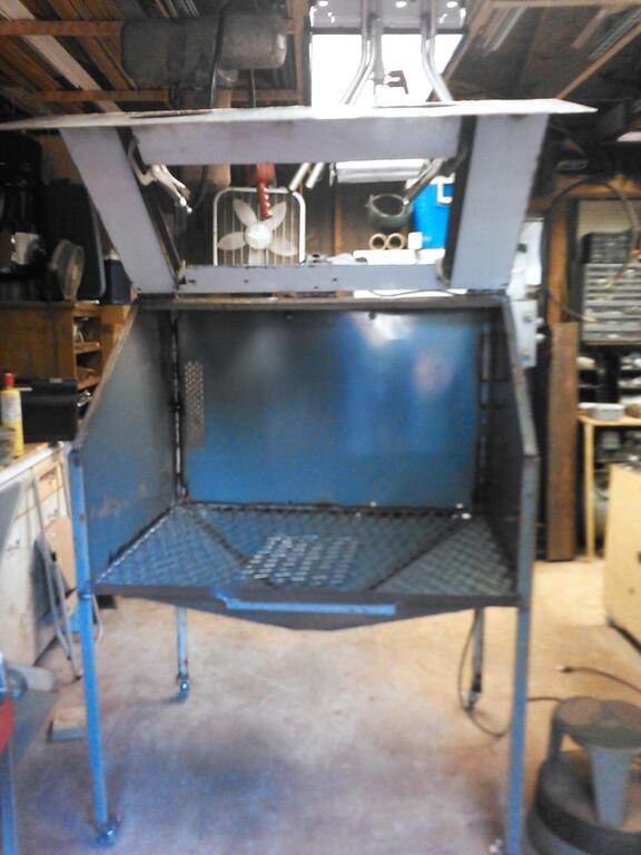

JPWH 6,544 #43 Posted September 27, 2020 Media blast cabinet. 48" wide by 30" deep. My hobby budget is not enough to buy large tools so I have to get creative at times. 4 1 Share this post Link to post Share on other sites
ebinmaine 78,655 #44 Posted September 27, 2020 1 hour ago, JPWH said: hydraulic press That's one of my "someday" welding projects. 1 Share this post Link to post Share on other sites

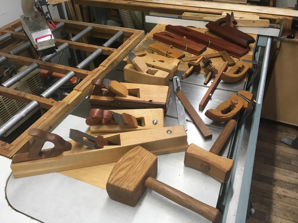

DennisThornton 4,773 #45 Posted October 7, 2020 On 4/17/2020 at 11:24 PM, formariz said: Some of mine. Wow! 2 Share this post Link to post Share on other sites

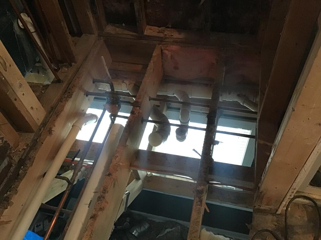

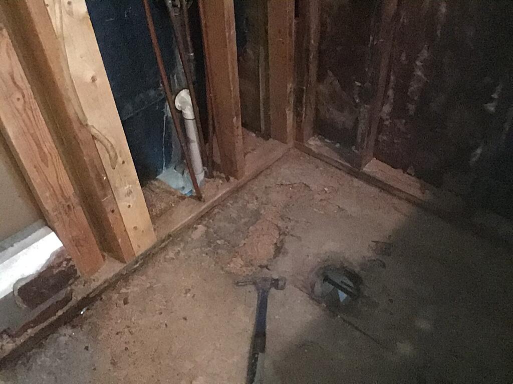

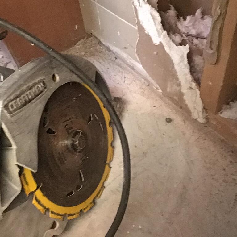

Pullstart 69,911 #46 Posted November 25, 2020 This, I did not make. I did however, modify it for my needs. It is not quite OSHA any longer. It does work great for it’s purpose. It is a flush cut saw, I think. I modified it to cut on a negative angle, like 5 degrees maybe? Without the guard or fence, I can flush cut a floor out if it’s rotten, right along the edge of the room. 1 Share this post Link to post Share on other sites
