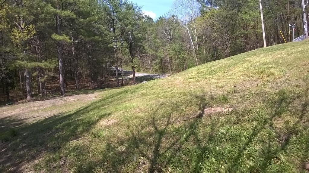

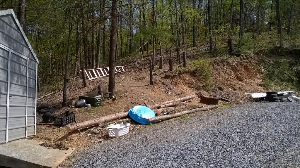

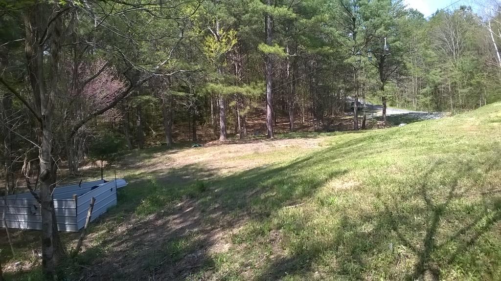

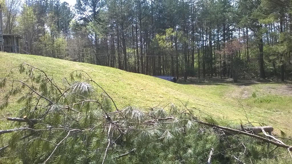

Charrie 18 #1 Posted April 3, 2020 1994 420H Our yard has some pretty steep hills and last year the stock turf tires would slip if the ground was the least bit wet. Going down down the hills the tires would slip sometimes. We learned to try going at a 45 degree angle up and down. We also have several acres of wooded areas that we are working on thinning out the small undergrowth so i was thinking that overall the agra tires might work best for us. The original tires are dry rotted on the sidewalls and the right tire is starting to loose air every other day or so, so i have to do something. I guess one could put a tube in the tires for temporary but not sure how long that would last and would not solve the sliding problem. I grew up on a small farm with a Wheel Horse Charger 12 hydro and 48" deck. Maybe just because I was so used to the Charger 12, the 12 as I remember was more stable and pulled better then the 520 out in the woods and pasture. WE have only had the 520 for less then a year so maybe i just need more experience with it. But back to the tires, what do you all recommend? Share this post Link to post Share on other sites

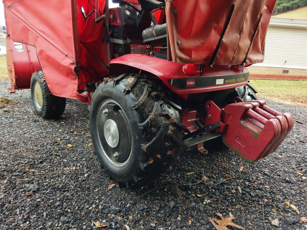

WVHillbilly520H 10,378 #9 Posted April 4, 2020 10 minutes ago, WHX24 said: I like Diggers advice and do switch backs on the hills. They will tear it up abit if really soft and wet but nothing terrible. From what you described ags might in your future. Guy we all know and love here @WVHillbilly520H runs ags all over his property with heavy tractors all the time .. let's hear what he has to say. Thanks Jim, yes AGs year round and quite honestly I'll say there is less if no damage to the lawn vs running turfs because I'm not slipping sliding and spinning out plus I live on a rolling hill and I do run fluid filled (rear only) and iron weights as well on all 3 of my horses (last 2 pics inside plus outside weights and fluid). 5 2 Share this post Link to post Share on other sites
WVHillbilly520H 10,378 #10 Posted April 4, 2020 1 hour ago, ebinmaine said: The Cub may have calcium chloride in it. Best to avoid that due to corrosive nature. I use and recommend Rimguard. Others use RV antifreeze or windshield washer fluid winter blend. 6 ply wouldn't be necessary for weight reason but should be a tougher tire tread as you stated. Yes on 1,2 and 4 , I have no experience with 3 , as far as 6 ply tires they will ride very rough and go with the 4 plys max. 1 Share this post Link to post Share on other sites

JoeM 9,618 #19 Posted April 7, 2020 Just curious, what kind and condition are the turf tires are on the machine now? Judging by the last pic and comparing to the roof pitch of the building in the background, a good set of turf tires should be good on that the hill. I would say you are just at 15 degrees. Do make sure your air pressure is correct in the tires, to much bulges the center and you loose grip surface. I run 12 - 13 psi in all the tires. 1 Share this post Link to post Share on other sites

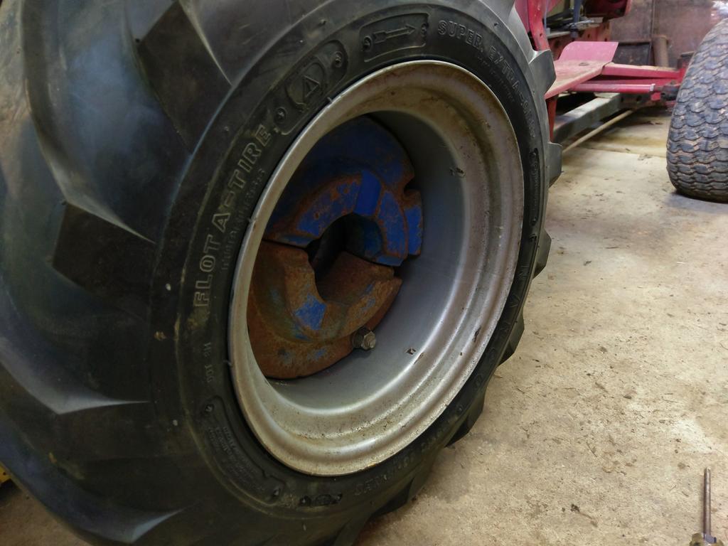

WVHillbilly520H 10,378 #20 Posted April 7, 2020 (edited) One thing to note about tires in general as they age the rubber actually hardens and has less traction/bite if your 520 still has the original Dico branded tires they are most likely to hard to grip the surface , of course wheel weights and/or fluid filling would help this out but newer soft rubber would be better whether turf AG or trail. Edited April 8, 2020 by WVHillbilly520H 2 Share this post Link to post Share on other sites
bo dawg 565 #21 Posted April 13, 2020 (edited) I would say he has the factory Dico style tires, they're a rounded looking worthless tire in my eyes. They can slip on flat surface sometimes. Get rid of them and you can go get any other turf tire and be better off. The sharper the edges of the turf tread and sq shoulders the better and you should be fine. I agree with Tractor Junkie, may have too much air pressure too, too much too hard. But if you aint afraid of having some Ag bar impressions in your yard then I would just get a mild Ag tire, not aggressive..... I'm just saying.... Edited April 13, 2020 by bo dawg Share this post Link to post Share on other sites

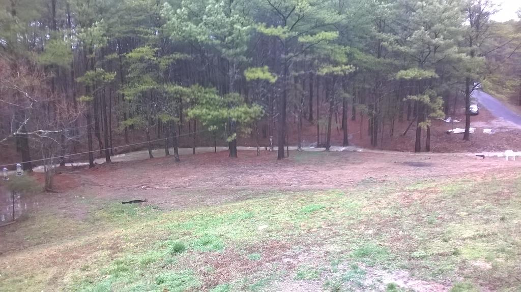

Charrie 18 #22 Posted April 13, 2020 Quote The stock tires are a bit hard. last year we were running around 15lbs of air. This year because one leaks down, we are using about 30lbs. Now if the land is good and dry, it does fairly well on the grass.. The problem is our home site is cut out into the side of a large hillside. It is 300' on up to the top of the hill from the back of our house. During a rainy season, water comes out of the hillside behind the house and is channeled around the house. If the rain holds for a week then it starts to dry up really good. There is a lot of slate like rock so the ground is fairly porous. I think the agra tires would work best for what we plan to use the tractor for. 2 Share this post Link to post Share on other sites
