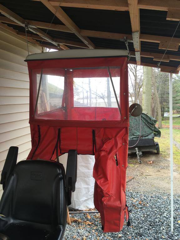

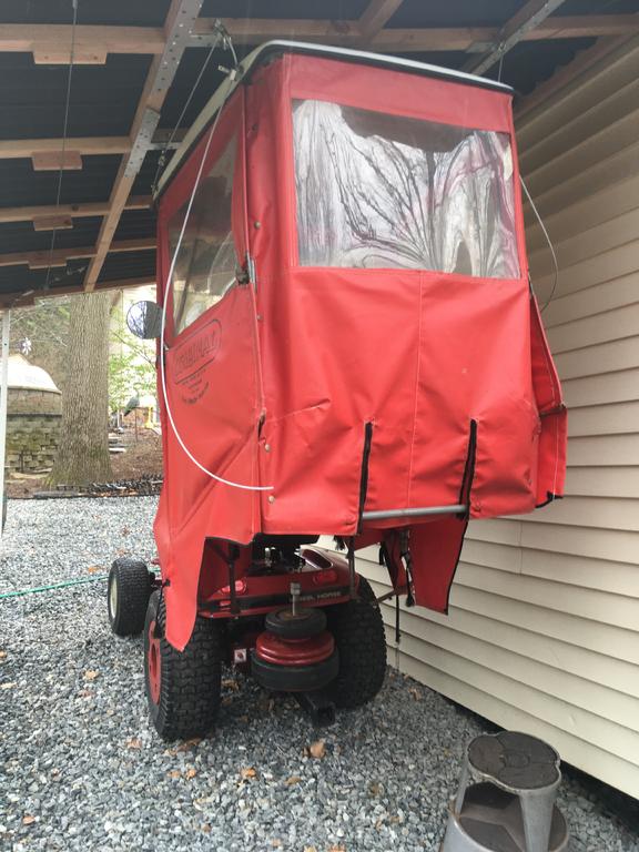

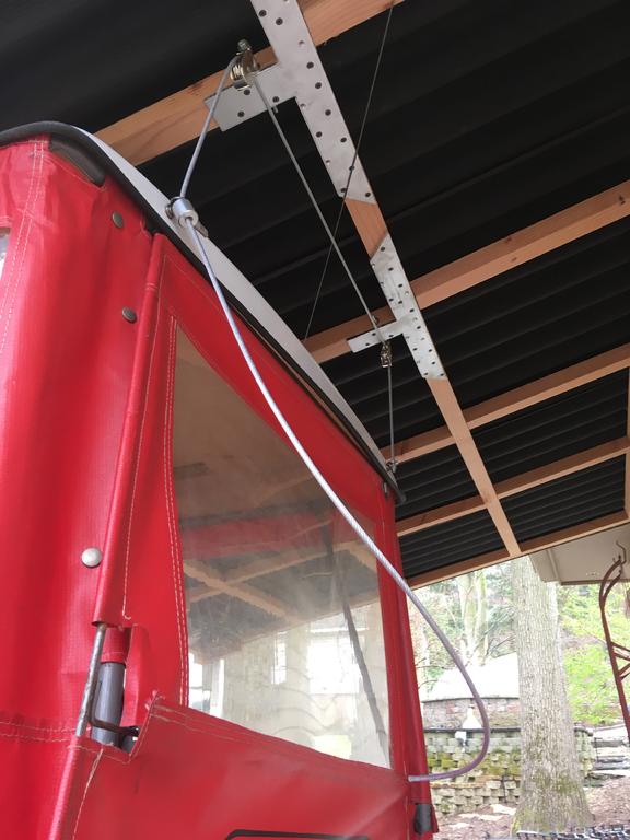

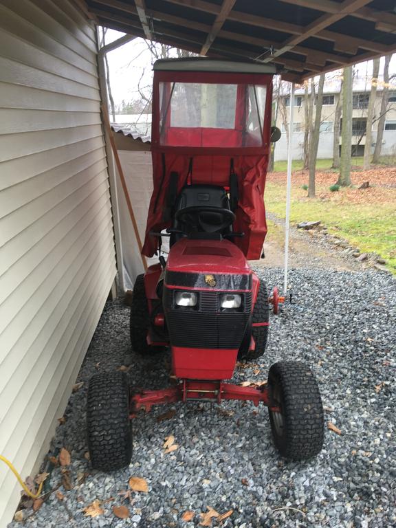

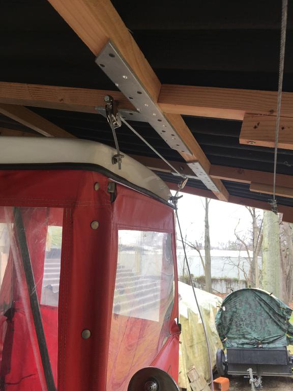

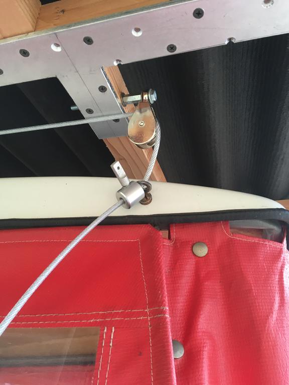

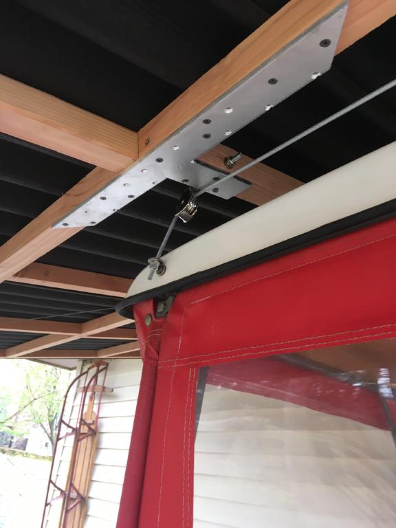

formariz 12,359 #1 Posted April 3, 2020 So it was time again to remove cab and blower which went unused this winter. Cab is really a pain by myself both to remove and to store. Not wanting to break it apart again, I thought of lifting it right off the tractor in one piece. Devised this simple rig attached to my collapsible lean-to. Worked really well. Removed cab in minutes. Simply unbolt it from tractor and lift one side a little each time until all the way up. Then simply drive tractor out. To install will just be the reverse. I may move this to a more permanent location eventually so I can lower lean-to if I have to. 7 4 2 Share this post Link to post Share on other sites

squonk 46,685 #4 Posted April 3, 2020 I thought of something like that, but I ended up removing the roof, popping off the doors,unclipping the vinyl and taking off the framework in 2 pieces. Took less than 30 minutes to remove. and about 40 to go back on. I can hang all the framework on 1 hook and the rest up in a loft 1 Share this post Link to post Share on other sites

formariz 12,359 #6 Posted April 4, 2020 49 minutes ago, squonk said: I thought of something like that, but I ended up removing the roof, popping off the doors,unclipping the vinyl and taking off the framework in 2 pieces. Took less than 30 minutes to remove. and about 40 to go back on. I can hang all the framework on 1 hook and the rest up in a loft That is basically what I have been doing but want to avoid it. Removal this way is basically 5 minutes and installation will be the same. I also avoid damage to tractor from removing the metal frame by myself. In addition I will be eliminating any damage due to handling and storage. While it is all together and suspended it is also easy to treat the entire unit with vinyl conditioner. It will only be touched again to lower it onto tractor. I already do a similar procedure with blower so I don't have to muscle anything around. Merely drive tractor into right spot and drop it. 2 Share this post Link to post Share on other sites

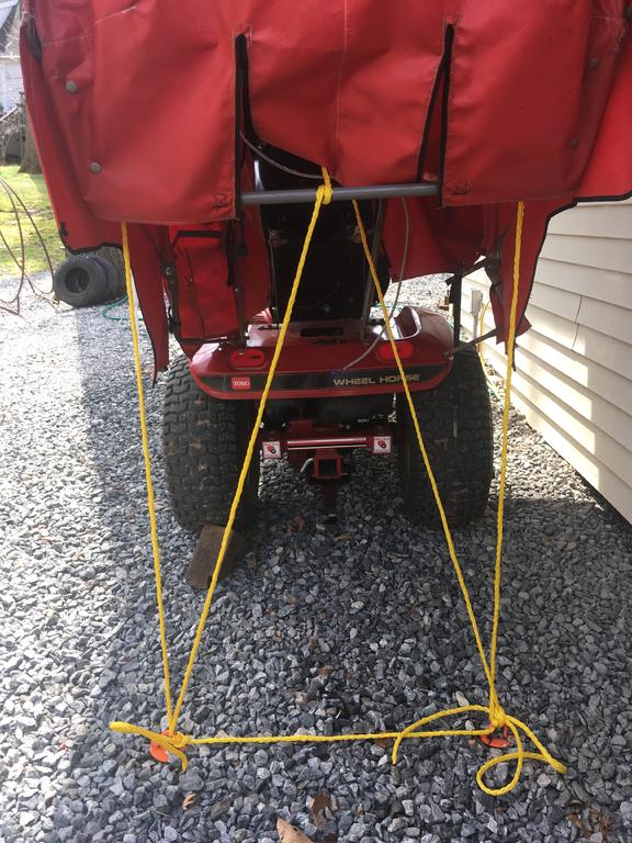

pfrederi 20,619 #8 Posted April 4, 2020 Around here an open leanto like that the cab would be banging around and take a beating from the wind. 1 Share this post Link to post Share on other sites
formariz 12,359 #9 Posted April 4, 2020 1 hour ago, pfrederi said: Around here an open leanto like that the cab would be banging around and take a beating from the wind. Eventually this set up will go inside a closed lean-to in another shed. It really never gets much wind from that side . In winter it is covered by a tarp also on sides. I will however for the mean time take the advise and tie it in such manner that it will not happen. Share this post Link to post Share on other sites

formariz 12,359 #11 Posted April 5, 2020 17 hours ago, pfrederi said: ..real men do not use cabs @pfrederi Happy to report that “girly” cab is now secured. 1 Share this post Link to post Share on other sites
