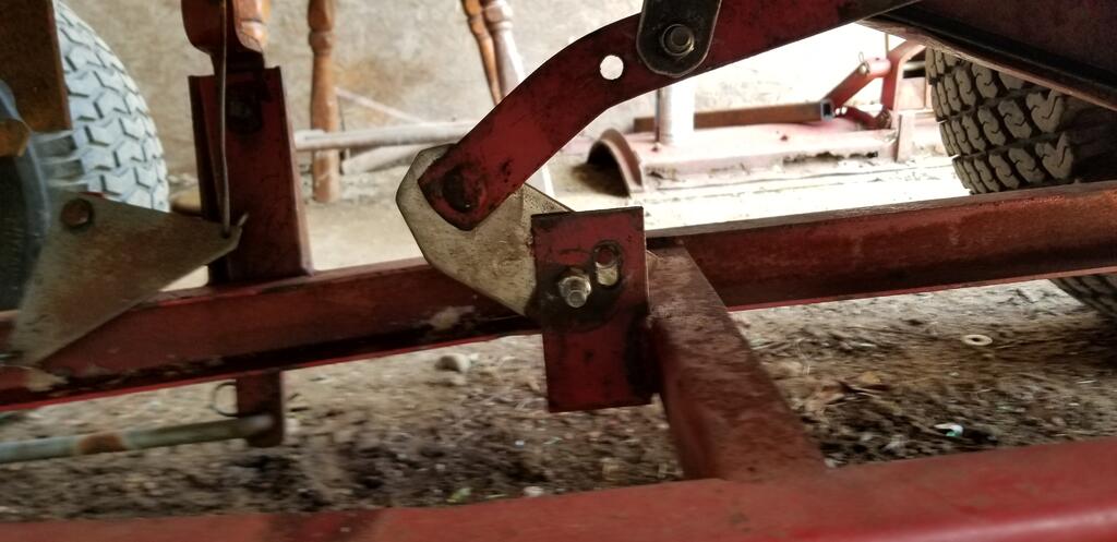

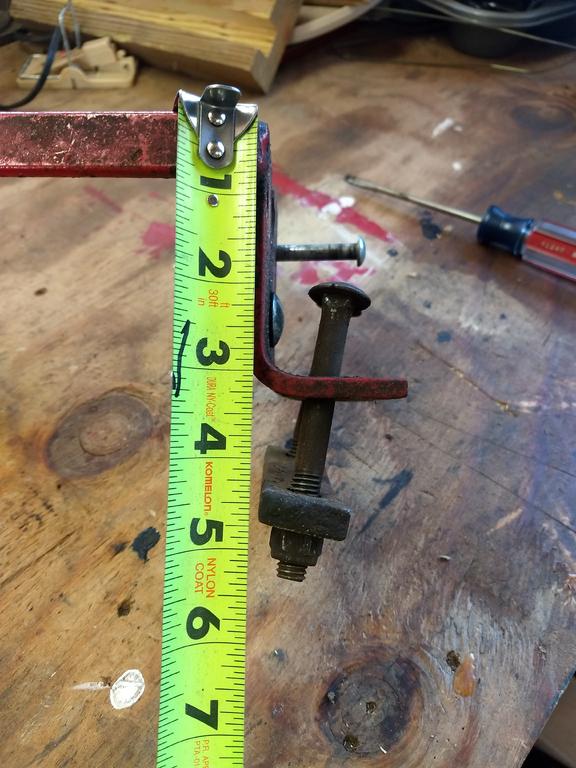

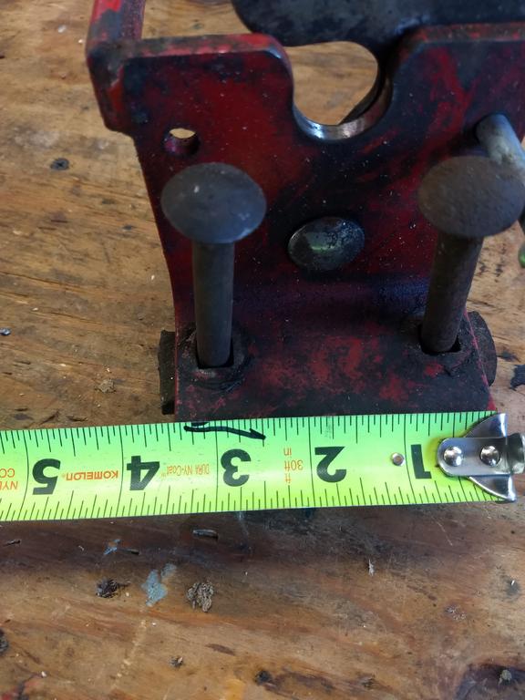

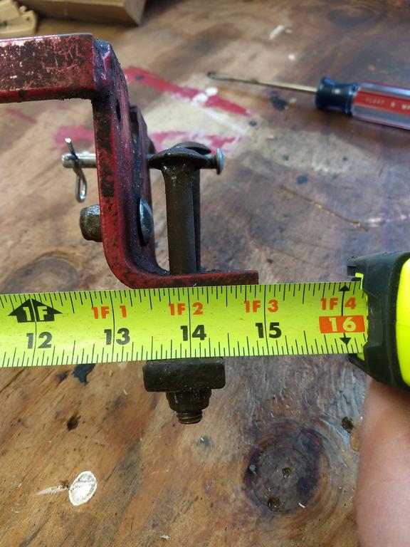

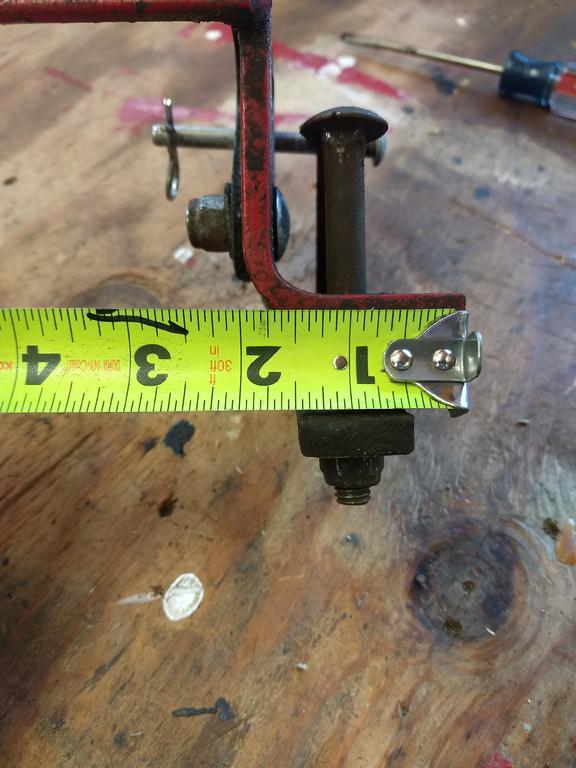

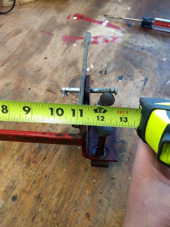

gt14rider 1,187 #1 Posted April 2, 2020 Can someone please help me with this. I need dementions for this type of plow bracket for a 73 no name. Any help would be appreciated Share this post Link to post Share on other sites
ebinmaine 78,867 #2 Posted April 2, 2020 I'd be happy to help but won't be in the shop til Saturday Share this post Link to post Share on other sites
The Tuul Crib 7,354 #3 Posted April 2, 2020 Are you wanting to know if this one will fit the no name? Share this post Link to post Share on other sites
gt14rider 1,187 #4 Posted April 2, 2020 Thank you sir, I ain't going nowhere, something to do, trying to keep busy 2 Share this post Link to post Share on other sites
gt14rider 1,187 #5 Posted April 2, 2020 It should fit, 104659 . Need measurements to build my own. 2 Share this post Link to post Share on other sites
ebinmaine 78,867 #8 Posted April 4, 2020 Center to center measurement of the bolt holes appears to be 2.5" If you need anything else don't hesitate to ask. Share this post Link to post Share on other sites
gt14rider 1,187 #9 Posted April 4, 2020 Thanks again, this should be good for now, 1 Share this post Link to post Share on other sites

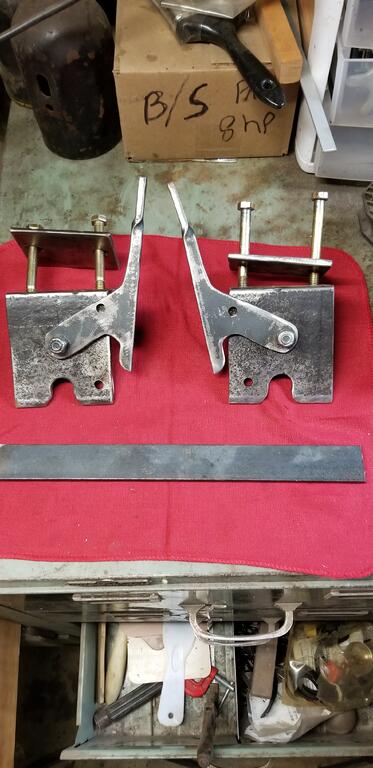

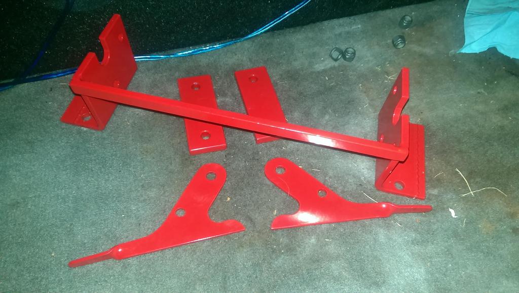

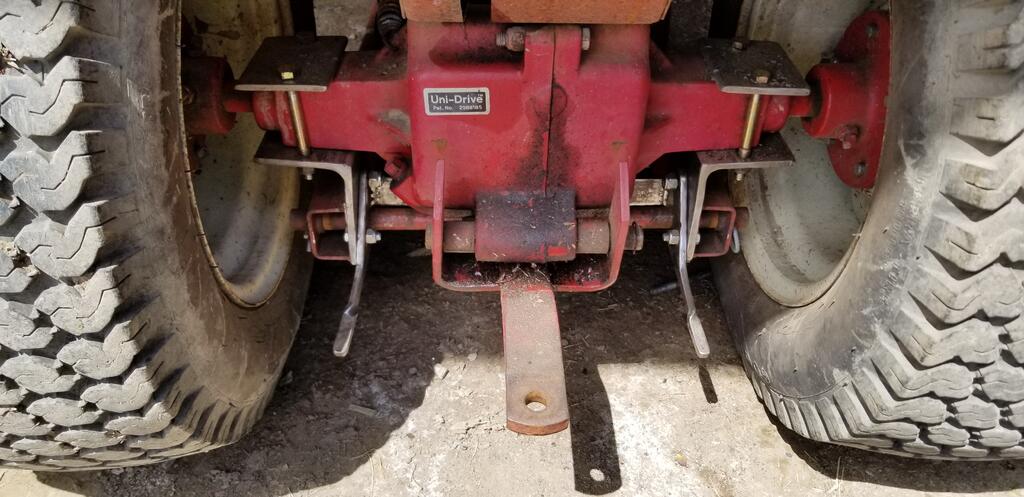

WVHillbilly520H 10,378 #10 Posted April 5, 2020 (edited) I built one a while back and also made my own locking keys wish I could find my post with blueprints. Found my thread back in Nov 2016 no blue print for this bracket as I just copied the one I had on hand what I did have a blueprint for was snow plow skid shoes... Edited April 5, 2020 by WVHillbilly520H 1 2 Share this post Link to post Share on other sites
WVHillbilly520H 10,378 #11 Posted April 5, 2020 On 4/2/2020 at 4:09 PM, gt14rider said: Can someone please help me with this. I need dementions for this type of plow bracket for a 73 no name. Any help would be appreciated Maybe this thread will inspire you even more post #32 ... 1 Share this post Link to post Share on other sites

WVHillbilly520H 10,378 #15 Posted April 26, 2020 (edited) 2 hours ago, ebinmaine said: @WVHillbilly520H I think participated in that... Perhaps Jeff can post sizes. I think I have an extra set that may be the easiest way to go... But 1" (plus) thick sqaure , 3" long ,same bolt spacing and holes as your plow bracket will give you approximately 2" (+/-) height under blade bottom at full lift. Oh and they don't have to be solid can be square tubing of at least 1/8 wall. Edited April 26, 2020 by WVHillbilly520H 2 Share this post Link to post Share on other sites
gt14rider 1,187 #16 Posted April 26, 2020 Thanks, so I was thinking,(smell the wood burning) if I make the bracket 4" instead of 3" that would eliminate the spacer. 1 Share this post Link to post Share on other sites
WVHillbilly520H 10,378 #17 Posted April 26, 2020 7 hours ago, gt14rider said: Thanks, so I was thinking,(smell the wood burning) if I make the bracket 4" instead of 3" that would eliminate the spacer. Yes you could do that as well. Share this post Link to post Share on other sites
Lee1977 7,637 #18 Posted April 27, 2020 I built mine 3 3/4" deep, It's either 5/16" or 3/8" thick that"s what size angle I had. Did cut some of the width off at the top. 1 Share this post Link to post Share on other sites

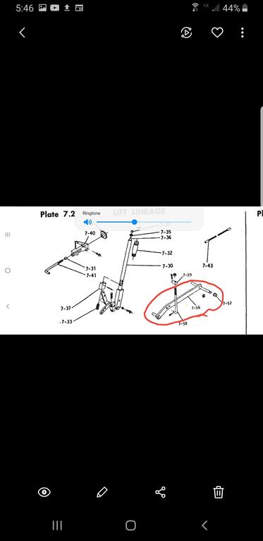

gt14rider 1,187 #19 Posted May 6, 2020 Question, on the 73 no name,there is lift arm 7-56in pic. Does 7-58 and 7- 59 get replaced with 12" lift linkage or does link go from lift handle to plow? Share this post Link to post Share on other sites
ebinmaine 78,867 #20 Posted May 6, 2020 I have NONE of the red circle items. My link is 11.5 to 12" solid and goes from handle to plow directly. 1 Share this post Link to post Share on other sites
gt14rider 1,187 #21 Posted May 6, 2020 Does anyone know what that linkage circled in red is for? Mower deck? 1 Share this post Link to post Share on other sites
Lee1977 7,637 #22 Posted May 6, 2020 4 hours ago, gt14rider said: Does anyone know what that linkage circled in red is for? Mower deck? Yes 1 Share this post Link to post Share on other sites
WVHillbilly520H 10,378 #24 Posted May 6, 2020 And any other mid mount implements that you want to "float" while engaged on the ground. 1 Share this post Link to post Share on other sites

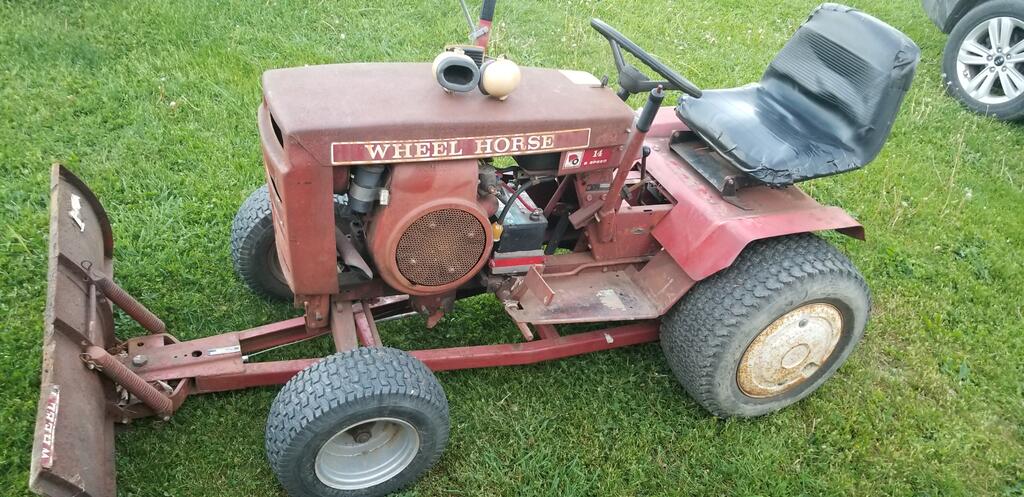

gt14rider 1,187 #25 Posted May 25, 2020 She ain't pretty but she works, 1 Share this post Link to post Share on other sites
