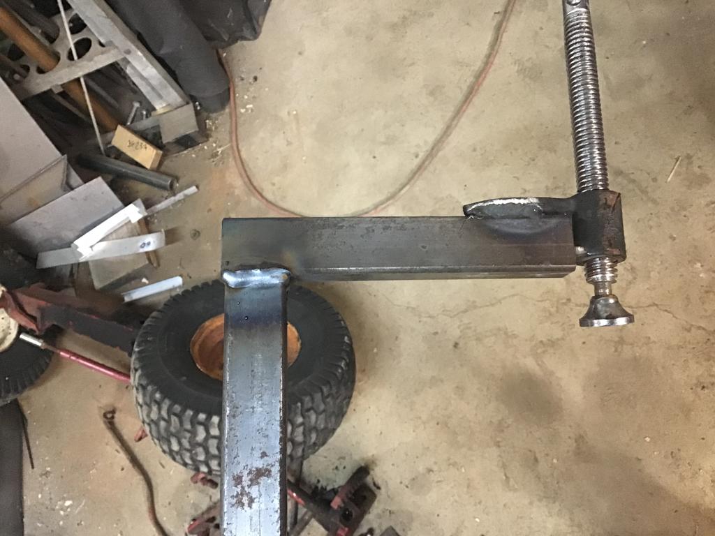

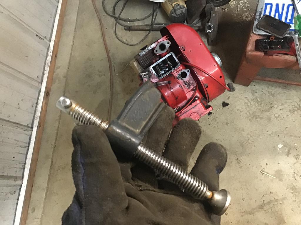

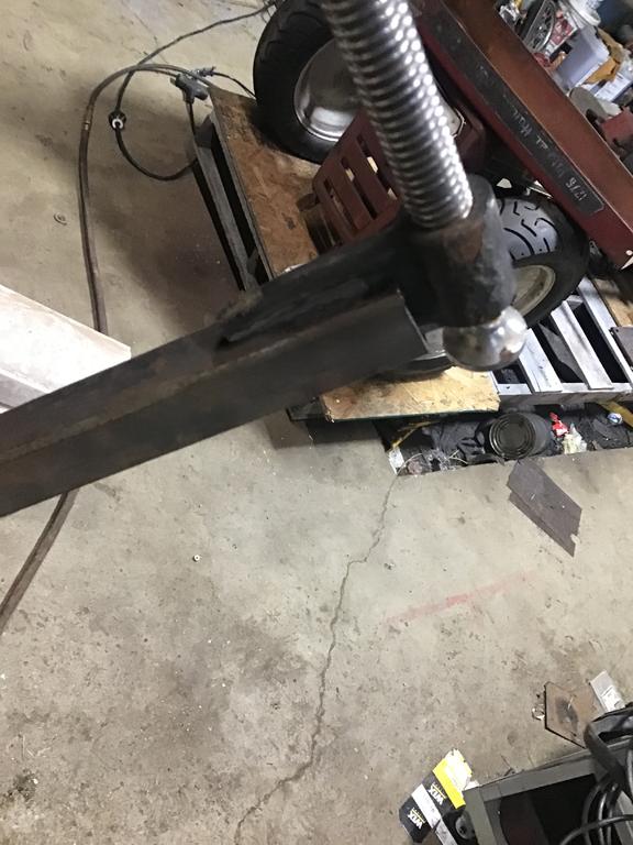

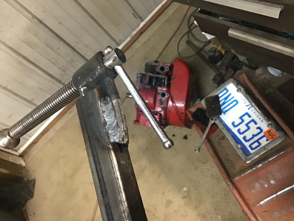

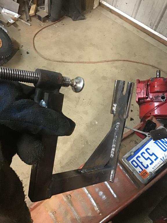

Pullstart 71,332 #1 Posted April 1, 2020 I have always gotten by without a valve spring compressor, by use of wedges, sockets, screwdrivers and 14 pounds of good luck. I have been looking at this broken piece of C clamp ever since I tossed it in the scrap pile last spring? It’s about time I bring it back inside and out it to good use! 4 Share this post Link to post Share on other sites

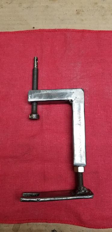

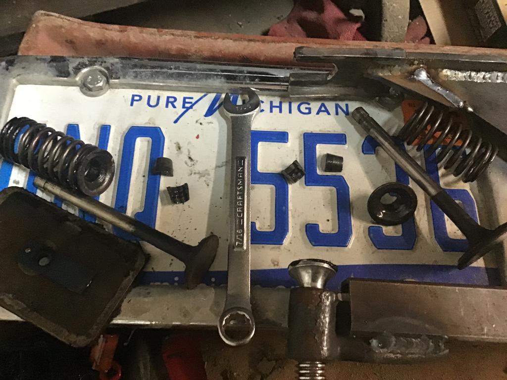

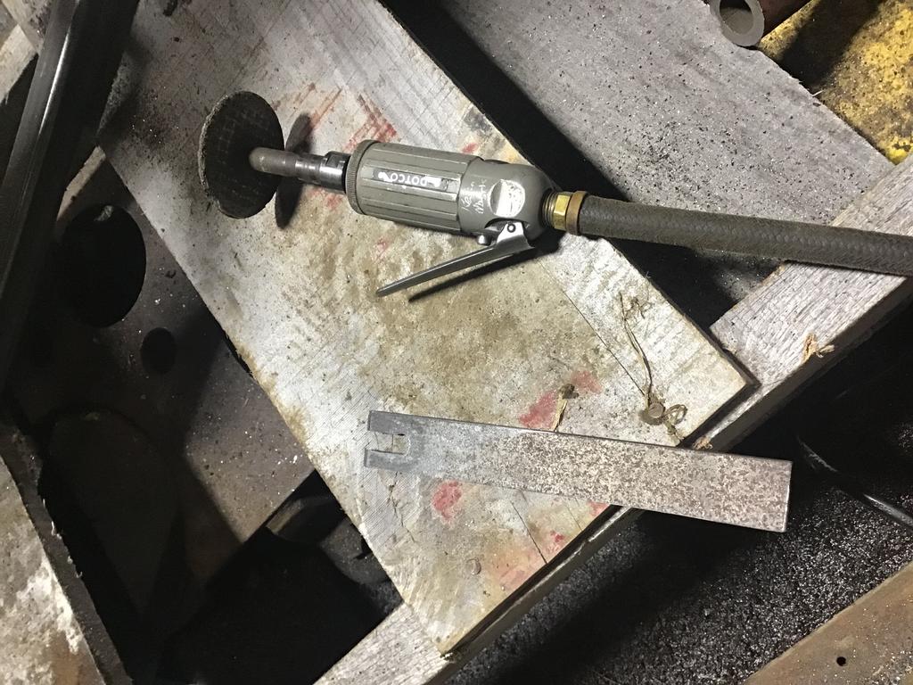

Pullstart 71,332 #3 Posted April 1, 2020 A little clearance for the valve spring keepers and we have a new tool! 8 4 1 2 Share this post Link to post Share on other sites

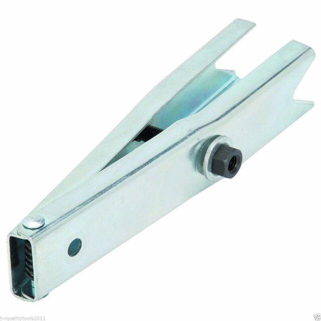

WHX?? 58,236 #9 Posted April 1, 2020 Ahhh dude you got way too much time on yer hands..... Prolly cost yo 20 in electricity to run the welder! https://www.ebay.com/itm/8-Universal-Adjustable-Valve-Spring-Compressor-Automotive-Engine-Repair-Tool/121137417517?hash=item1c345a4d2d:g:SV8AAOSwyhVdl-ep Share this post Link to post Share on other sites
Pullstart 71,332 #10 Posted April 1, 2020 Just now, WHX24 said: Ahhh dude you got way too much time on yer hands..... Prolly cost yo 20 in electricity to run the welder! https://www.ebay.com/itm/8-Universal-Adjustable-Valve-Spring-Compressor-Automotive-Engine-Repair-Tool/121137417517?hash=item1c345a4d2d:g:SV8AAOSwyhVdl-ep What’s the fun in buying something so well engineered when you can waste your entire allotted shop time building one? No Coronas in my welder or electric bill! 3 1 Share this post Link to post Share on other sites

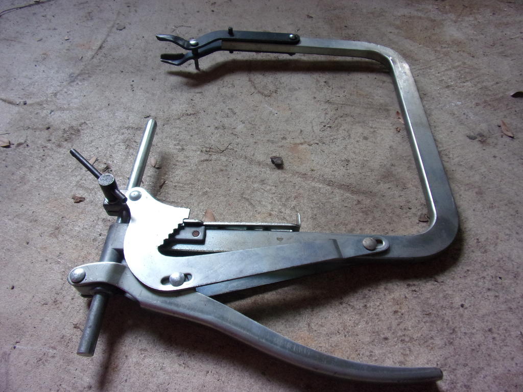

Ed Kennell 47,403 #14 Posted April 1, 2020 Kevin, Great job repurposing the C clamp. Definitely more robust than the one I bought. Here are some ideas for the rest of your builds. 3 1 1 Share this post Link to post Share on other sites
Ed Kennell 47,403 #15 Posted April 1, 2020 4 hours ago, WHX24 said: Ahhh dude you got way too much time on yer hands..... Prolly cost yo 20 in electricity to run the welder! https://www.ebay.com/itm/8-Universal-Adjustable-Valve-Spring-Compressor-Automotive-Engine-Repair-Tool/121137417517?hash=item1c345a4d2d:g:SV8AAOSwyhVdl-ep This is one of the negative reviews on the $20 spring compressor. Dec 11, 2019 toy tool First time I tried to use it the valve keeper area popped off. I am working on V-8 engine. The jaws are bending apart. Piece of junk for engine work. As you can see in the picture the left claw for top of valve is bending after 1 try 2 Share this post Link to post Share on other sites
squonk 48,166 #16 Posted April 1, 2020 1 hour ago, Ed Kennell said: This is one of the negative reviews on the $20 spring compressor. Dec 11, 2019 toy tool First time I tried to use it the valve keeper area popped off. I am working on V-8 engine. The jaws are bending apart. Piece of junk for engine work. As you can see in the picture the left claw for top of valve is bending after 1 try I have seen the top quality compressors bend. Valve springs can be nasty. Kevin, I can't dance! .................................. 1 2 Share this post Link to post Share on other sites
WHX?? 58,236 #17 Posted April 1, 2020 5 hours ago, Ed Kennell said: This is one of the negative reviews on the $20 spring compressor. Dec 11, 2019 toy tool First time I tried to use it the valve keeper area popped off. I am working on V-8 engine. The jaws are bending apart. Piece of junk for engine work. As you can see in the picture the left claw for top of valve is bending after 1 try Don't take a rocket scientist to figure out this ain't exactly a high quality tool. Workin on V-8s or for a living or a motor thats worth some serious coin you best spend a tad more. Not a problem for the hobbyists and the one maybe two Kohlers I do a year. Same goes for the dirt cheap piston ring thingy I got. Even then with ten thumbs I still manage to breakem... 6 hours ago, formariz said: . I simply replied " because I can". If that don't sound like @Achto... can't argue with that! 1 1 Share this post Link to post Share on other sites

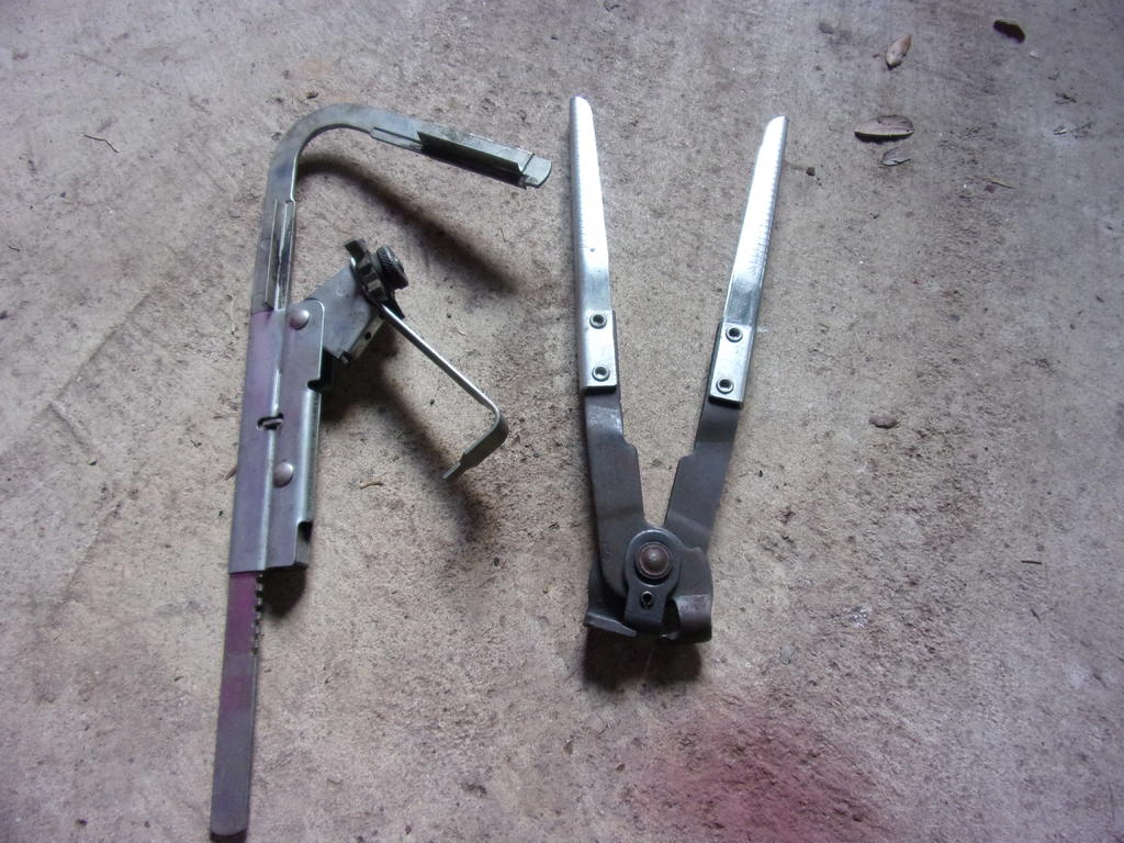

Achto 32,795 #18 Posted April 2, 2020 Nice job on the spring compressor Kevin. I've gotten away with this style of compressor, left over from my days as a auto body tech. Not exactly the best tool but it does work for small engines. One of these days I might have to purchase or make the correct tool. 1 1 Share this post Link to post Share on other sites
gt14rider 1,278 #19 Posted April 2, 2020 Made this up , screwdriver wasn't doing it 2 1 Share this post Link to post Share on other sites

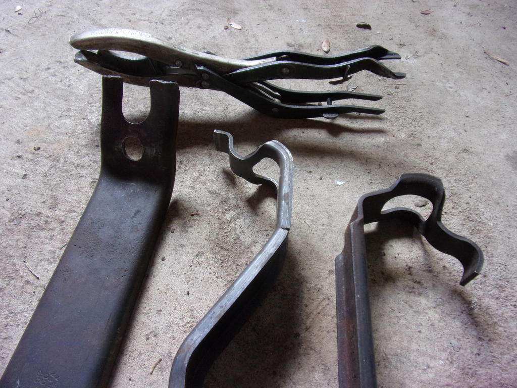

953 nut 69,567 #20 Posted April 2, 2020 On 4/1/2020 at 9:53 AM, WHX24 said: Ahhh dude you got way too much time on yer hands..... Prolly cost yo 20 in electricity to run the welder! https://www.ebay.com/itm/8-Universal-Adjustable-Valve-Spring-Compressor-Automotive-Engine-Repair-Tool/121137417517?hash=item1c345a4d2d:g:SV8AAOSwyhVdl-ep I have had a Snap-on OHV compressor similar to the one you linked to, but it is not my go-to on flat head engines. I have had this one for close to sixty years and it is the only way to go IMHO. 3 1 Share this post Link to post Share on other sites
