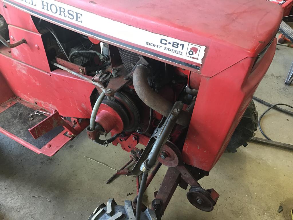

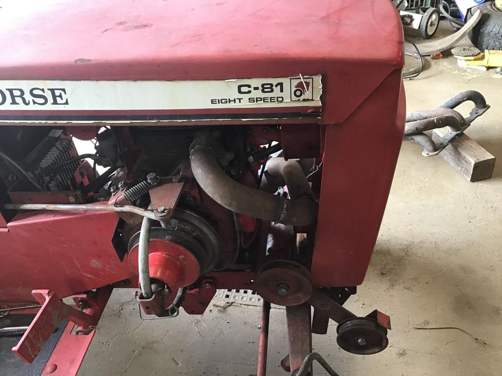

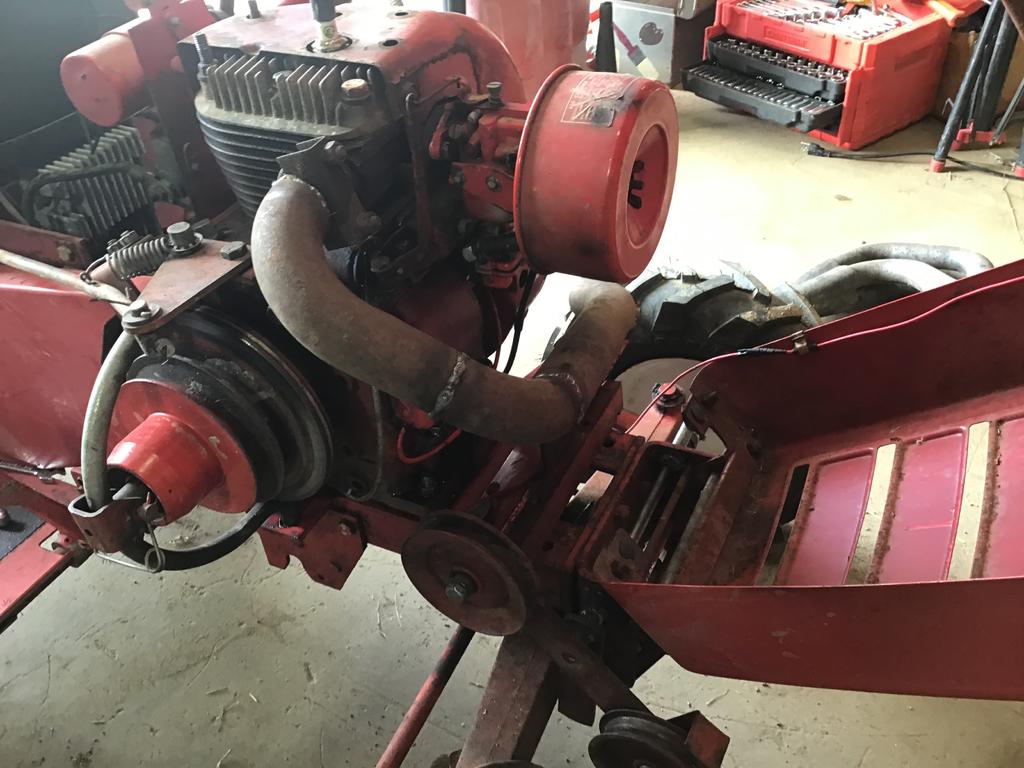

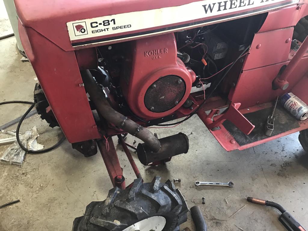

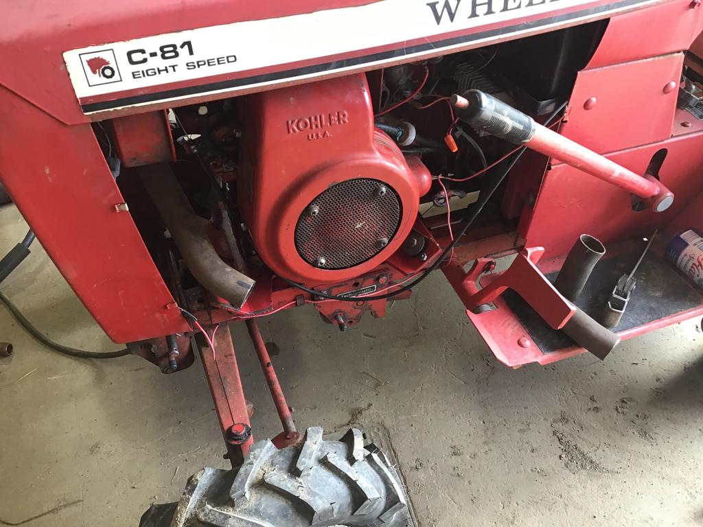

Pullstart 71,350 #28 Posted April 5, 2020 We hacked up Steve’s muffler to build Rylee’s stack system for Screamin’ Jimmy. Looks like Steve needs a little tubing work! I don’t plan on having under belly attachments, so a rear exhaust is in order. 1 1 1 Share this post Link to post Share on other sites
tom2p 2,396 #29 Posted April 5, 2020 like the rear exhaust ! 2 Share this post Link to post Share on other sites
Pullstart 71,350 #30 Posted April 6, 2020 Well that looks cool.... 1 Share this post Link to post Share on other sites

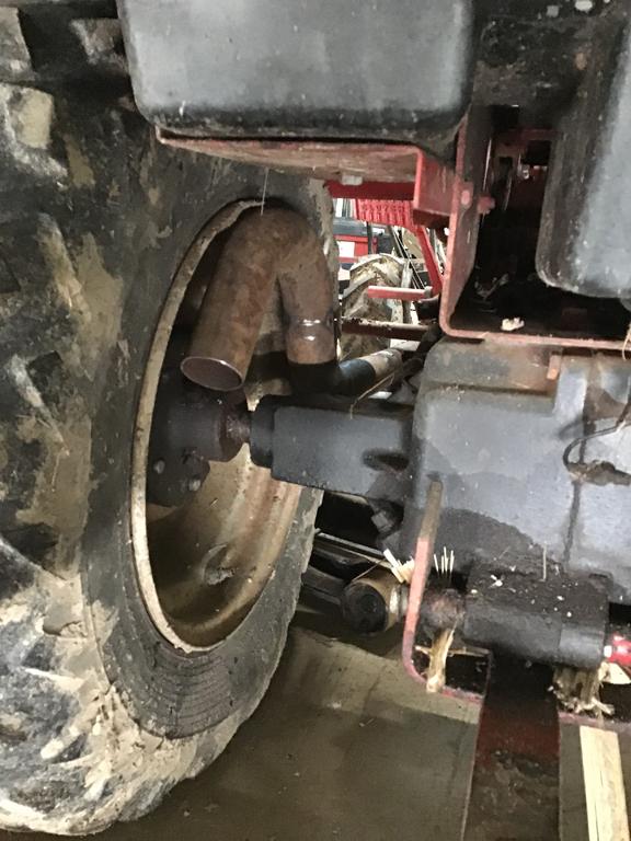

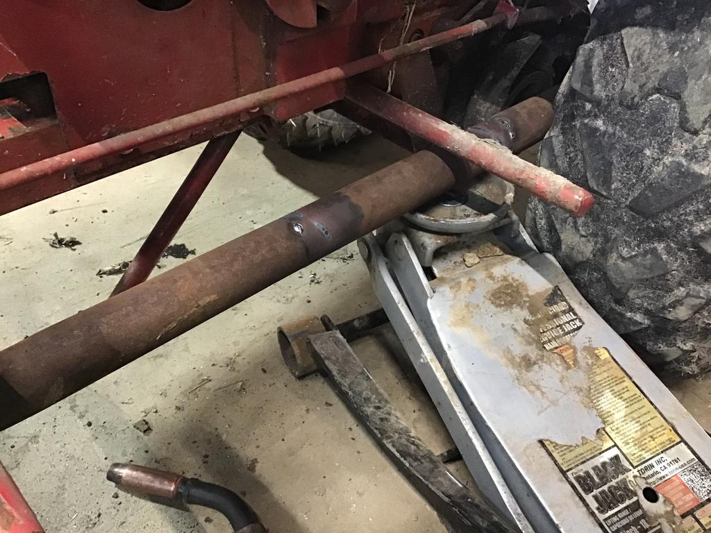

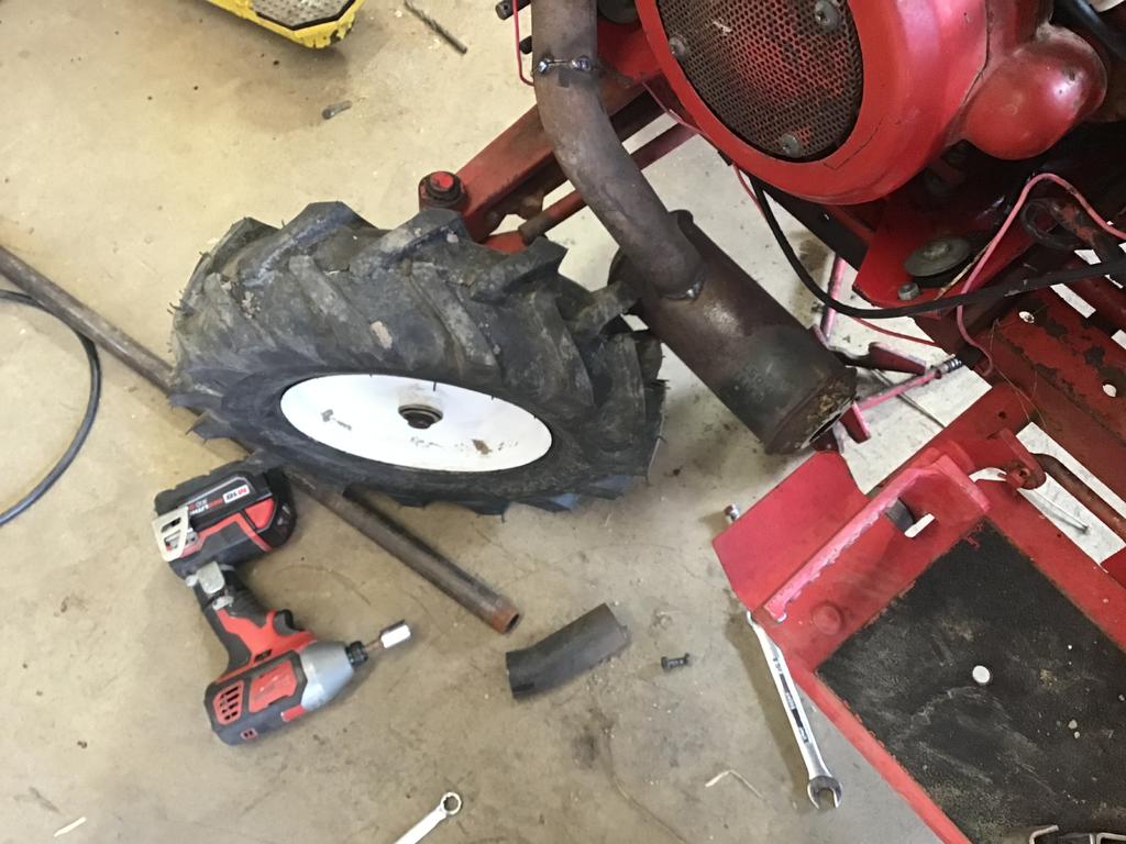

Pullstart 71,350 #31 Posted April 6, 2020 ... until I turn the wheel. 1 Share this post Link to post Share on other sites
Tractorhead 9,217 #32 Posted April 6, 2020 Huh, maybe a bit close. how about the ground clearance? Did you plan just to weld it, or did you plan anywhere a separation point? Share this post Link to post Share on other sites
Pullstart 71,350 #33 Posted April 6, 2020 26 minutes ago, Tractorhead said: Huh, maybe a bit close. how about the ground clearance? Did you plan just to weld it, or did you plan anywhere a separation point? I’ll cut it off and try to hide it behind the floorboard in the back. It was no lower than the transmission but with interference to the tire, It’ll move. I have a ton more bends to play with 1 Share this post Link to post Share on other sites

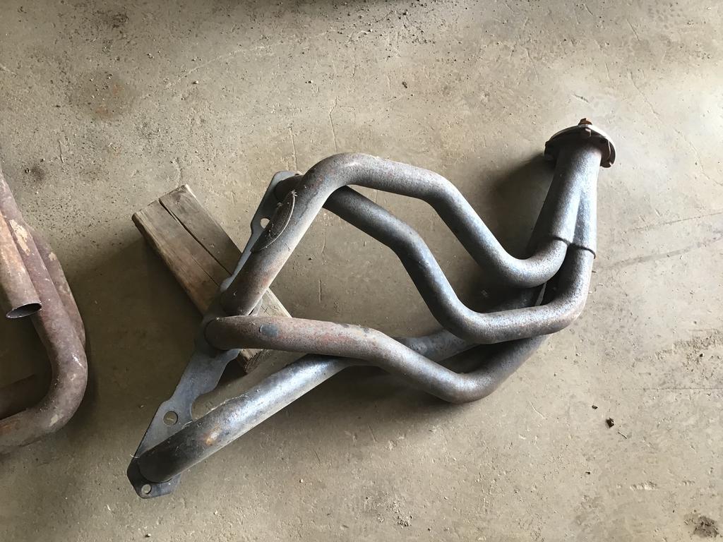

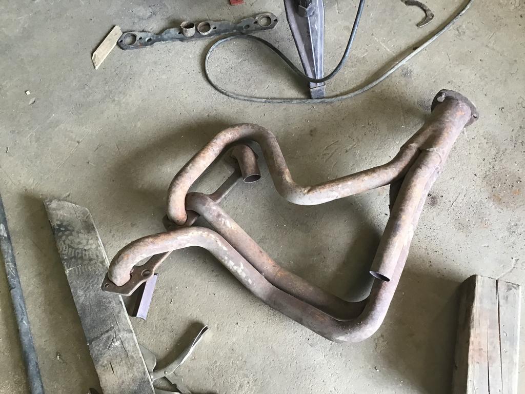

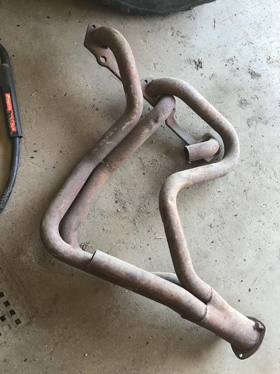

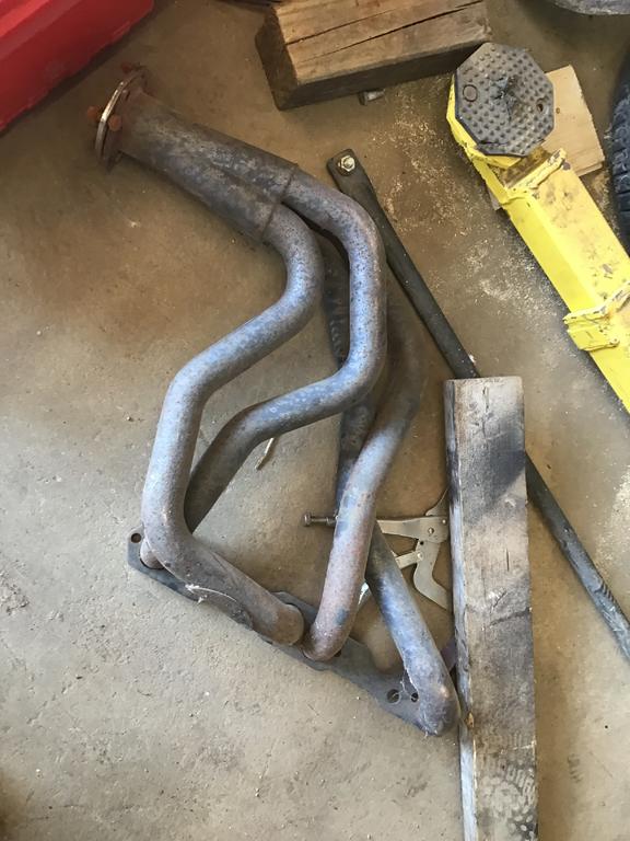

ri702bill 13,163 #34 Posted April 8, 2020 Nice work so far. I'm surprised you relocated the original Nelson style muffler - had you figured for another Putt Putt Glasspack or a straight pipe. Did you disconnect the battery before welding the pipe sections in place? The rectifier may not like it. Good repurposing of the SBC shorty header - looks a G body style. Bill 1 Share this post Link to post Share on other sites
Pullstart 71,350 #35 Posted April 8, 2020 1 hour ago, ri702bill said: Nice work so far. I'm surprised you relocated the original Nelson style muffler - had you figured for another Putt Putt Glasspack or a straight pipe. Did you disconnect the battery before welding the pipe sections in place? The rectifier may not like it. Good repurposing of the SBC shorty header - looks a G body style. Bill I want to make the exhaust cool, but usable for mowing for a few hours if needed. The longer the pipe gets, the more it sounds like a mini Harley Davidson an that’s tolerable. Battery has been disconnected indeed and I feel like the last thing the headers were on was a K5 Blazer maybe? Never had a V8 car... The not so black header I think is either Ford or Mopar, it’s got a funky flange inlet that I’ve never seen? Share this post Link to post Share on other sites
Tractorhead 9,217 #36 Posted April 8, 2020 I just was curious, because on the Pict it looked very deep, but that is maybe depending on perspective. 1 Share this post Link to post Share on other sites
Pullstart 71,350 #37 Posted April 8, 2020 I pulled some tin to get a better angle at my exhaust work... 1 Share this post Link to post Share on other sites

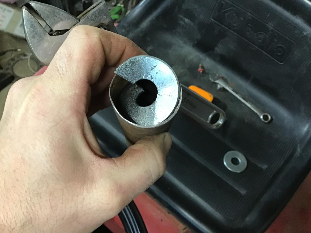

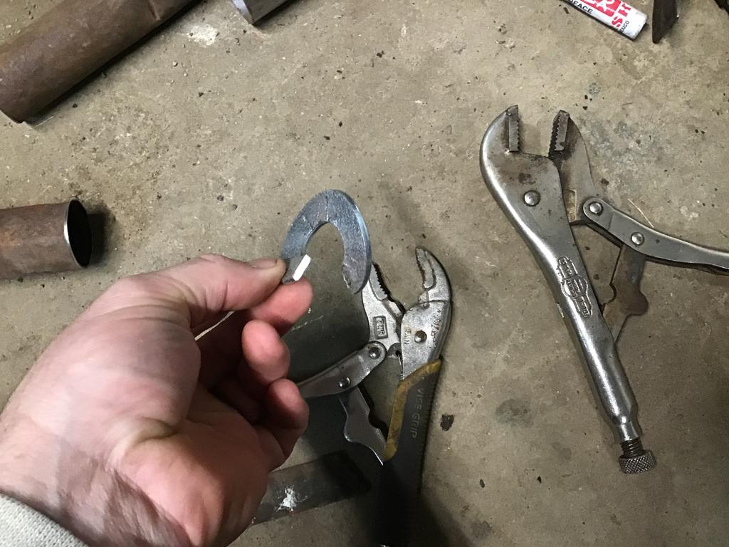

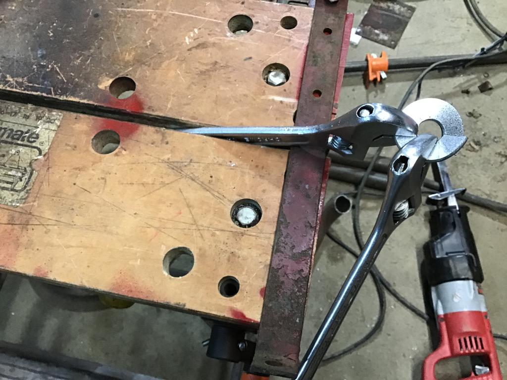

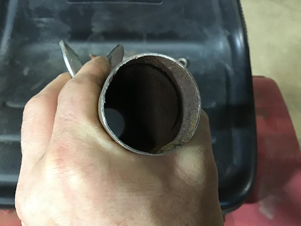

Pullstart 71,350 #38 Posted April 9, 2020 @ebinmaine maybe this will help with the explanation on the washers... I think some crescent wrenches will be enough to shape them. 2 1 Share this post Link to post Share on other sites

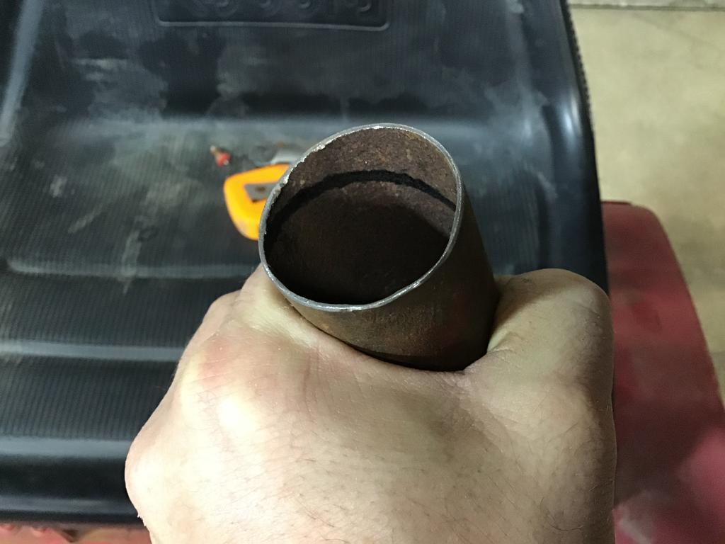

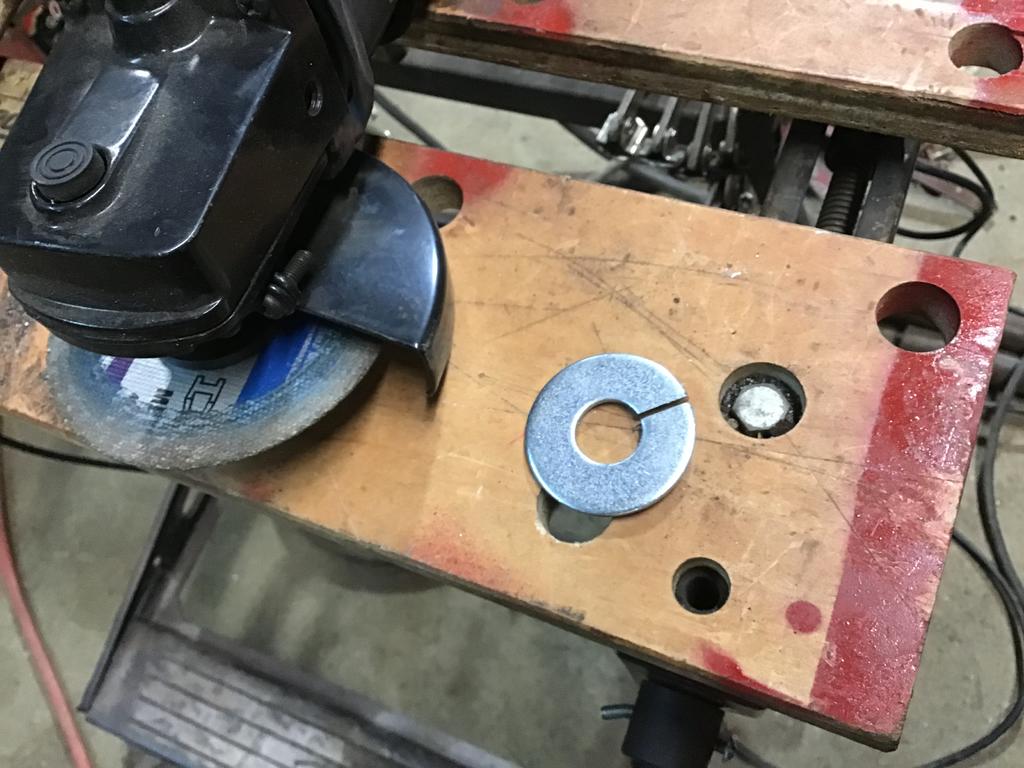

Pullstart 71,350 #39 Posted April 9, 2020 Here is some washer baffle progress. I’ll keep twisting it until it slips into the pipe, then I’ll weld at least 1/2” of seam exposed. I might even drill a hole at the end of it and plug weld it in place there too. 2 Share this post Link to post Share on other sites

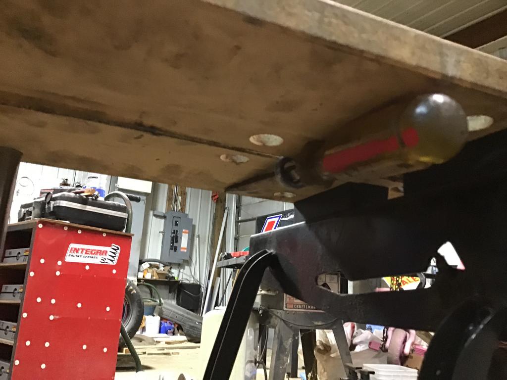

Pullstart 71,350 #40 Posted April 9, 2020 This little “work mate” table was given to me, I think. It’s a handy little guy! I made up this “vice” to help bend quicker. 1 Share this post Link to post Share on other sites
SylvanLakeWH 32,685 #42 Posted April 9, 2020 Don't really "get" the concept of mufflers like this, would love an explanation of how they actually work... Also be cool to hear a before and after if that is possible... Lookin' good! 3 1 Share this post Link to post Share on other sites

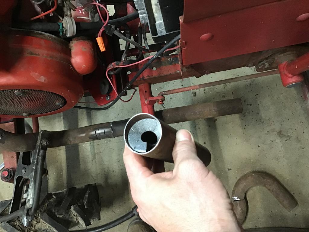

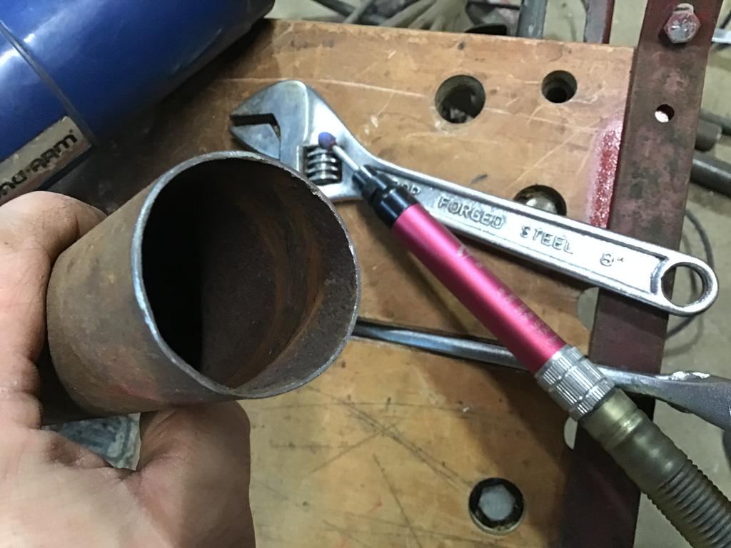

Pullstart 71,350 #43 Posted April 9, 2020 I marked the inside of the pipe and ran a pencil grinder in there to clean the rust out. The split in the washer will be located at the bottom of the exhaust to allow any condensation to be pushed through without pooling up. 1 Share this post Link to post Share on other sites
Pullstart 71,350 #44 Posted April 9, 2020 1 minute ago, SylvanLakeWH said: Don't really "get" the concept of mufflers like this, would love an explanation of how they actually work... Also be cool to hear a before and after if that is possible... Lookin' good! Stay tuned... I am going to warm up Steve, then take a video to test my method. From what I understand... Essentially the noise travels in a straight direction until it is ricocheted in an opposite direction. Think of a pool table bank shot. Every bend in a system will alter the noise output in some way. Some noise cancels out, some noise makes it’s way through the tailpipe. 2 1 Share this post Link to post Share on other sites
ebinmaine 80,882 #45 Posted April 9, 2020 6 minutes ago, pullstart said: Stay tuned... I am going to warm up Steve, then take a video to test my method. From what I understand... Essentially the noise travels in a straight direction until it is ricocheted in an opposite direction. Think of a pool table bank shot. Every bend in a system will alter the noise output in some way. Some noise cancels out, some noise makes it’s way through the tailpipe. Sounds like what the original flowmasters were. No actual muffling, so to speak. Maybe @WVHillbilly520H Jeff could pop in with the technical description but I don't think they were called mufflers. Maybe resonators? 2 1 Share this post Link to post Share on other sites
Pullstart 71,350 #46 Posted April 9, 2020 FULL DISCLOSURE! I haven’t even listened to the video yet! 2 1 Share this post Link to post Share on other sites

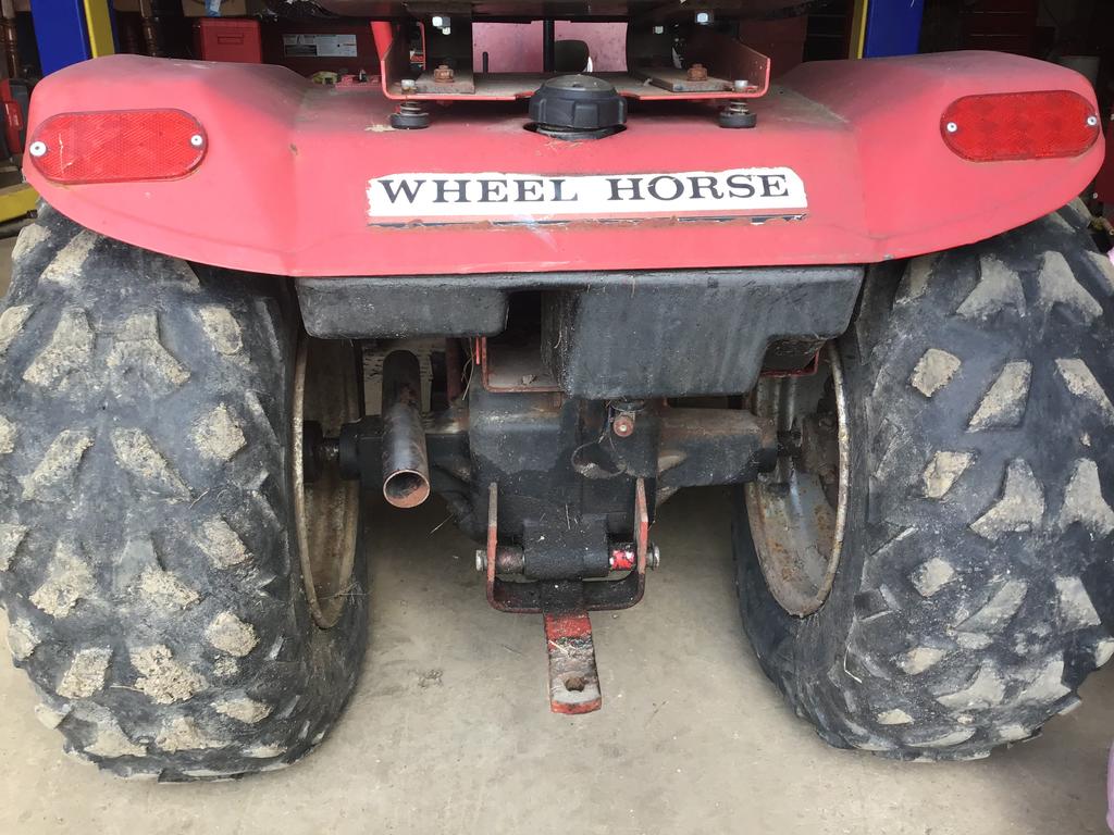

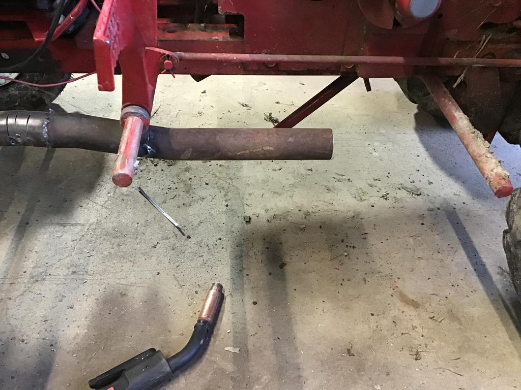

Pullstart 71,350 #48 Posted April 9, 2020 I might have to put another little bend in to center this but here it is all in place! 2 1 Share this post Link to post Share on other sites

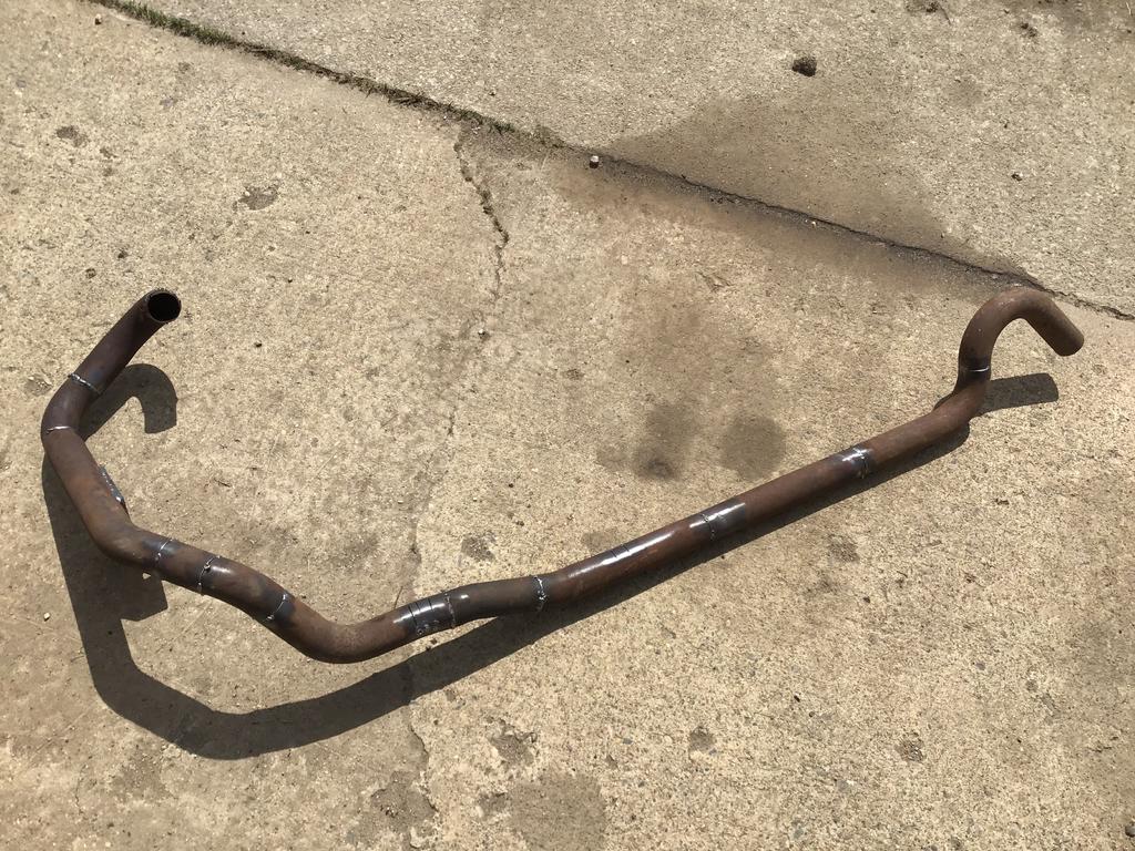

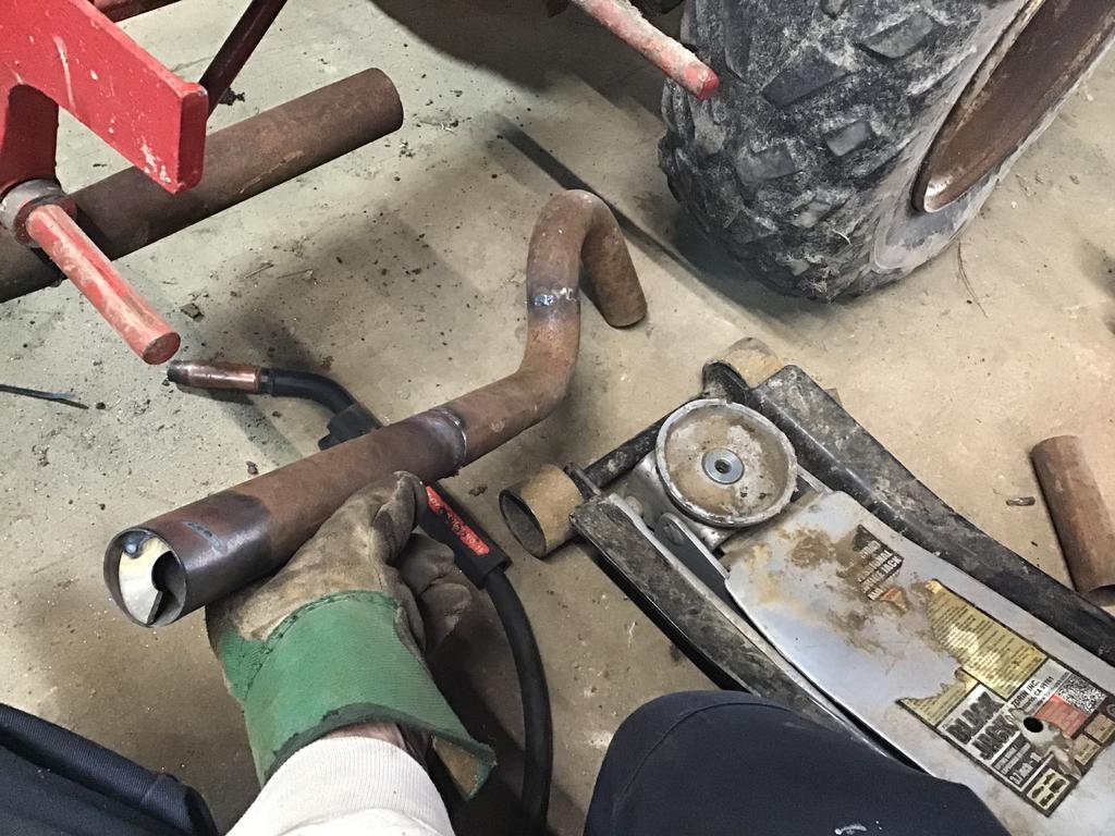

Pullstart 71,350 #49 Posted April 9, 2020 Good news! It’ll come off in one piece! I have wire wheeled it and am ready to weld the seams on the welding table. 2 3 1 Share this post Link to post Share on other sites
ebinmaine 80,882 #50 Posted April 9, 2020 I'll watch that video later but that looks awesome. 1 Share this post Link to post Share on other sites
