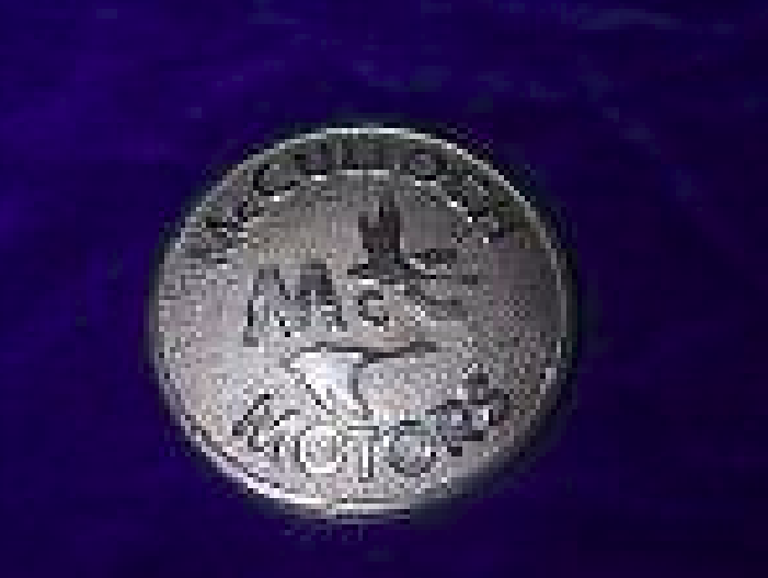

bc.gold 3,406 #11 Posted April 17, 2020 (edited) The McCulloch logo was removed from a fuel tank that came into our scrap yard with a load, there were no other parts. I carefully cut the logo free from the tank then back filled it with automotive body filler, then used it as my pattern to cast these in aluminum. I use petro-bond sand in my core box's, this sand is so fine that it will pick up finger prints, it's a nice product to work with it uses oil instead of water as a binder so even an idiot is able to cast metals with out fear of a steam explosion. This image does not do the casting justice. Edited April 18, 2020 by bcgold Share this post Link to post Share on other sites
