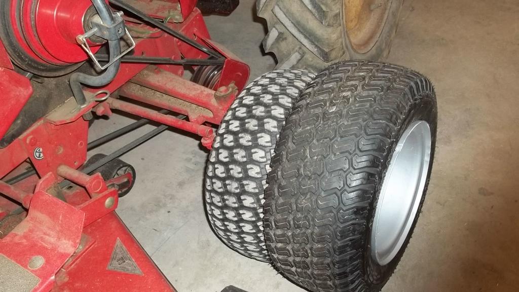

WHX?? 58,324 #10 Posted March 25, 2020 (edited) 4 hours ago, squonk said: My Tip: Take them to the tire shop down the road! Yer a sally Skunk... did that once and they charged me 10 bucks. Wouldn't get out of bed for that. Even greased the the tech another ten for not marring the rims. Took another set in to the same place and got bent over and scratched rims for 40 bucks... wt%??? Talk about inflation and not just the tires! Needless to say the tech did not get a tip. Bought a HF mini for 40 and just did 4 6-12s with no problems. Now money ahead. Best part no scratched rims by an unruly tire monkey! Forgot about the baby powder trick. Thanks for the reminders fellas...Would have made getting the lug staggers I was lookin for (duals) much easier without twisted tubes. Pet peeve is not having the stem perpendicular to the rim. Looks like I got yer OCD Oilwell! Edited March 26, 2020 by WHX24 3 3 Share this post Link to post Share on other sites

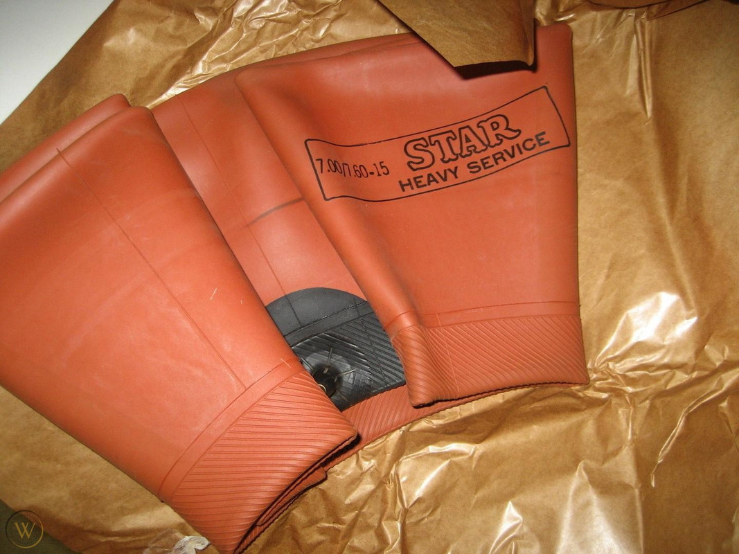

bc.gold 3,406 #19 Posted March 26, 2020 How many of you remember the red inner tubes, they always made the best sling shots. 1 Share this post Link to post Share on other sites

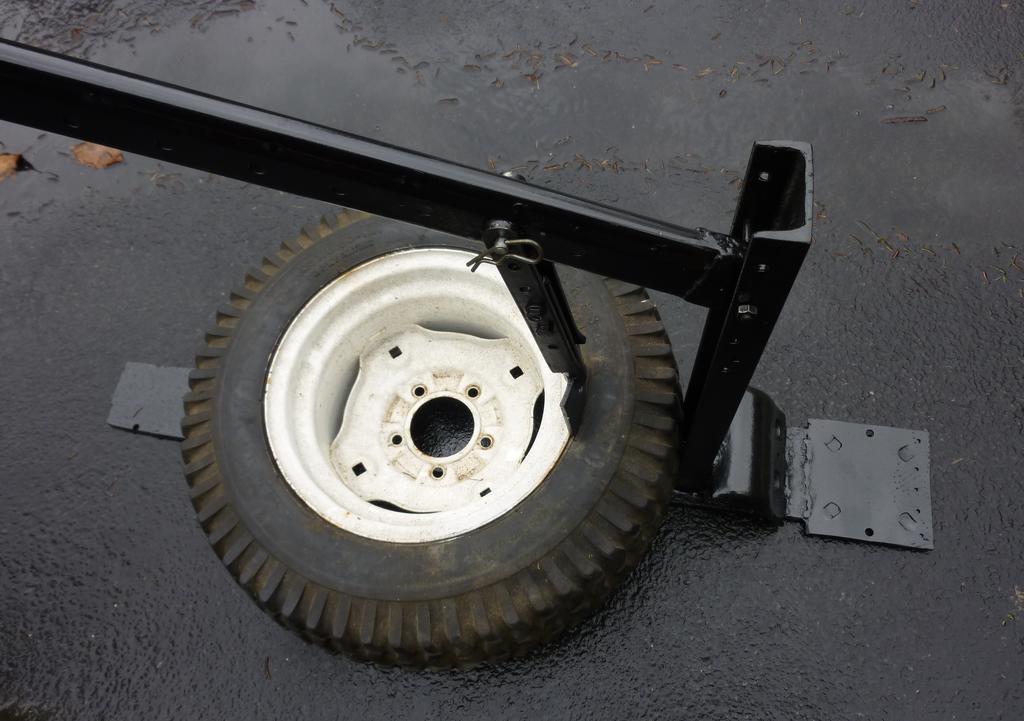

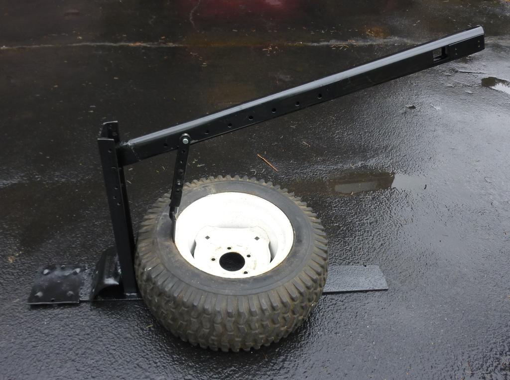

Rob R 993 #21 Posted March 28, 2020 18 hours ago, Lee1977 said: Never had a problem mounting them, some were a little more difcult but I got them on. It's getting them off that is the problem. After two or three tries I have that covered too. Solved the taking off problem by making a HD bead breaker out of scrap steel since the store boughts are mostly junk, easy to store and works like magic.... most borrowed tool I own! 1 Share this post Link to post Share on other sites
Lee1977 7,807 #22 Posted March 28, 2020 1 hour ago, Rob R said: Solved the taking off problem by making a HD bead breaker out of scrap steel since the store boughts are mostly junk, easy to store and works like magic.... most borrowed tool I own! You wouldn't have broke that one loose it was glued on might have cut right trough that 2 ply tire if it didn't fold away.. I don't know what they used but it was good stuff. Share this post Link to post Share on other sites

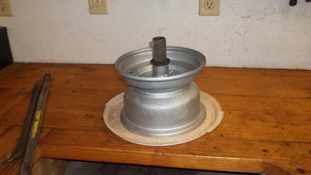

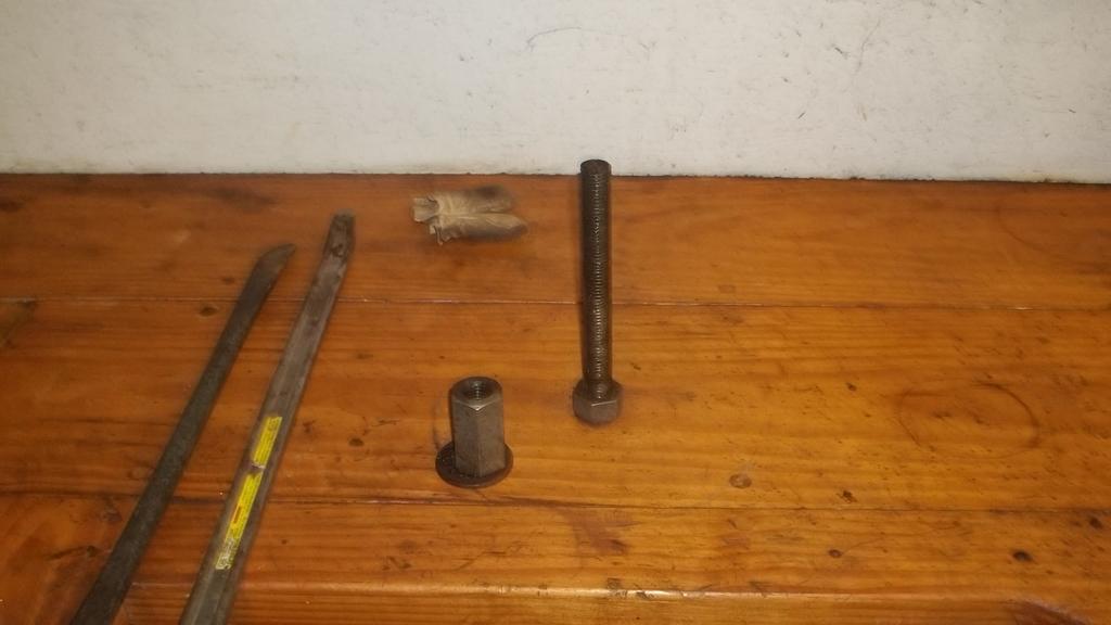

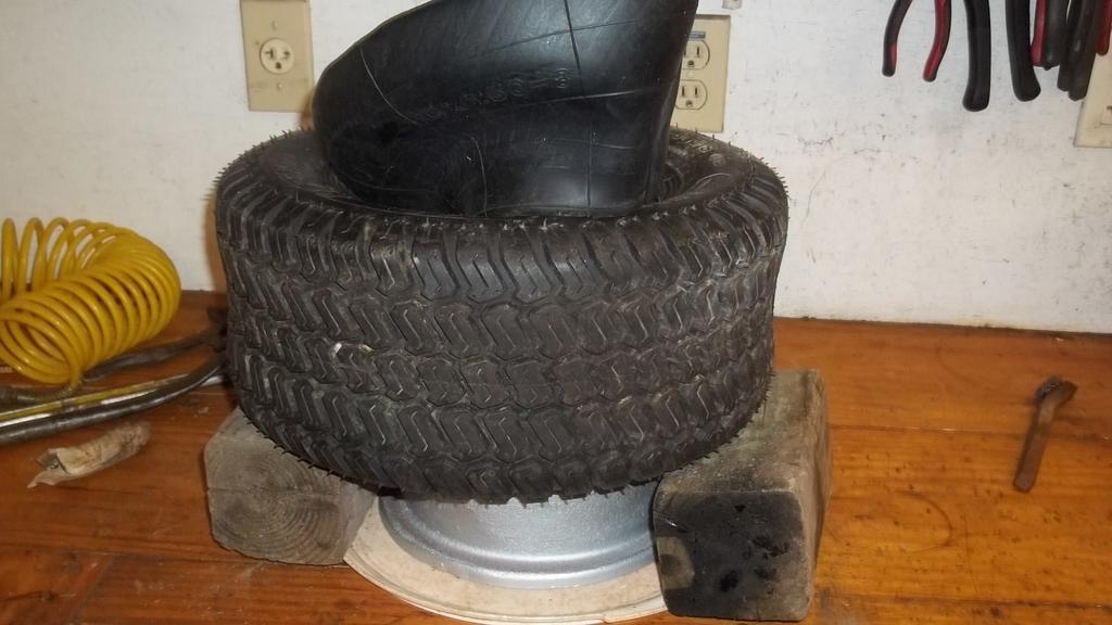

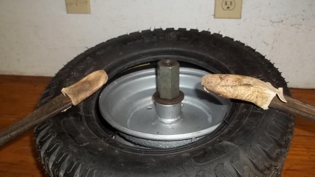

953 nut 70,064 #23 Posted April 1, 2020 Today I mounted up a pair of tires @RJ Hamner was nice enough to sell me and decided to show y'all my high-tech tire machine for smaller size tires. A piece of 3/4" all-thread rod through a hole in the work bench and a couple tire irons. For freshly painted rims I use an old Tupperware lid to protect the paint, run a washer and rod coupling onto the all-thread and it ain't going anywhere. Lube up the tire and the lower bead slides on by hand. Next I use a pair of highly calibrated 4 X 4 chunks to hold the tire up while inserting the tube (right side up of course). Fingers cut from an old leather glove slipped over the tire irons protect the paint. These 8" tires and shorter spindles should make the 310-8 ride and steer a lot better. If any of you plan to copy this high-tech tire changer you can just send the royalty checks to me! Share this post Link to post Share on other sites
Lane Ranger 12,159 #24 Posted April 1, 2020 9 hours ago, 953 nut said: Today I mounted up a pair of tires @RJ Hamner was nice enough to sell me and decided to show y'all my high-tech tire machine for smaller size tires. A piece of 3/4" all-thread rod through a hole in the work bench and a couple tire irons. For freshly painted rims I use an old Tupperware lid to protect the paint, run a washer and rod coupling onto the all-thread and it ain't going anywhere. Lube up the tire and the lower bead slides on by hand. Next I use a pair of highly calibrated 4 X 4 chunks to hold the tire up while inserting the tube (right side up of course). Fingers cut from an old leather glove slipped over the tire irons protect the paint. These 8" tires and shorter spindles should make the 310-8 ride and steer a lot better. If any of you plan to copy this high-tech tire changer you can just send the royalty checks to me! Richard: That Big Hex Nut you are using looks like a Schnacke Recoil Hex Nut ! Share this post Link to post Share on other sites
953 nut 70,064 #25 Posted April 1, 2020 36 minutes ago, Lane Ranger said: looks like a Schnacke Recoil Hex Nut Nope, just a 3/4" rod coupling. Did Schnancke make a recoil that big? must have been a 40 HP model. Share this post Link to post Share on other sites
