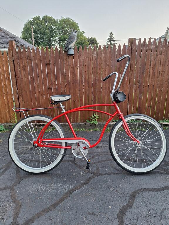

AlexR 3,140 #2354 Posted September 2, 2023 3 hours ago, D_Mac said: I didn't know Wheelhorse made bicycles. Learn something new every day.. It is cool!! 2 Share this post Link to post Share on other sites

D_Mac 9,339 #2356 Posted September 2, 2023 16 minutes ago, AlexR said: I didn't know Wheelhorse made bicycles. Learn something new every day.. It is cool!! They really don't make them. I built the bike and @Vinylguymade the head badge. But shhhhh... its our secert. 1 5 Share this post Link to post Share on other sites
AlexR 3,140 #2357 Posted September 2, 2023 1 hour ago, D_Mac said: They really don't make them. I built the bike and @Vinylguymade the head badge. But shhhhh... its our secert. Well you did a great job! And I couldn't tell it wasn't Wheelhorse because vinylguy made such a great badge for it. 1 Share this post Link to post Share on other sites

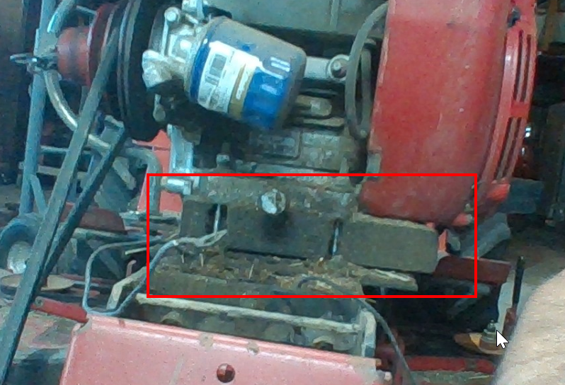

davem1111 2,453 #2365 Posted September 4, 2023 19 hours ago, wallfish said: Honda makes a super reliable engine. (Expensive, but super reliable) WISH I never sold that 520 with a 20 hp GX620 Honda and 2 stage. That thing was a beast and should've sold the one with the Onan. I'm very happy with the GX610 on my GT-1848. The only problem is that the PO or whoever re-powered it, mounted the engine on PT 2x4's, which are showing their age. Need to get some tube steel under it. Should I get some rubber spacers for shock absorption? I have the hood off right now for other reasons, but should probably fix this soon before the engine ends up on its side on the ground.... Share this post Link to post Share on other sites
ebinmaine 81,293 #2366 Posted September 4, 2023 42 minutes ago, davem1111 said: Should I get some rubber spacers for shock absorption? IMHO..... No. Leave directly bolted. 43 minutes ago, davem1111 said: I have the hood off right now Try out a "spare" hood for fit. 1 Share this post Link to post Share on other sites
Handy Don 17,741 #2367 Posted September 4, 2023 1 hour ago, davem1111 said: I'm very happy with the GX610 on my GT-1848. The only problem is that the PO or whoever re-powered it, mounted the engine on PT 2x4's, which are showing their age. Need to get some tube steel under it. Should I get some rubber spacers for shock absorption? I have the hood off right now for other reasons, but should probably fix this soon before the engine ends up on its side on the ground.... Unless some failing of the wood mount (rot, motor shifting, bolt holes wallowing, bolts loosening, etc.) is driving the change, you could, IMHO, leave the wood. Rubber will likely disappoint you, as it deteriorates from vibration (and probably from fuel and oil) and can cause the engine to shift under load. Also, unless you it’s matched by damping frequency to this application, it won’t do much for the vibration anyway. 1 1 Share this post Link to post Share on other sites

davem1111 2,453 #2369 Posted September 5, 2023 12 hours ago, Handy Don said: Unless some failing of the wood mount (rot, motor shifting, bolt holes wallowing, bolts loosening, etc.) is driving the change, you could, IMHO, leave the wood. Rubber will likely disappoint you, as it deteriorates from vibration (and probably from fuel and oil) and can cause the engine to shift under load. Also, unless you it’s matched by damping frequency to this application, it won’t do much for the vibration anyway. Hmmm... I guess there's nothing critical going on that would force my hand in replacing the wood. It looks like it may be cracking and deteriorating in some places, but the engine isn't "loose". It does seem to move a bit when I engage the PTO, but everything still works fine. Guess I'll leave it alone for now. Maybe a winter project, and if I'm going to lift the engine I will most likely want to do some more intense cleaning and repainting if needed. 13 hours ago, ebinmaine said: IMHO..... No. Leave directly bolted. Try out a "spare" hood for fit. Hah! Yes, I do have a much nicer hood to put on it now (with louvers), plus I have some new hinge brackets and nylon bushings so the hood won't be slopping around. I still need to decide if I want to return this to its original gray color... my wife says "BORING!" so I may get a wild hair and paint it purple or something like that. We shall see. 2 Share this post Link to post Share on other sites

Lee1977 7,813 #2371 Posted September 5, 2023 16 hours ago, davem1111 said: I'm very happy with the GX610 on my GT-1848. The only problem is that the PO or whoever re-powered it, mounted the engine on PT 2x4's, which are showing their age. Need to get some tube steel under it. Should I get some rubber spacers for shock absorption? I have the hood off right now for other reasons, but should probably fix this soon before the engine ends up on its side on the ground.... I have never chacked out a 610 Honda or the Briggs that was on it but a inch and a half rise seem a little high, but might not be. The Honda 610 PTO height is 5 1/4" can not find the Briggs height. An Onan is 7" above the frame inncluding the 1/4" plate below, so 6 3/4 " might be right. 1 1 Share this post Link to post Share on other sites
