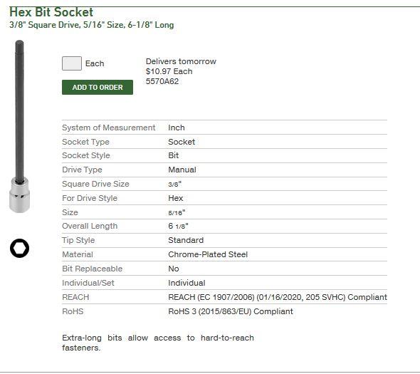

pfrederi 21,095 #15 Posted March 18, 2020 the rings are in the mail. if you are going to work on the pump end of the manifold i would highly recommend you get on of these. save a lot of frustration,smacked knuckles and cursing and swearing.... 1 1 1 Share this post Link to post Share on other sites
