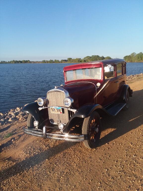

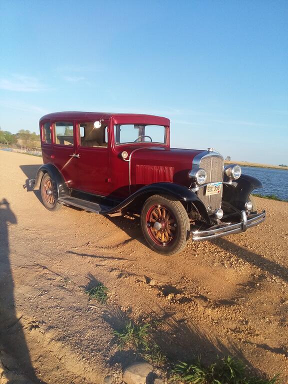

Cvans 1,009 #154 Posted May 24, 2020 Today had to sort out the wiring for the lights and something was drawing down the battery when not running. The most the alternator would charge was 20 amps. I believe I've found the problem and now it's charging up to 40 amps and I don't see any sparks when removing the negative battery cable. The front tires need balancing and I plan on use tire beads as these wooden spoked wheels won't fit on a balancer. There is some slack in the steering that needs addressing. The more the engine is run the better it sounds. Had it up to 40 mph but that sounds about as high as I want the engine revving. Took a drive to the lake this evening. Lots of waves and smiling people. I think I'm going to enjoy having June Bug in the family. 1 9 Share this post Link to post Share on other sites
Tractorhead 9,217 #156 Posted May 24, 2020 Thats really cool👍 Think the max speed here isn‘t any interest, here it’s more the „Hey it‘s survived in original“ - effect. btw fantastic Pic‘s! nice surrounding on the lake, the beach fits optical to the wooden spoke! Nice contrast. ok the pict‘s can maybe be improved.. a male guy well dressed with a hat deep in it’s face and a Machine gun in front ajar the Car is missing 😂 Also great you have found and solved your electric troubles. Can be the slack in steering being a result of the unbalanced Tyres or did you have some slope or play in steering gear ? I have myself no experiences with Wooden Tyres at all and maybe it‘s a myth, but i have heared that wooden spoked tyres have allway‘s some play in it depening on Humidity, Type of wood and few other things they are happen on wooden Spokes. I talked at a historical meeting once with a Guy who has an old Hispano. He tell‘s me that. It is also possibly to bring the wooden type of tyre roadappoved here on historical Vehicles but only with a speedlimit to 60Km/h. That could maybe the reason in my opinion. But at all it is a dang aged Beauty at all 👍 no doubt. 1 1 1 1 Share this post Link to post Share on other sites

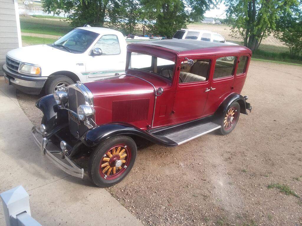

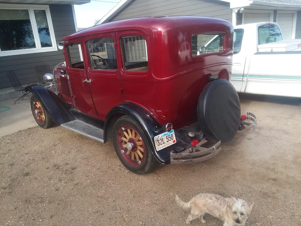

Cvans 1,009 #166 Posted May 30, 2020 (edited) Took June Bug on here first 50 mile journey yesterday. Had to go to Watertown for a checkup and some running around. 35 to 40 mph is a nice speed and we have a back road to town that is paved with very little traffic. Nothing passed me going up and only two coming back. Lakes, trees, and farm country makes for a picturesque drive. The car does good in town and keeps up with traffic just fine. June Bug is a bit of a distraction though and gets lots of honks and grins. In the parking lots you better have time for visiting or leave her at home. So far the general consensuses is to leave the interior original and just replace the missing door panels so that's what I'm going to do. New plugs and coil will be installed today. I'll be changing from 30w non-detergent to 20-50w detergent on Monday and change it again after a few miles as I'm sure the detergent is going to get dirty in a hurry. So far I'm enjoying the journey. Edited May 30, 2020 by Cvans 1 3 Share this post Link to post Share on other sites
Tractorhead 9,217 #167 Posted May 30, 2020 Sound pretty nice journey, but you know the rules, nothing happens without Picts. 😎 2 Share this post Link to post Share on other sites
Cvans 1,009 #168 Posted May 30, 2020 Well those are the photos after getting home and I'd feel a little funny taking photos of my own car in front of Menards. 4 Share this post Link to post Share on other sites
