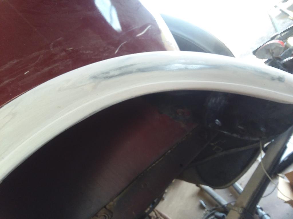

Cvans 1,009 #126 Posted April 23, 2020 (edited) I'm finding that recreating the flared lip at the edge of the fender is a real pain in the hind end. It was done with Bondo before the accident and who ever did it was a master at their trade which I am not. I need to come up with some kind of jig or mold to form it with. This is turning into the hardest part of the project and when figured out probably wont be bad. Any ideas? Edited April 23, 2020 by Cvans Share this post Link to post Share on other sites
Pullstart 71,020 #127 Posted April 23, 2020 Sandpaper wrapped around a dowel or other similar shape? 1 Share this post Link to post Share on other sites
ebinmaine 80,129 #128 Posted April 23, 2020 That's where you're different sizes and shapes of cheese grater files come in handy. You put the Bondo on and let it sit until it's kind of gummy. Do some shaving. Never done it. Watched it. But never tried it. If you have any woodworking tools or skills you can make a block the shape of what you need and use that with your sandpaper. 1 Share this post Link to post Share on other sites
Cvans 1,009 #129 Posted April 23, 2020 The cheese graters work good and I have a couple. The problem is getting a uniform curve to match the fender. I traced a line to follow with a compass and looks good until I start trying to follow it by hand. Wish I could just use a router with a guide. Going to have to come up with some kind of guide to use either when laying down the bondo or when removing it. Taking the fender off today and see what I can come up with. Thankfully these fenders are extremely easy to remove. 4 Share this post Link to post Share on other sites
Cvans 1,009 #130 Posted April 26, 2020 Spent the last couple of days thinking and working in the garden. Finally came up with an idea for forming the lip on the fender. I had some old self adhesive foam insulation for installing the topper on a pickup. It's 1/4" x 1 1/2" wide so it was split to half that. The outline of the lip was traced onto the fender with a sharpie marker. The foam was installed along the outside of the traced line. Then the Bondo was applied. There was some concern about the Bondo sticking to the foam but that turned out to not be a big problem. What actually caused the most grief was the way the foam stuck to the finished part of the fender. The stuff stuck to the fender like a leech to flesh. Anyway it's done and it is going to be usable. 1 4 1 Share this post Link to post Share on other sites

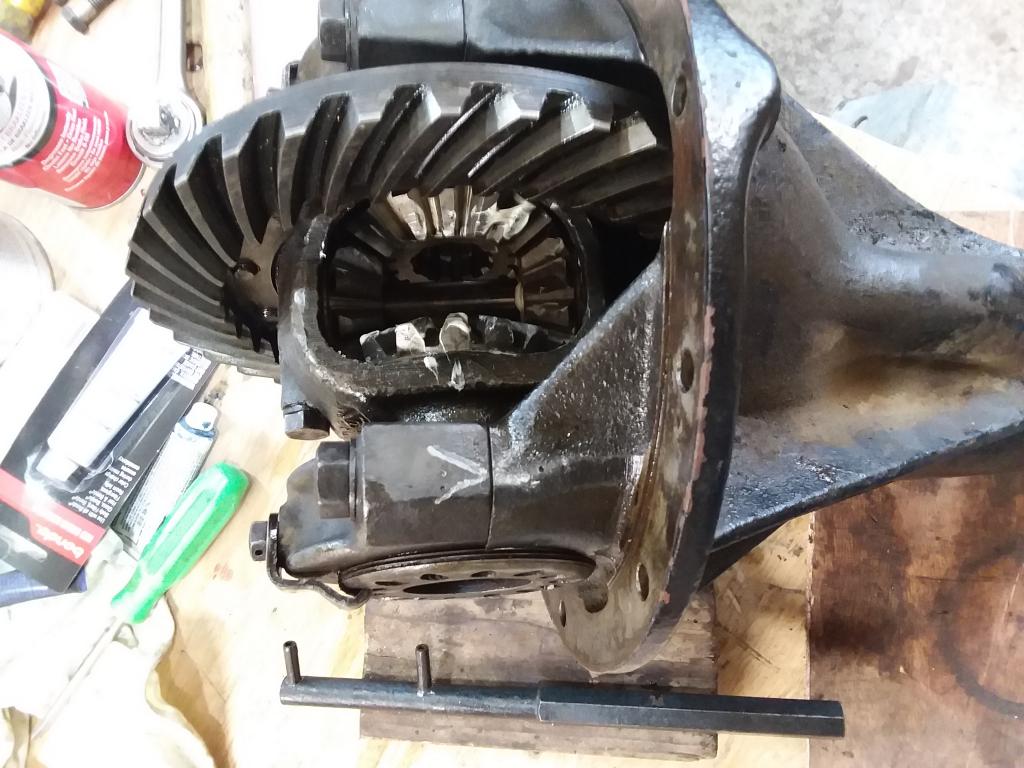

Cvans 1,009 #135 Posted May 1, 2020 Today the last part came for the differential. Spent this afternoon and evening putting it back together. Thankfully all the parts were correct and went together well. I had forgotten how much fun it is getting the spider gears in. Those conical thrust washers were kind of a pain. Hopefully by tomorrow evening it will be back on it's wheels again. Be nice to back it out of the shop so the fender can be finished. 4 2 1 Share this post Link to post Share on other sites
