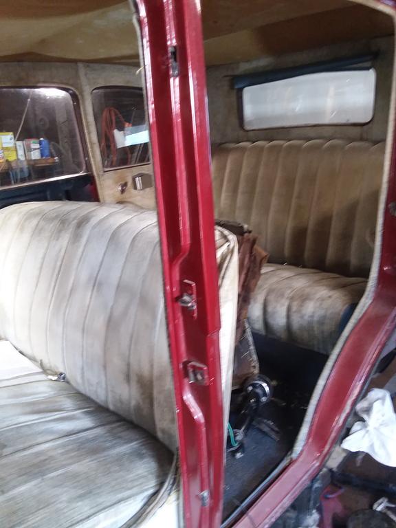

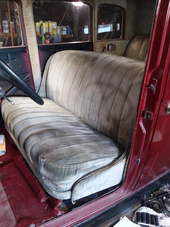

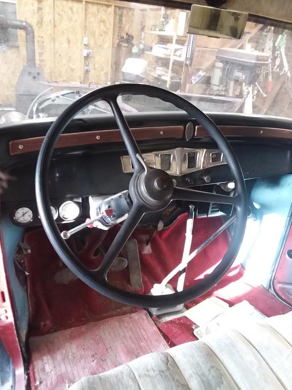

Tractorhead 9,217 #96 Posted April 1, 2020 @Cvans would you please be so Kind and show me a View of the Interior, i be really curious, to get a small view from the inside. Just if it not bother you and you‘re agree with. Thanks a Lot in advance Share this post Link to post Share on other sites
Howie 900 #97 Posted April 1, 2020 The body man at wife's uncles dealership showed me how to use the lead. I have done it a couple of times but not that good at it. I still have his paddles and body files out in the shop. 1 1 2 Share this post Link to post Share on other sites
Cvans 1,009 #98 Posted April 1, 2020 2 hours ago, Tractorhead said: @Cvans would you please be so Kind and show me a View of the Interior, i be really curious, to get a small view from the inside. Just if it not bother you and you‘re agree with. It's pretty much original except the front carpet. Someone took the door panels are off to be replaced and they were with the car. The seat upholstery looks really old but I don't know if it's 90 years old. The door panels, headliner, and interior panels are original. The headliner is starting to sag so I'm going to use some small wood trim to tack it back up. It was only attached at every other joist. I'd like to leave as much original as possible. 2 Share this post Link to post Share on other sites

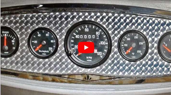

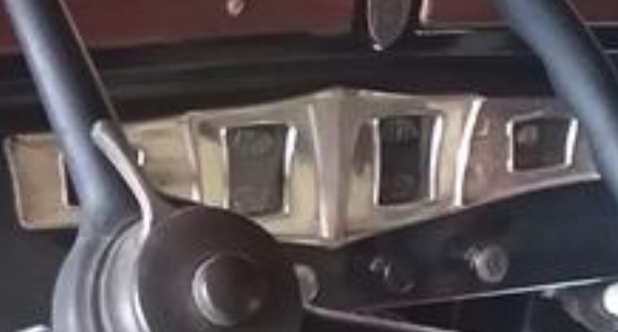

bc.gold 3,406 #99 Posted April 1, 2020 Love the design and layout of the instrument cluster. Share this post Link to post Share on other sites
bc.gold 3,406 #100 Posted April 1, 2020 (edited) The first time I seen a dash with these over lapping swirls, I was hooked and had to learn how it was done. I've since added these to a few projects to dress them up. Valve grinding compound smeared onto the surface the using a wooden dowel in a hand drill of press is all you need. Edited April 1, 2020 by bcgold 1 Share this post Link to post Share on other sites
