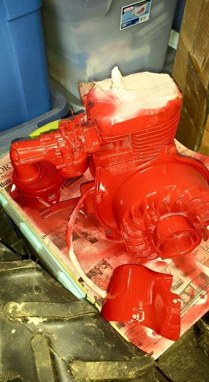

JCM 11,417 #4 Posted March 16, 2020 This is a pic of a 1977 C-120 that I bought from the original owner and good friend. I did replace the coil which I still have and was red. The only items that were painted after I bought it are the wheels, seat back, seat mount and front of the rear hubs Regal Red. Hope this helps and good luck with the restoration. Great Tractor. 4 3 Share this post Link to post Share on other sites

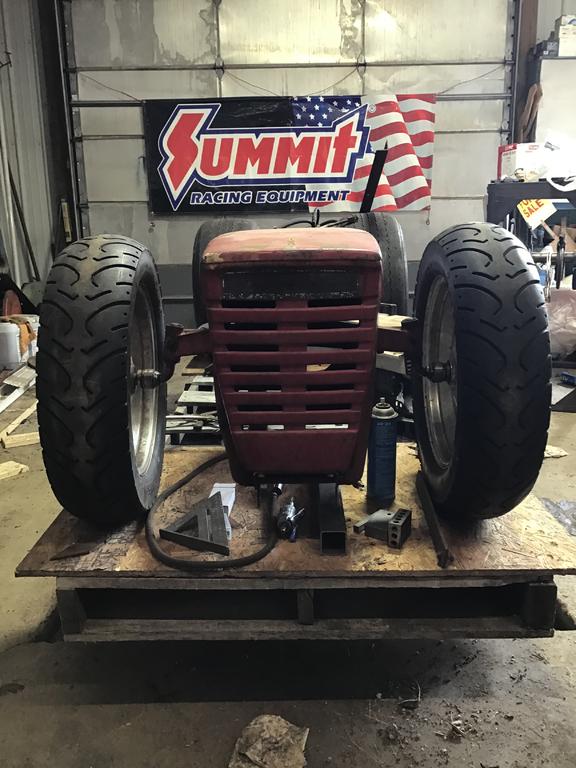

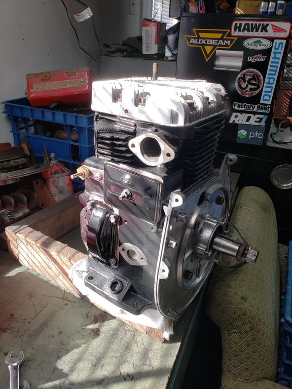

Larry P. 45 #7 Posted March 16, 2020 Well thanks for your response on the engine paint. I attached a few pictures of the painted frame, wheels and rebuilt engine. Funny how tiny the frame is without the hood and fenders. 7 3 Share this post Link to post Share on other sites

WHX?? 58,236 #10 Posted March 16, 2020 19 minutes ago, The Tool Crib said: Paint can gum up the adjustment screws Surmised that's why they were never painted Cribs. That mill is a work of art right there Larry! That would have had the tins & pan put on and down the paint line she would have sailed. I also believe they would have left the guv retainer & pto end off or capped it for above said reasons. They probably had a nifty cap to slide right over the brass nut & crank. Gotta like those custom pedal extensions for the short inseam fellas but there went your "stock" right out the window! 2 Share this post Link to post Share on other sites

Herder 2,356 #17 Posted March 16, 2020 Red with a clean cylinder head, fuel pump, carb is my preference. It keeps a somewhat stock look. Cylinder heads and carburetors are air cooled and paint takes away from that. 6 3 Share this post Link to post Share on other sites

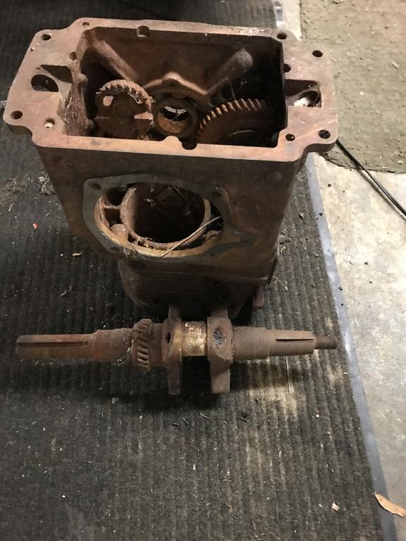

Larry P. 45 #20 Posted March 17, 2020 By the way, I had to sell my shoes and mortgage my home to pay for the high cost of the engine machine shop work and rebuild. As you can see in the pictures of the before and after, the original K341 was found buried in a junkyard. I had to literally dig it up. It was like finding gold. Final rebuild looks pretty darn good. 2 1 3 Share this post Link to post Share on other sites

WHX?? 58,236 #23 Posted March 17, 2020 1 hour ago, Larry P. said: Final rebuild looks pretty darn good. Wow ...yes it does! I don't think I would have tackled that one for love nor money. You ever decide to do one like that again we'd sure love to tag along. I notice the carcass has the balance gears in it. Did you use them or leave them out? Most engine builders here leave them out for fear of future issues. 1 Share this post Link to post Share on other sites
Larry P. 45 #24 Posted March 17, 2020 Hi Jim, Balance gears were left out when the rebuild was done. 3 Share this post Link to post Share on other sites
