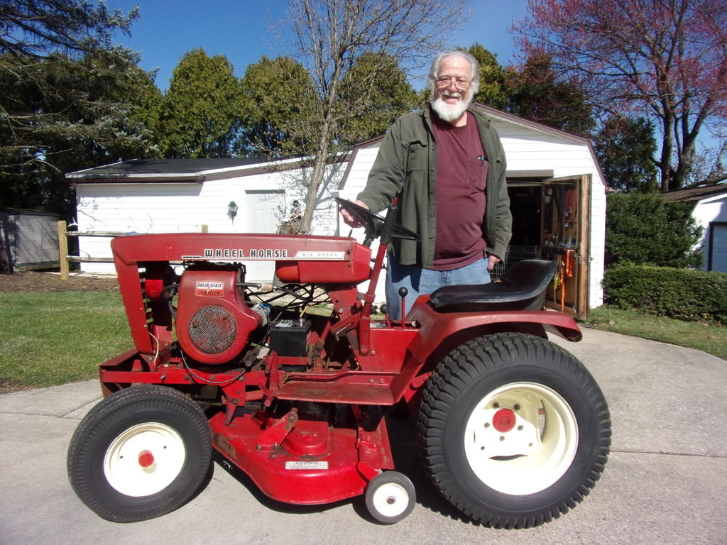

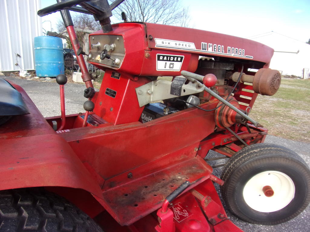

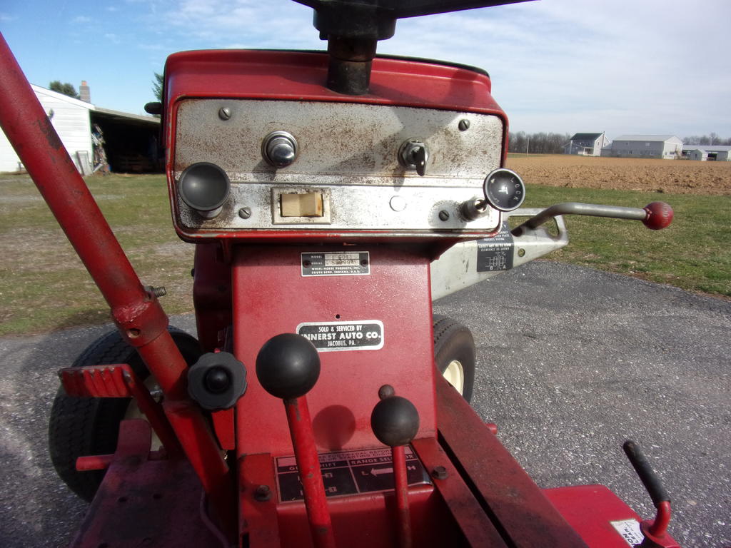

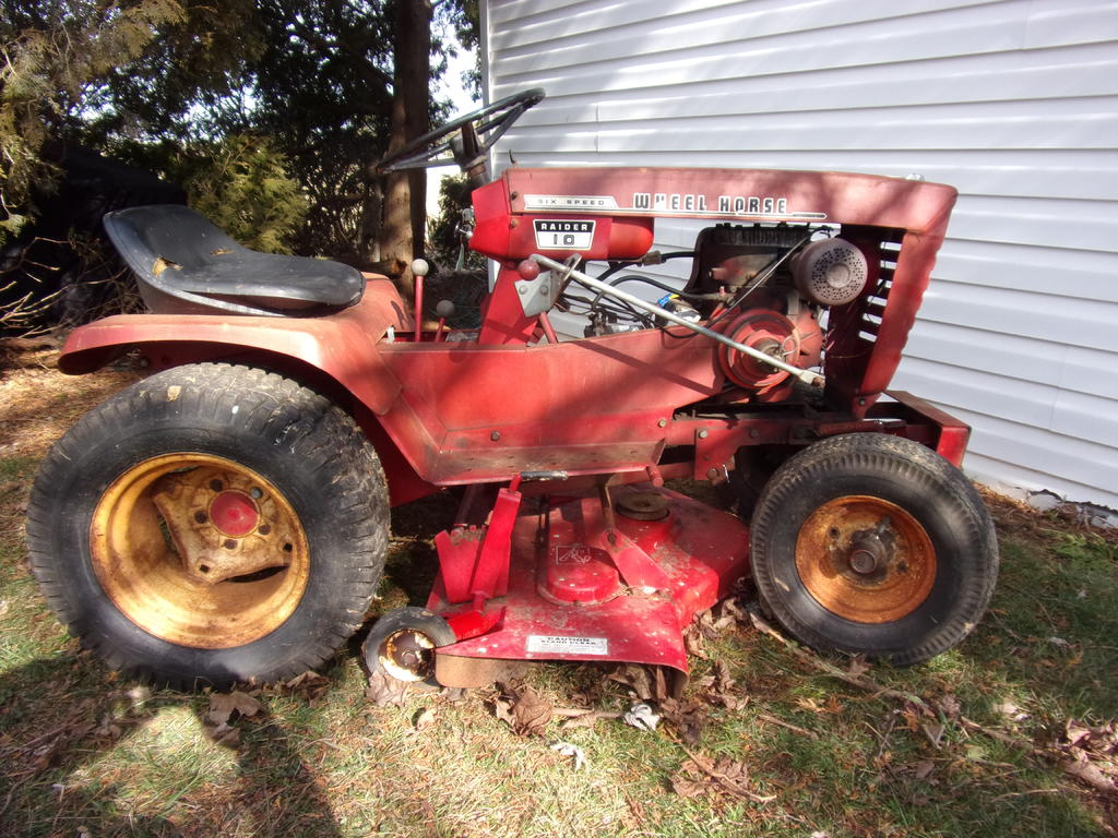

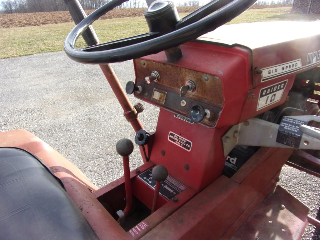

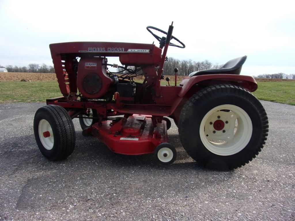

Ed Kennell 47,632 #1 Posted March 13, 2020 A neighbor called and asked if I wanted a WH tractor. This Raider 10 is what I found behind his garage. I offered to fix it up and sell it for him, but He said he didn't want paid for it...he just wanted it gone. I told him about the Big Show and suggested we donate it to the WHCC for a raffle . So, I contacted the WHCC and they have agreed to accept it for the raffle. I have been working on it and got it running pretty well. It starts one turn and runs with no smoke. It does need some choke and searches at low speed. I will continue working on the carb. It runs great at WOT. I have had the deck apart. The tensioner pulley and slide were frozen. They have been replaced. The spindles bearings feel OK, although the deck is pretty loud and has a rust thru spot. It does run in all gears and mows well. Got the lights and even the cigar lighter to work. It is all original paint and tires. I had to patch a tube in one tire. They have some cracking but all have good tread and now hold air. I painted the wheels. The tins are really good and straight with only minor rusting. I did some rust removing and cleaning. Here's what she looks like today. If the Corona doesn't cancel me or the Big Show, we will be there. You could win a Raider 10. 11 23 8 Share this post Link to post Share on other sites

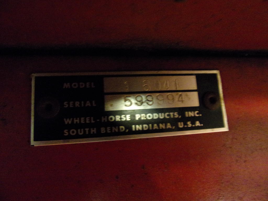

gwest_ca-(File Mod) 12,511 #3 Posted March 13, 2020 Model 1-6041 with serial number 599994? Garry 1 1 Share this post Link to post Share on other sites
SylvanLakeWH 32,710 #4 Posted March 14, 2020 Very generous of you! Looks great! 1 1 Share this post Link to post Share on other sites

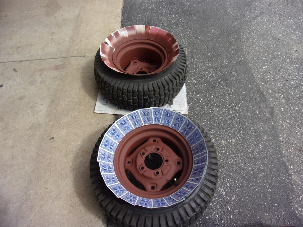

wallfish 20,693 #5 Posted March 14, 2020 Nice going Ed. She looks great. Suppose you wanna get a poker game go'in now, with those marked cards 1 6 Share this post Link to post Share on other sites
Pullstart 71,402 #6 Posted March 14, 2020 4 minutes ago, wallfish said: Nice going Ed. She looks great. Suppose you wanna get a poker game go'in now, with those marked cards Maybe magic tricks? 3 Share this post Link to post Share on other sites
WHNJ701 4,173 #7 Posted March 14, 2020 I really like that idea of the cards for the rims, I have a few old pizza boxes with cut out circles for painting rims. I will have to try that 1 Share this post Link to post Share on other sites

troutbum70 858 #9 Posted March 14, 2020 What a great raffle tractor and really like your idea with cards, very nifty idea. 1 Share this post Link to post Share on other sites

Ed Kennell 47,632 #13 Posted March 14, 2020 13 hours ago, gwest_ca said: Model 1-6041 with serial number 599994? Garry Right on as usual Garry. Tractor Tecumseh deck 1 Share this post Link to post Share on other sites

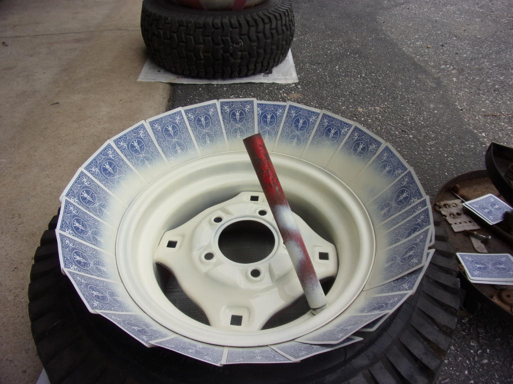

Ed Kennell 47,632 #14 Posted March 14, 2020 12 hours ago, wallfish said: Nice going Ed. She looks great. Suppose you wanna get a poker game go'in now, with those marked cards Thanks John. Not poker, I play double deck pinochle a couple times a week so we wear out a deck every month. So I have plenty for masking WH tires. 2 Share this post Link to post Share on other sites
Ed Kennell 47,632 #15 Posted March 14, 2020 12 hours ago, jabelman said: I really like that idea of the cards for the rims, I have a few old pizza boxes with cut out circles for painting rims. I will have to try that Yeah, I find the cards are much easier to fit between the tire and rim than cardboard cereal boxes or newspaper or masking tape. Share this post Link to post Share on other sites

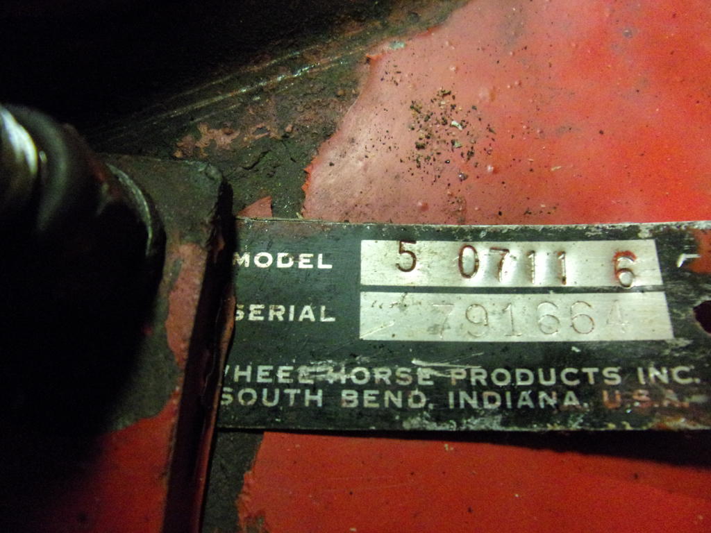

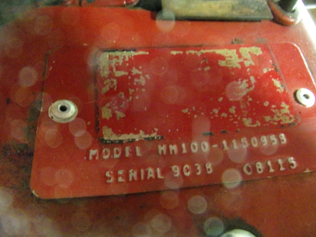

gwest_ca-(File Mod) 12,511 #18 Posted March 14, 2020 Thanks for posting the ID plates. Often get asked where they are located and don't know for sure so started adding the photos to the information pages for each model. Their location moved around over the years. Garry 1 2 Share this post Link to post Share on other sites
Cvans 1,009 #19 Posted March 14, 2020 Painting the wheels made a huge difference and it looks much better. The playing card trick on the wheels is a good one. Thanks for posting it. 1 Share this post Link to post Share on other sites

Ed Kennell 47,632 #21 Posted March 14, 2020 (edited) I drove the Raider to my neighbor to show him his cleaned up tractor. He was pleased to know you guys appreciated his donation. Terry Strayer and his Raider 10 Edited March 14, 2020 by Ed Kennell 6 2 2 Share this post Link to post Share on other sites
stevebo-(Moderator) 8,742 #22 Posted March 14, 2020 Did you say the cigar lighter works 2 2 7 Share this post Link to post Share on other sites
Pullstart 71,402 #23 Posted March 14, 2020 2 hours ago, Ed Kennell said: I drove the Raider to my neighbor to show him his cleaned up tractor. He was pleased to know you guys appreciated his donation. Terry Strayer and his Raider 10 Awesome stuff, Ed! Mr. Terry, you’re a gentleman and a scholar! 6 1 Share this post Link to post Share on other sites
