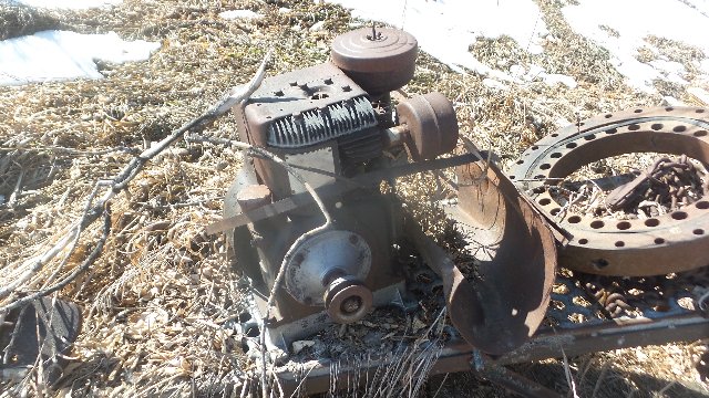

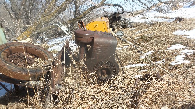

bc.gold 3,406 #1 Posted March 11, 2020 (edited) Spark plug appears to be installed and the pepper pot muffler looks to be in decent condition. Edited March 11, 2020 by bcgold 5 Share this post Link to post Share on other sites
ZXT 2,402 #2 Posted March 11, 2020 ...but does it run? 1 Share this post Link to post Share on other sites
ebinmaine 80,438 #3 Posted March 11, 2020 Dump a bit of ATF in there for a while and see what happens... Share this post Link to post Share on other sites

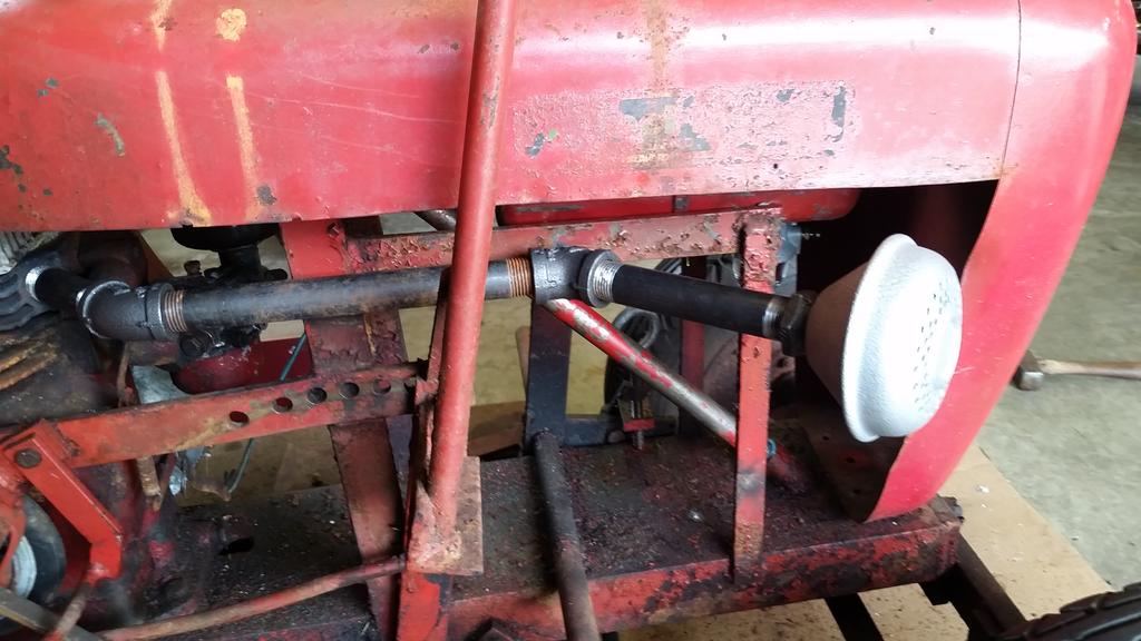

12Horse Paladin 1,038 #4 Posted March 11, 2020 ? What you call the 'pepper pot' muffler... Are those more valuable, or desireable, for some reason? Asking cuz i see lots of discussion on mufflers, and many seem to get excited over this type, and i always wondered why? I always figured the newer type, tube style, mufflers to be the better design, if for no other reason than reduced noise... Share this post Link to post Share on other sites
WHNJ701 4,173 #5 Posted March 11, 2020 must be one those invisible spark plugs 2 1 Share this post Link to post Share on other sites
Stepney 2,356 #6 Posted March 11, 2020 45 minutes ago, 12Horse Paladin said: ? What you call the 'pepper pot' muffler... Are those more valuable, or desireable, for some reason? Asking cuz i see lots of discussion on mufflers, and many seem to get excited over this type, and i always wondered why? I always figured the newer type, tube style, mufflers to be the better design, if for no other reason than reduced noise... I think your thinking of the shower head muffler. Pepper Pot's are still available new and do nothing for sound.. though are authentic to certain models. The original muffler to those 19/23 type B&S engines are of a different shape, that one likely was just a refit. 1 Share this post Link to post Share on other sites
12Horse Paladin 1,038 #7 Posted March 11, 2020 1 hour ago, Stepney said: I think your thinking of the shower head muffler. Pepper Pot's are still available new and do nothing for sound.. though are authentic to certain models. The original muffler to those 19/23 type B&S engines are of a different shape, that one likely was just a refit. Ok, i can understand that. Now i guess i gotta figure out what the shower head muffler is😄, apparently i have them confused/didnt really understand, the difference. Thanks for the info! Share this post Link to post Share on other sites
bc.gold 3,406 #8 Posted March 11, 2020 12 hours ago, ZXT said: ...but does it run? Nope, cash n carry - where is as is. Share this post Link to post Share on other sites
WHX?? 57,869 #9 Posted March 11, 2020 1 hour ago, 12Horse Paladin said: shower head muffler is Very desirable & valuable amongst collectors. Mostly used on small bore motors. 2 1 Share this post Link to post Share on other sites
Achto 32,432 #10 Posted March 11, 2020 15 minutes ago, bcgold said: Nope, cash n carry - where is as is. If it turns over buy it, it will run. If it don't turn over then you're taking a chance. If it does turn over the first thing that I would do (after changing the oil) is cut the points wire off and replace the original coil with an solid state coil, part #398811 or after market equivalent. This coil will have to be installed opposite of the directions on the coil, or put it on backwards. Then rebuild or replace the carb. Those cast iron Briggs are tough engines. Hopefully it will work out for you. 2 Share this post Link to post Share on other sites
ZXT 2,402 #11 Posted March 11, 2020 5 hours ago, Achto said: If it turns over buy it, it will run. If it don't turn over then you're taking a chance. If it does turn over the first thing that I would do (after changing the oil) is cut the points wire off and replace the original coil with an solid state coil, part #398811 or after market equivalent. This coil will have to be installed opposite of the directions on the coil, or put it on backwards. Then rebuild or replace the carb. Those cast iron Briggs are tough engines. Hopefully it will work out for you. The 8 hp Briggs that came on my David Bradley has a SSI coil off of a 5hp briggs on it. Obviously doesn't match up well with the flywheel since it's larger diameter, but it runs! 1 Share this post Link to post Share on other sites
