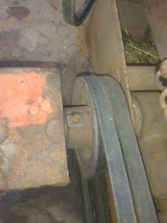

bottjernat1 2,197 #5 Posted March 10, 2020 So I took the drive belt guard off to find this! Any one have a photo of the correct pulley? VID_20200309_180753673.mp4 Share this post Link to post Share on other sites
Pullstart 71,520 #6 Posted March 10, 2020 If you spin the pulley around, would it fit on the shaft if you deburred it? Would the belt line up correctly? Seems it should just be a single groove pulley to me.. 1 Share this post Link to post Share on other sites
bottjernat1 2,197 #7 Posted March 10, 2020 1 minute ago, pullstart said: If you spin the pulley around, would it fit on the shaft if you deburred it? Would the belt line up correctly? Seems it should just be a single groove pulley to me.. yeah after yaking at a few of the wheelhorse junkies on facebook i agree with you to. i think it is sopposed to be single to. i tried to flip it around it wont fit on. either it is tapered or just wore funny. it would line up if i used it but i think i am going to dig around and see if i dont have the correct pulley. or if someone on here does i would be up for buying one. 1 Share this post Link to post Share on other sites
gwest_ca-(File Mod) 12,535 #8 Posted March 10, 2020 1611 pulley should be 4" OD with a 3/4" ID. Hydros used a different OD and a double was used to drive a tiller early on. Garry 1 Share this post Link to post Share on other sites
bottjernat1 2,197 #9 Posted March 10, 2020 (edited) You should have heard some of the responses i got on Facebook. One guy says it looks to small. im like are u blind it went right on in my video LOL. one guy said heat it and press it on. once again watch the video it goes right on. Edited March 10, 2020 by bottjernat1 1 Share this post Link to post Share on other sites
dells68 7,499 #10 Posted March 10, 2020 @bottjernat1 I was on the forum when you posted it and o agree you got a lot of crack-pot answers. None of the crazy ones me by the way! 2 Share this post Link to post Share on other sites
RandyLittrell 3,946 #11 Posted March 11, 2020 I was one that said too small, but I meant the outside diameter of the pulley. I haven't had the belt cover off my belt drives,only my hydro's, so I guess I proved my ignorance!! Ask my wife, she will confirm! Randy 2 Share this post Link to post Share on other sites
bottjernat1 2,197 #12 Posted March 11, 2020 10 hours ago, RandyLittrell said: I was one that said too small, but I meant the outside diameter of the pulley. I haven't had the belt cover off my belt drives,only my hydro's, so I guess I proved my ignorance!! Ask my wife, she will confirm! Randy its all good i wasnt any better i didnt catch what you were getting at. LOL 1 Share this post Link to post Share on other sites

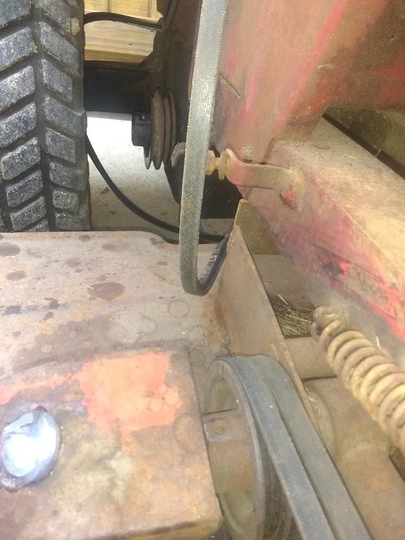

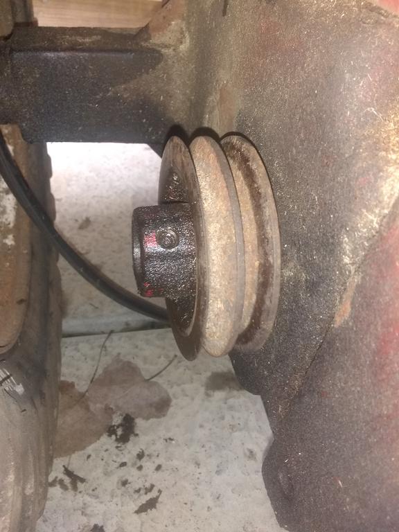

bottjernat1 2,197 #15 Posted March 12, 2020 So i figured out where the rear end pulley came from! I think it is a deck pulley? What do you all think? I am hoping to meet someone at the tractor show in auburn this weekend so i can get the right pulley. I am also needing a couple shifters. Share this post Link to post Share on other sites
bottjernat1 2,197 #16 Posted March 12, 2020 So i did a bit of a temporary Hillbilly rig last night better then nothing. This is temporary and it will come right off so its a good thing. I also greased the fire out of the deck gears. there was little to no grease. I got to go up to my big shed i know i have a couple of the parts i need. 856_silicone.mp4 Share this post Link to post Share on other sites

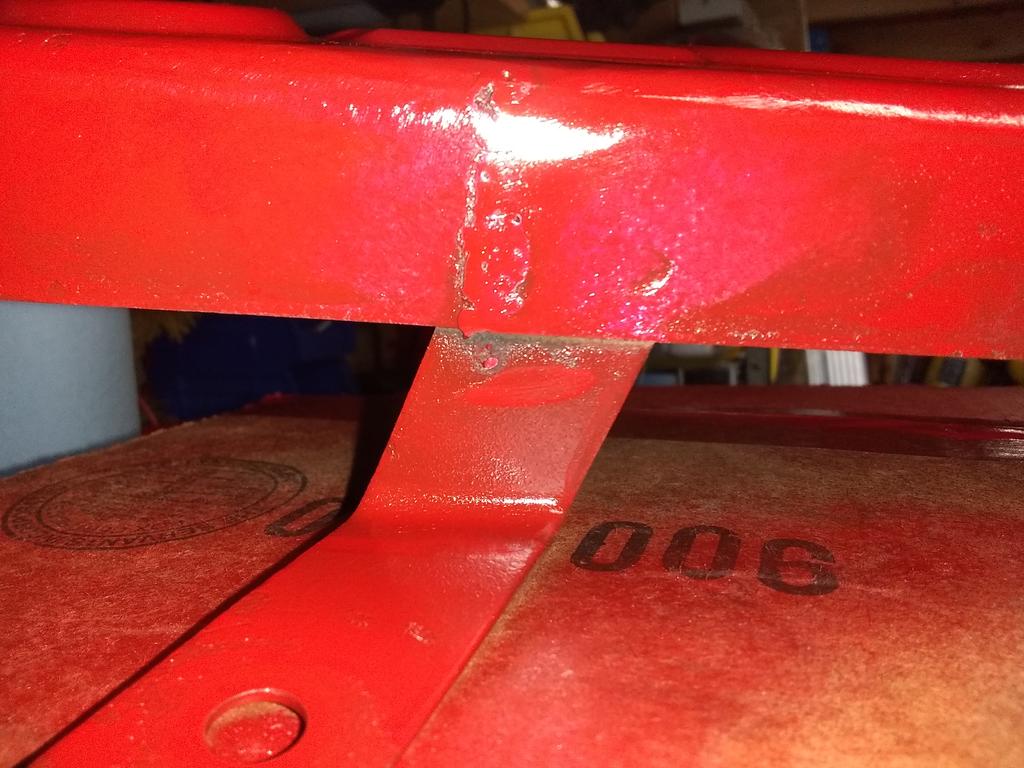

bottjernat1 2,197 #25 Posted March 16, 2020 Update i welded the belt cover. Still gotta do a little more but I feel I did pretty good. It was busted all the way around the curve Share this post Link to post Share on other sites
