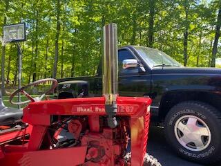

ebinmaine 80,772 #28 Posted May 23, 2020 7 hours ago, johnnymag3 said: That looks very supportive, especially with the added twists for rigidity. Where can I find the locking nuts for the 1" npt pipe? Also a muffler clamp that small...Should I go to the engine vs. the frame? Any difference? I guess there is no movement either way. thanks !!!! john Like @jabelman says those are standard locking nuts from a box store. The clamp on Cinnamon is a 1-3/8" standard exhaust clamp. Best to bring the piece of pipe and compare the sizes. BRANDS WILL VARY. I don't believe it would matter if you went to the engine or frame on a tractor that does not have a shaker engine mount. Share this post Link to post Share on other sites

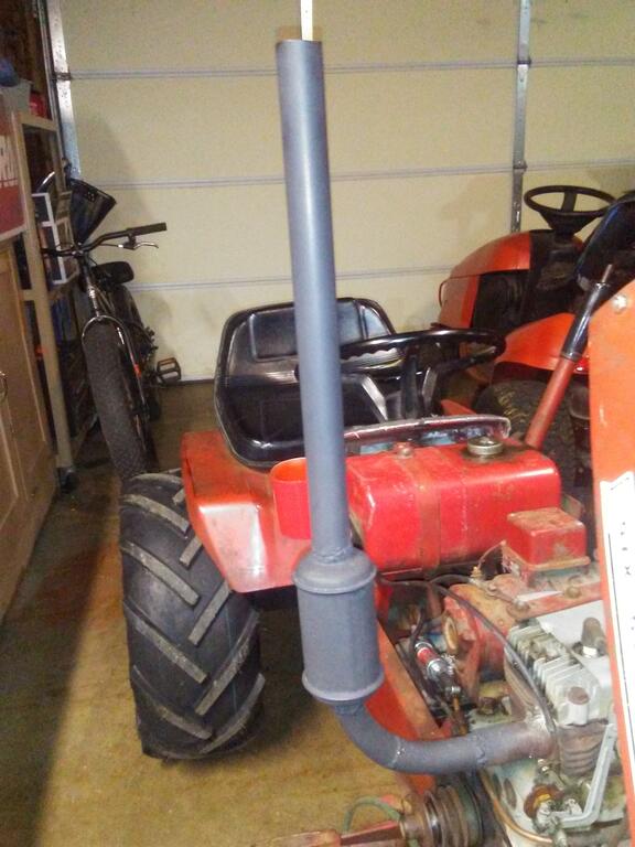

ET160 30 #32 Posted June 18, 2020 I think I'm going to have to extend my stack muffler. I'm getting too much exhaust in my face at the regular height. Share this post Link to post Share on other sites
ebinmaine 80,772 #33 Posted June 18, 2020 Just now, ET160 said: I think I'm going to have to extend my stack muffler. I'm getting too much exhaust in my face at the regular height. That's why the one on my cinnamon horse is so tall. I also have it facing sideways. Share this post Link to post Share on other sites

ebinmaine 80,772 #37 Posted June 18, 2020 19 minutes ago, ET160 said: That's 1 1/2" ID, right? My particular pipe that is on top of the muffler is a 1-1/4" metal bathroom floor drain. I chose that for several different reasons. It's thin so it doesn't weigh much. It's chrome so it looks cool. The piece I bought is half of a p-trap section from a sink drain and I cut it so that it faces sideways. It would be best to get a physical measurement of what you have before purchasing extensions. They can vary. Share this post Link to post Share on other sites
ET160 30 #38 Posted June 19, 2020 Eric, Thanks for the advice. I'll see if can get to the store today. In the interim, what do you think about pointing the stack down toward the front tire. Would it get too hot for the tire? Share this post Link to post Share on other sites
ebinmaine 80,772 #39 Posted June 19, 2020 1 hour ago, ET160 said: pointing the stack down toward the front tire Just before or just after it maybe you would be okay. Maybe. I certainly would not put exhaust pointing directly at the rubber even if it was several inches away. Share this post Link to post Share on other sites
Pullstart 71,332 #40 Posted June 19, 2020 3 hours ago, ET160 said: Eric, Thanks for the advice. I'll see if can get to the store today. In the interim, what do you think about pointing the stack down toward the front tire. Would it get too hot for the tire? do you have pictures of your stack on here somewhere? A “Tink Tink” rain flapper turned 90 outwards can help redirect fumes too. Share this post Link to post Share on other sites
