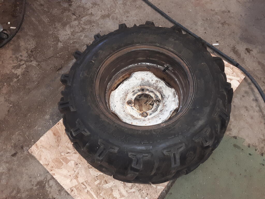

Oldskool 6,678 #178 Posted May 27, 2020 Well come H E double hockey sticks or high water. The GT is getting those tires on. So this is what happens when 14" Chevy ralley wheels meet up with 15in GT wheels. A 1/2" less back space and 2" wider 1 Share this post Link to post Share on other sites
Oldskool 6,678 #179 Posted May 30, 2020 Tire test fit. Looks like it's going go work 1 2 Share this post Link to post Share on other sites

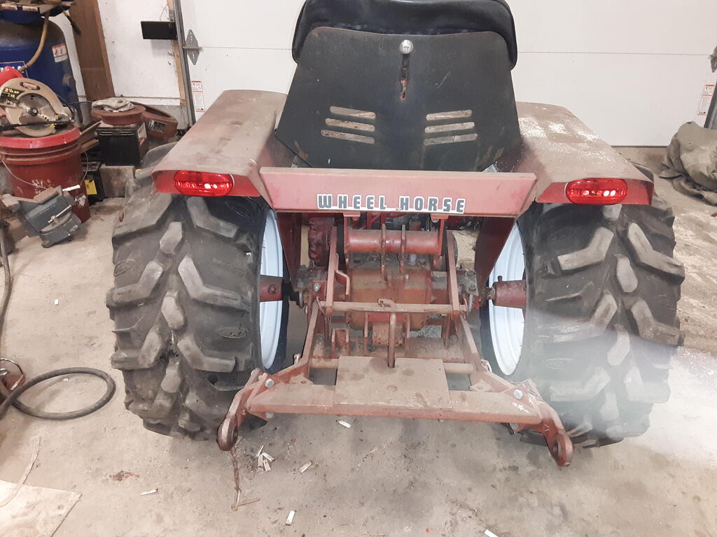

Oldskool 6,678 #180 Posted June 4, 2020 It's been to long getting this far, but it has been a busy year. Surprisingly enough. So 18x9.50x8 on front and 27x11x14 radials on the rear. Now it's a roller. YAY lol.! Now to scrounge up an engine 3 3 3 Share this post Link to post Share on other sites

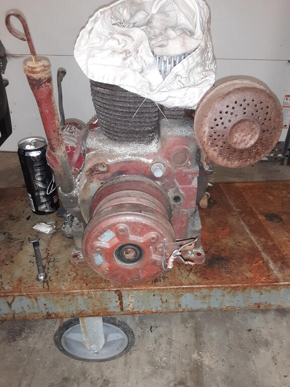

Oldskool 6,678 #185 Posted June 9, 2020 I'm in need of some help here. What is the best way to get these off without destroying something? Share this post Link to post Share on other sites
ebinmaine 80,616 #186 Posted June 9, 2020 Just now, Oldskool said: I'm in need of some help here. What is the best way to get these off without destroying something? @953 nut @pfrederi I remember one of you posting a particular tool or tools..... 1 Share this post Link to post Share on other sites
Oldskool 6,678 #187 Posted June 9, 2020 I was wondering if a bearing puller with a 3 jaw puller would work. Not sure how the electric clutch comes off either 1 Share this post Link to post Share on other sites
ebinmaine 80,616 #188 Posted June 10, 2020 1 minute ago, Oldskool said: I was wondering if a bearing puller with a 3 jaw puller would work. Not sure how the electric clutch comes off either No sir. Something to do with a correct sized bolt and push/pull against the crankshaft. Pullers do NOT work on some or most electric clutches. Share this post Link to post Share on other sites
Oldskool 6,678 #189 Posted June 10, 2020 3 minutes ago, ebinmaine said: No sir. Something to do with a correct sized bolt and push/pull against the crankshaft. Pullers do NOT work on some or most electric clutches. Ah, so kinda like a power steering pulley removal/installation tool? Share this post Link to post Share on other sites
953 nut 69,146 #190 Posted June 10, 2020 16 minutes ago, Oldskool said: in need of some help here. What is the best way to get these off without destroying something? The inside of the electric clutch is threaded, mine on a '70 GT-14 was a 1"-8 NC bolt thread. Run the bolt in against the end of the crank shaft and it will push the clutch off. You cab borrow one from ACE, buy it and then bring it back telling them it was not the correct size. 2 1 Share this post Link to post Share on other sites
Oldskool 6,678 #191 Posted June 10, 2020 9 minutes ago, 953 nut said: The inside of the electric clutch is threaded, mine on a '70 GT-14 was a 1"-8 NC bolt thread. Run the bolt in against the end of the crank shaft and it will push the clutch off. You cab borrow one from ACE, buy it and then bring it back telling them it was not the correct size. Mine seems to be the same thread as my puller bolt. I believe that would be Acme thread? Share this post Link to post Share on other sites

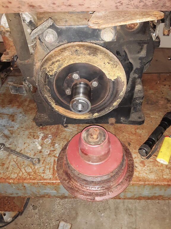

Oldskool 6,678 #193 Posted June 10, 2020 Both clutches are off. The pulleys and set screws are soaking over night in WD-40. Hope to get them off tomorrow after work. Any tips and tricks for those? I assume they are cast iron and really dont want to mess them up Share this post Link to post Share on other sites
Oldskool 6,678 #194 Posted June 11, 2020 Well dang. I thought I was making some headway on the GT. Then the old engine hit the floor and broke the pulley. Kinda needed it lol. Now on the hunt for one of those 3 Share this post Link to post Share on other sites
