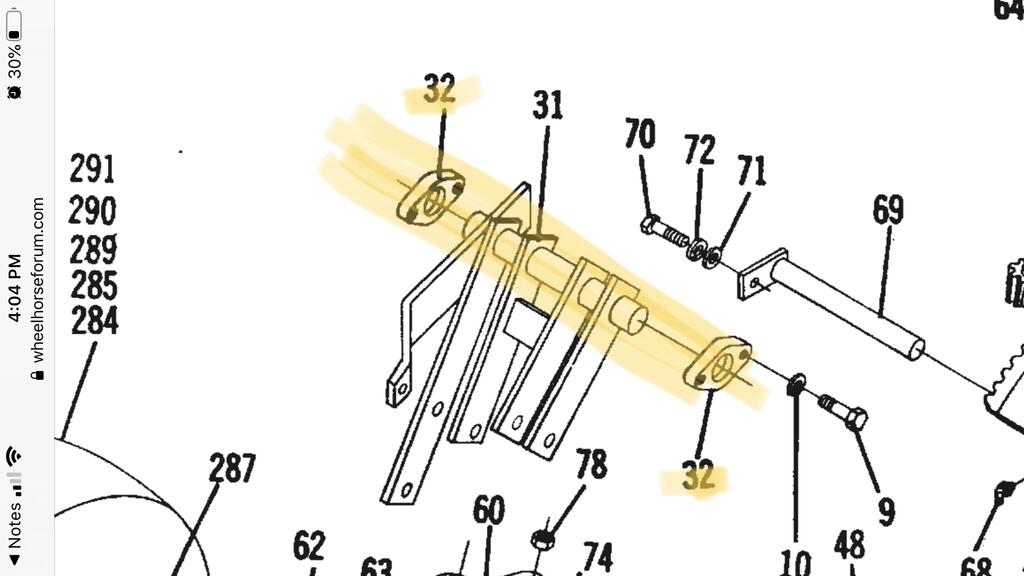

Oldskool 6,678 #288 Posted July 11, 2020 3 hours ago, pfrederi said: Pull the pin between the rock shaft and the heavy link going back to the 3pt. See if that changes anything. Look for an binding blockage of the rock shaft /cylinder arm. The end caps of the rock shaft is where the binding is. Now is that cap open ended or is it cup shaped? My thought is if it's open ended I may drill a hole on either end to spray WD40 into then when freed put grease fittings in Share this post Link to post Share on other sites
19richie66 17,932 #289 Posted July 11, 2020 (edited) The rock shaft sits in blocks like the three point upper link. Edited July 11, 2020 by 19richie66 1 Share this post Link to post Share on other sites
Oldskool 6,678 #290 Posted July 11, 2020 15 minutes ago, 19richie66 said: The rock shaft sits in blocks like the three point upper link. Sweet! I going to put the grease fittings in. I have it freed up. I still wasn't getting full motion. The rest of the problem was the instrument panel had shrunk to the point it wasn't letting the handle have full travel. I put up a wanted ad for that panel and a dash panel Share this post Link to post Share on other sites

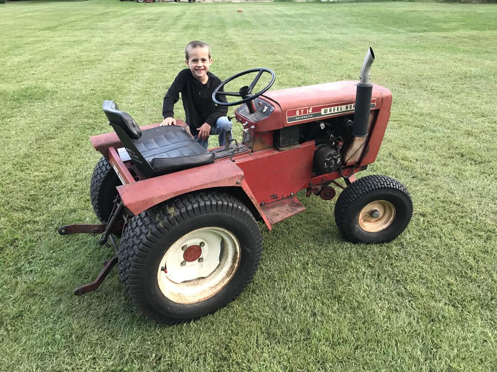

PeacemakerJack 11,059 #291 Posted July 12, 2020 Well done! I showed Zach the video of you driving through the tall grass and he was going crazy saying...”I need those type of tires on Blackbeard (his GT14)!!!” Very cool indeed and I’m glad you’re sticking with it. You have it almost to the point of being able to put it into service👍🏻 4 Share this post Link to post Share on other sites
Oldskool 6,678 #292 Posted July 12, 2020 @PeacemakerJack thank you. It's been fun it's also been a bit trying at times. A few more trips around the yard then on to the FEL part of the project. Any pics of Blackbeard? 1 Share this post Link to post Share on other sites
PeacemakerJack 11,059 #293 Posted July 12, 2020 2 hours ago, Oldskool said: Any pics of Blackbeard? There is a whole thread dedicated to it...😉 However, this is one of my favorites... my little buddy and his big tractor! 2 2 1 Share this post Link to post Share on other sites
Oldskool 6,678 #294 Posted July 12, 2020 1 hour ago, PeacemakerJack said: There is a whole thread dedicated to it...😉 However, this is one of my favorites... my little buddy and his big tractor! He sure looks like he likes that GT. I'm digging the stack. Kinda wish I had gone that route 1 Share this post Link to post Share on other sites
