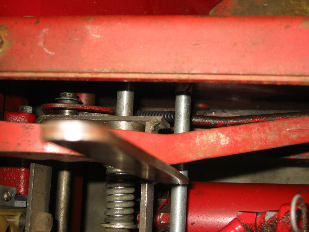

Oldskool 6,678 #251 Posted July 6, 2020 17 hours ago, pfrederi said: Long end of the roll pin forward for drive back for tow. Return spring hooks to cam plate and the 1/4" bolt just below the cross shaft I have the spring installed. Unfortunately the valve is stuck halfway. Also I checked the dipstick and there isnt any fluid on it. What is a replacement for type A trans fluid for them tractors? Share this post Link to post Share on other sites

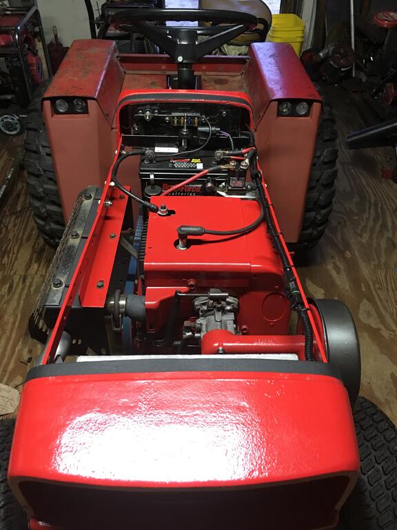

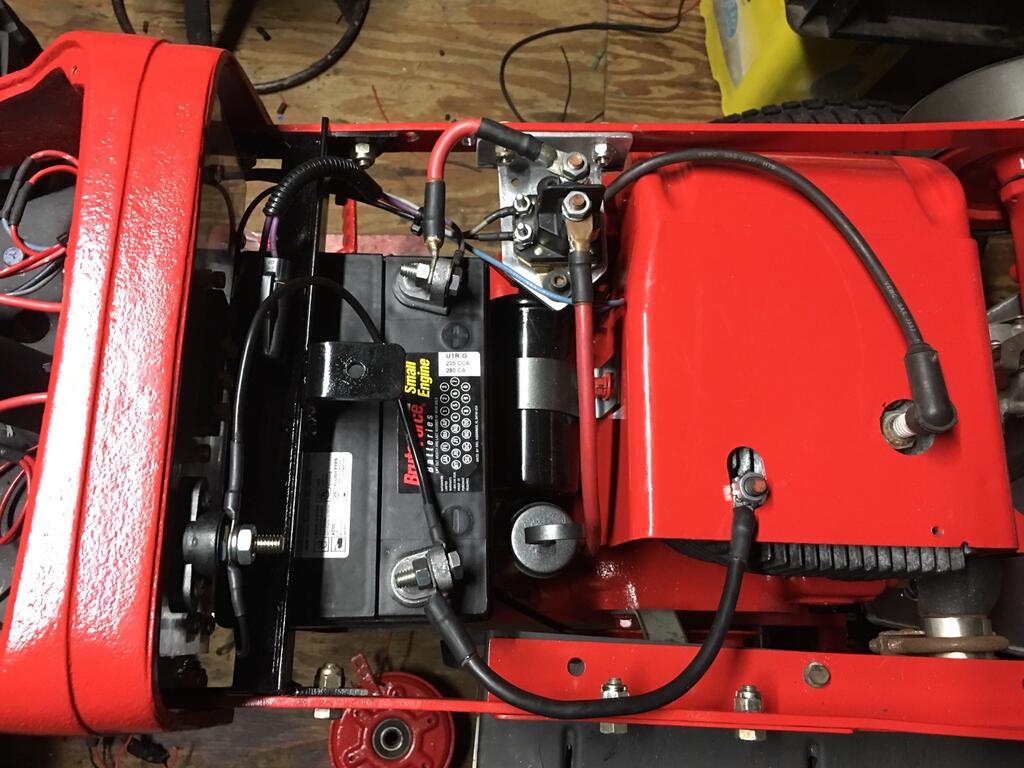

19richie66 17,932 #252 Posted July 6, 2020 I made a tab that has a rubber foot/stud that pushes down on the battery. Maybe over complicated but works and holds the hood pin also. 1 2 1 Share this post Link to post Share on other sites
Oldskool 6,678 #253 Posted July 6, 2020 @19richie66 nice looking engine bay. That year it that tractor? Share this post Link to post Share on other sites
pfrederi 21,145 #254 Posted July 6, 2020 Dex/Merc for fluid Going to have to free up your tow valve. Soak it and tap on it occasionally. It is a port valve remove the big nut and it should pull straight up and out. 2 Share this post Link to post Share on other sites
Oldskool 6,678 #255 Posted July 6, 2020 (edited) 6 minutes ago, pfrederi said: Dex/Merc for fluid Going to have to free up your tow valve. Soak it and tap on it occasionally. It is a port valve remove the big nut and it should pull straight up and out. So nothing is gonna go flying out when I pull it. You know those little pieces that you wonder where in the heck they went and when you do find the pieces now how does that go back together? 🤔 Edited July 6, 2020 by Oldskool Share this post Link to post Share on other sites
pfrederi 21,145 #256 Posted July 6, 2020 Just now, Oldskool said: So nothing is gonna go flying out when I pull it. You those little pieces that you wonder where in the heck they went and when you do find the pieces now how does that go back together? 🤔 No springs just 2 O rings and a plastic backer ring. 1 Share this post Link to post Share on other sites

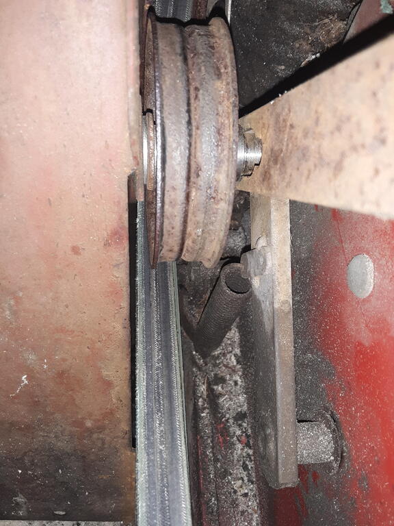

Oldskool 6,678 #257 Posted July 6, 2020 Getting real close now. I got the vale to turn. Now figure out how the throttle cable comes out of the dash so to install a new one. Then the last thing is to investigate why the belt wants to ride on the edge of the idler pulley. 1 Share this post Link to post Share on other sites
pfrederi 21,145 #258 Posted July 6, 2020 Move the hydro pump drive pulley in or out a bit to align also check engine pulley had to move mine out a bit. Share this post Link to post Share on other sites
Oldskool 6,678 #259 Posted July 6, 2020 @pfrederi I will try it again. By the looks of the belt it was an issue before I did the engine swap. I had to make a new bushing that went on the end of the bolt that holds the idler pulley on. Kinda thought that would have fixed it. Back to the drawing board Share this post Link to post Share on other sites
pfrederi 21,145 #260 Posted July 6, 2020 Get a long straight edge align engine pulley and pump pulley with your idler 2 Share this post Link to post Share on other sites
19richie66 17,932 #261 Posted July 6, 2020 3 hours ago, Oldskool said: @19richie66 nice looking engine bay. That year it that tractor? Thanks. 1972 1 Share this post Link to post Share on other sites

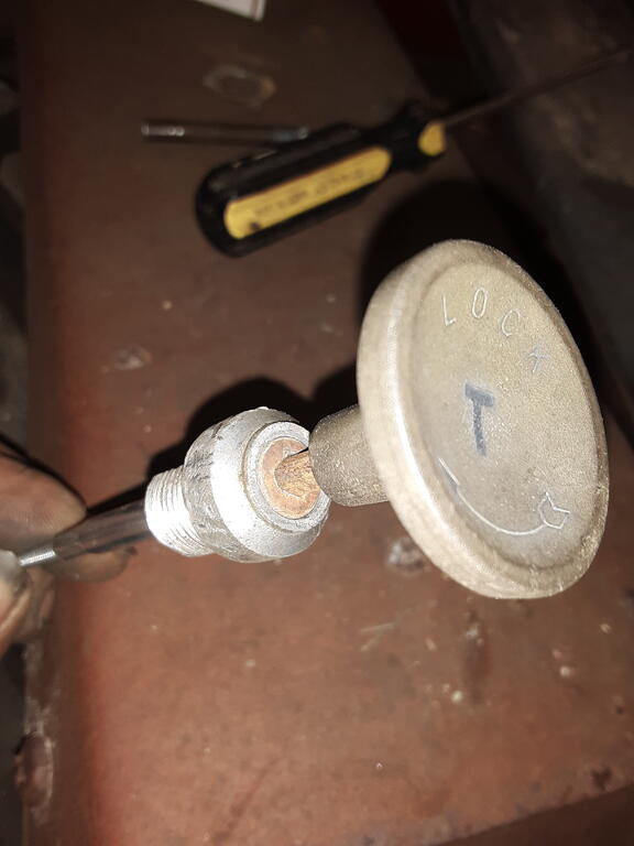

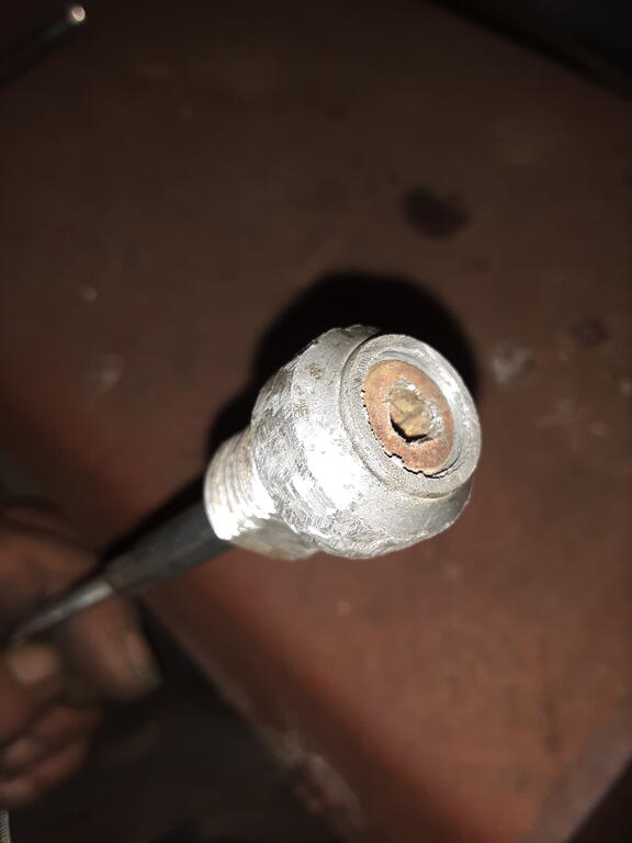

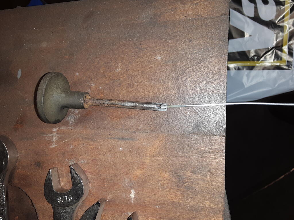

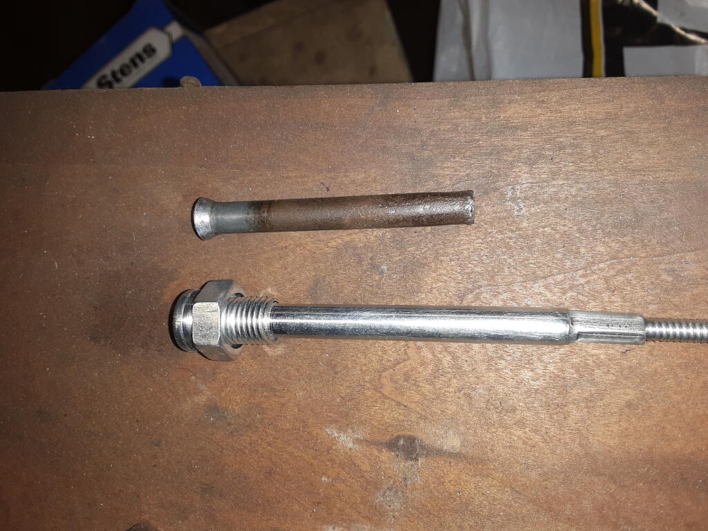

Oldskool 6,678 #262 Posted July 6, 2020 Hope this hold up but made a new throttle cable old/new. I wanted to try and save the throttle lock. Share this post Link to post Share on other sites

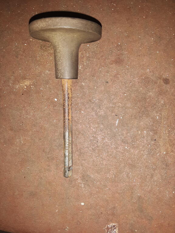

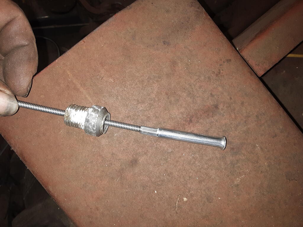

Oldskool 6,678 #263 Posted July 6, 2020 The top tube is what is left of the old cable casing. The bottom is the new cable casing. It has been cut off and flared Share this post Link to post Share on other sites
Oldskool 6,678 #264 Posted July 6, 2020 Top pic is the cable reassembled. I had to drill out the back of it for the new casing to pass thru. Bottom pic is the old handle. The hole on the side is where the old cable was staked in place. Share this post Link to post Share on other sites
Oldskool 6,678 #265 Posted July 6, 2020 The new cable inserted and staked in place. Simply heated with a small torch then hit with a punch thru the little hole. Then the finished product. It locks in place very nicely. As long as it holds up I'm good to go. 1 Share this post Link to post Share on other sites

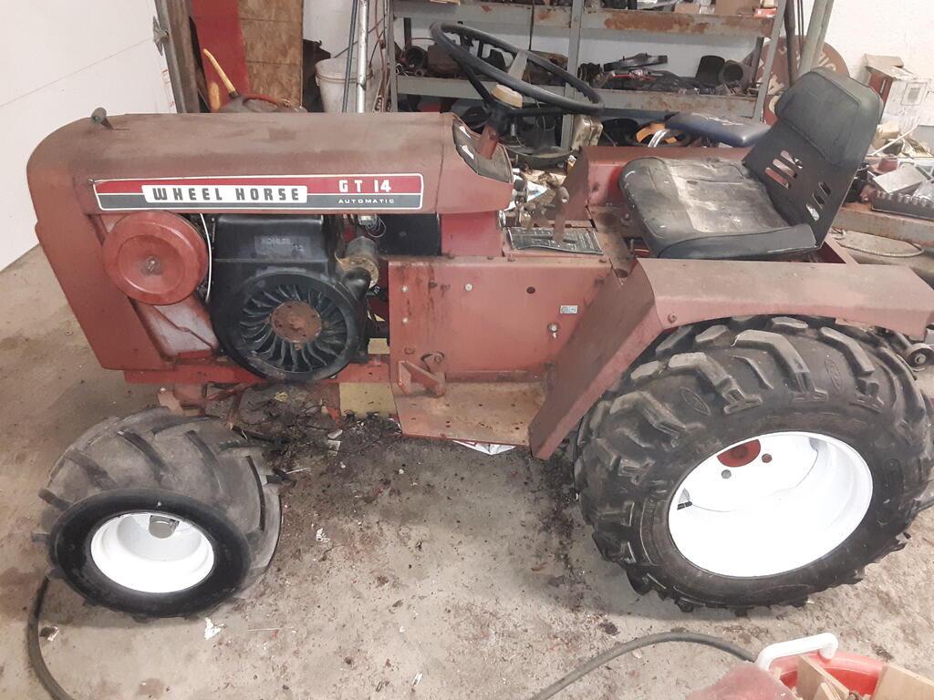

Oldskool 6,678 #272 Posted July 11, 2020 @19richie66 I think I should have spent more money on my pump. I ended up taking 2 old ones to make 1. It pumps. Hope it keeps up. 1 Share this post Link to post Share on other sites

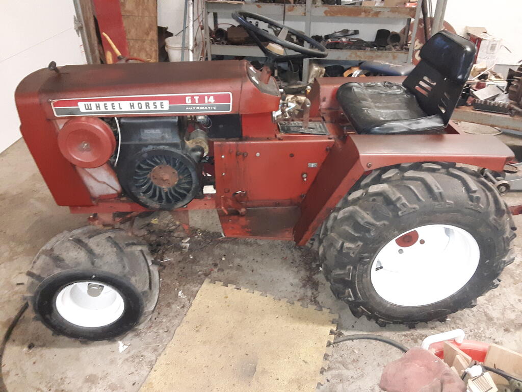

Oldskool 6,678 #273 Posted July 11, 2020 If all goes well and the rain stops I think I'm finally ready for a ride. Somebody got a WD-40 bath and rubbed down with a scotch brite pad and so did the GT lol 5 Share this post Link to post Share on other sites
ebinmaine 80,619 #274 Posted July 11, 2020 13 minutes ago, Oldskool said: Somebody got a WD-40 bath and rubbed down with a scotch brite pad and so did the GT lol Hehehehehe.... You've put a lot of thought and time into this one with the help of others. That's gonna be a valuable tool in your garden/yard arsenal. Worth every single minute. I'll be looking forward to seeing video once you get a ride in. 1 1 Share this post Link to post Share on other sites
Oldskool 6,678 #275 Posted July 11, 2020 1 minute ago, ebinmaine said: Hehehehehe.... You've put a lot of thought and time into this one with the help of others. That's gonna be a valuable tool in your garden/yard arsenal. Worth every single minute. I'll be looking forward to seeing video once you get a ride in. Thanks. It will definitely be worth it. I will for sure post a video of the first ride. Anxious to get the FEL on as well 1 Share this post Link to post Share on other sites
