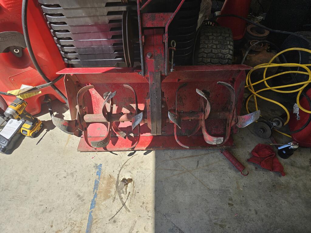

HyperPete 939 #9 Posted May 1, 2025 On 3/3/2020 at 9:24 AM, Lane Ranger said: I have replaced the two seals on one side on two different tillers. Clothes line and wire rubbed the seals open. Two seals on each side and I did not have to slit the case. The two piece tines on each side remove pretty easy to access. I know this is coming back from the dead, but I am struggling to replace my seals. I removed the outer two times & the square plate, and the two shaft "pins" & cotter pins. I can't get the tines off the access the seals. Are you able to help? Share this post Link to post Share on other sites
WHX?? 57,769 #10 Posted May 1, 2025 Should be pins that come out but yes the tines may be brown welded on. Maybe try tilling with the pins out loosen it up ? 2 Share this post Link to post Share on other sites
mike avad 61 #11 Posted May 1, 2025 I'D put a little heat on them and tried to used a pice of wood and a hammer mine came right off but I had mine apart before good luck 1 Share this post Link to post Share on other sites
ineedanother 2,800 #12 Posted May 2, 2025 9 hours ago, WHX?? said: Should be pins that come out but yes the tines may be brown welded on. Maybe try tilling with the pins out loosen it up ? I have two tillers, both in pretty good condition but I'm going to pull the tines off in the next week or two. is how I'll go about it. I'm getting too old to not let the machine do the work when possible. 1 Share this post Link to post Share on other sites
Lane Ranger 12,092 #13 Posted May 3, 2025 HyperPete: I had leaky seals on mine as the clothes line rubbed the seal up and the axles were coated. . They came right off but if yours are not welded heating them up with a gas acetylene torch should do the job. Your pic does show a little twist in the one tine. Share this post Link to post Share on other sites

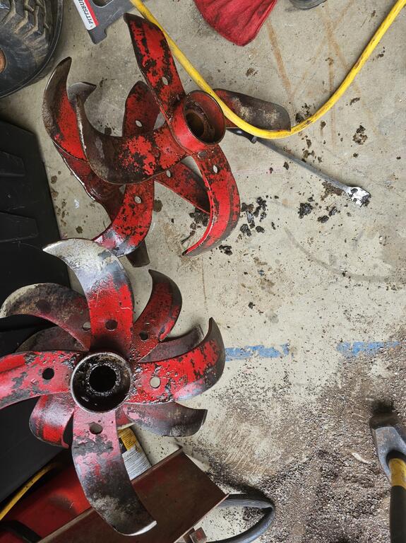

HyperPete 939 #14 Posted May 4, 2025 (edited) Thanks everyone for the replies. The acetylene torch was next on my list, but I wanted to be sure there wasn't a circlip or something similar inside that I was fighting against. It would really be unpleasant too hammer the heck out of it and end up snapping something off internally. I did get the top section of tines on one side to slide on the inner-axle, but it still wouldn't come off. I have been slamming it with a hand sledge and it just isn't moving. So I guess I'll hit it with the torch and see what happens next. And I'll get some updated photos. Thanks! Edited May 4, 2025 by HyperPete 1 Share this post Link to post Share on other sites

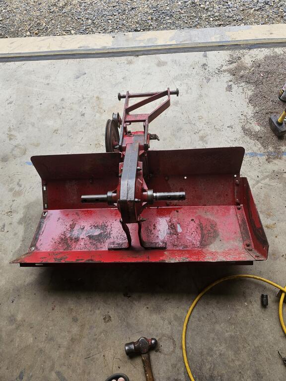

HyperPete 939 #19 Posted May 7, 2025 (edited) Interestingly, I had been dousing everything liberally with penetrating oil. I was hammering the crap out of the underside of one side, and it began moving on the inner shaft. I sprayed it all again and left it for a few days. I came out today, prepared to do more battle, and the tines literally just slid off the shafts. WIN! Edited May 7, 2025 by HyperPete 1 Share this post Link to post Share on other sites
